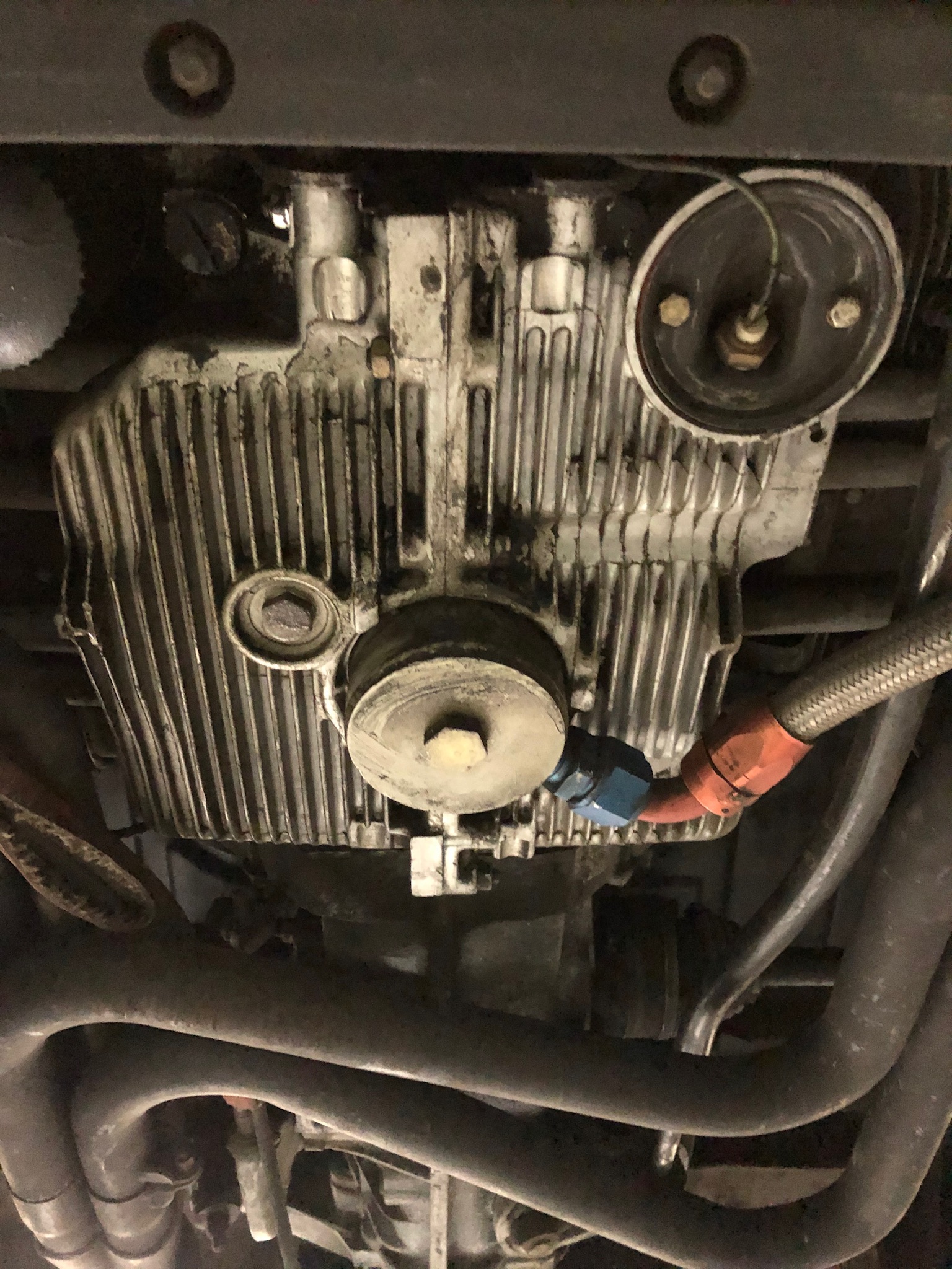

infraredcalvin   Skipped the race in Pahrump... onto Chuckwalla...   Nov 9 2020, 10:55 PM
GregAmy   What are we looking at? What went kablooey? The T...   Nov 10 2020, 07:50 AM

GregAmy   The pic is of all the oil coming from the top of ...   Nov 10 2020, 09:23 PM

infraredcalvin   Sorry I missed your post, I think the gal showed m...   Nov 10 2020, 10:30 PM
GregAmy   No thoughts on the oil pressure. Greater than zero...   Nov 10 2020, 10:32 PM

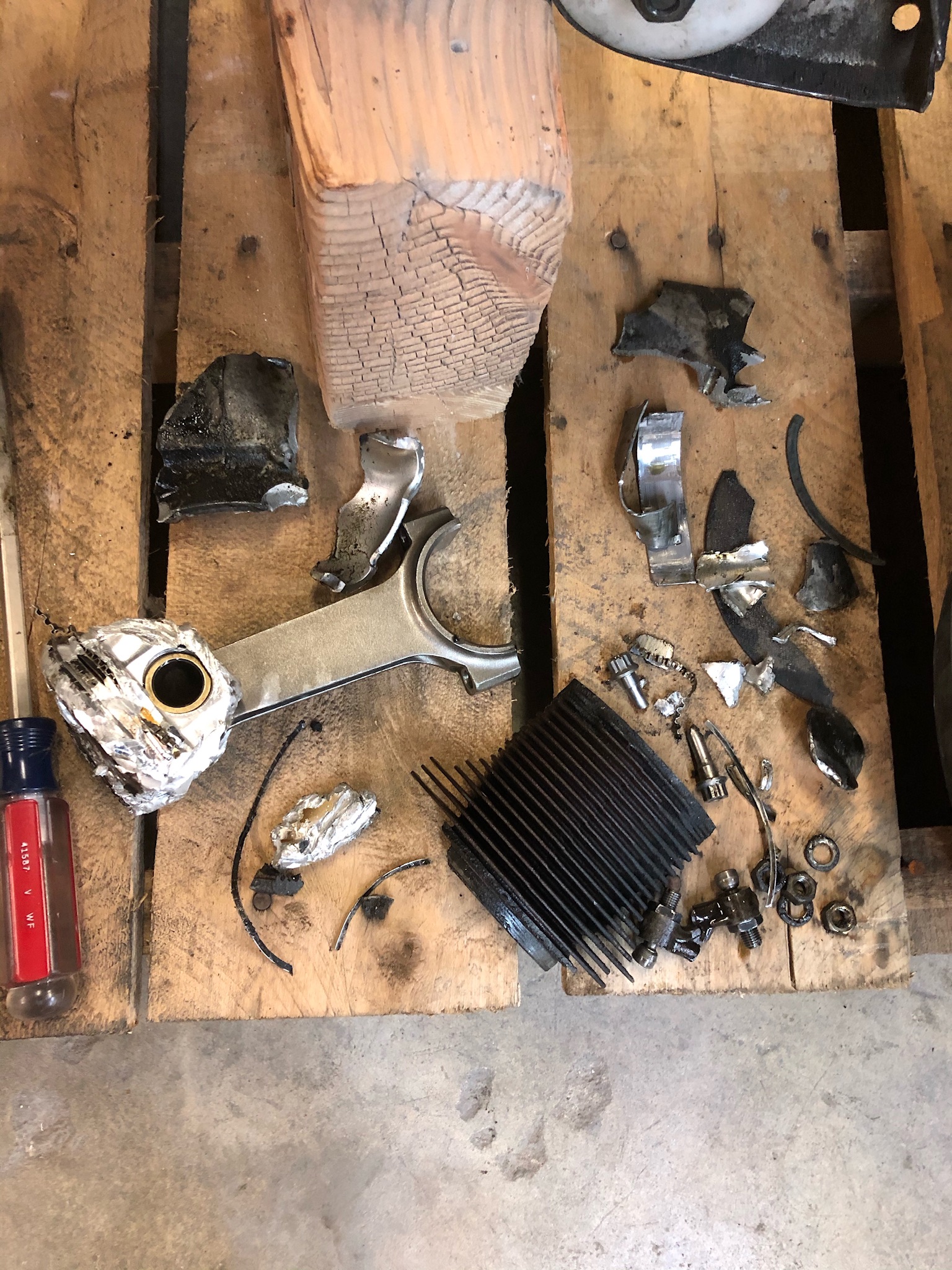

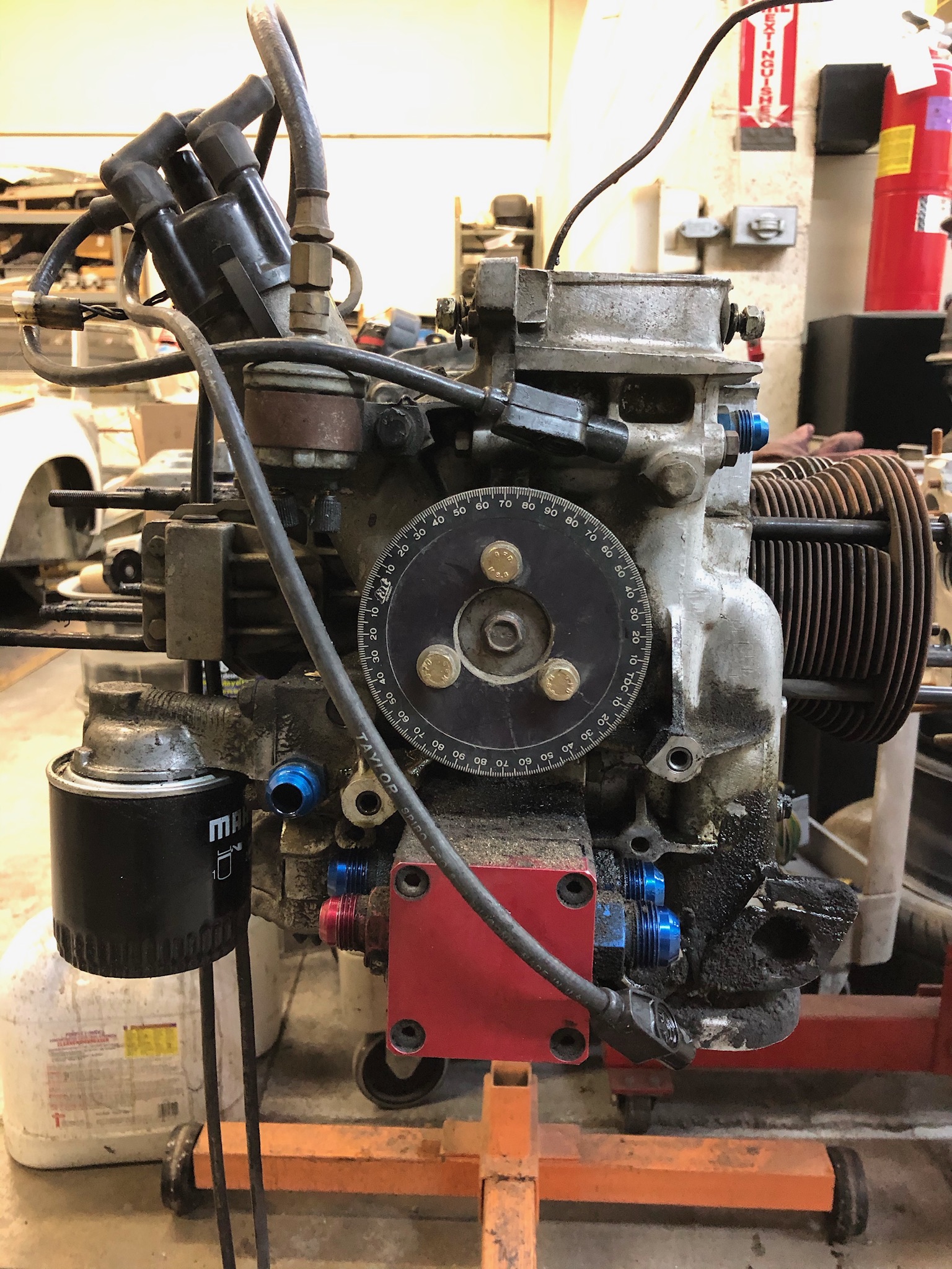

infraredcalvin   Well, no such luck on the damage. I dropped the m...   Nov 17 2020, 09:12 AM
mepstein   Holy moly   Nov 17 2020, 09:14 AM
brant   those "windows" in the case are a clear ...   Nov 17 2020, 09:39 AM
GregAmy   Ooooowww.... "So what happened?" ...   Nov 17 2020, 12:13 PM

infraredcalvin   Just got off the phone with Dennis at FAT, looks l...   Nov 18 2020, 02:45 PM

Charles Freeborn   Ooooohh.... that hurts... Did it destroy the crank...   Nov 19 2020, 12:45 PM
GregAmy   Ooooohh.... that hurts... Did it destroy the cran...   Nov 19 2020, 04:23 PM
wndsrfr   Ooooohh.... that hurts... Did it destroy the cra...   Nov 19 2020, 08:25 PM

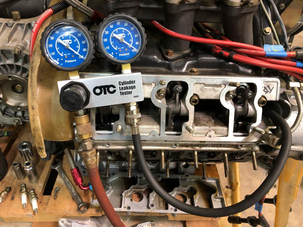

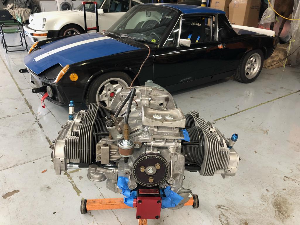

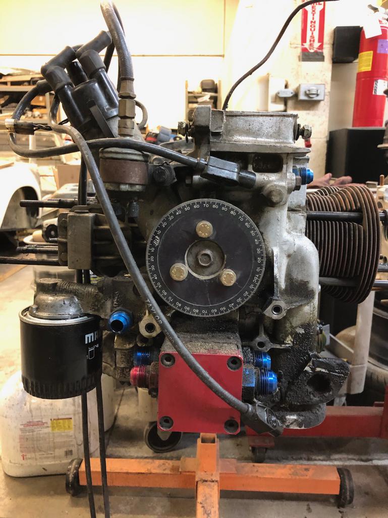

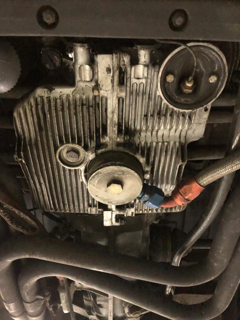

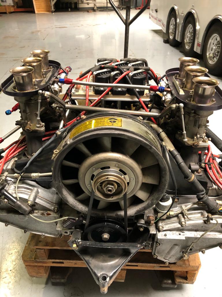

infraredcalvin   UPDATE: Motor build is progressing fine, ultimate...   Feb 3 2021, 09:03 AM
yeahmag   What dry sump pump will you be running? I've b...   Feb 3 2021, 11:53 AM
infraredcalvin   Sorry, I thought I had a picture of the clean pump...   Feb 3 2021, 01:16 PM
infraredcalvin   Also used modified tuna can on bottom. Only conce...   Feb 3 2021, 01:18 PM
yeahmag   Looks like a BugPack pump. Did you happen to recor...   Feb 3 2021, 04:56 PM
infraredcalvin   Looks like a BugPack pump. Did you happen to reco...   Feb 3 2021, 07:18 PM
ChrisFoley   Autocraft Dry Sump Pump.   Feb 3 2021, 06:23 PM
infraredcalvin   BTW, the valve head broke off, no dropped seat. P...   Feb 3 2021, 07:26 PM

infraredcalvin   The 914 gods were on my side and I finally picked ...   Feb 6 2021, 08:38 PM

infraredcalvin   Who would have thought spark plugs would be on bac...   Mar 17 2021, 03:08 PM
Tdskip   Score!   Mar 19 2021, 10:51 AM
Justinp71   Nice Motor! What are the specs on it (size, ca...   Mar 22 2021, 09:56 AM

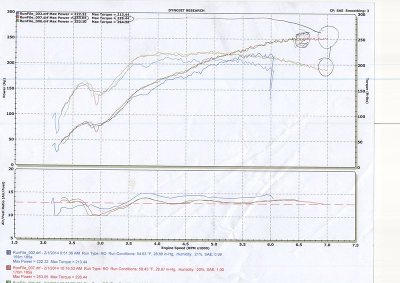

infraredcalvin   Motor came with limited info, but finding notes re...   Mar 23 2021, 08:12 AM
slivel   Motor came with limited info, but finding notes r...   Mar 27 2021, 11:45 AM
Tdskip   I have 964 cams in the ‘74 911 with the 3.2, the...   Mar 23 2021, 09:47 AM

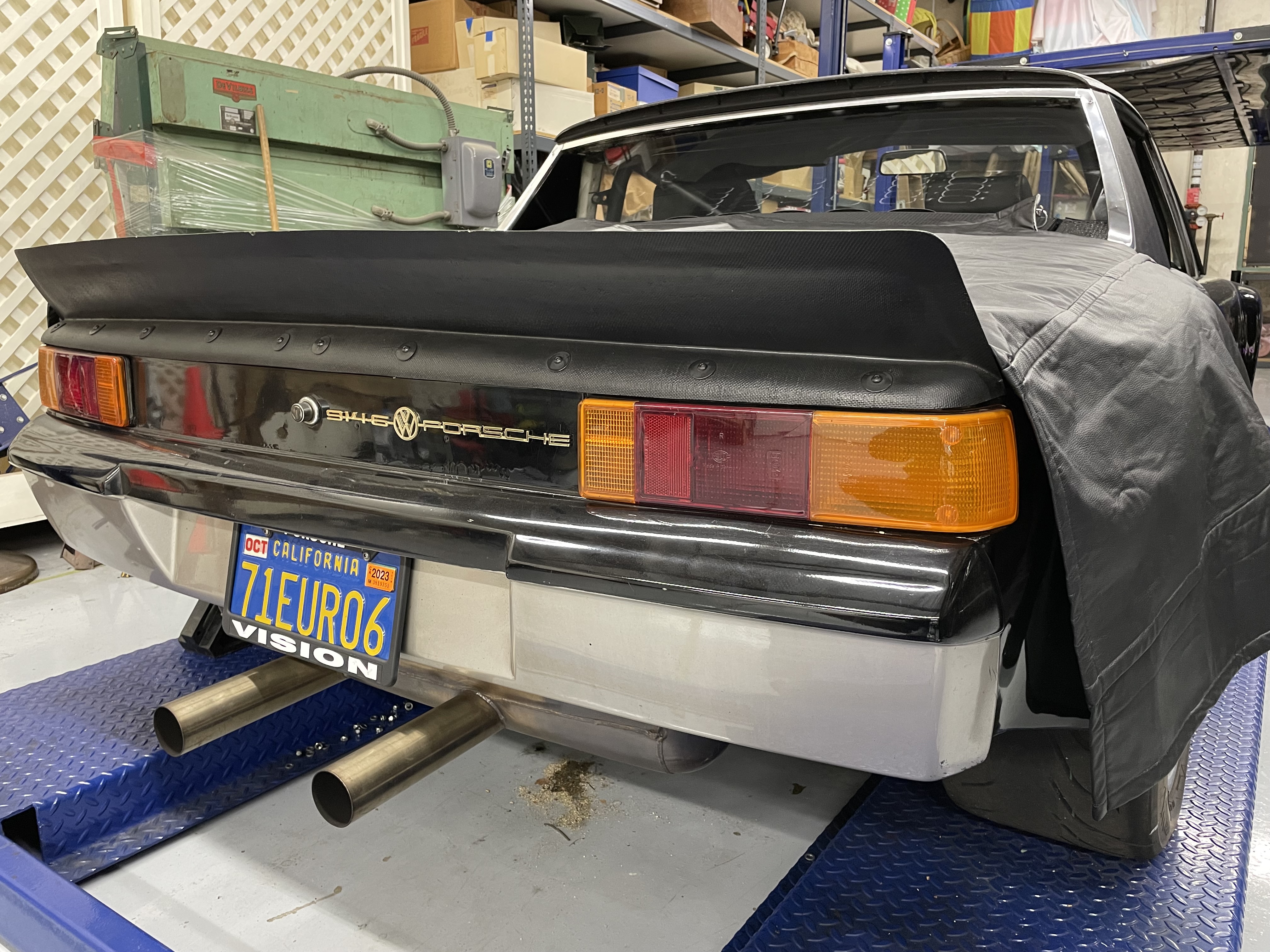

infraredcalvin   Got motor back in, everything hooked up, 6 qts of ...   Apr 10 2021, 10:15 PM
Charles Freeborn   Got motor back in, everything hooked up, 6 qts of...   Apr 11 2021, 07:02 PM

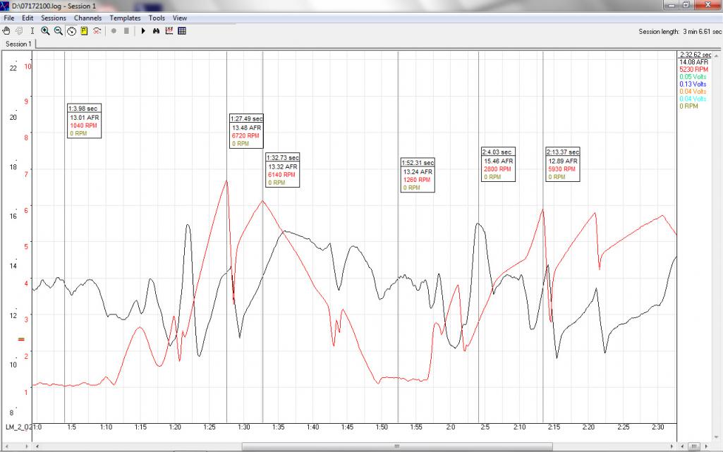

infraredcalvin   JZiq93JBxTY I was able to tune most of the poppin...   Apr 11 2021, 08:56 PM

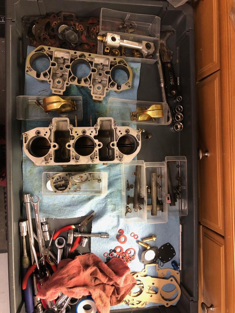

infraredcalvin   Thanks, I ended up, rebuilding the carbs, glad I d...   May 2 2021, 11:56 PM
Justinp71   Fyi, they run rich all the time. This is so the tr...   May 4 2021, 02:17 PM
Justinp71   Also I'd just drive it to the raceway... much ...   May 4 2021, 04:26 PM
infraredcalvin   I’m hearing you about running rich. I’m still...   May 4 2021, 11:58 PM

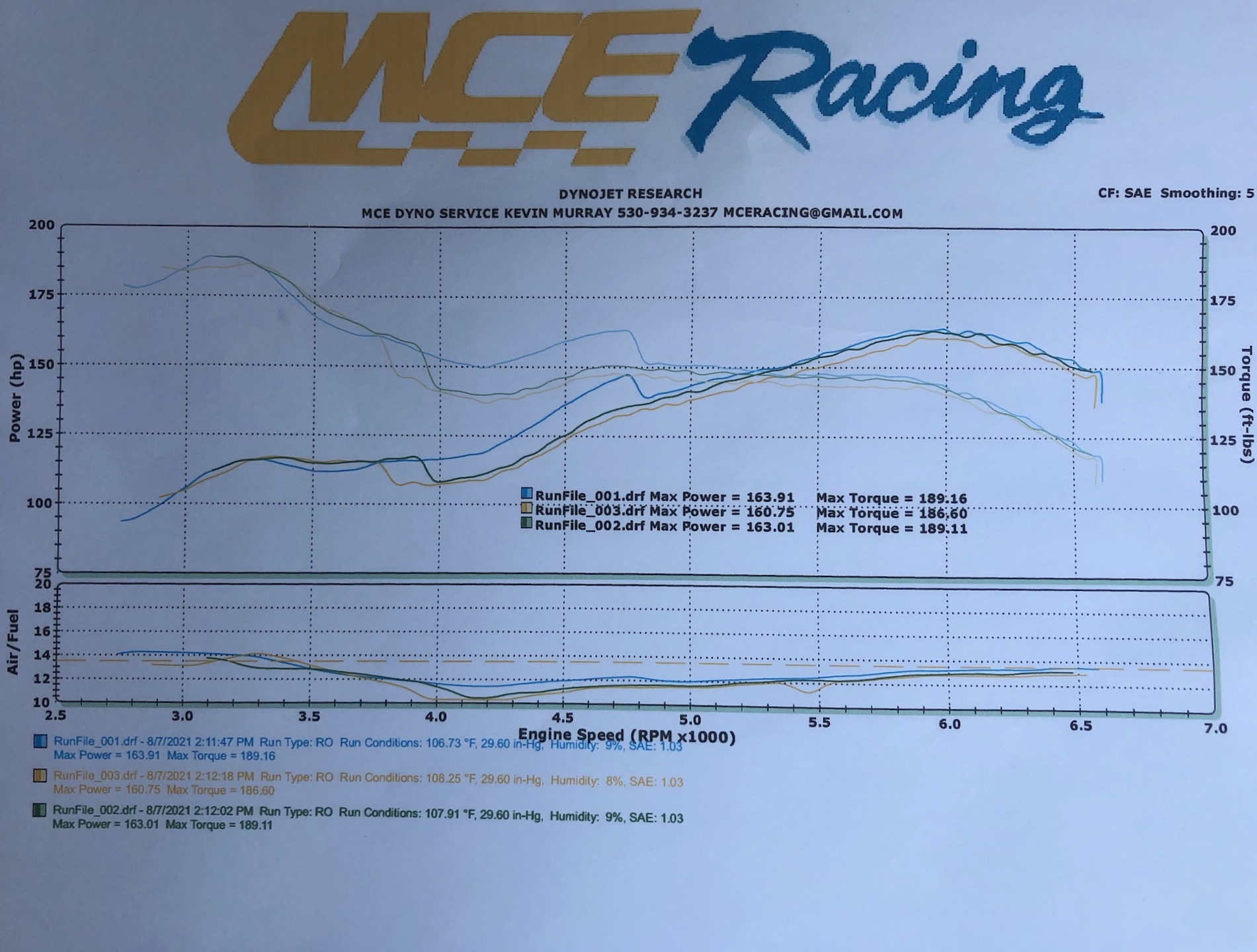

Justinp71   Wow, 10:1 at WOT that is rich, got some power on t...   May 6 2021, 04:13 PM

infraredcalvin   Right now engine tune is my highest priority, yes ...   May 22 2021, 11:04 AM

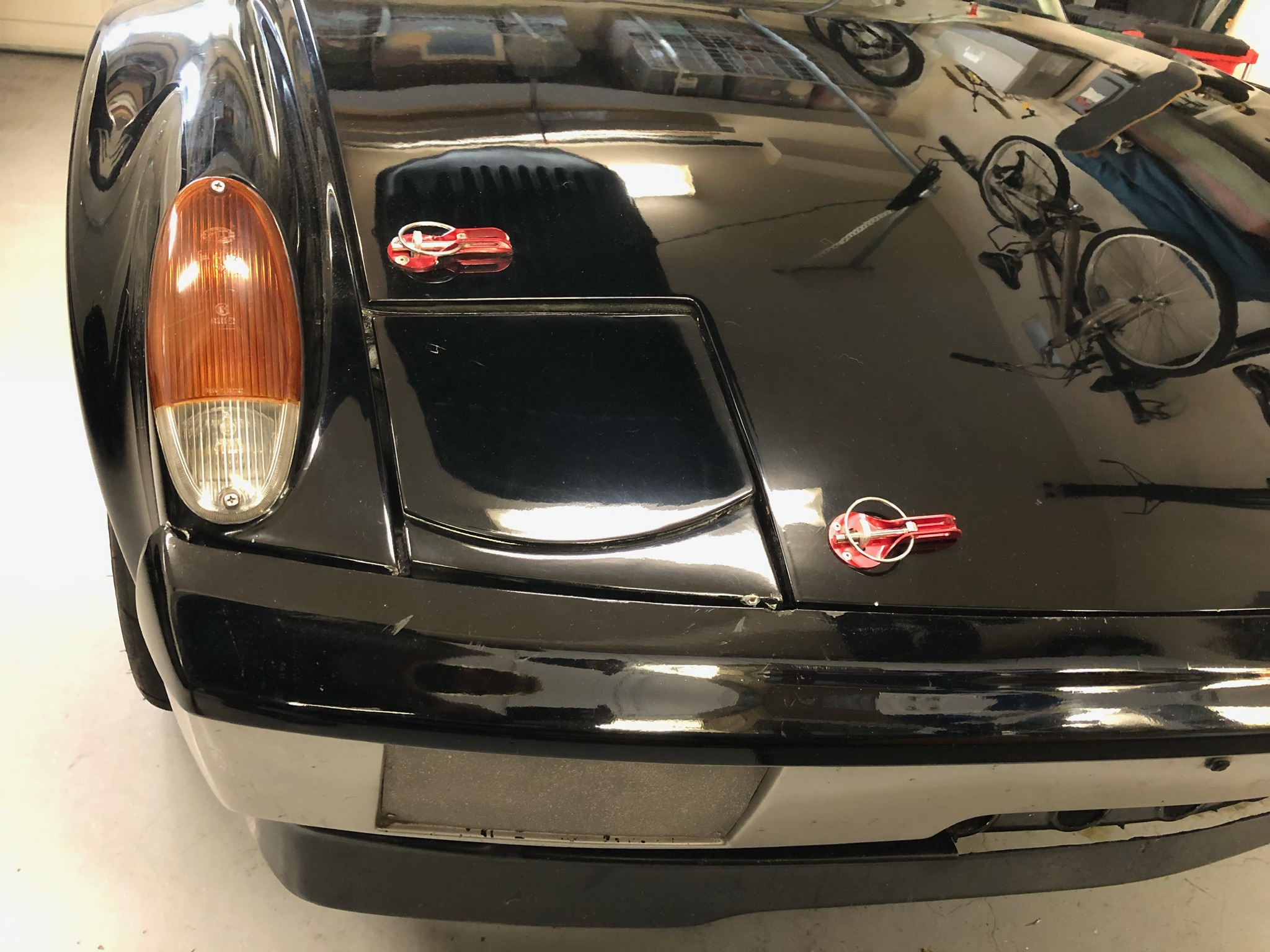

infraredcalvin   Gotta pin down front of hood. PO put spacers a...   May 22 2021, 11:20 AM
stownsen914   Gotta pin down front of hood. PO put spacers at...   May 23 2021, 08:11 AM
stownsen914   On the engine tune, AFRs around 10 is way rich. Fo...   May 23 2021, 08:30 AM
infraredcalvin   air may be flowing IN there instead of out. This ...   May 23 2021, 10:12 AM
stownsen914   It's a little hard to figure out the orientati...   May 23 2021, 11:53 AM
