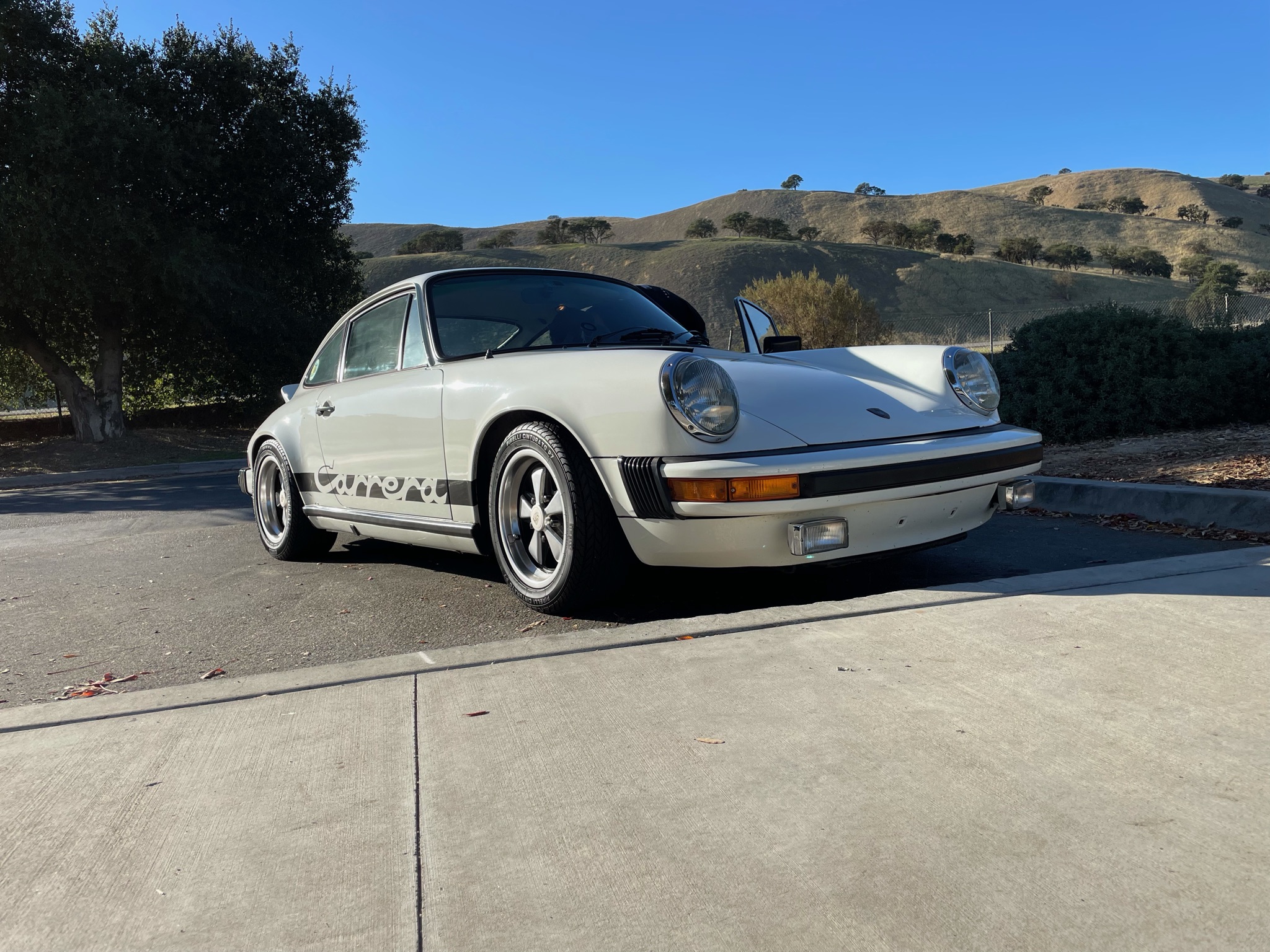

A little sidebar, last week I went on a road trip with my best friend. He’s an avid historic racer, and has some really neat cars, one specifically, is near and dear to our hearts… but this story isn’t about that car…
My friend was invited to race at the Velocity Invitational at Laguna Seca (formerly held at Sonoma Raceway - Sears Point). He wanted to get up there early as practice started on Thursday. He chose a good little car that is now becoming one of his favorite road trip cars, a ‘74 Carrera. Nothing fancy, just a nice, driver+ quality car. We set out from the OC (Irvine) at 10 AM in this little dream, headed to Monterey:
The car was about to flip the odometer, we were going to do some photos/postings on the ‘gram when the odo/speedo stopped working a hundred or so miles from flipping back to zero…. Oh well, we had fun anyway…

Nice ride! My uncle has a 70 in white that I grew up with, has a strong 2.5L first time I drove that I was shocked at the instant power. We put the first 2.7L in my 914 while I was in high school!

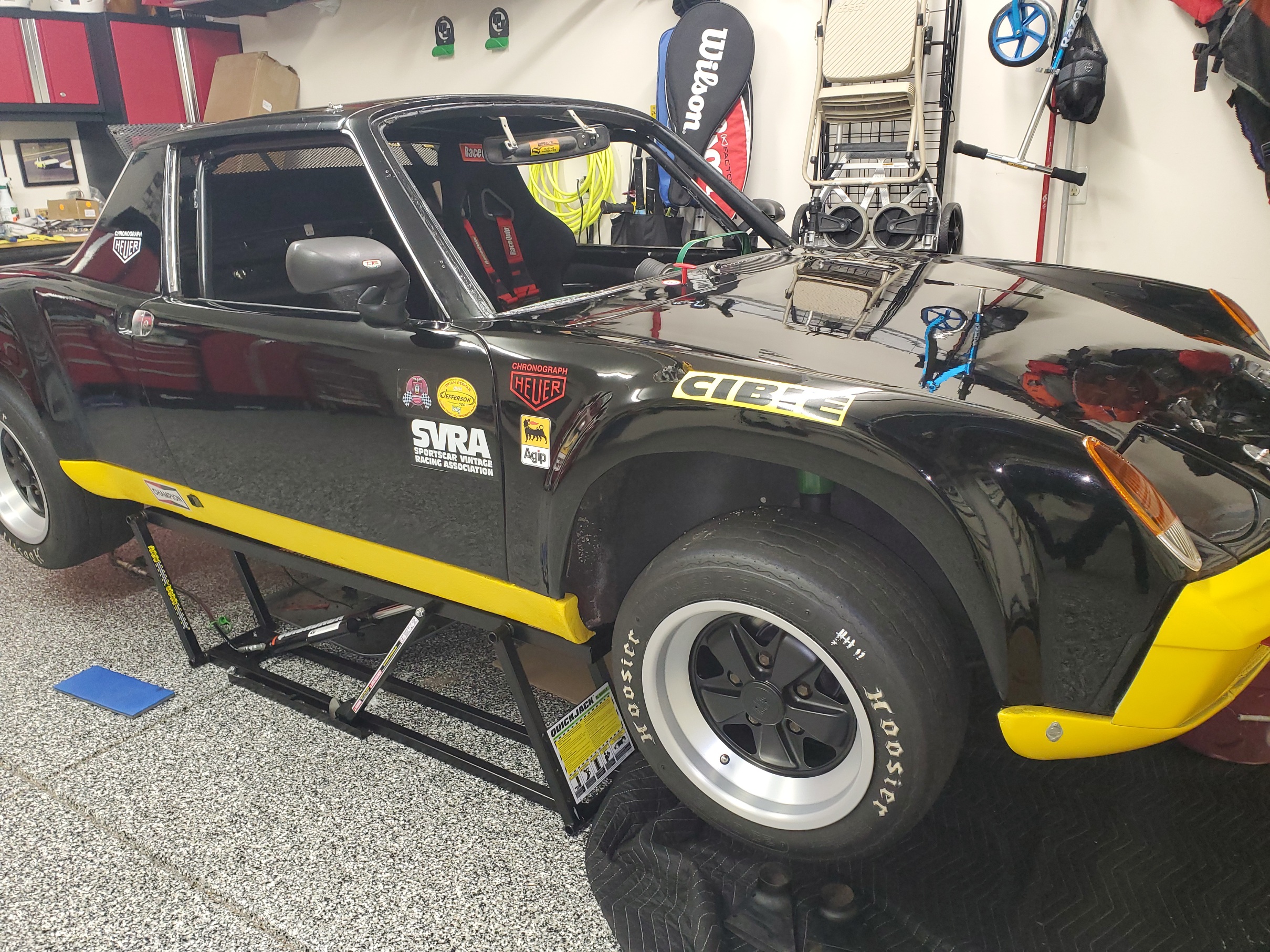

Now for a quick update on my car. Spent some time messing with carbs, a little better here and there, but I think I need a colortune, as I still can’t “hear” the sweet spot. I’m considering a wholesale change, @slivel has a similar motor setup, but very different carb settings. I’m thinking of swapping to what he’s got (I have all the chokes and jets) and seeing what happens…???
I’ve also been playing with timing using my ever trusty 20 year old craftsman adjustable timing light. I was getting erratic readings when taken near coil or near plug. So I used a voltmeter on the electromotive board as suggested in the instructions. I think I got both banks firing at the correct timing. It certainly feels like she woke up a bit on top - although I’m only talking 10-20 hp or so…. Regardless, progress! I also bought another used HPV-1 board and coil in case one of mine is bad.
I’m messing with suspension now. Set up my smart strings and have a combined total of 1/4” toe out in front! That explains why she darts under hard braking, probably also explains why steering feels so heavy. I’ll get her adjusted this weekend, ahhhh I’m sensing the nimbleness of the 914 is about to come back…
Up next I think we”ll also take a look at a poor man’s cornerbalance…

1/4" toe out is a bit much. For track car you want no more than an 1/8 " toe out or neutral. Toe in is not generally recommended for track only.

Long time listener, first time caller...
Toe out will not cause a heavy feeling in the steering nor darting under breaking. It will cause the car to feel darty on the freeway and turn in FAST. With anything beyond 0mm toe out the car will want to tram line and follow any irregularity in the road. I run about 3mm toe out in the front on 15" wheels with a close ratio rack. It's a pain in the ass on the freeway. Caster on the other hand can make the steering feel heavy. That being said, I run as much caster as I can to help with camber gain while turning.
Darting under braking is likely either an imbalance in the suspension or brake system. Even when I ran 1/4" of toe out on my autocross car you could stand on the brakes without touching the steering wheel and it would stop straight (surface needs to be flat).

@yeahmag & @cracker Thanks for the response guys, I’m a silent listener to both of you on anything you post, you guys have lots of track/course time to the max in these cars.
Fact is yes and yes, my car does track on every single variance on the road, it also turns in fast, if you’ve driven Willow Springs (before the new pavement) you’d understand why it darts under hard braking too. Caster is maxed, as is camber - I forget, but I think I got -1.8 at the front and -2 at the rear.
I’m sure you’ve seen my engine woes above, most of this is venting. Seems like the whole damn car just feels lethargic. I’ve been around 914s enough to know it just doesn’t feel right, and it’s not one thing that’s causing it. It’s got all the right cool kid parts, but it’s like none of them were finely tuned or even tuned at all.

-2 in the rear with all shims removed? I still have shims on the white car with some still to go. Around -2.2 at present with -1.25 in front. You will dial in what works for you over time.
Been DE and racing 914s for ~32 years.

Actually I misspoke above, rears measured out at -2, I was advised not to mess with it until some of thes other issues were resolved with the fronts.
Actually, I just reread above, and it clicked this time, lots of caster makes steering heavy… hmmmm, you just made something else click…. (IMG:style_emoticons/default/idea.gif)
I gotta check something else on my front suspension this weekend…

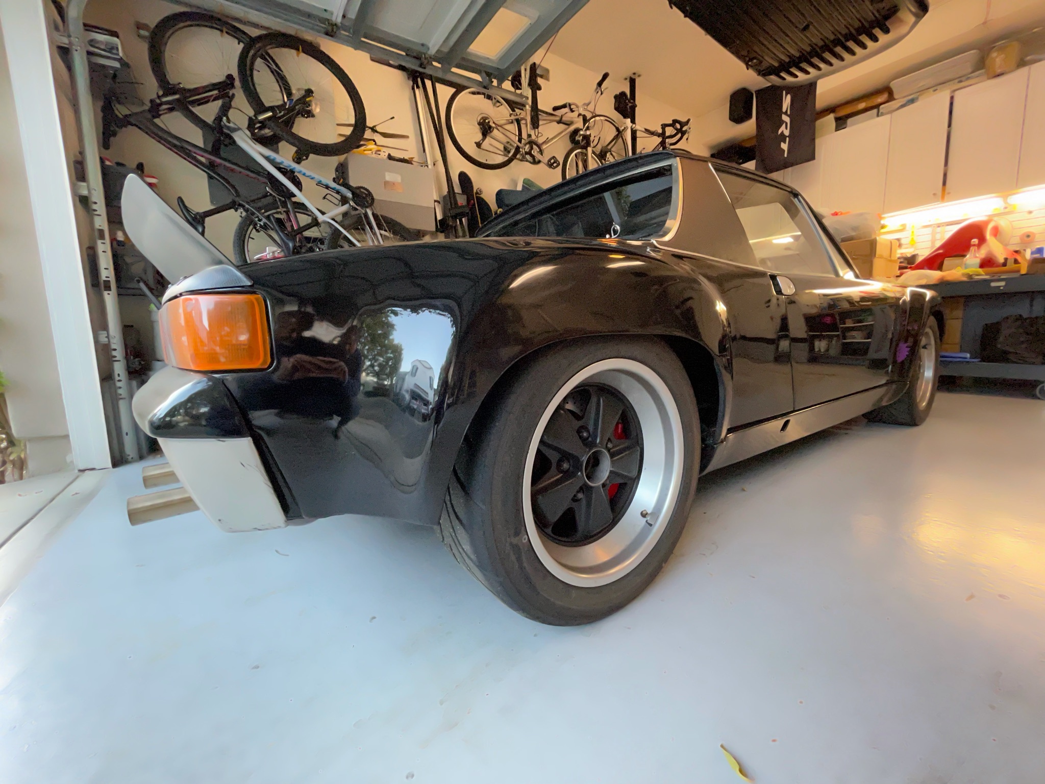

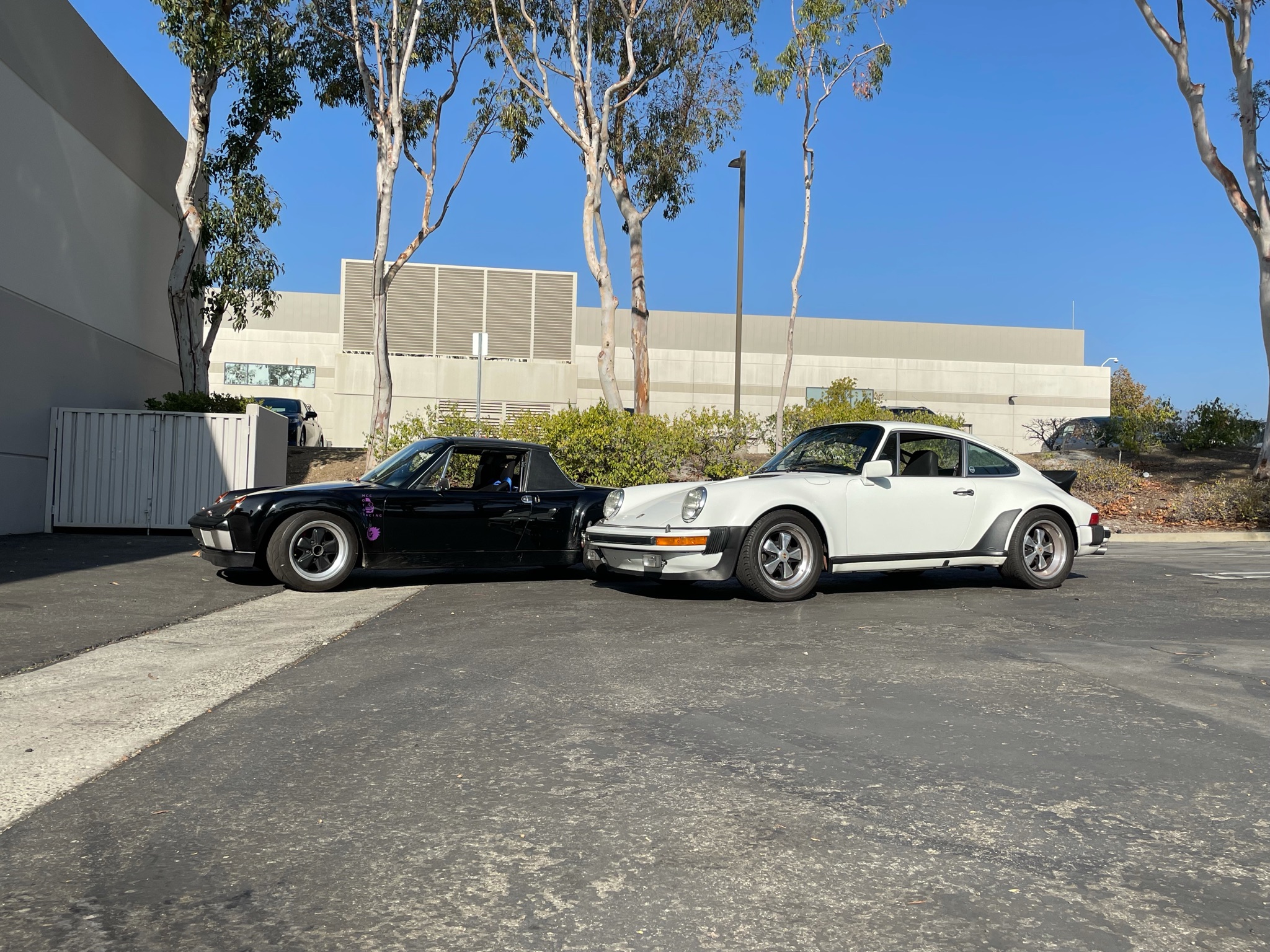

Good day today at the shop. Last drive last week I felt a single shutter in the front suspension, felt it once on the track too, couldn’t really put my finger on it except that it felt like the suspension was moving, yet I couldn’t see any evidence (I thought it was the shock mount at the top). Then while discussing caster above it dawned on me where the movement was occurring.
I set my front toe to 0 deg and took it for a drive today. Found that when I hit my brakes hard while in reverse, I’d get the shutter, then again if I hit the brakes hard moving forward. Back on the lift, sure enough, the a arms were sliding front to back. The PO had put on the infamous needle bearings, but appeared that the front mount was not pushed all the way back to prevent movement when tightened. Also found one of the front outer bearing mounts was backwards - I flipped it, took a clamp to the assembly and tightened all up. Put my strings back up and readjusted toe.
Hopefully there wasn’t a reason the mount was on backwards (like the needle bearings were installed backwards on this mount by accident….???
Gave me an opportunity to take the turbo out for a spin too:

Happy NYE all, had my car at the house for the holidays, didn’t mess with it much. Except as I was chasing down sloppy throttle and clutch linkage, it revealed almost non existent pedal cluster bushings. Car came with a new set so this must’ve been on the POs list. I didn’t do a restore, just cleaned things up and put her all back in the car. Just need to put the cable back on trans side and put skid plate back under steering rack. This is so much easier on a lift….

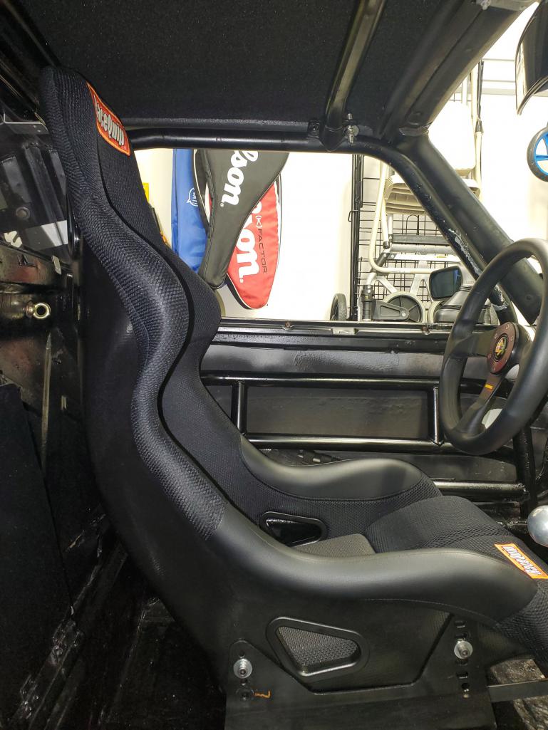

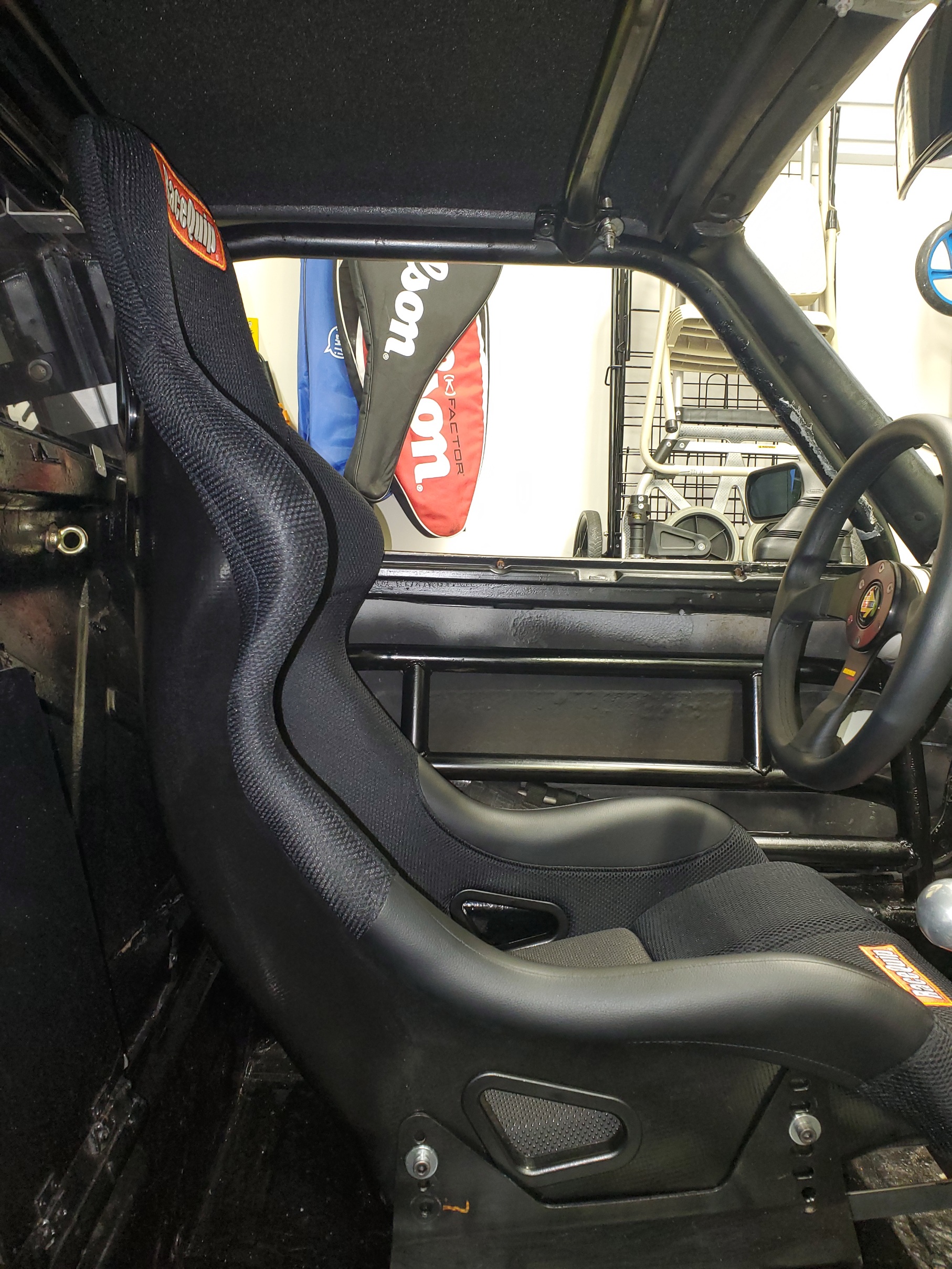

Have enjoyed watching your progression with the car! Have been totally reworking my 6 too and just test fitted new seat tonight as well as new dash a buddy is starting to fab for me.
