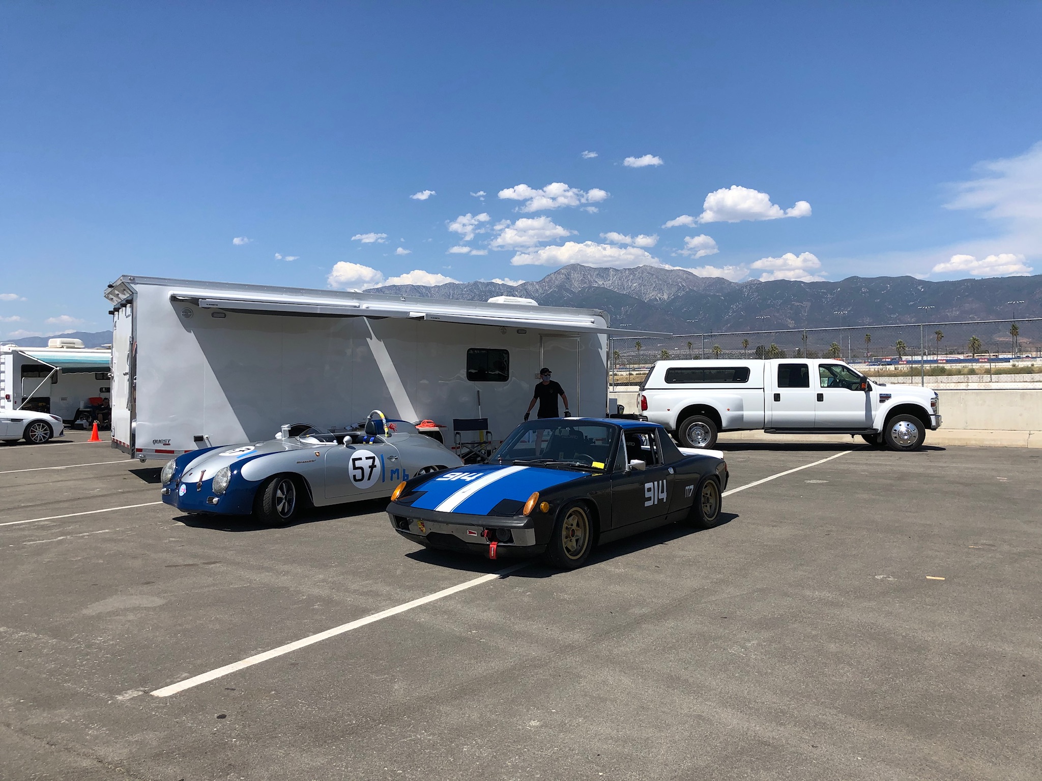

Car ran well in the AM, not so much in the heat, wasn’t too hot but she got harder to start at the end of the day. Sunday morning she fired up Like nothing was ever wrong...
Ready for the AM
Kills bugs, not quite as fast as a turbo...

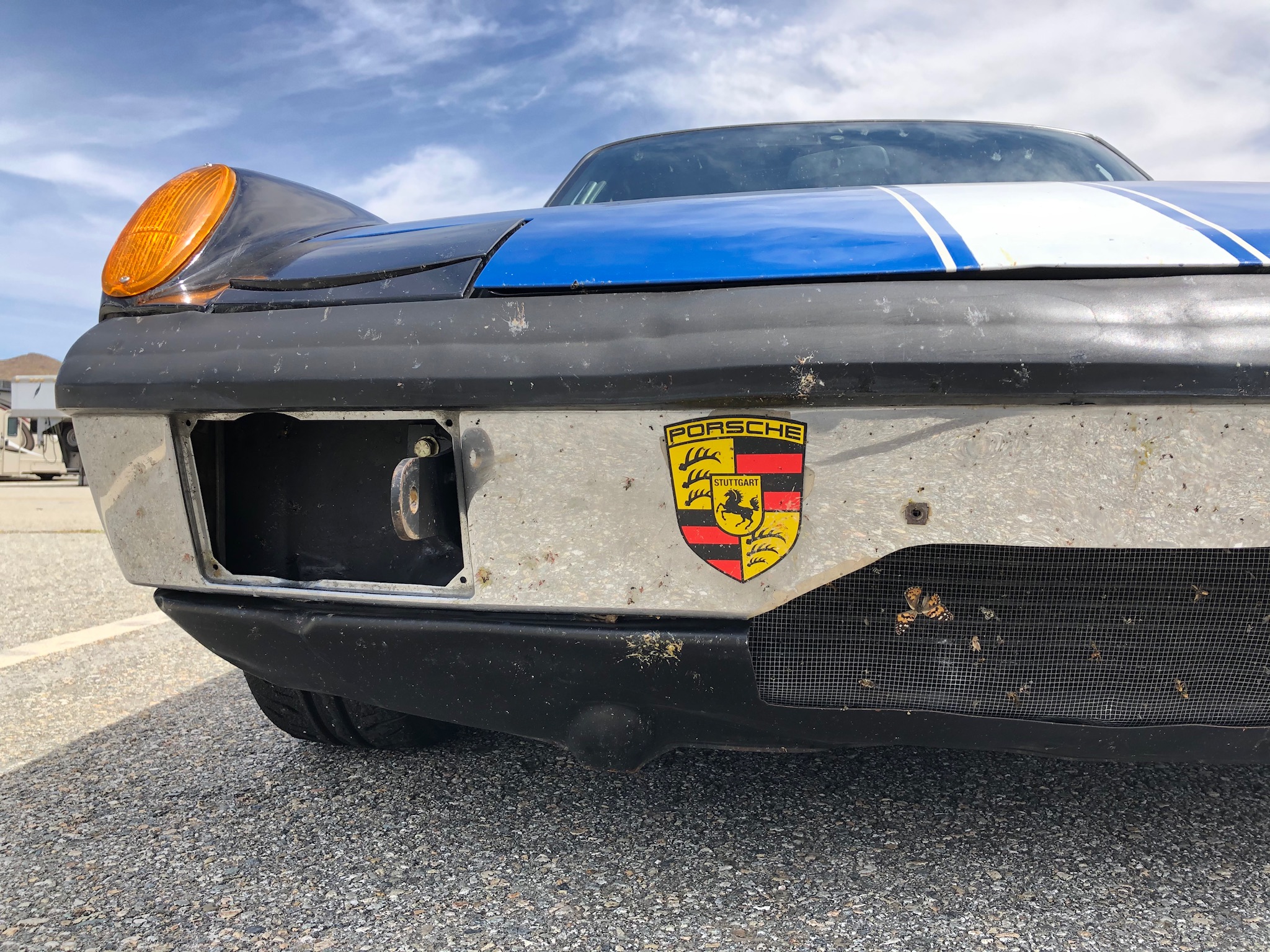

Had 1/2 of a great weekend despite the heat. Was 115 Saturday, car ran warm but well. By Sunday, she only made it out one session before electronics succumbed to the heat. New lightweight battery, here we come! I was able to drag a friend out, he showed most of us up on his potent ‘57 speedster.

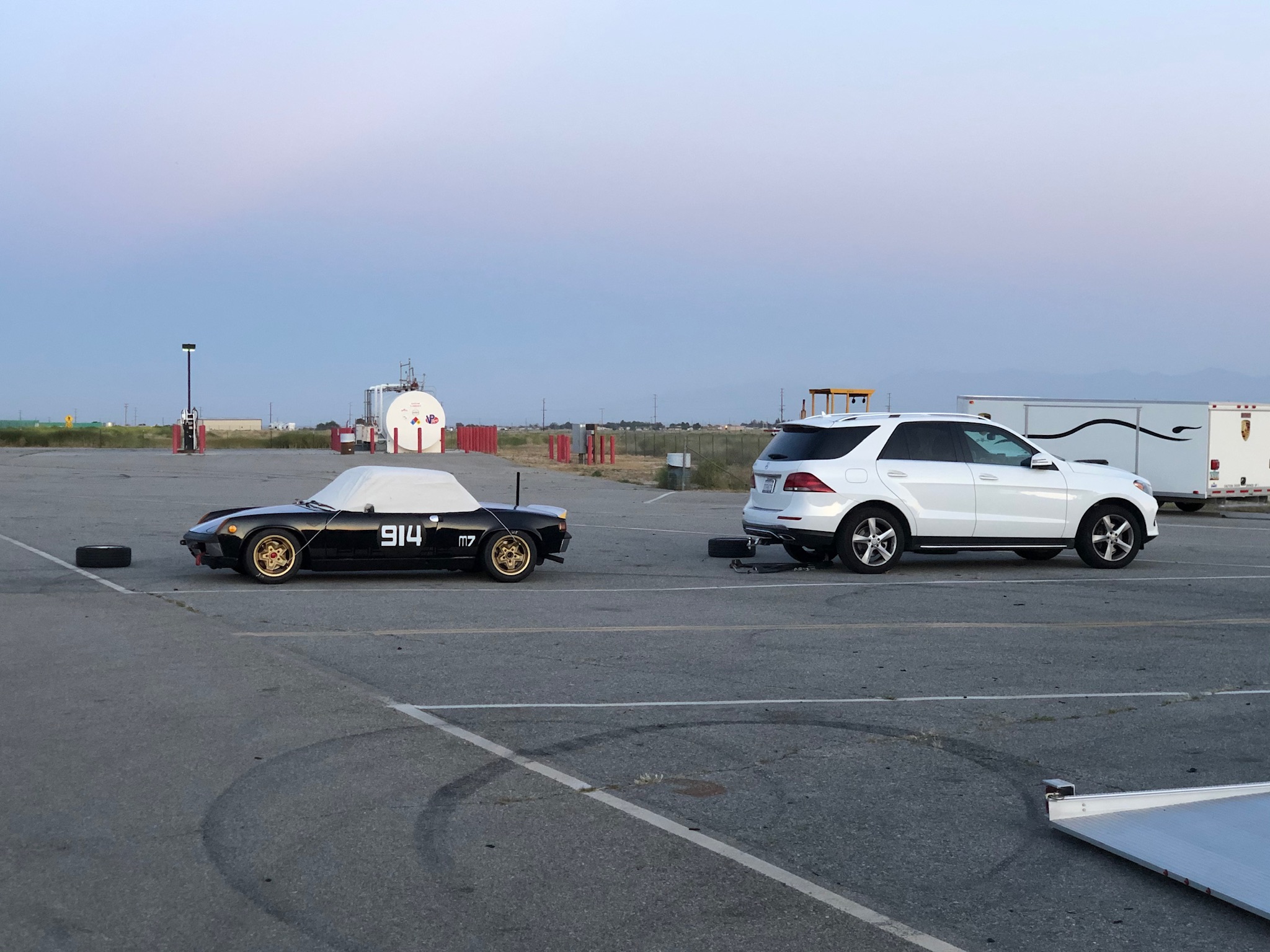

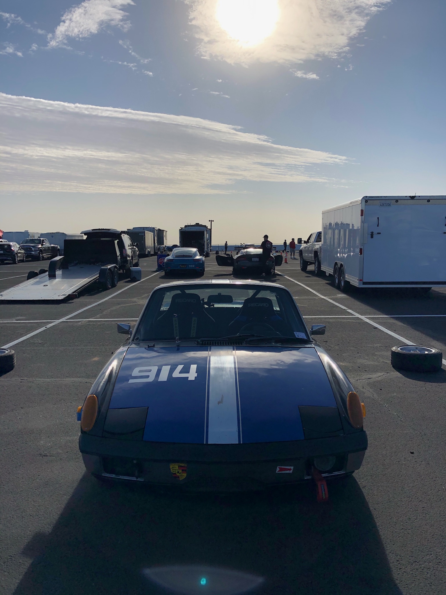

Skipped the race in Pahrump... onto Chuckwalla!
Beautiful start to the weekend.
Car was ready to go,
Day one, a bit disappointing in my afternoon sessions, off 5 Sec from morning sessions???

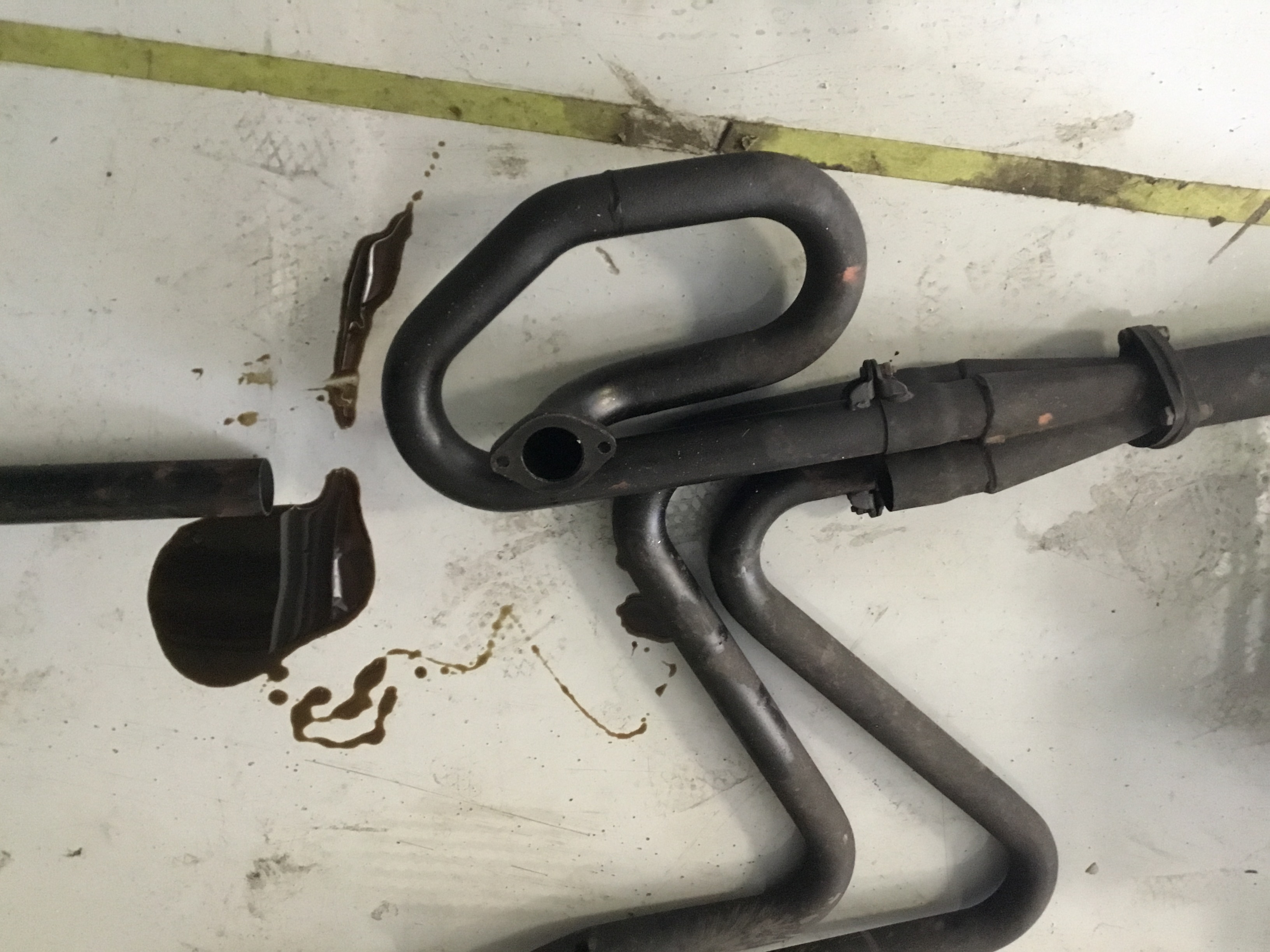

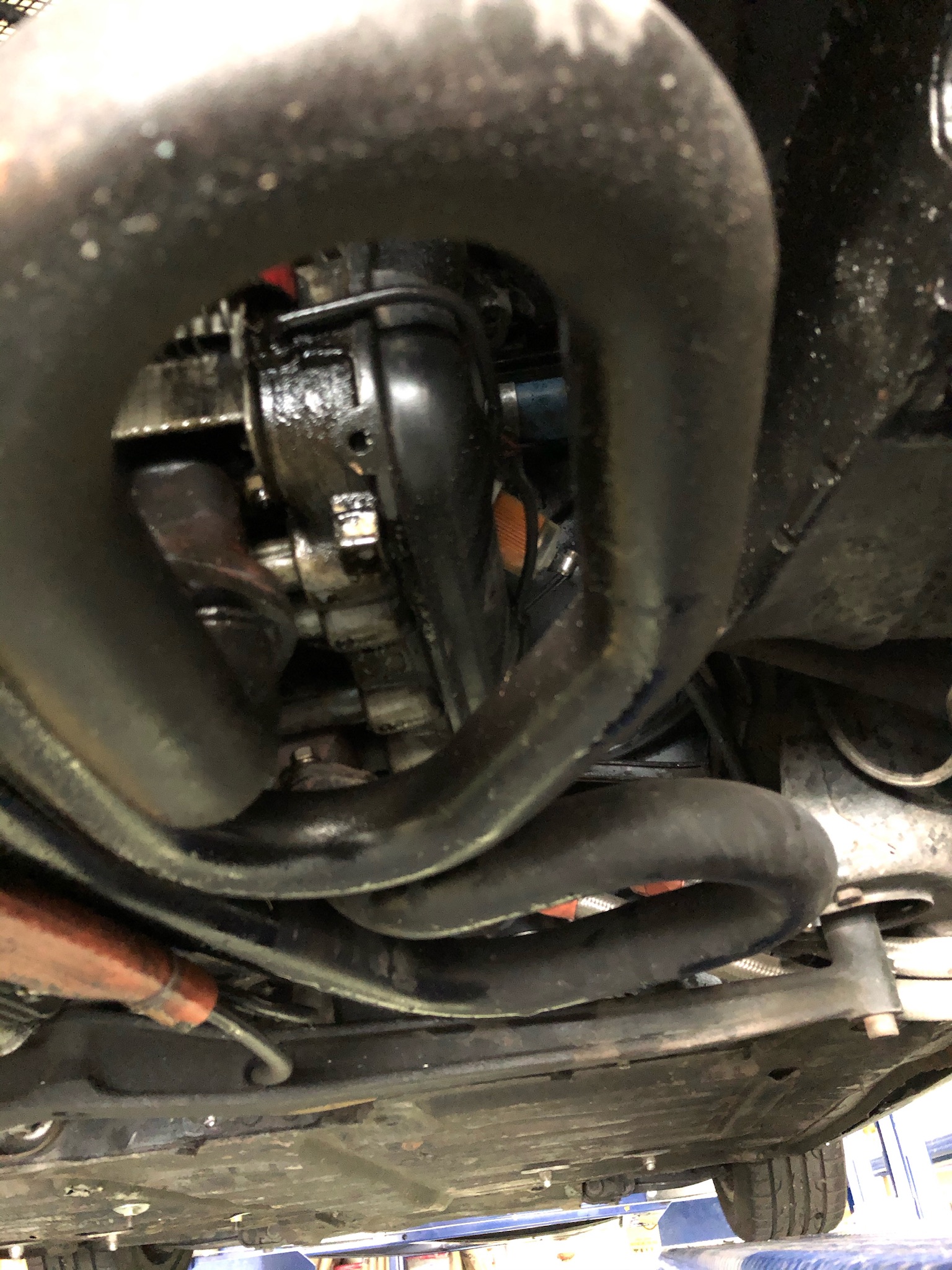

Kablooey! Looks like I’m in the market for a new engine... should I convert to a 6?

What are we looking at? What went kablooey?
The Type 4 oil pickup system is poor, and really sucks (actually, fails to suck) once you start putting some hard g-loading on it. Dry sump is really the way to go, and it's not very expensive or difficult.
If money is no object, go /6, you can build a monster engine with tons of power*. But if you have budget constraints then you can still make as good or more power from a /4 for the same amount of money.
GA
*But be careful: more power = more speed = I need bigger brakes = I need better suspension = I need more tires = I need more wheels = I need more fenders = I need more safety = I need big rollcage = I need less weight = I need to cut away panels = I need to fab more cage = divorce = how in the hell did I get here...?

Go 2270 or 2316 (96mmx80mm stroker) for about 1/5 the price of /6 conversion. For another $2000 or so do a dry sump and you're more agile than a /6 anyway...

QUOTE(GregAmy @ Nov 10 2020, 05:50 AM) *
I know, I’m going through that now. When I got the rear end repaired I had the bodyshop do some work on the hack job baseball bat rear flares. He did such a nice job I don’t want to go down the gt flare route with this car. I did make sure we could fit a 225 with a 3/4 in spacer though...
The pic is of all the oil coming from the top of the passenger side heads. The more I think about it, it could have been a high oil pressure issue. I had just made a mental note that the pressures seemed high just over 70psi about 30 seconds before the “pop”.
I need to drop the engine since the Fat shroud is covering everything topside. Speaking of Fat, I dropped by their shop to discuss a rebuild - yes I know their history, but I’m looking for a shop to assess the parts I have, if they’re any good anymore, most came from Fat or Scat...

QUOTE(infraredcalvin @ Nov 10 2020, 10:53 PM) *
You sure it's not just a popped breather hose? I've had two instances of valve cover hoses separating from the heads on the track...and it made a mess of the track both times. To resolve this at Lime Rock '19 I had to kinda-flare the aluminum fitting with a taper, glue on the hose to the fitting with adhesive, then drill a hole through the hose, clamp, and fitting and run a cotter pin across them then goop it up with silicon. Worked like champ for the weekend.
Next pair of valve covers will use TIG'd on AN fittings with screw-on hoses. That ain't coming off.

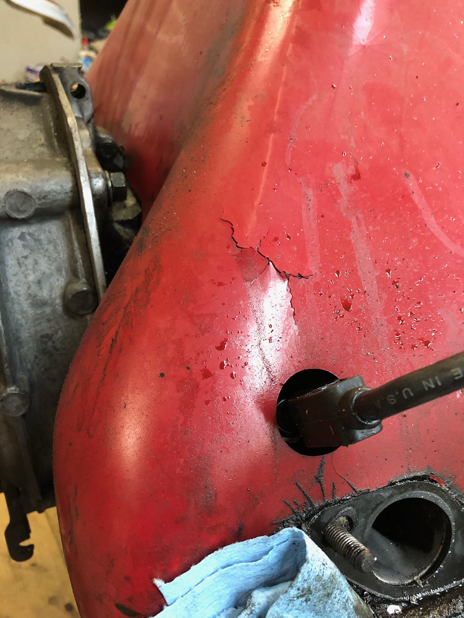

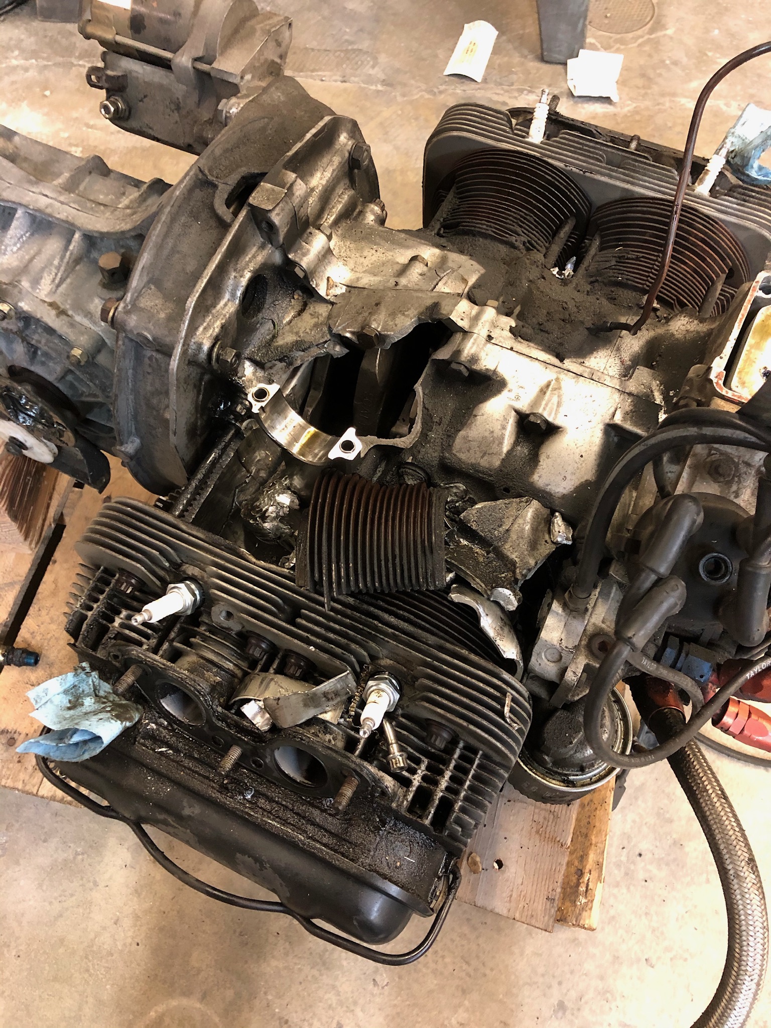

Well, no such luck on the damage. I dropped the motor and the more I dug into it, the more I realized it was not going to be good...
First, there was a about half a quart of oil in my header...
Then I dropped the engine and noticed the crack in the shroud from an impact coming from the inside...
Then all the metal falling out as I took the shroud off...
Looks like I lost an exhaust valve, then all hell broke loose...
Hmmm decisions....

those "windows" in the case are a clear sign of the rod needing more space

Ooooowww....
"So what happened?"
"Cooling system issue."
"Oh?"
"Yeah, a rod went through the cooling shroud."
