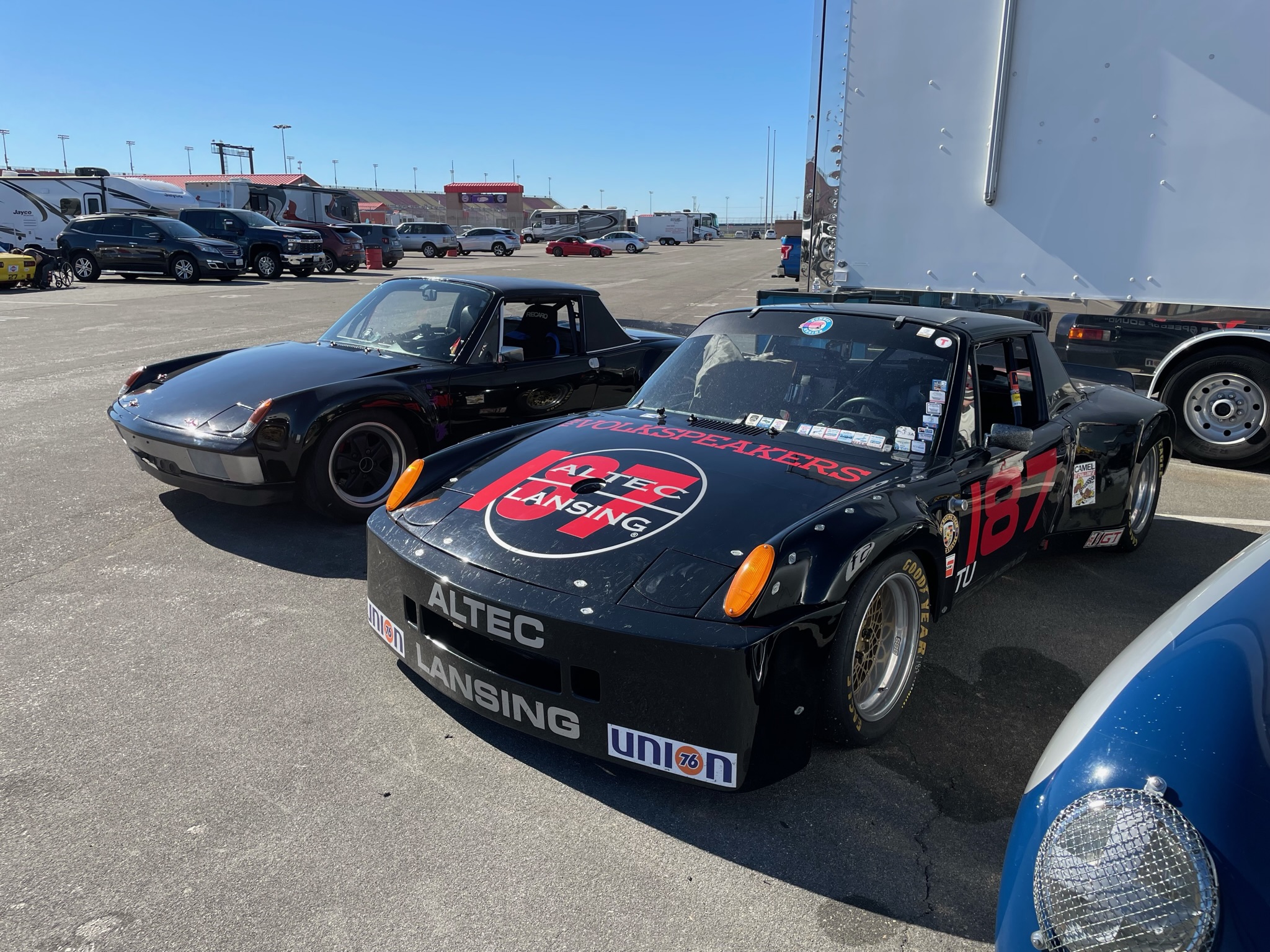

No track time, but spending some time at the track with some heavy hitters.

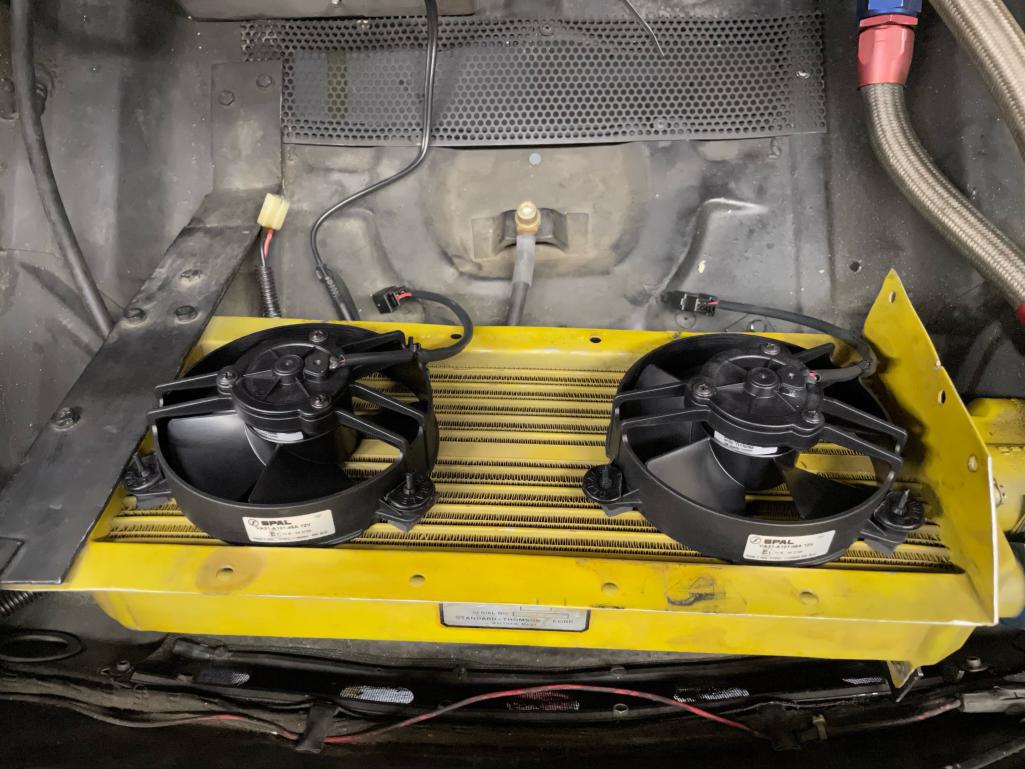

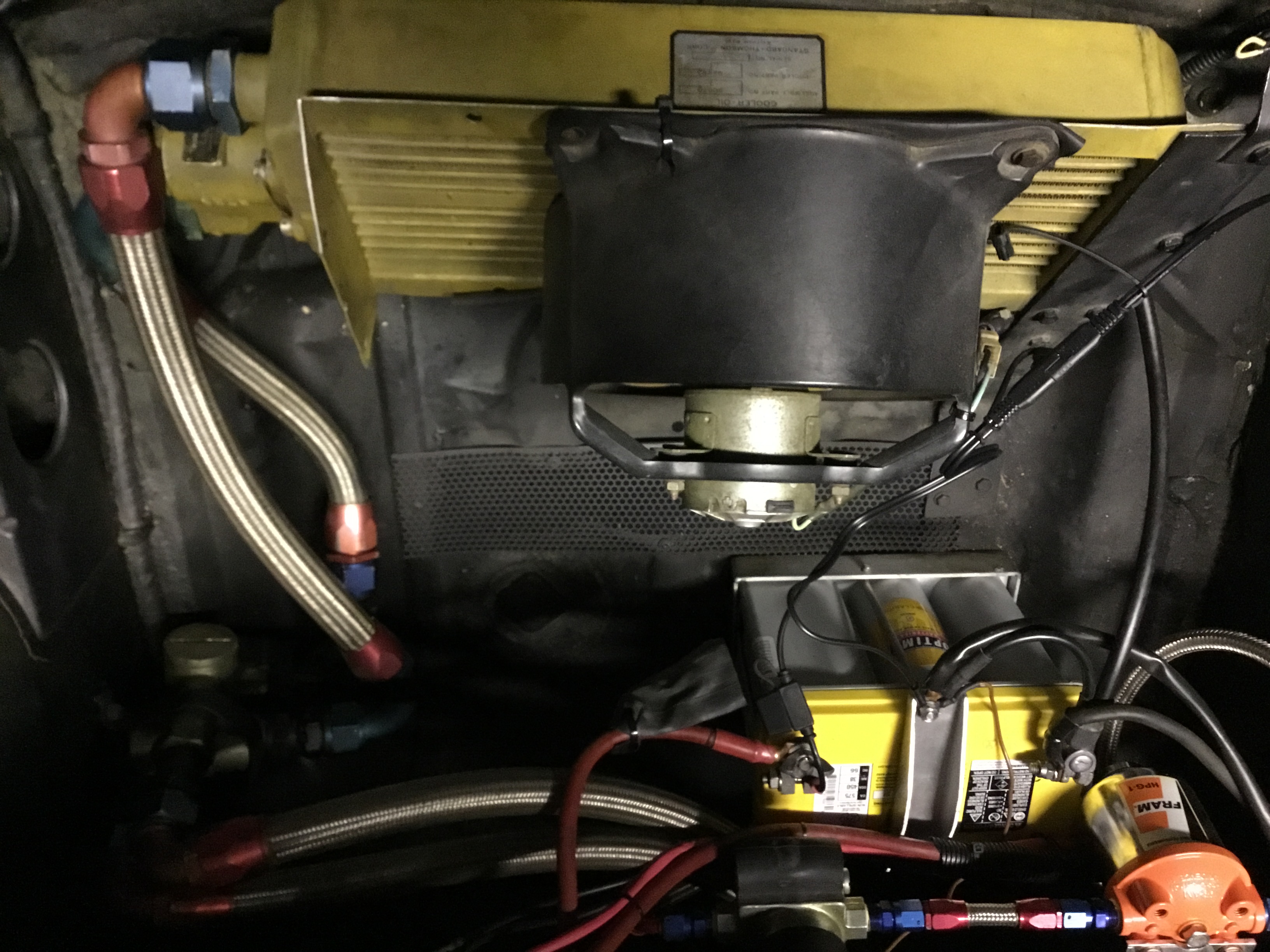

Ugh, long time no post! Cars been running well, I’ve got a few projects ahead of finding my lost hp, one involves finishing the old race car and getting her sold - but that’s for another thread…
Working on a few projects to finally make the new one mine. Last week at Streets of Willow it got well into the mid to high 80s, we also had some long, 40 min sessions with only 20 min downtime between, so she was running a bit warm. The existing fan works well enough to keep her under or at 100 C (212 F) on the street with spirited driving on a 90 deg day. But with no shroud, and this ridiculous fan setup, it too much for the track.
The fan looks t be from an old large appliance, but it sits on the edge of the cooler, with about .5 to .75 inch gap between the cooler and the edges of the fan housing. It’s also larger than the surface area of the cooler.
I feel a couple of flush fitting spal 5.2 in fans would work and look much better. And with each pulling 342 cfm, I should get plenty of air sucked through the fan vs around it.

Old one out, two new ones in.
Just need to make and install a pigtail. The PO had wired the old fan to the rear defrost switch, no reason to change at this point.
Much cleaner (and lighter) set. Next comes shrouding….

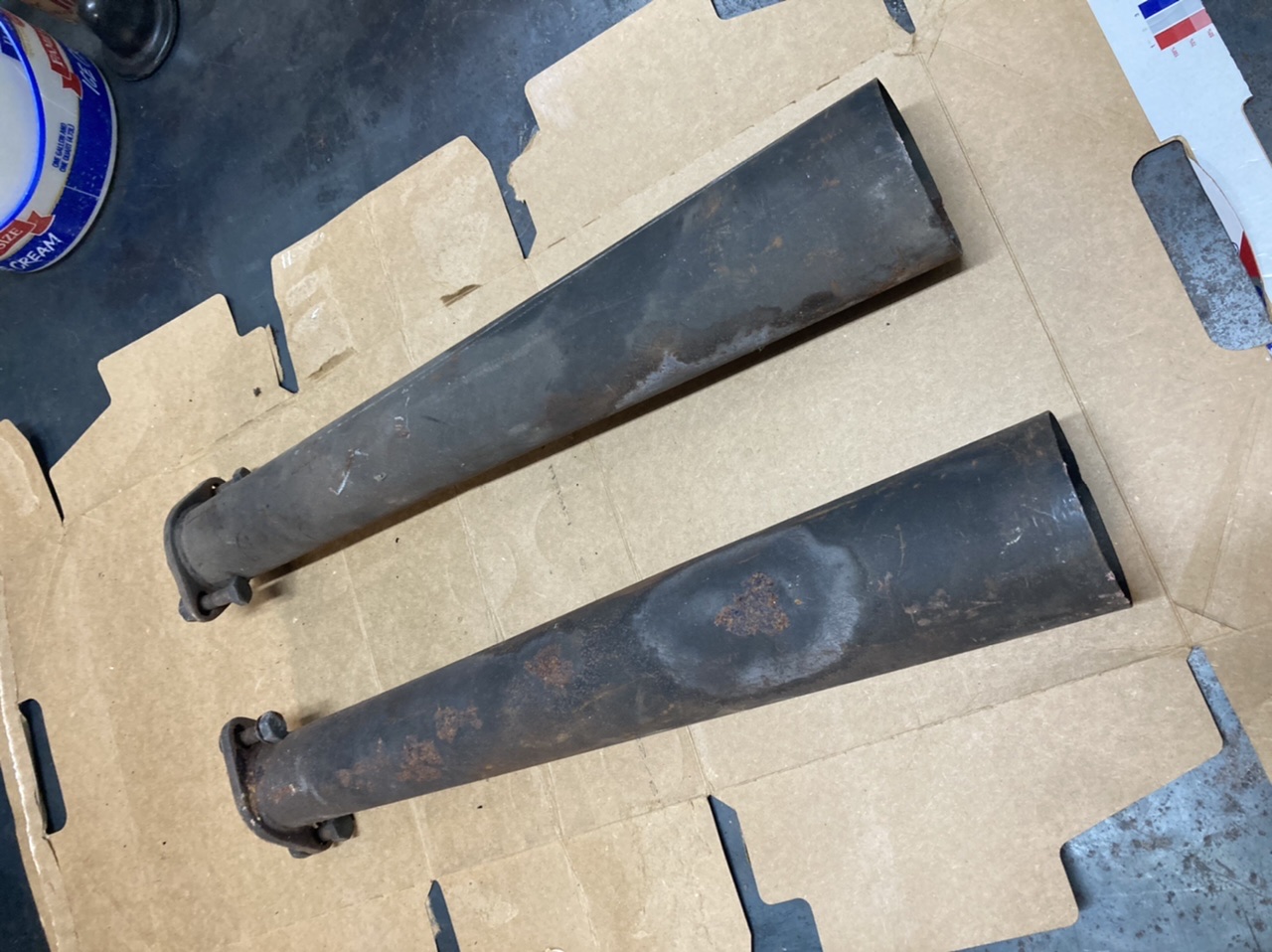

Also going to try no muffler. See if I feel any gains without. Pipes are about 10-12” short of the rear fascia, anyone see any problems with just running open vs getting some trumpets to extend beyond the fascia?

It's best to get a pair of trumpets. Without them you'd lose out on the scavenge effect of having a tailpipe after the collectors. Might even be worse than the muffler ...
18" is a good compromise length for the straight pipes.

The motors really like a cross over for torque
I Dyno’’d straight open pipes back to back with my current system and gained 14 ft lbs when the banks came together
Not sure you could see the difference without using a dyno
Seat of the pants…. Your brain will hear the noise difference, but only a dyno will measure it

True about the crossover. it can be a connecting pipe, or the merged, center exit GT3 style that everyone likes now. Or just bolt on the pipes to enjoy the noise (IMG:style_emoticons/default/smile.gif)
One other thing, open exhaust usually requires a small jet change to account for the freer flow. It's usually enough to keep it simple and just increase main jets 1-2 sizes.

QUOTE(stownsen914 @ Sep 27 2022, 08:10 AM) *
Thanks for the confirmation on jets, I was ready for that. Was hoping to test out on the track, but without trumpets doesn’t sound too smart so I’ll wait…

Member No.: 47
I’ve got a pair of mega phones I need to sell soon

OH and before i forget again, what's the opening at the flange side measure?
