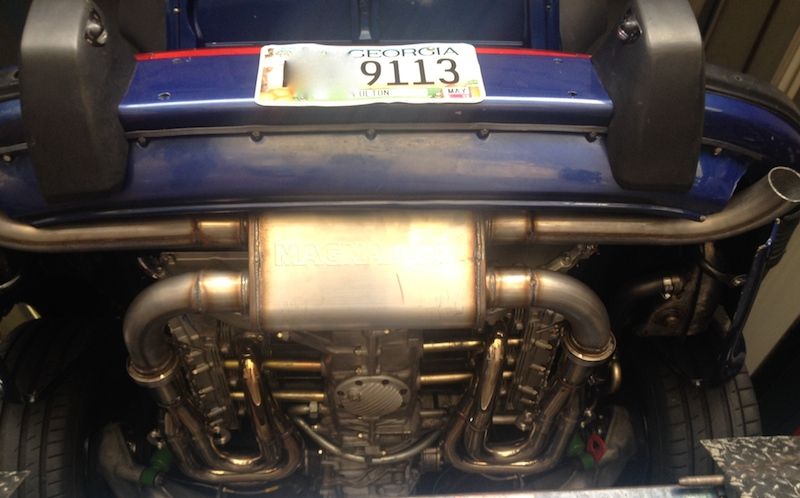

I have not heard of anything outperforming the magnaflow 2in / 2 out muffler. Came recommended from knight racing. I tried Ben's sport muffler for looks and it clearly lost some power, so eventually I put the magnaflow back on. I think it gave me 20hp.
A pic I have handy from a 911. This 3.2 car made 253hp at the wheels and it only had DC40 cams.
I drove a high compression 3.0 car once with dual supertrapps. It was quick but not as fast as I would have thought, I think the supertraps slowed it down. I have heard of straight up mega phones ripping for power though.

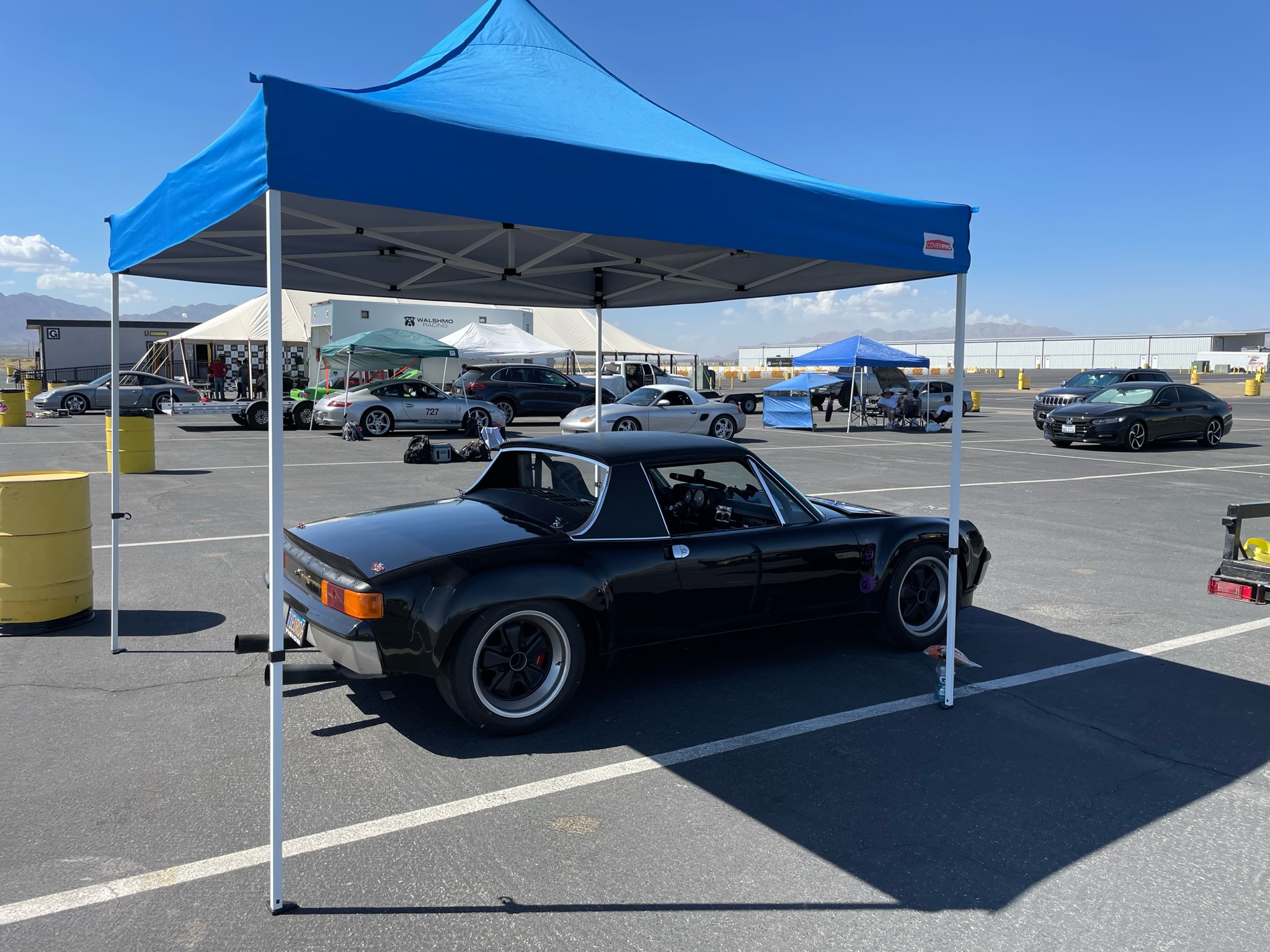

Finally got on the road around 1:30ish, made it to the track by 5:30. This is a pic from Friday, but it shows Brant’s megaphones on the car…

For the most part, car ran well. I started with putting 101 race gas in the tank and ran my first session with an eye on the afr gauge. At wot i kept seeing lean spikes into the 17/18s, after a few laps I brought her in for a main jet change.
46s we’re running 150 main jests, so I bumped up to 170s. I noticed a low rpm bog, but mid to high rpm were right on the 12s. So instead of fussing all day, I left it and ran it.
She ran nice and smooth all day, in the 100+ deg heat on track without a hitch until my 2nd to last session of the day. The low idle bog got worse, it seemed to drift into the low to mid rpm range. I checked fuel pressure and noticed I was only getting 1.5 psi, so I turned it up and got in a solid last few sessions. When I got back to the pits after my last run she was running funny, my fuel pressure was way back up. Adjusted back down to 3.5 and loaded her on the trailer for the ride home.

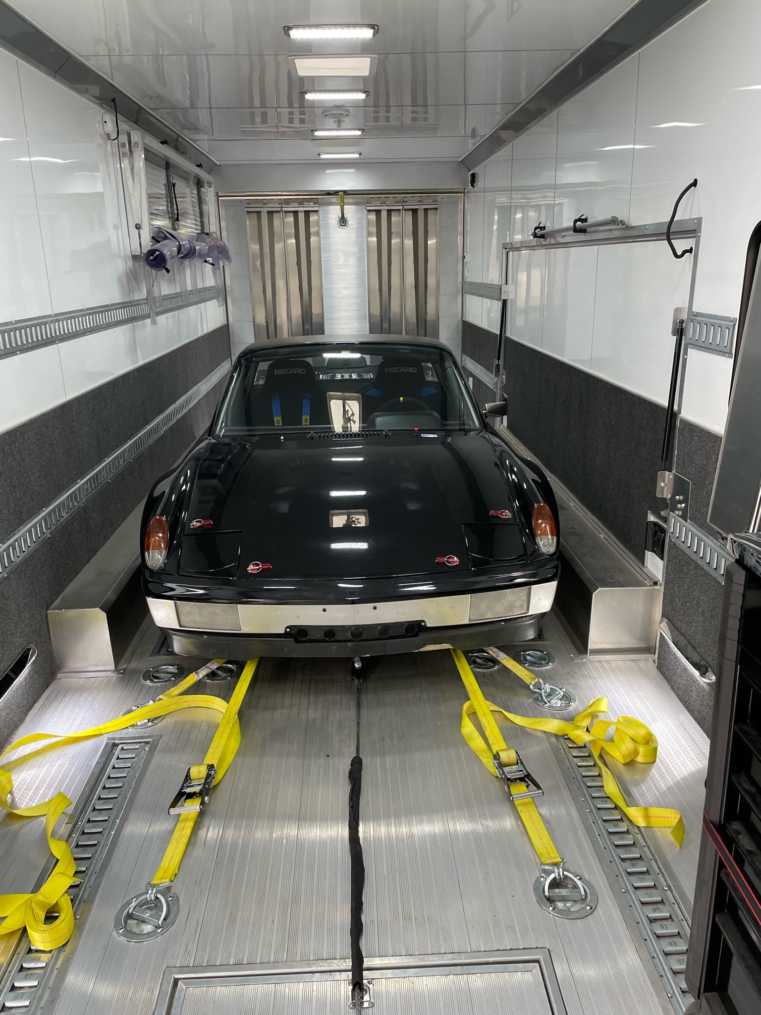

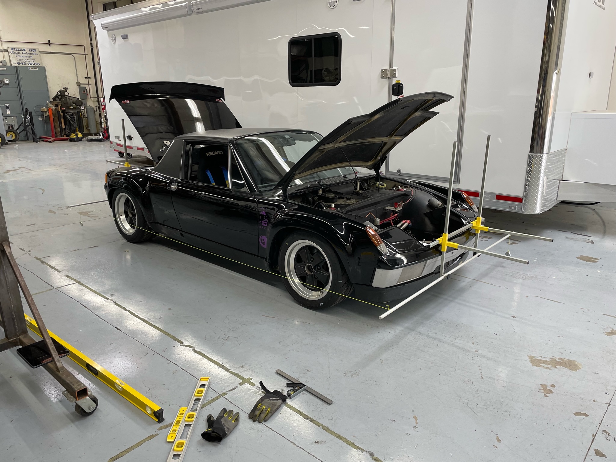

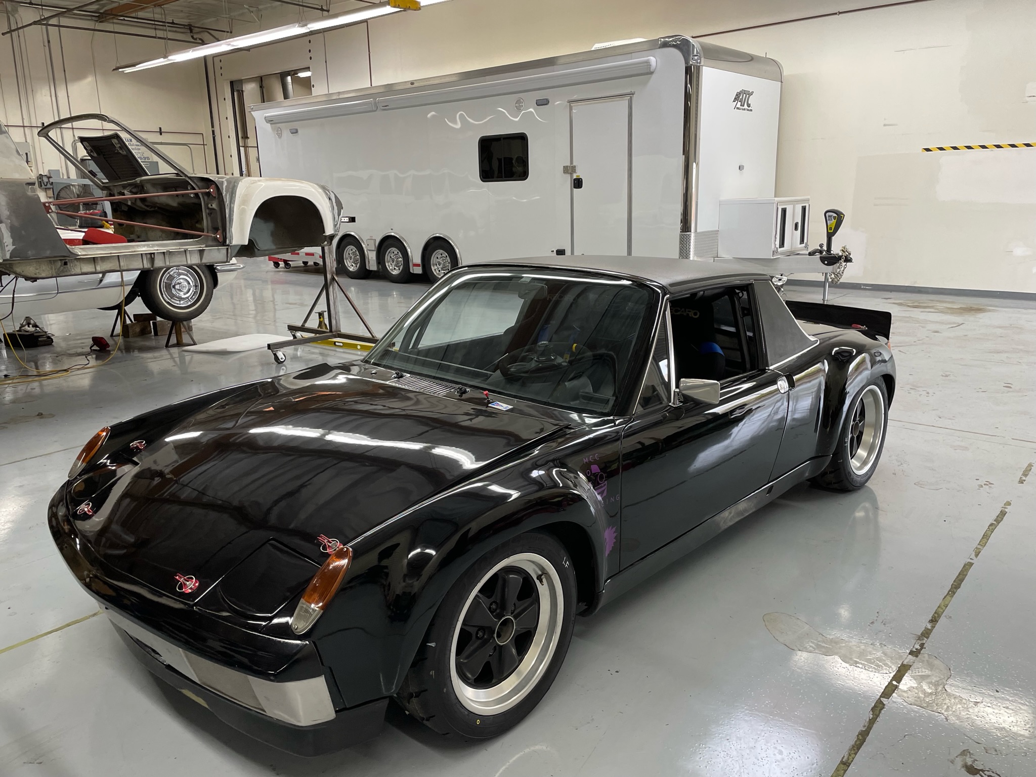

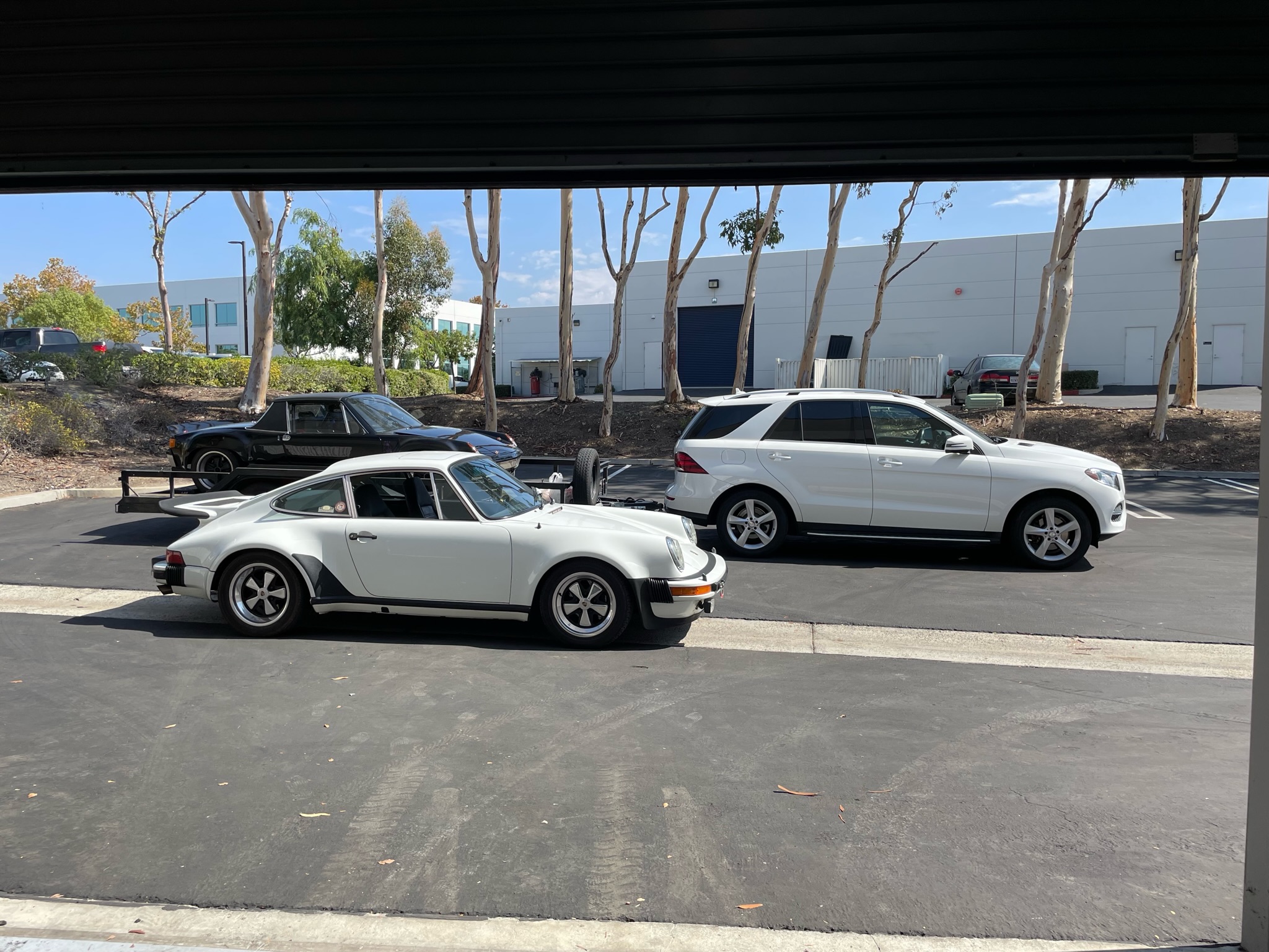

Finally, first track day of the year this week! My friend got a provisional membership at The Thermal Club down past Palm Springs. We have a little vintage group heading out there Wed to run the track for the day Thursday. Finally got some new tires, R888Rs for the old girl. I was burning up 10 year old R888s I’m assuming were cycled out. I’m really curious to feel the difference. Did a quick alignment, wanted to bring the front toe out a hair more, I was previously running almost neutral.
infraredcalvin
post Mar 21 2023, 07:32 AM
Post #239
Distracted Member
Posts: 1,737
Joined: 25-August 08
From: Ladera Ranch, CA
Member No.: 9,463
She’s ready to go!
Locked and loaded!
