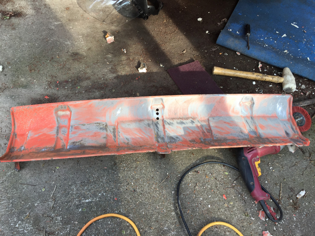

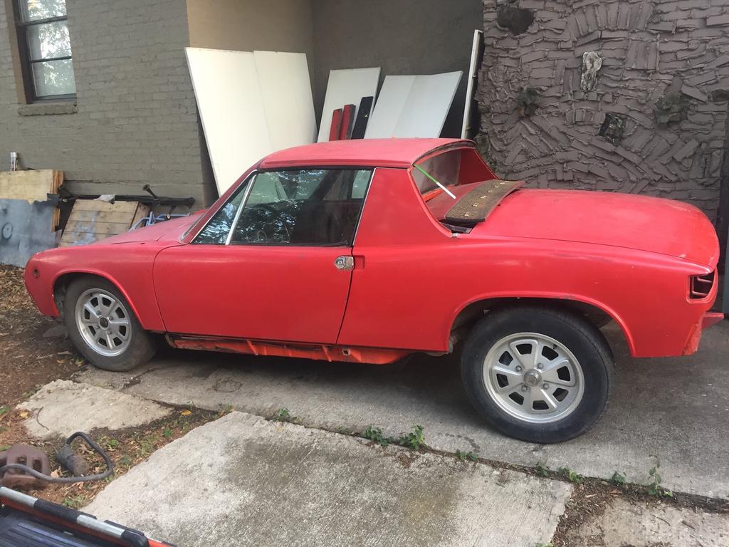

I've been putting this off, but I guess I should document the restoration build for my latest 914. I finally got the car on my property and even though there no garage (YET) I can go ahead and get some things started. This will be my 3rd 914 and it'll be a bit of a second chance for this car, as it has a front end section that's been grafted on (by PO) because of a previous accident - not to mention the rusted away hell-hole and holes in the floor. The graft actually looks pretty well done and solid, and the other items will be addressed. The car came with it's original engine - a 1.7 that's freshly rebuilt with zero miles on the rebuild (uninstalled). I've also got a 2056cc 'GA' motor that'll probably end up in this car.
The car was originally L21E Tangerine and someone's gone over it with a real crappy red paint. Since my last 914(/6) was L21E Tangerine.. I'm going to paint this one something else, and will be doing all bodywork and paint myself.
This "restoration" will be considered a driver quality effort.. but I don't plan on cutting too many corners either. I plan to do a quality job but it won't be going across the block at Christies either. Lots of parts have already been sourced, but there's always more, right! Here's the BEFORE shots:
(IMG:http://www.914world.com/bbs2/uploads_offsite/i.postimg.cc-7222-1571968560.1.jpg)

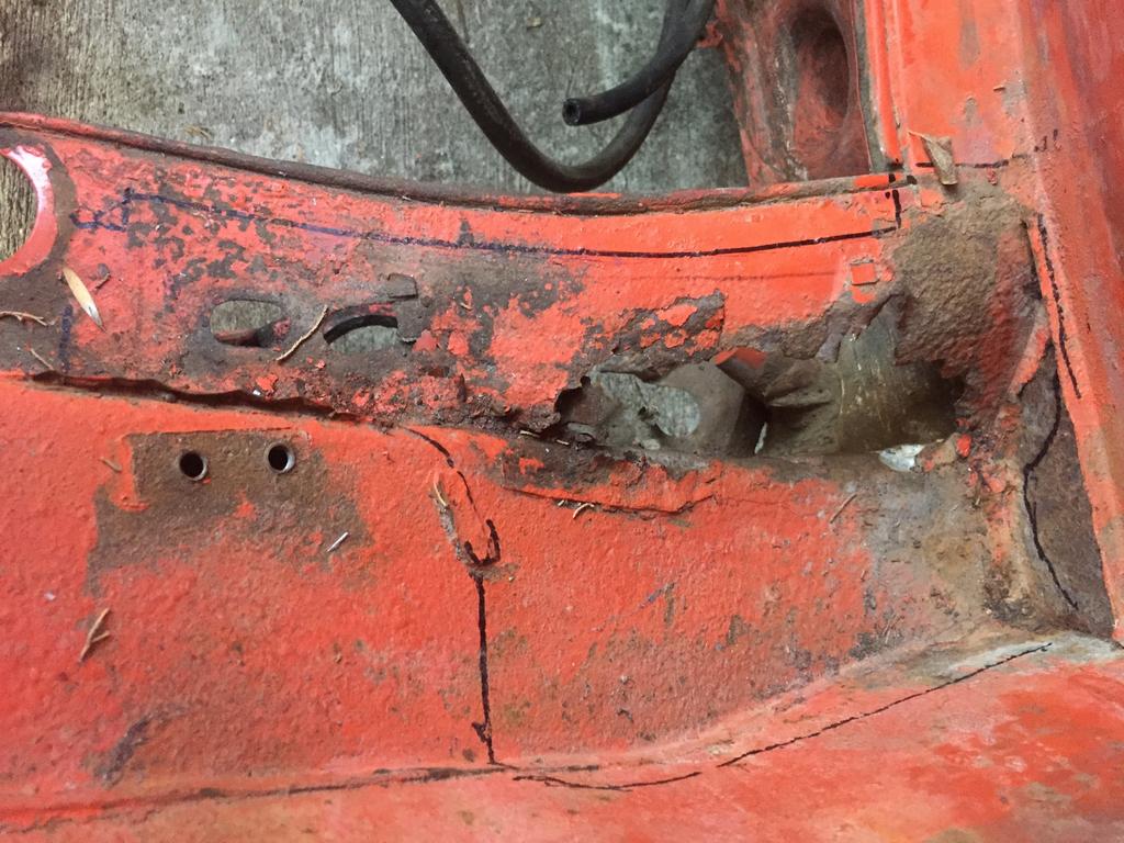

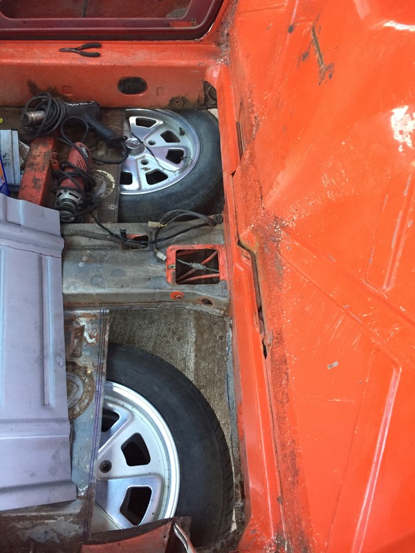

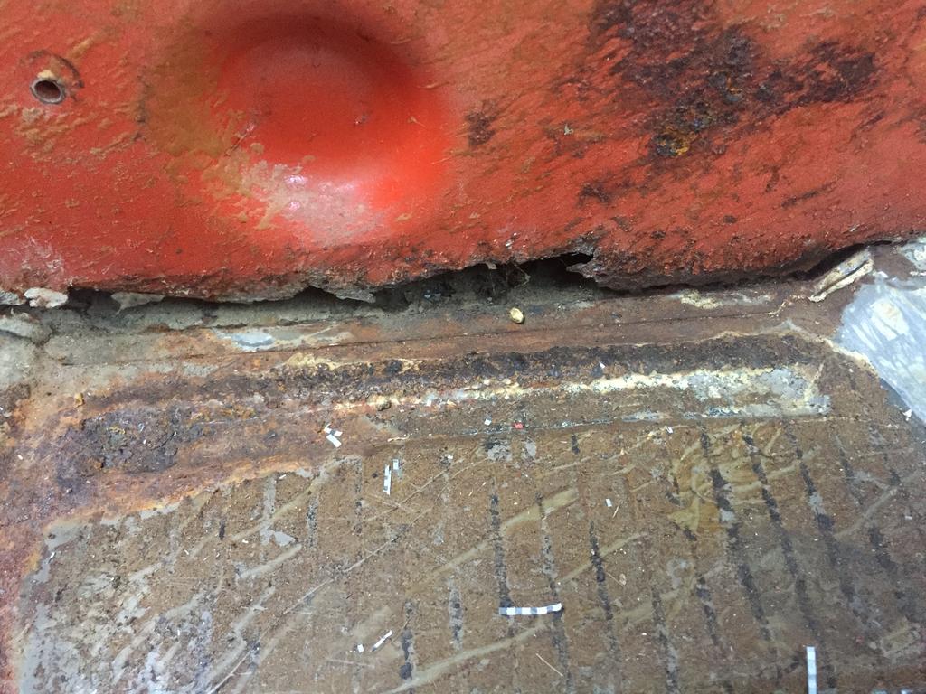

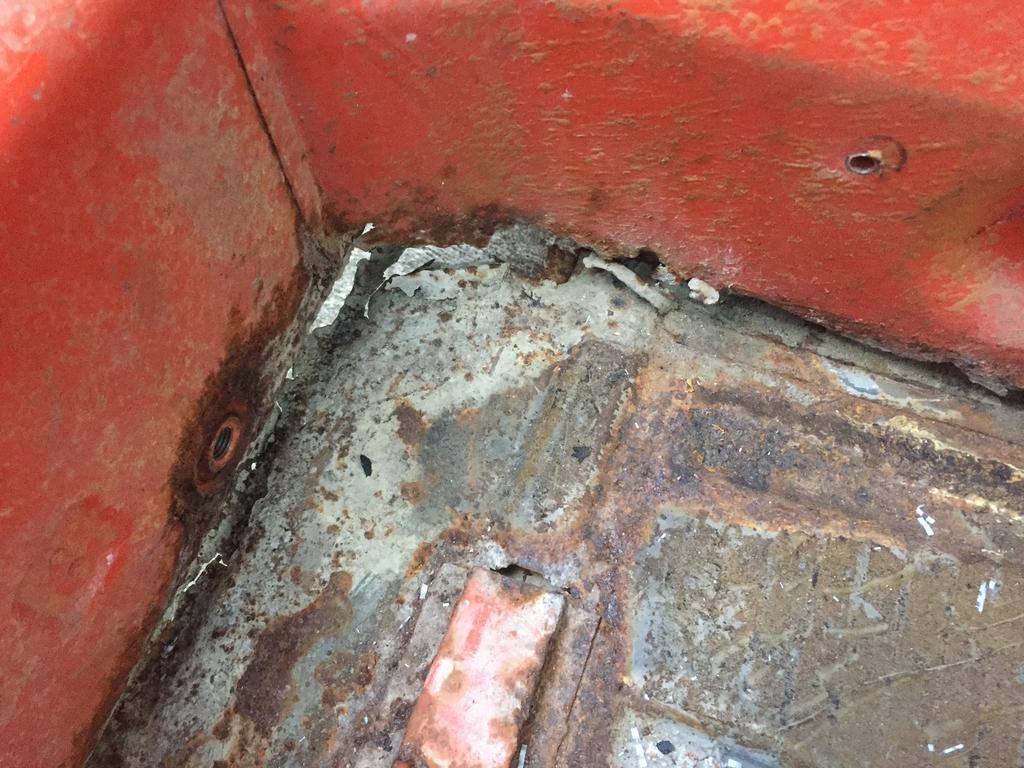

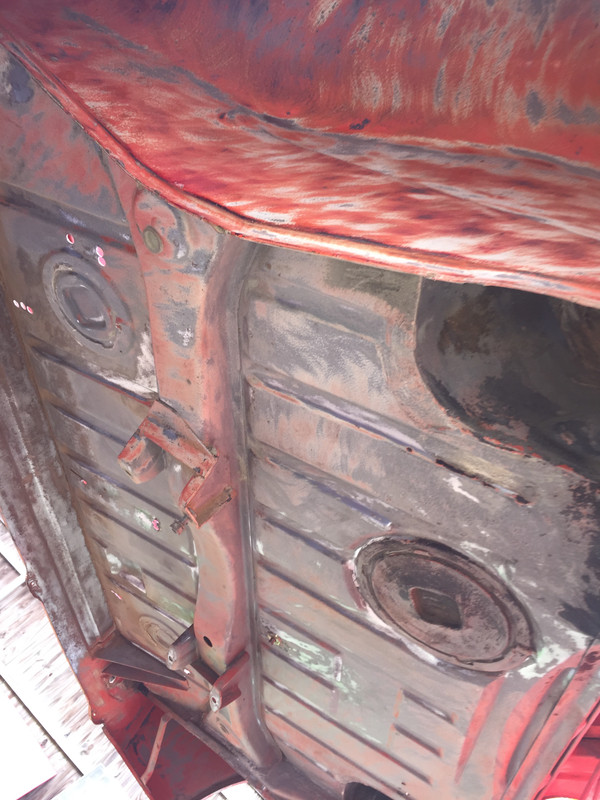

UGLY FLOORS:
(IMG:http://www.914world.com/bbs2/uploads_offsite/i.postimg.cc-7222-1571969093.1.jpg)
(IMG:http://www.914world.com/bbs2/uploads_offsite/i.postimg.cc-7222-1571969094.2.jpg)direct link upload images
(IMG:http://www.914world.com/bbs2/uploads_offsite/i.postimg.cc-7222-1571969094.3.jpg)photo upload site

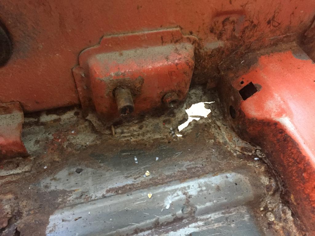

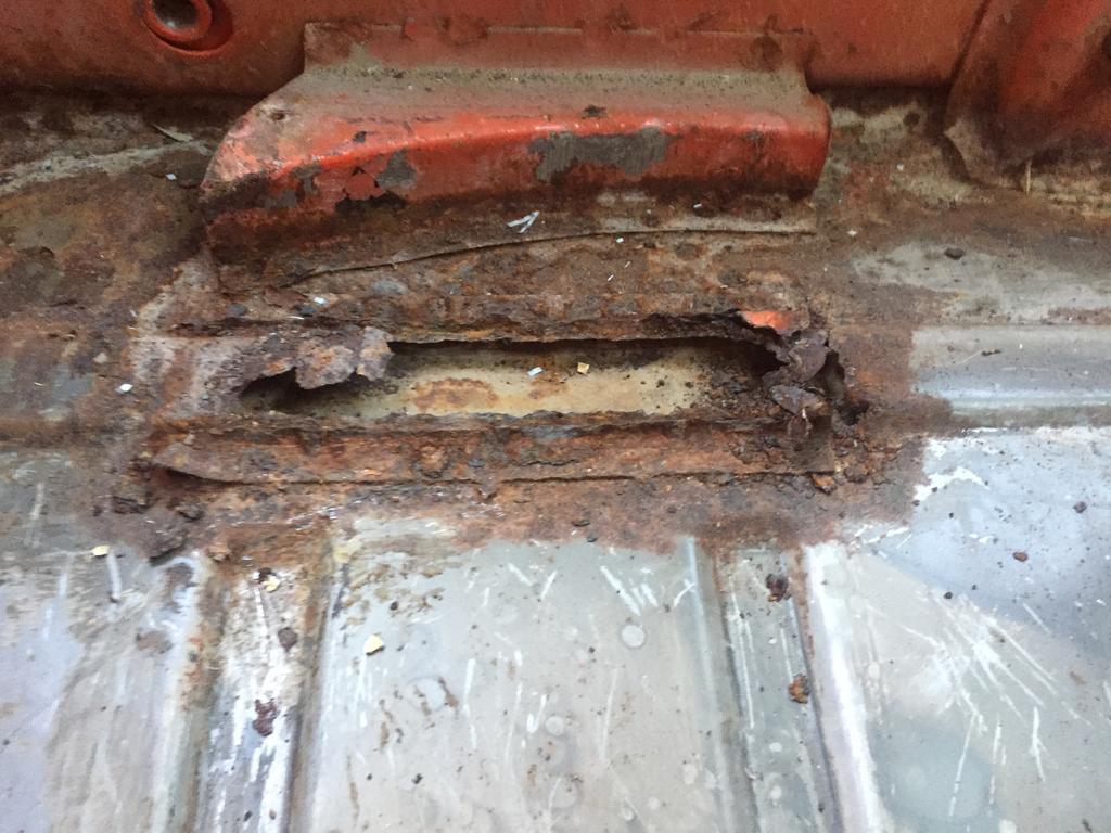

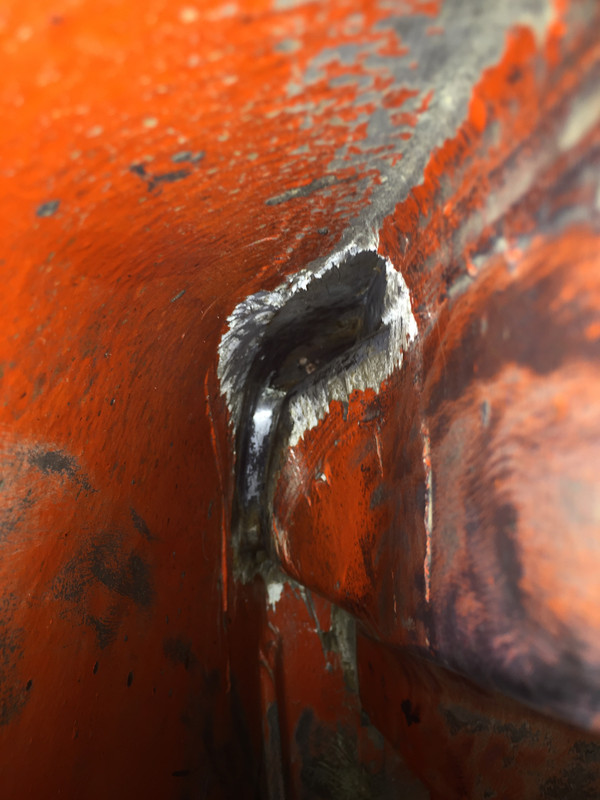

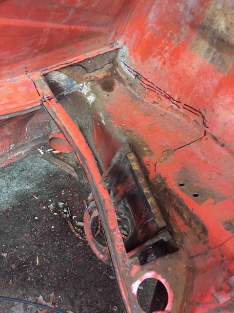

HELL HOLE:
(IMG:http://www.914world.com/bbs2/uploads_offsite/i.postimg.cc-7222-1571969095.6.jpg)

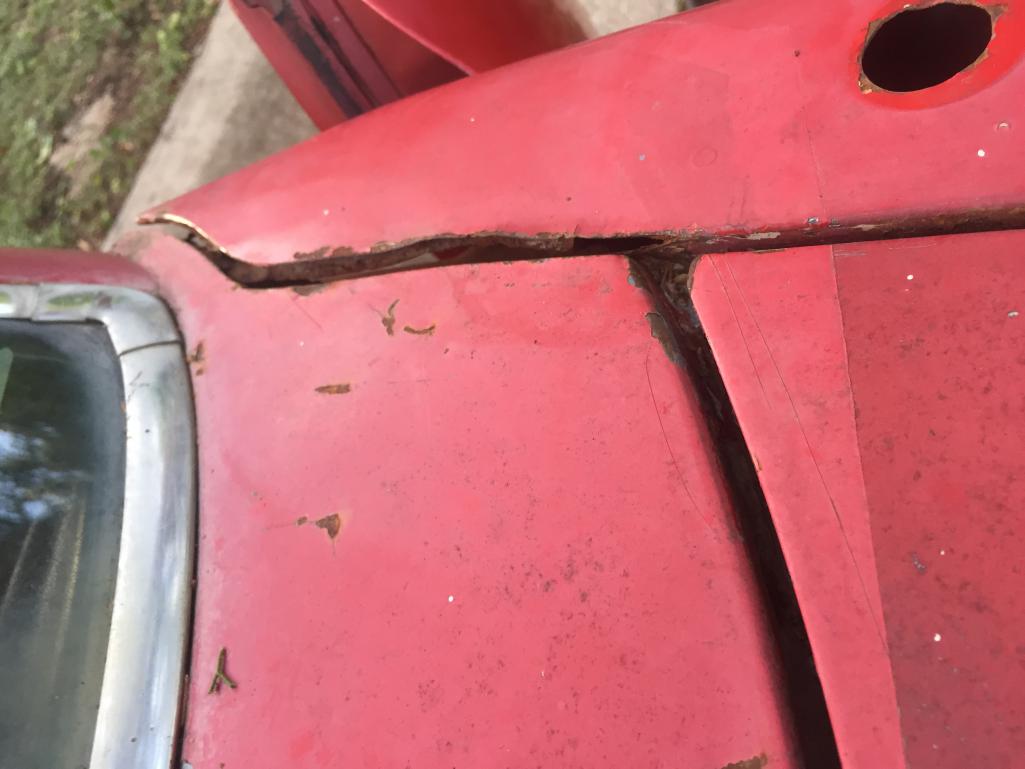

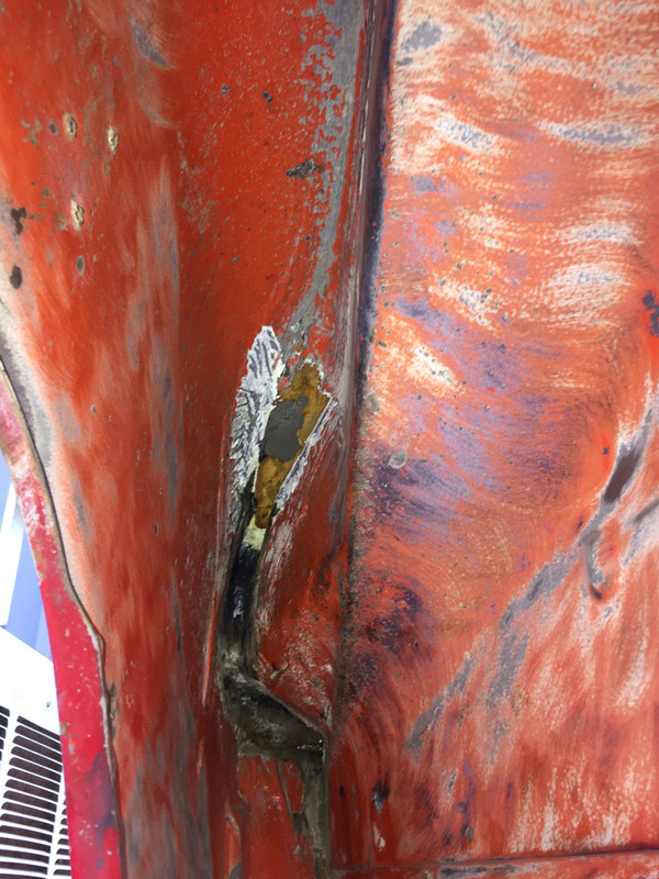

RUSTY FENDER TIPS:(IMG:http://www.914world.com/bbs2/uploads_offsite/i.postimg.cc-7222-1571969095.7.jpg)
(IMG:http://www.914world.com/bbs2/uploads_offsite/i.postimg.cc-7222-1571969096.8.jpg)

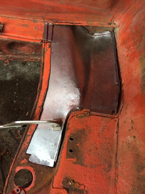

Here's my replacement metal test fit:
(IMG:http://www.914world.com/bbs2/uploads_offsite/i.postimg.cc-7222-1576028058.1.jpg)upload image to url

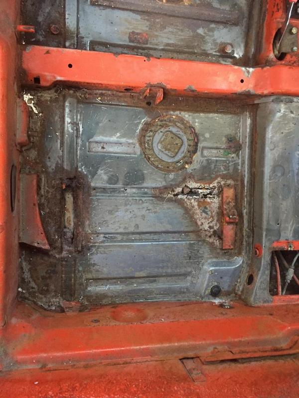

I was able to mess with the 914 a couple days since my last update. I've cut the rusted thru parts of the floors out:
(IMG:http://www.914world.com/bbs2/uploads_offsite/i.postimg.cc-7222-1579932496.1.jpg)
I've got the panels already and picked up some Mig gas for welding, the other day.

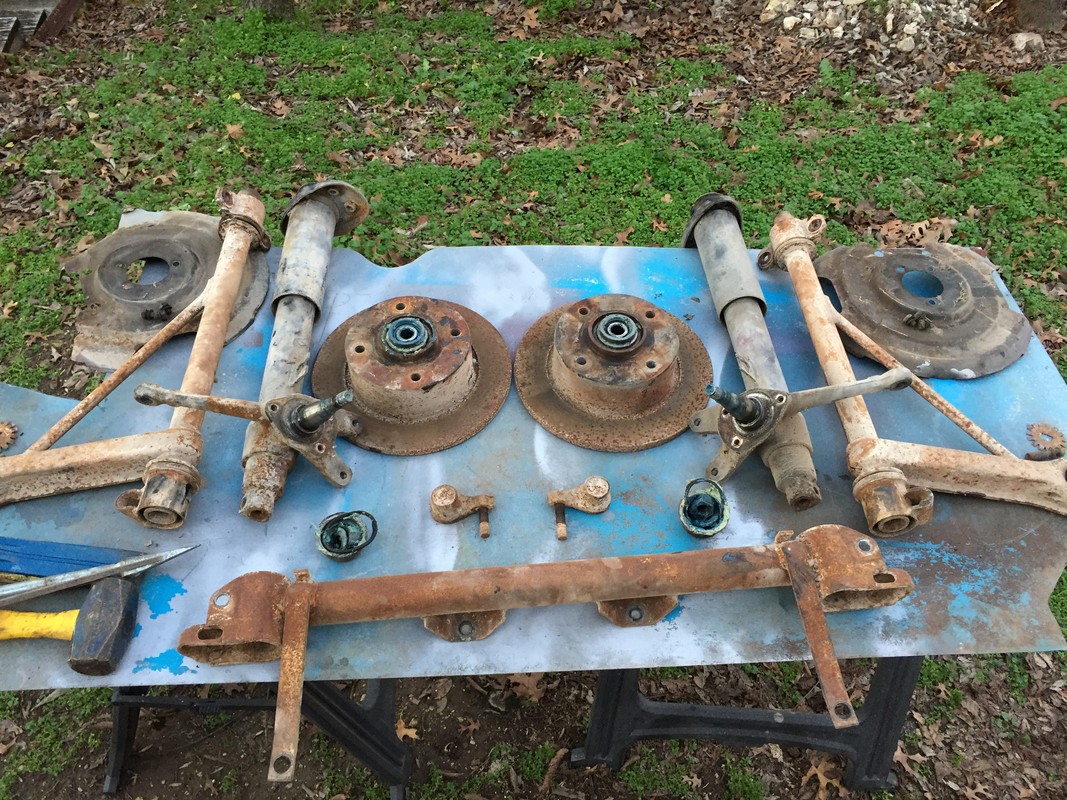

Also, I've removed all of the suspension.. for bushing, bearing, seal replacement - but also for under car clean up and painting. This car will not be on a rotisserie, I plan to wire wheel the entire underside, treat with phosphoric acid, epoxy and paint, or bed liner stuff, or both.

I busted most of the front suspension apart today. Gotta figure out how to get those bushings off the A-arms and the joints out of them too. Couldn't budge the dang set screws in the REAR discs rotors, so I just called it a day (IMG:style_emoticons/default/beer3.gif)

Put a torch on the bushy gs until they smoke and then turn them off with a screwdriver stuck in the hole on the mounting tab.
Heat will loosen the set screw.
It’s worth it to go to your local home store and buy a map torch. Heat makes everything loosen up.

Will do, thanks. What about the ball joint thingy that attaches to the strut - does it take a special tool to remove?

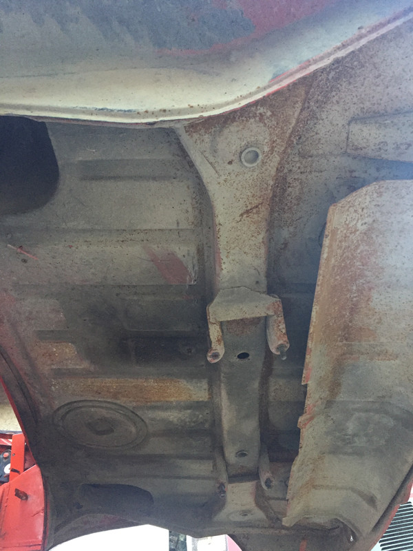

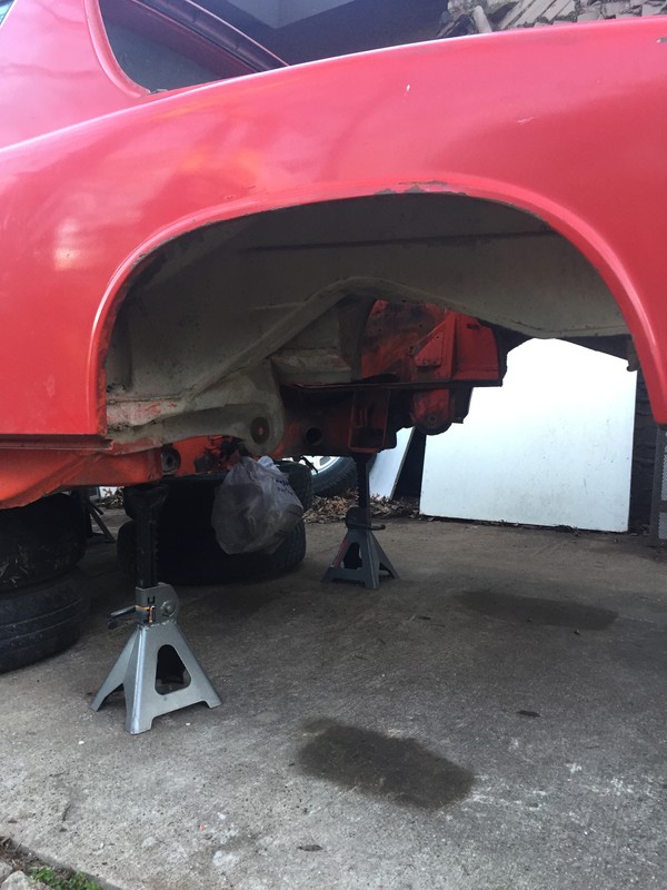

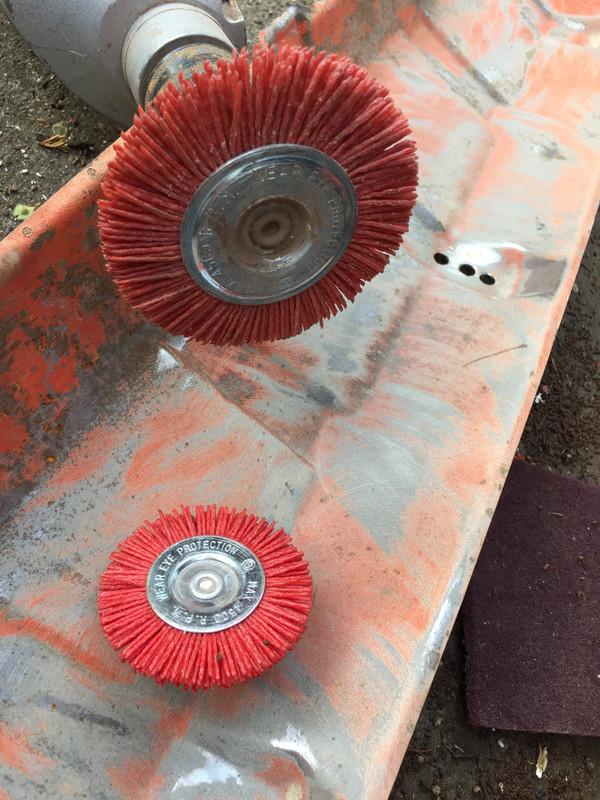

What I've been working at lately is.. getting the area under the rear trunk scrubbed down with a nylon 'wire wheel'. I really like the nylon wheel for this because it lasts forever, stays cool, is cheap and leaves an 80 grit texture which is good for the epoxy primer that'll be coming next (I will not be taking this all the way down to bare metal - not necessary). Here's the nylon wheel: (IMG:http://www.914world.com/bbs2/uploads_offsite/i.postimg.cc-7222-1584670136.1.jpg)
..AND one of the major hurdles has been removing the muffler heat shield (so I could get above it for rust treatment and paint. They'll tell you it's only spot welded in, but mine also had small strips of edge welding - I'll be bolting it back in:(IMG:http://www.914world.com/bbs2/uploads_offsite/i.postimg.cc-7222-1584670137.2.jpg)
..Here's a shot showing under the trunk floor after nylon wheeling it. I'll be scuffing all the nooks and crannies with maroon scotch-brite pads and phosporic acid solution before epoxy primer.
BEFORE: (IMG:http://www.914world.com/bbs2/uploads_offsite/i.postimg.cc-7222-1584670138.3.jpg)
AFTER:(IMG:http://www.914world.com/bbs2/uploads_offsite/i.postimg.cc-7222-1584670138.4.jpg)
Also I've gotten up inside the fenders/wheel wells and removed all of the foam that's known to eventually cause rust. Mine look pretty good at this point. The job sucks but glad I did it, and got it out of the way:
DURING(IMG:http://www.914world.com/bbs2/uploads_offsite/i.postimg.cc-7222-1584670138.5.jpg)
REMOVED:(IMG:http://www.914world.com/bbs2/uploads_offsite/i.postimg.cc-7222-1584670139.6.jpg)

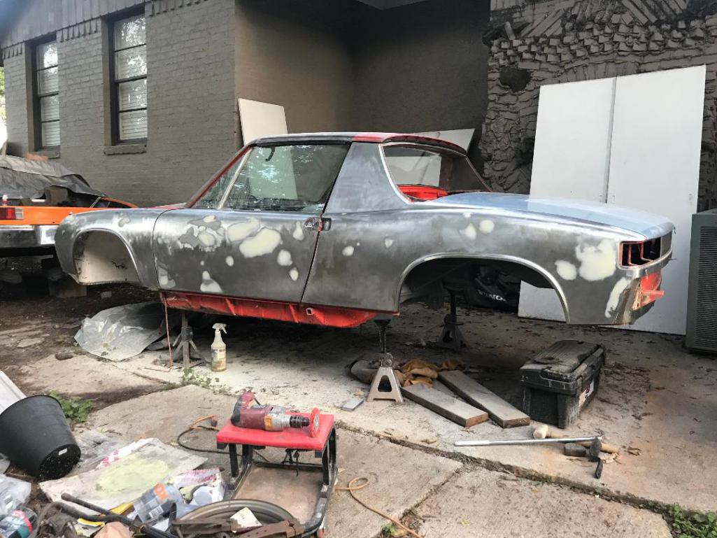

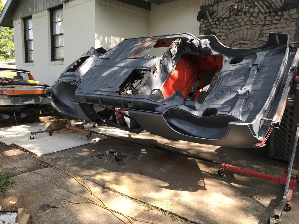

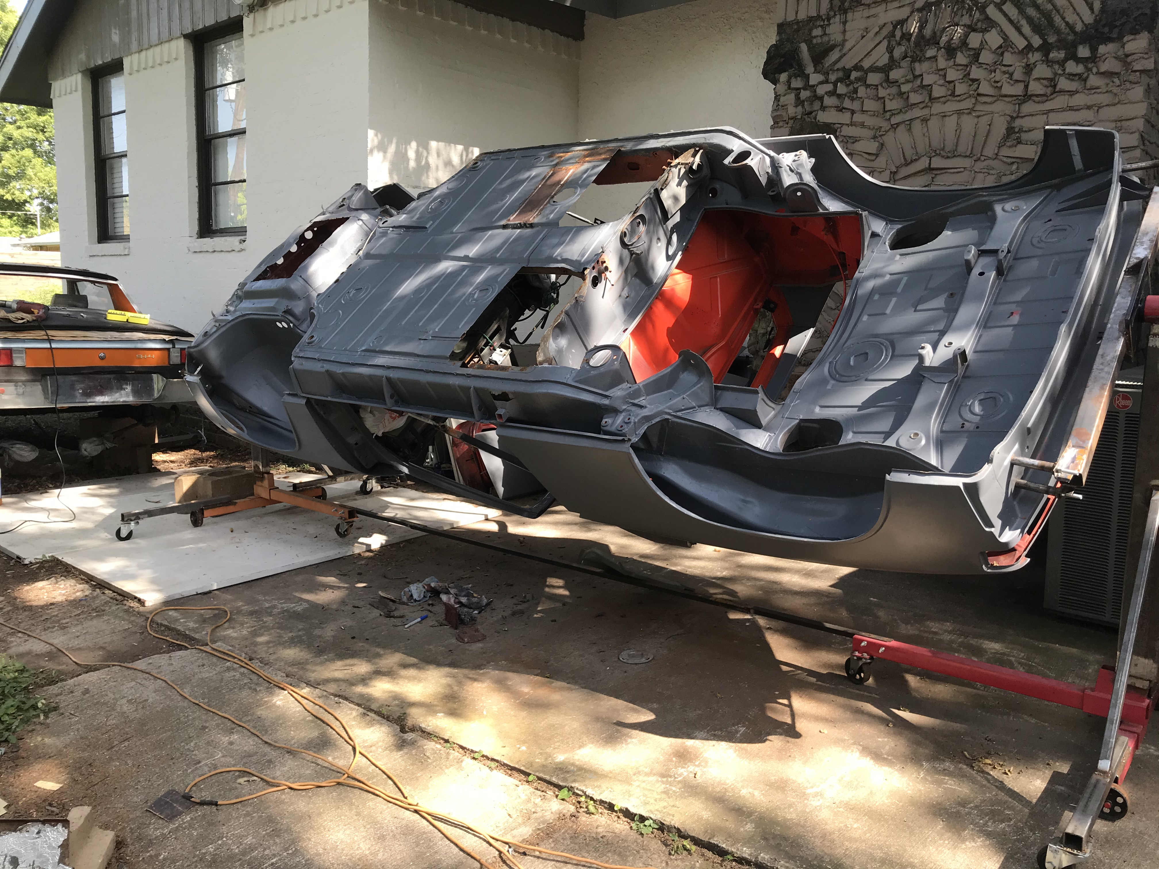

We're obviously in Epoxy primer and.. Got my rotisserie built and the car mounted:

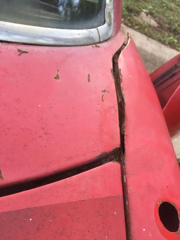

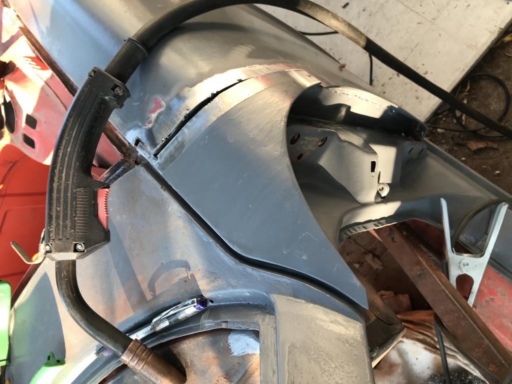

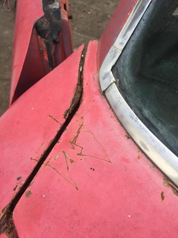

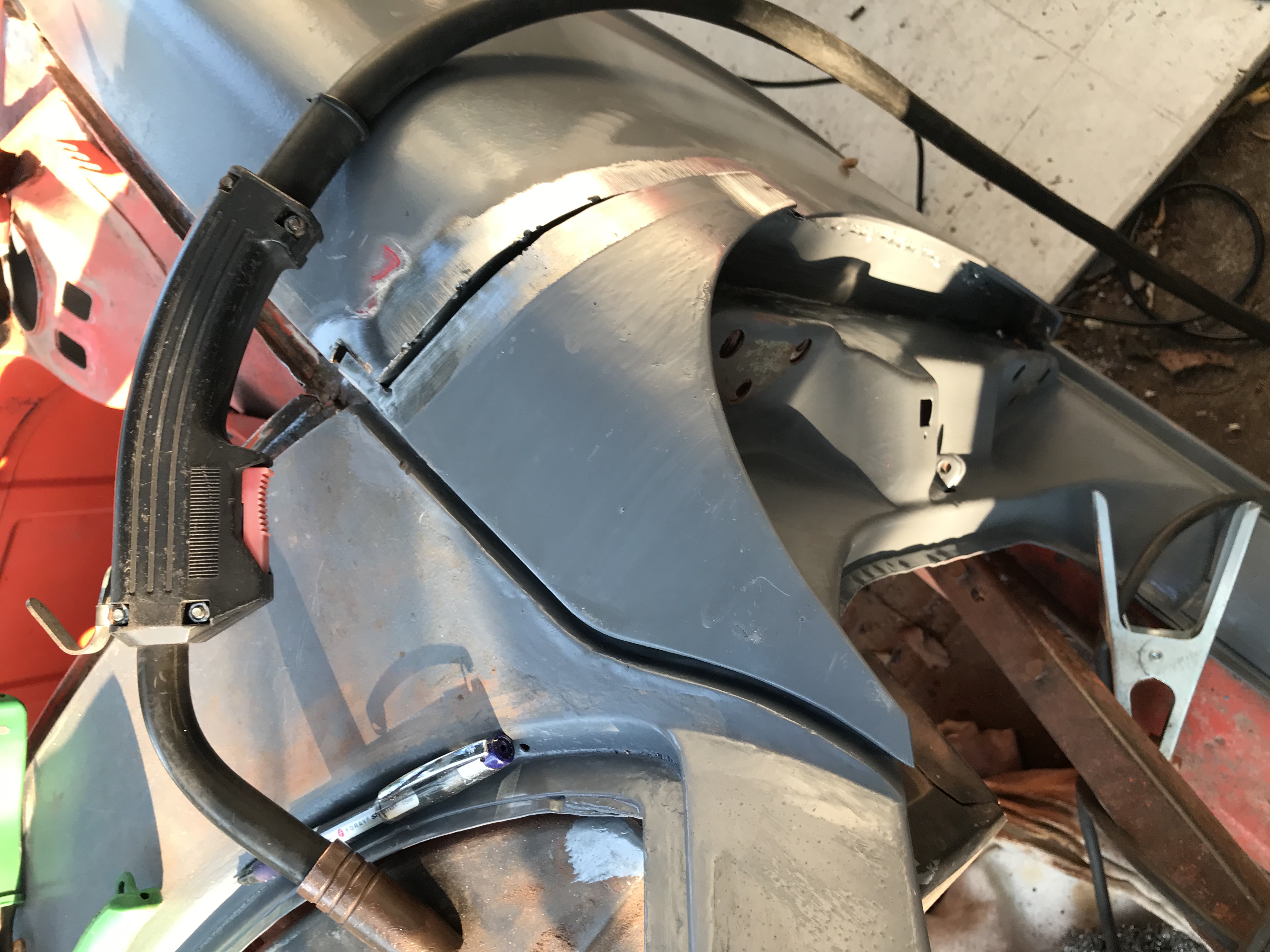

Oh yeah, before it got on the rotisserie I had to address the fender to cowling issues... both fender's "pointy tips" by the cowl, were rotting away. I cut them off and welded on replacements:
Before, during -
