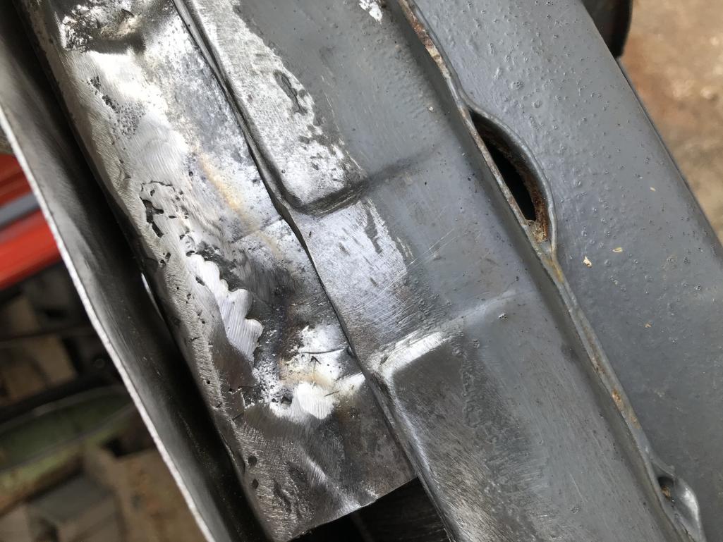

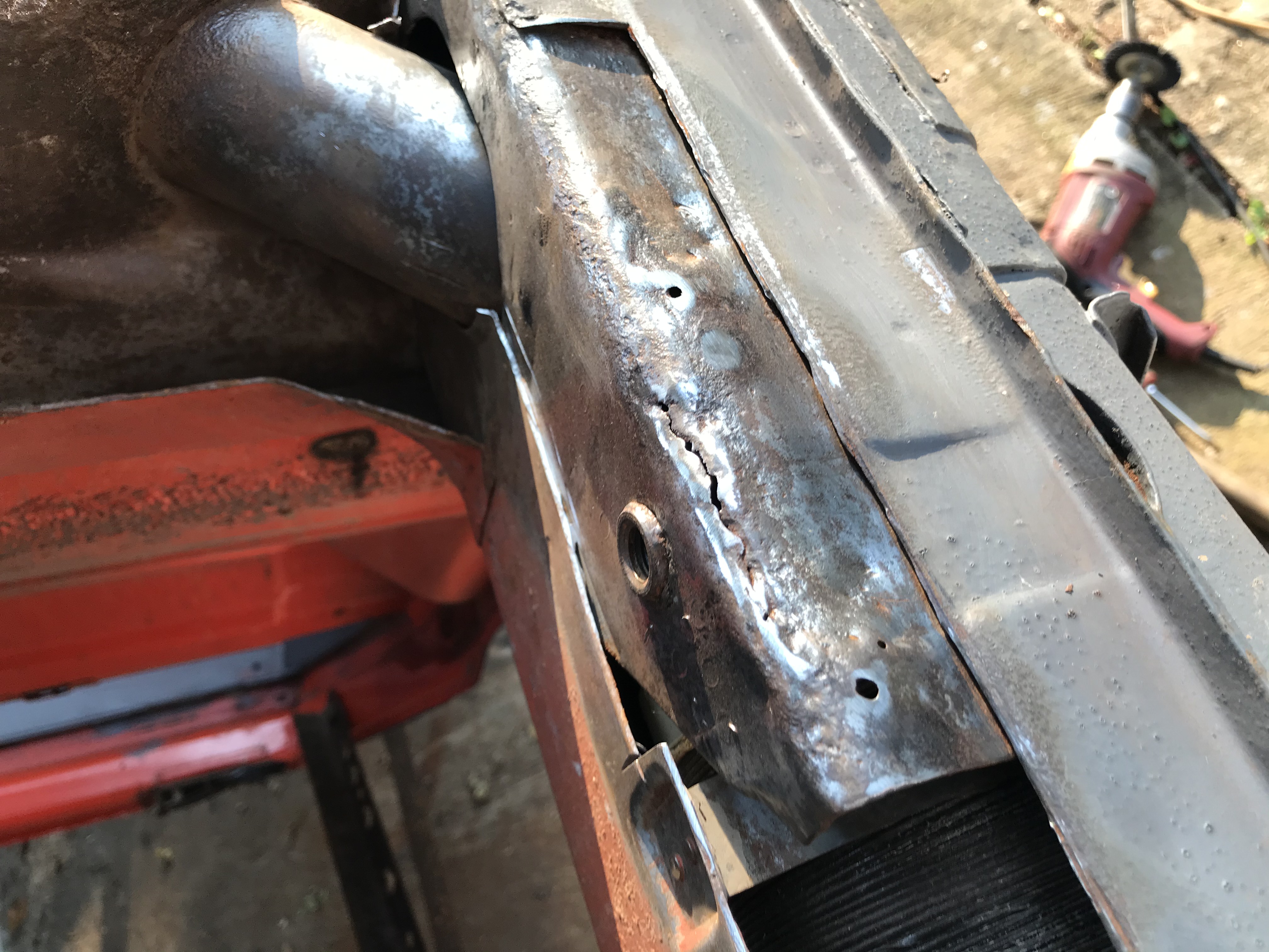

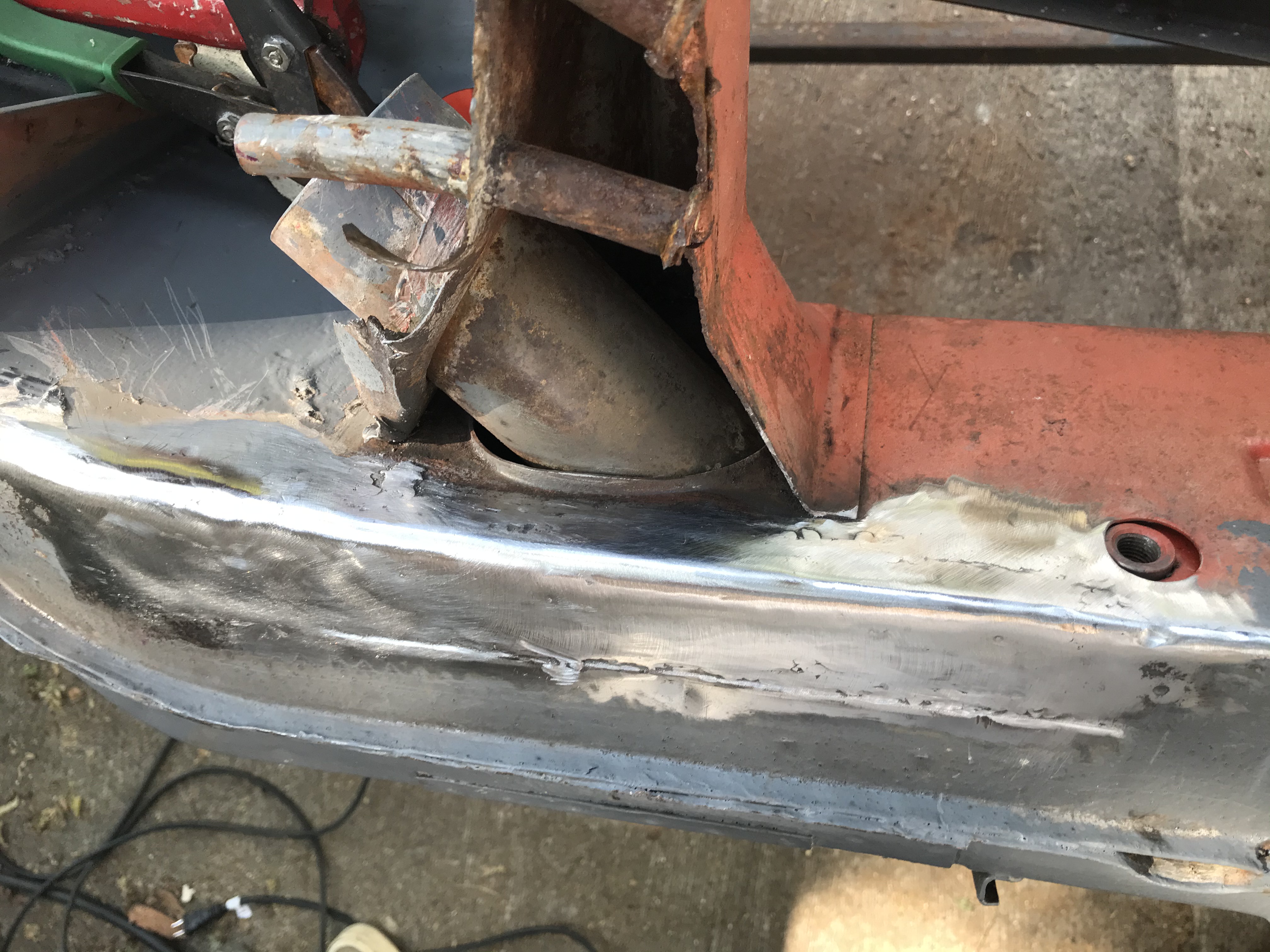

My longs are generally in good condition on this car, but there was a small amount of perforated metal (outer skin) where the two rear firewalls meet the longs on each side, so I’ve been cutting and patching:
Passenger side, before, during and after-

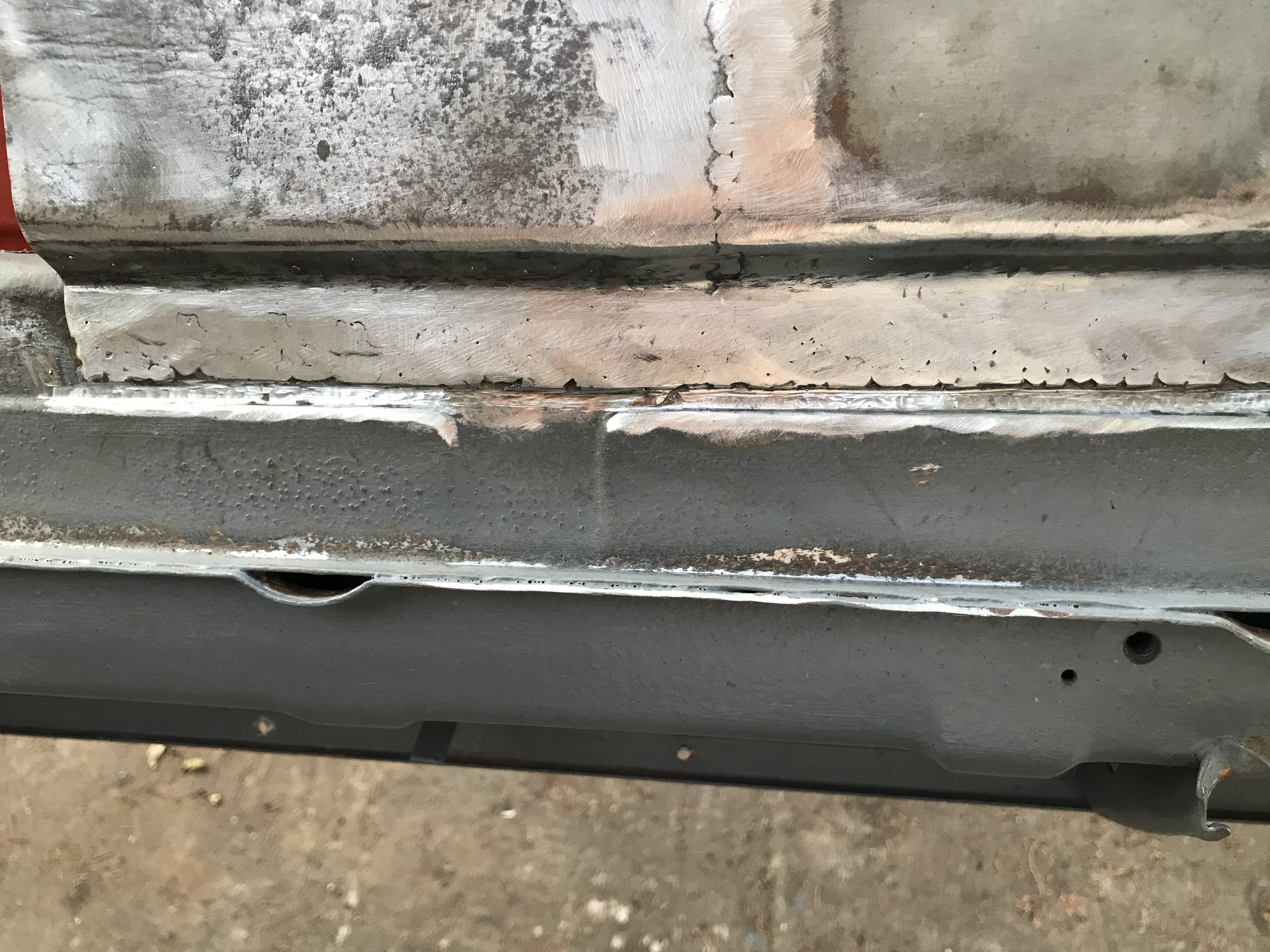

Driver’s side long repair, done:
Literati914

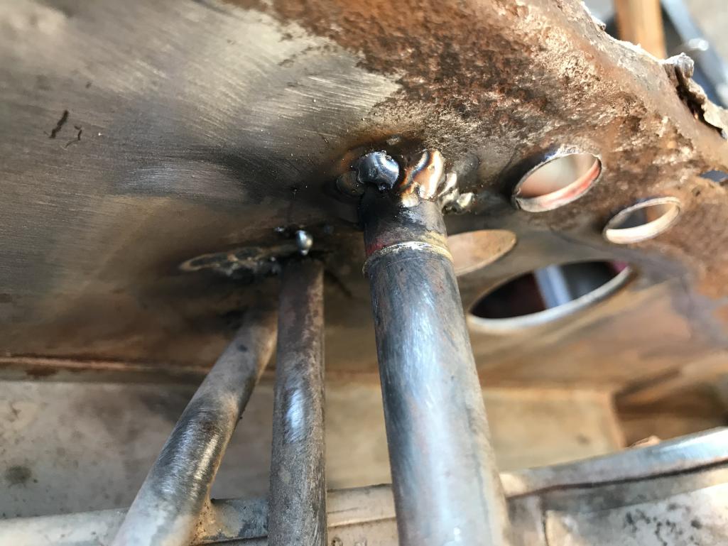

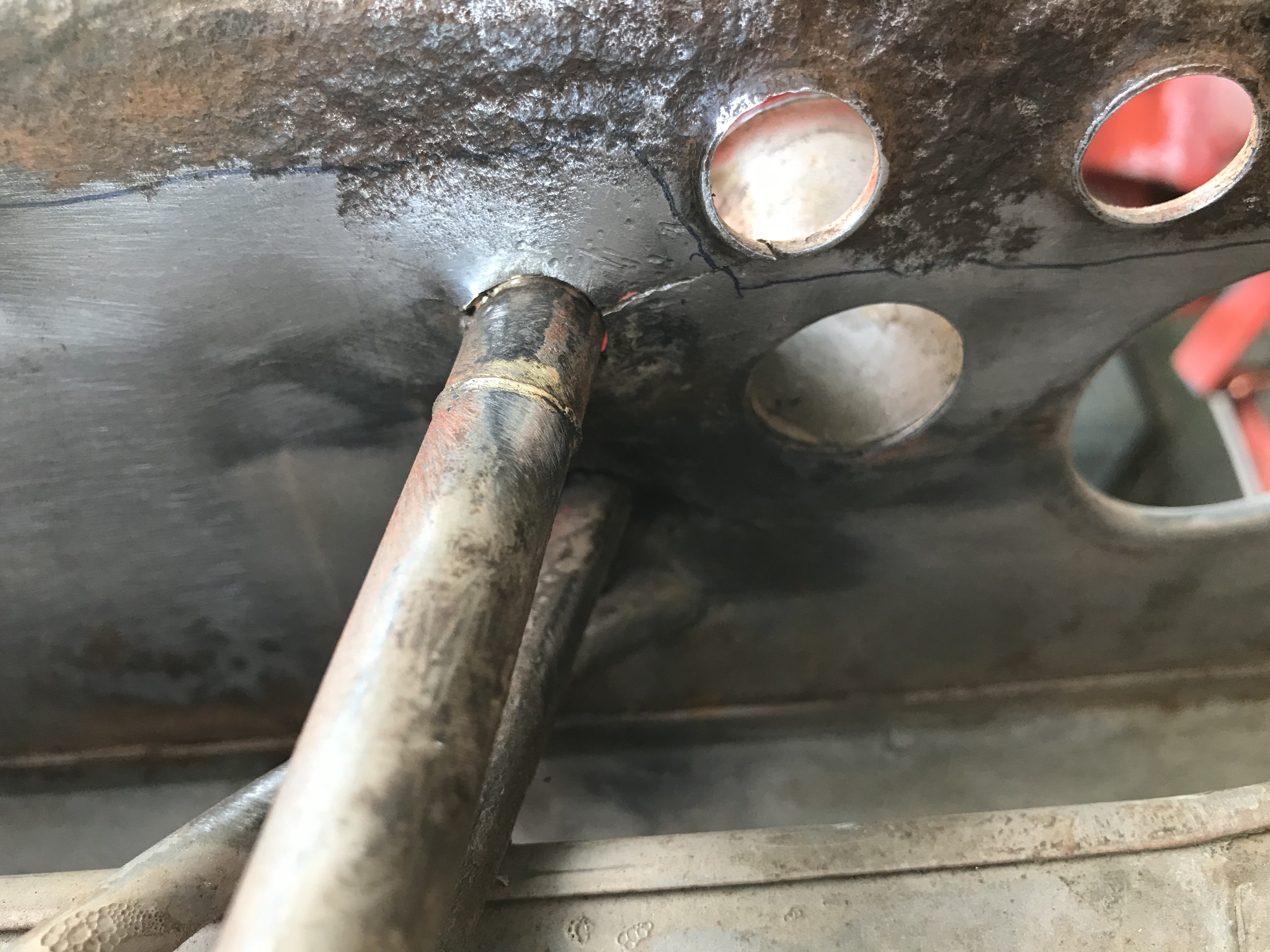

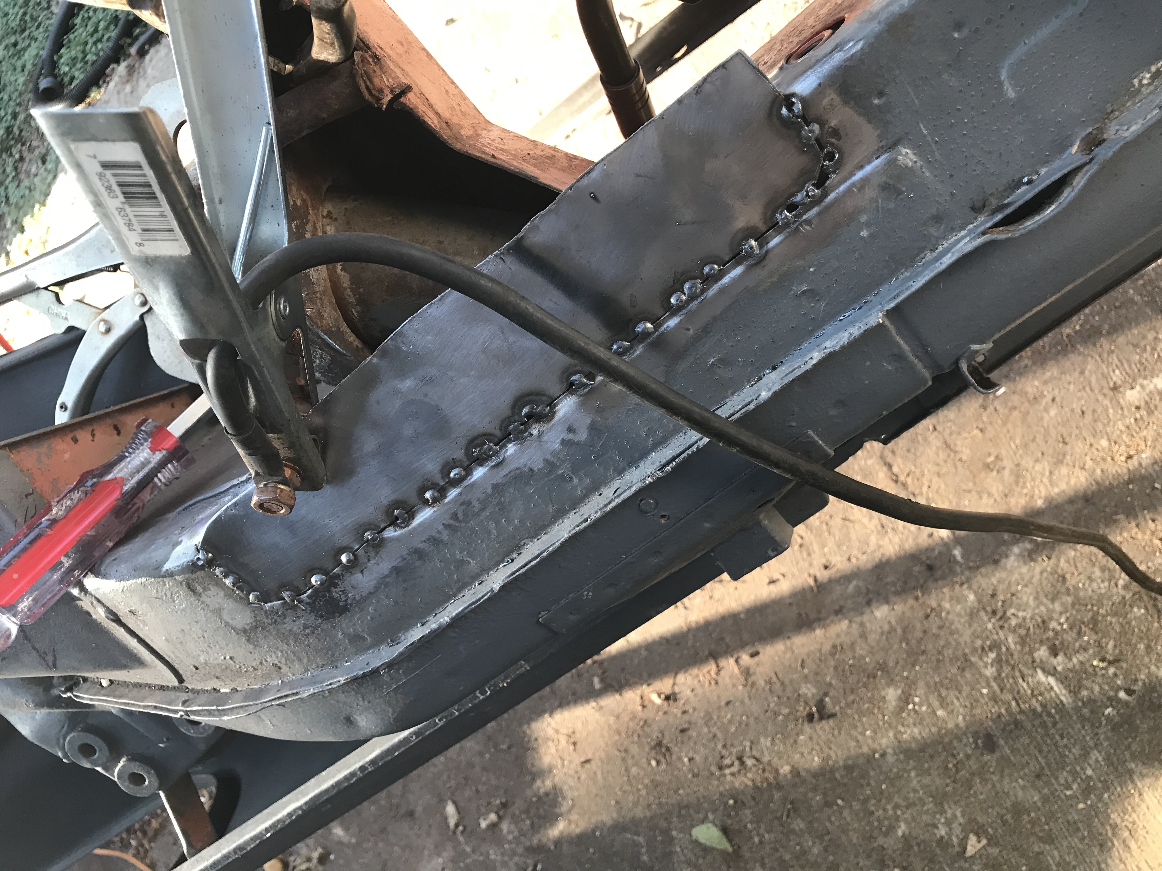

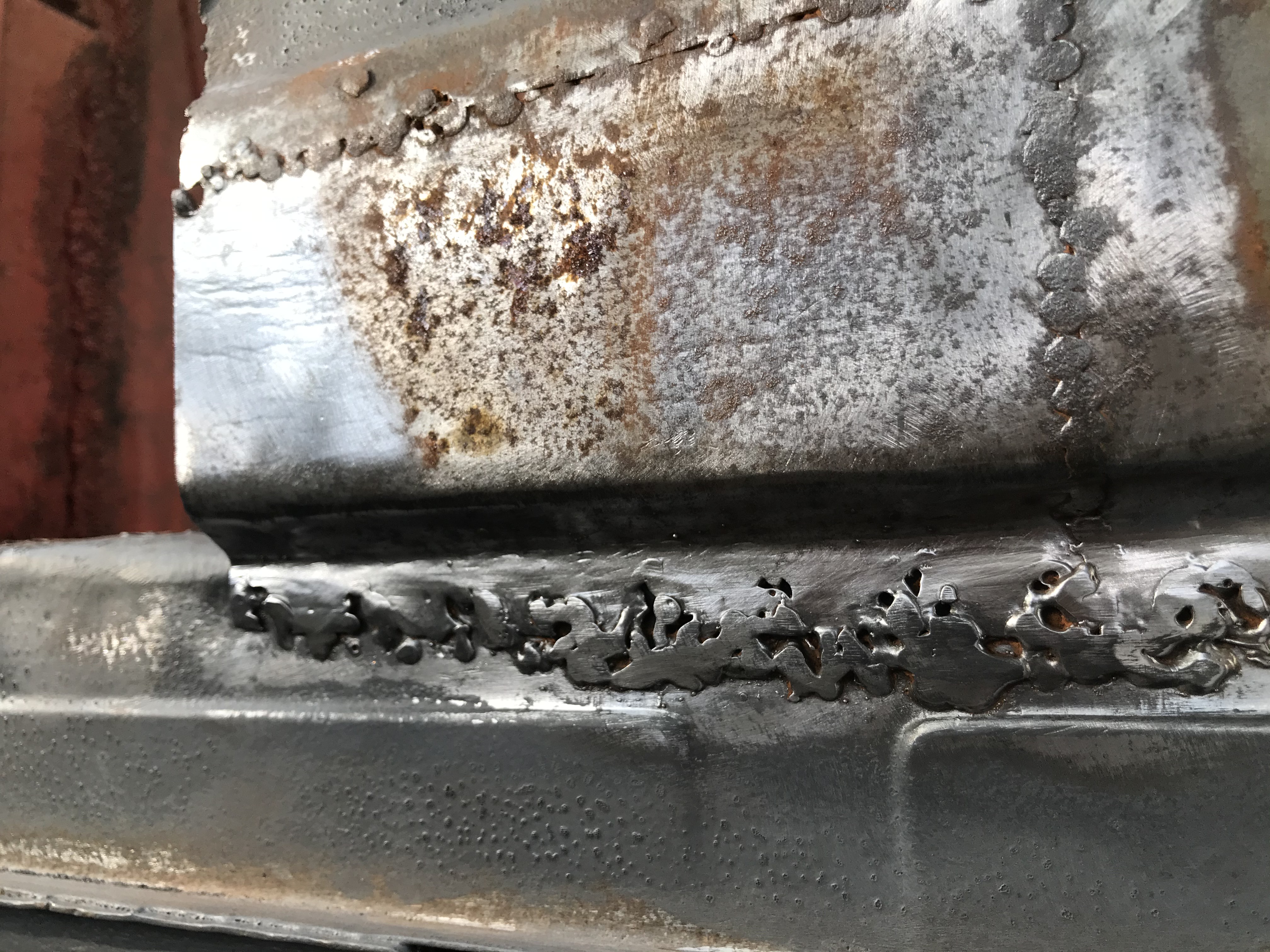

.. here’s a picture showing the reason I broke down and built a rotisserie...
The first pic is what my miserable welds were looking like while trying to weld a patch to the floor while laying on my back and the car a ft or so off the ground (IMG:style_emoticons/default/barf.gif) . Couldn’t really even manage to get anything clean enough for consistency. Had hot slag dripping on me and trying to dress the welds with a grinder between me and the car felt really dangerous.
The second pic is the very same area that I managed to clean up today and make look a little less embarrassing. So much easier with the rotisserie!

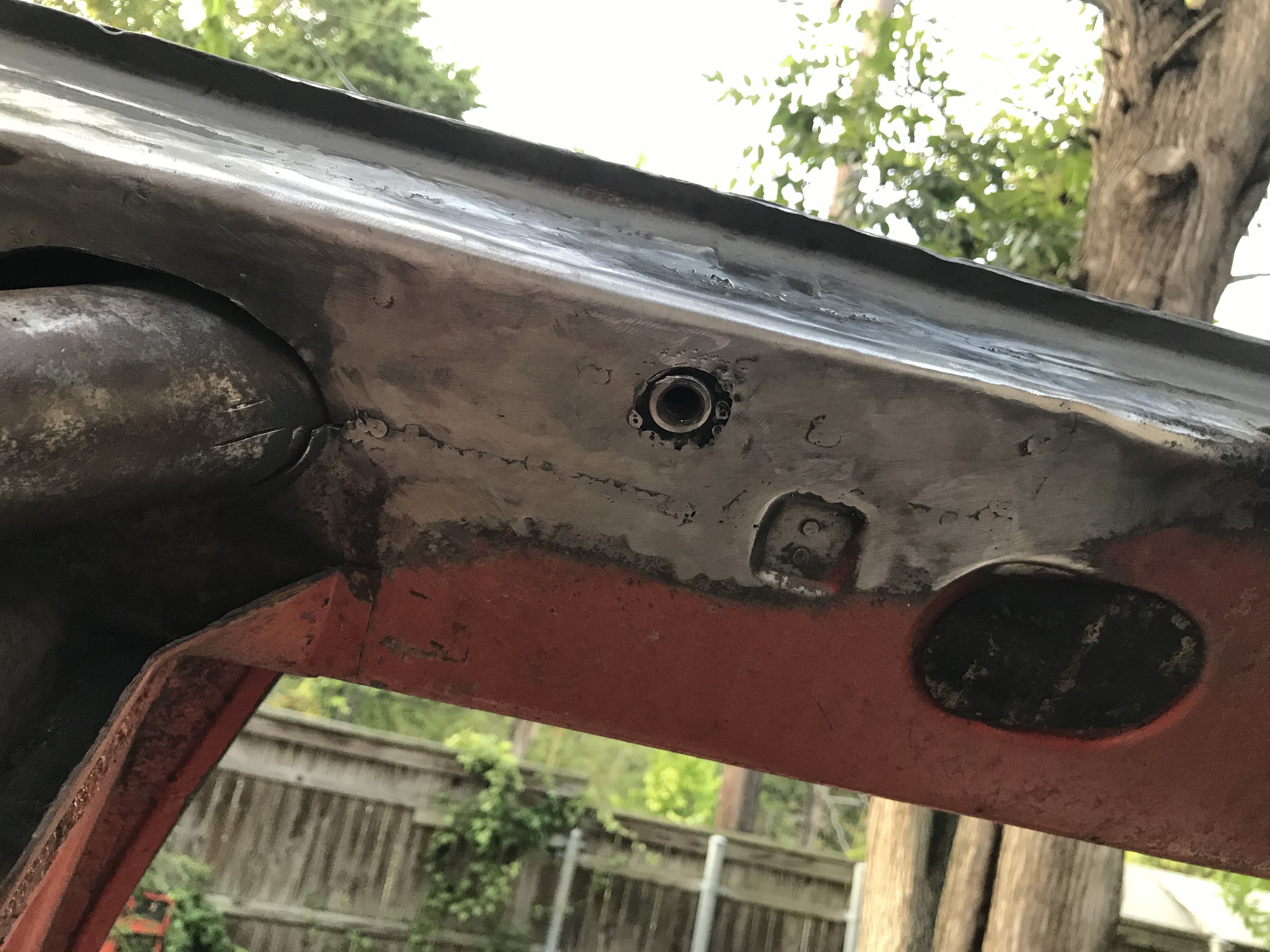

AFTER clean up (IMG:style_emoticons/default/piratenanner.gif)

I can't imagine doing the underside work I did without a rotisserie--and certain not being able to enjoy any of it. Being able to turn the car on either side or upside-down made most of the cutting, welding, and grinding fun(ish).

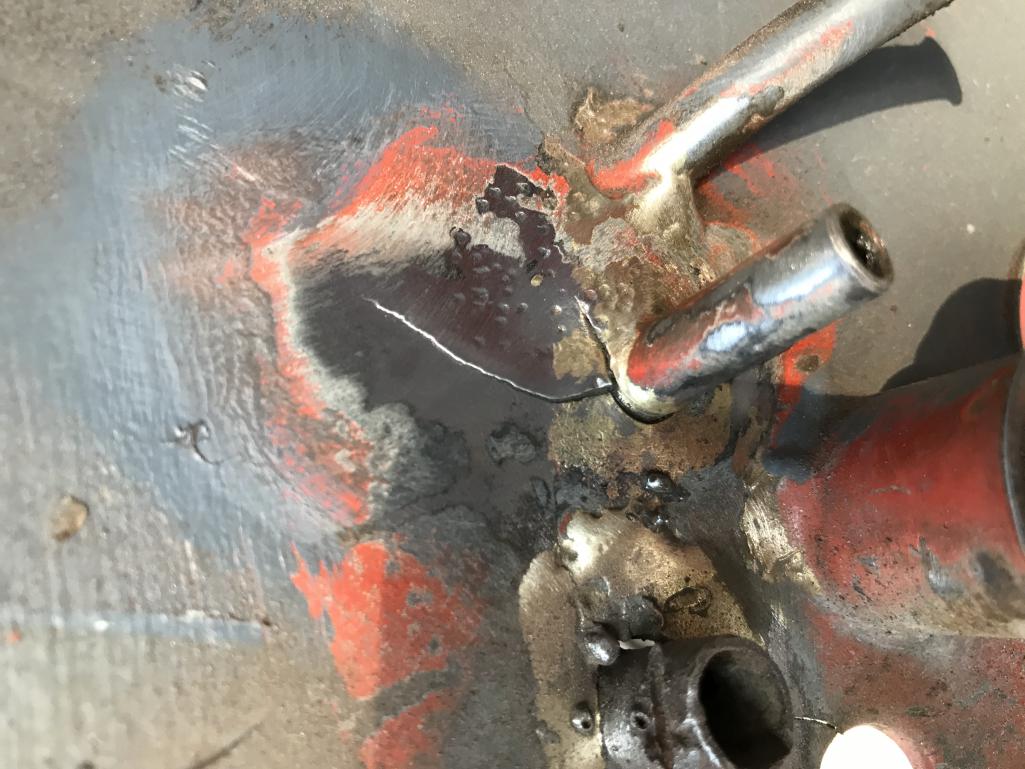

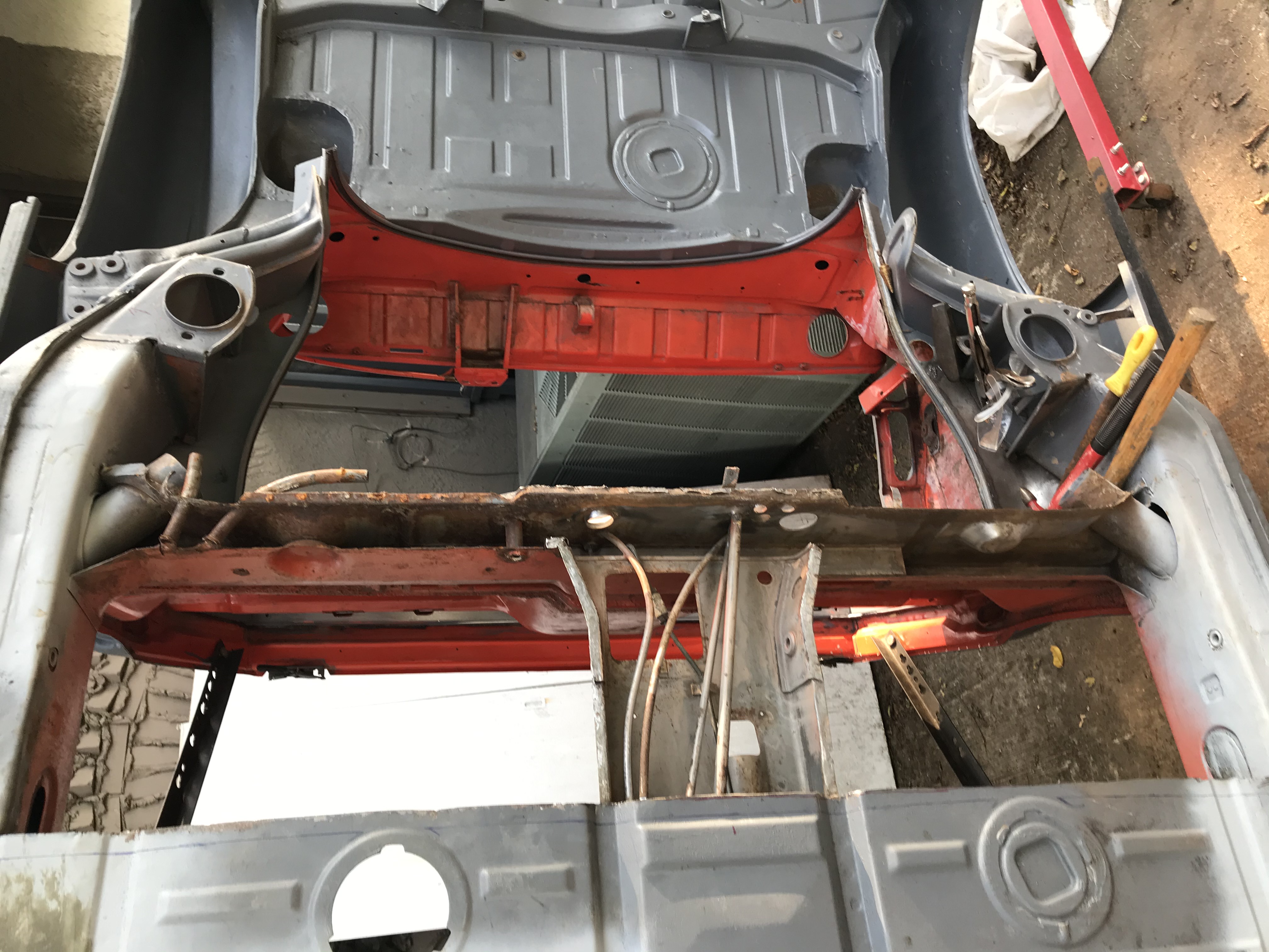

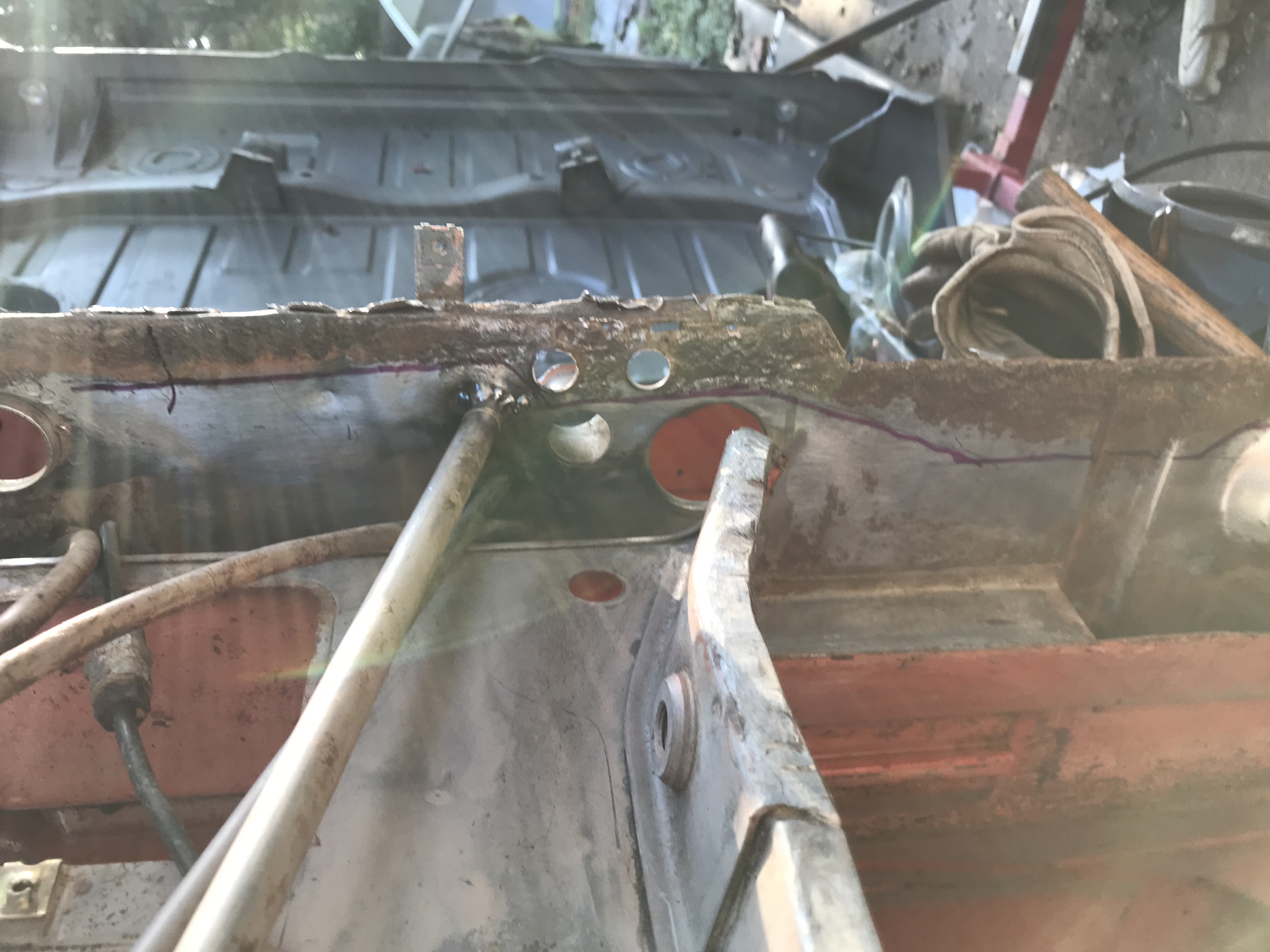

Ok so today I removed the rear under side of the tunnel and cleaned up the lips on the tunnel where the floor will be welded to eventually, as well as cleaned up the inside of the tunnel forward - in prep for internal chassis paint there. Note, the tunnel had been left intact before I had a rotisserie and this was going to make installing the floor easier somehow (IMG:style_emoticons/default/wacko.gif) . This way is much more thorough but also helpful because my clutch tube needed securing at the firewall as well as some repairs needed to the area around the throttle cable tube (see last pics):
Here’s the a shot showing the rear floor completely removed and tunnel flanges cleaned
Literati914
post Aug 16 2021, 09:13 PM
Post #36
Posts: 2,420
Joined: 16-November 06
From: Dallas, TX
Member No.: 7,222
Very Loose clutch tube
Literati914
post Aug 16 2021, 09:15 PM
Post #37
Posts: 2,420
From: Dallas, TX
Member No.: 7,222
..both repaired
Literati914
post Aug 16 2021, 09:20 PM
Post #38
Posts: 2,420
From: Dallas, TX
Member No.: 7,222

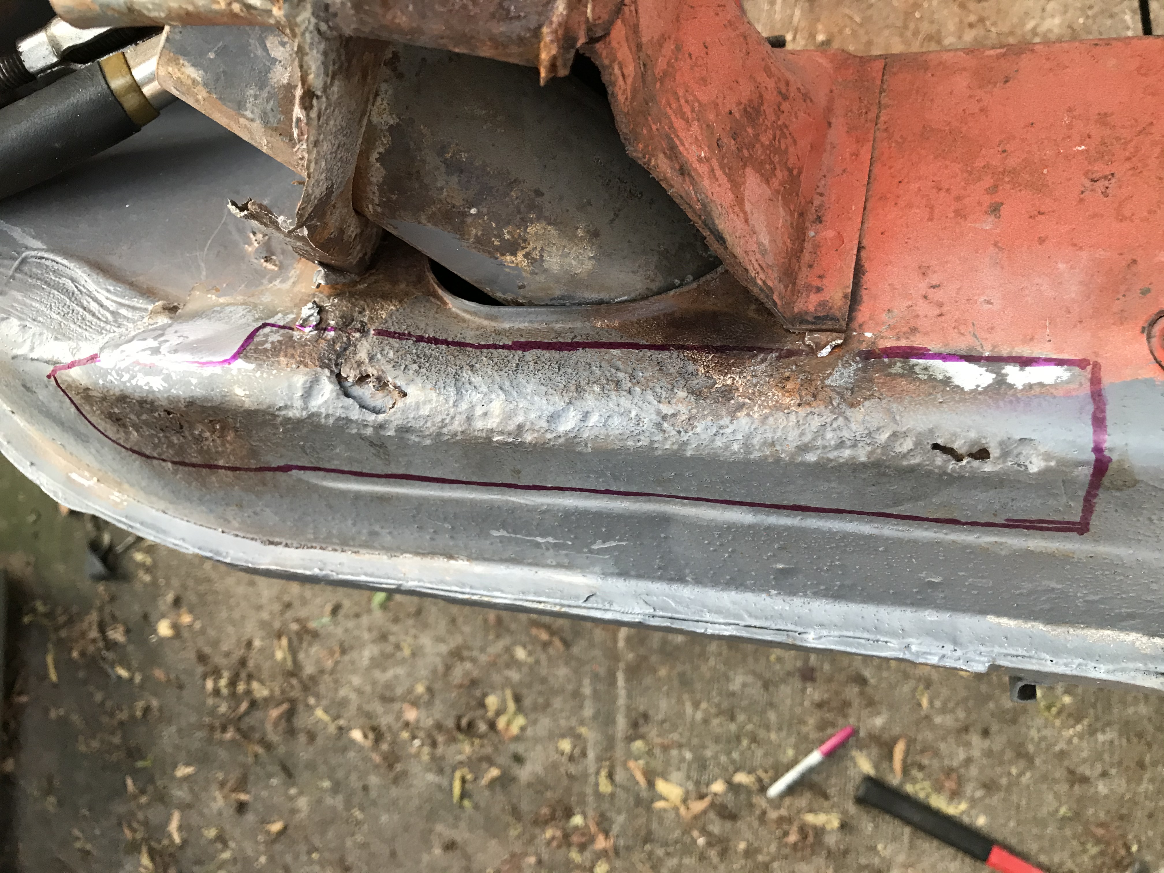

Here you can see marks for the cuts I made at the bottom of the outside firewall..I will be fabricating the lower section of the firewall - buying a whole panel seemed wasteful since most of it is in good shape. Hopefully these repairs will last a long time, the car will be a driver, if not a daily driver.
