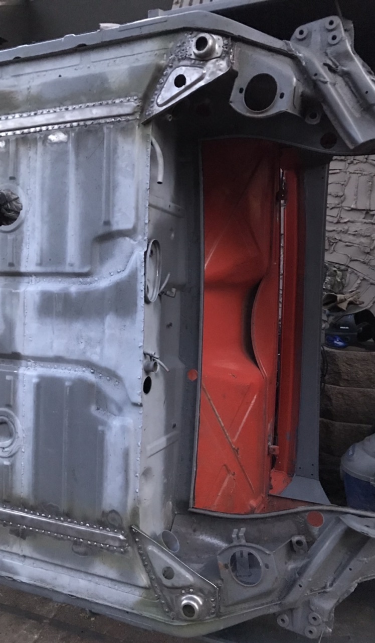

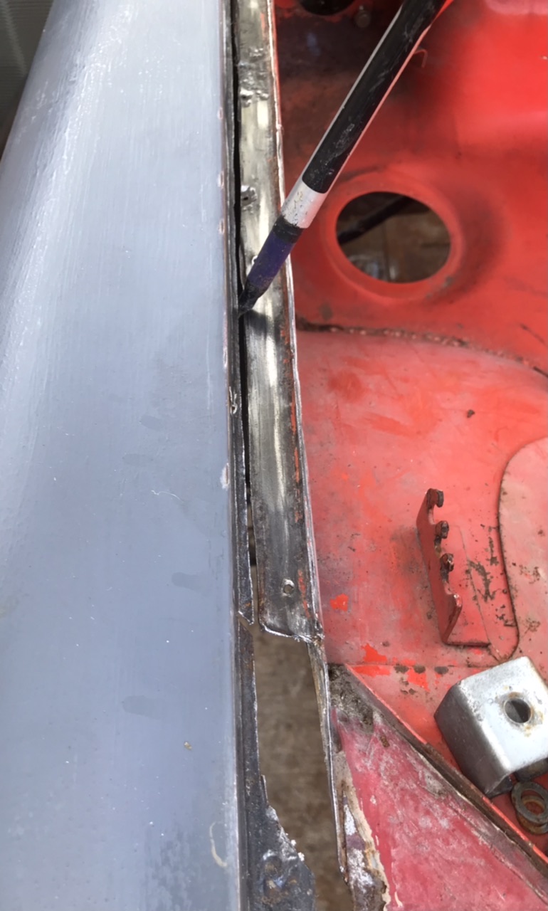

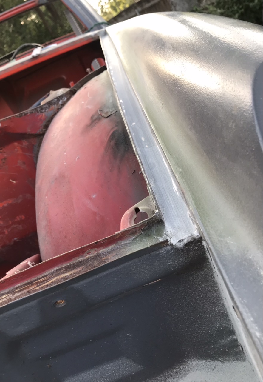

Literati914   Ok so today I removed the rear under side of the t...   Aug 16 2021, 09:06 PM
Literati914   Very Loose clutch tube   Aug 16 2021, 09:13 PM
Literati914   ..both repaired   Aug 16 2021, 09:15 PM
Literati914   Here you can see marks for the cuts I made at the ...   Aug 16 2021, 09:20 PM

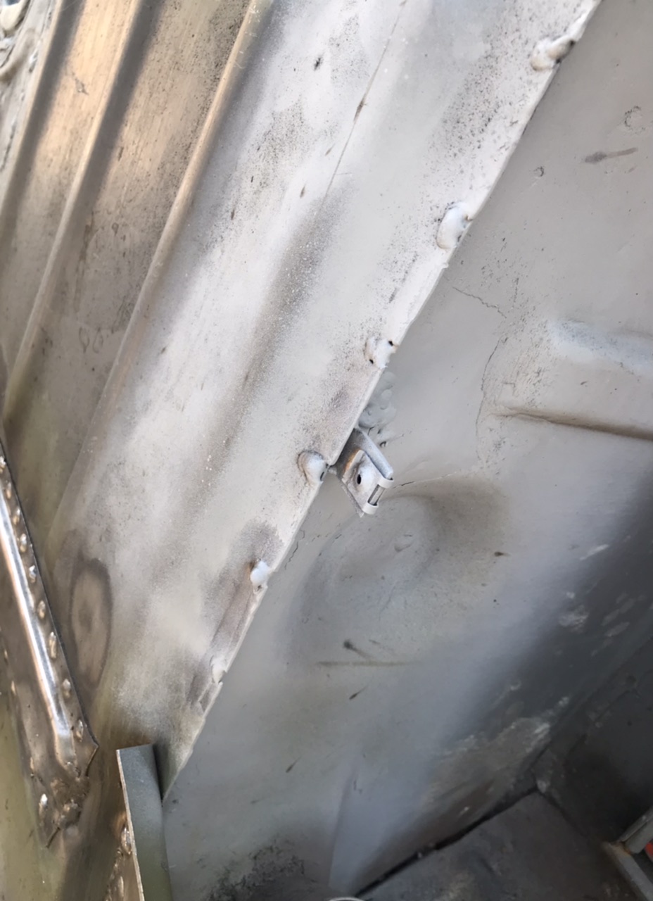

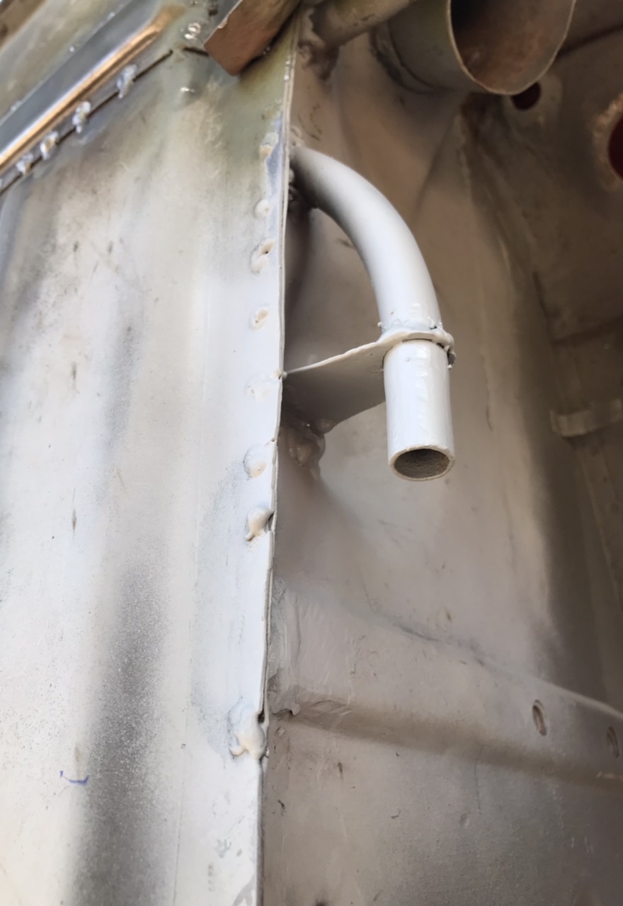

Literati914   Now to tackle the loose clutch tube bracket midway...   Sep 12 2021, 06:31 PM
Literati914   Bracket realigned and rewelded… I didn’t shoot...   Sep 12 2021, 06:36 PM
Literati914   Closed up, worked down and lightly primed   Sep 12 2021, 06:36 PM

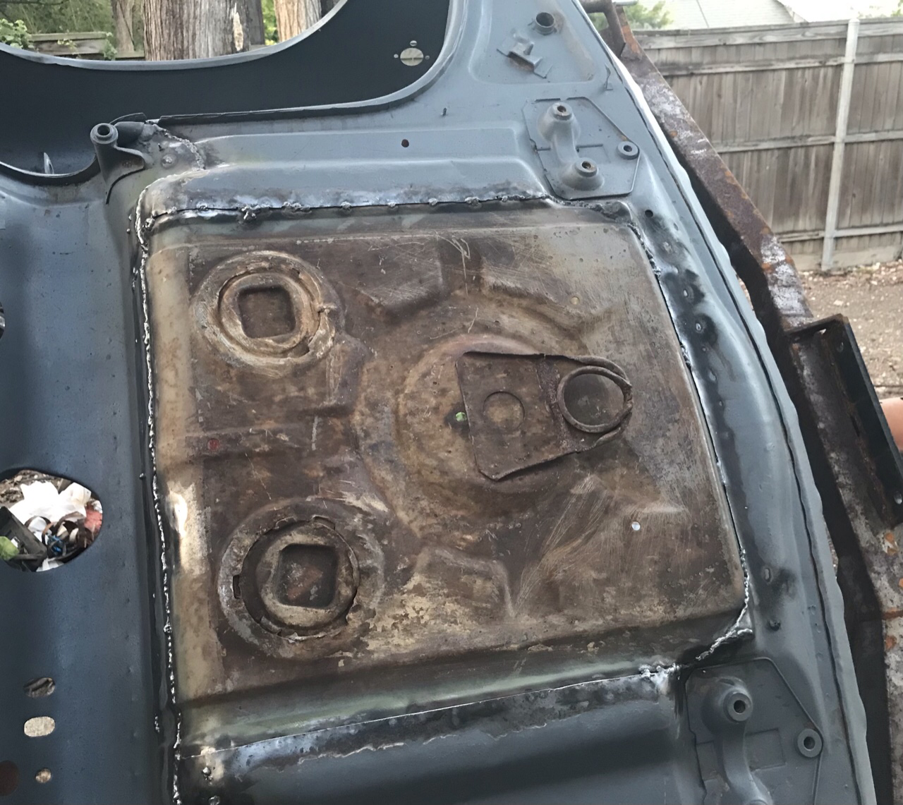

Literati914   Rusted through areas of the floor and firewalls ar...   Sep 27 2021, 07:41 PM
Literati914   In process   Sep 27 2021, 07:43 PM
Literati914   .. and completed - I’ve got solid floors again ...   Sep 27 2021, 07:44 PM

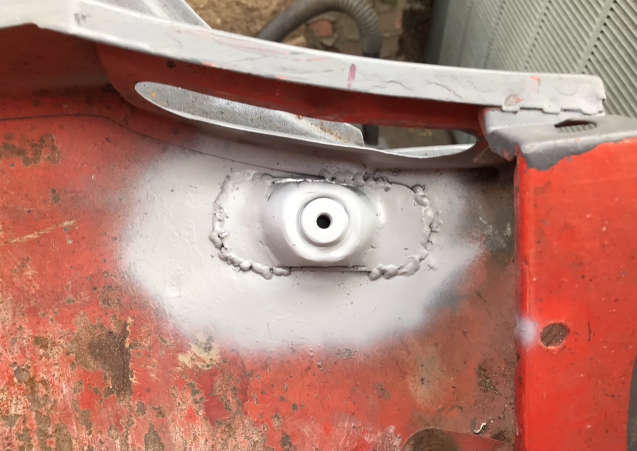

Literati914   Got a couple small items checked off the list The...   Sep 30 2021, 06:51 PM
Literati914   Installed :   Sep 30 2021, 06:52 PM

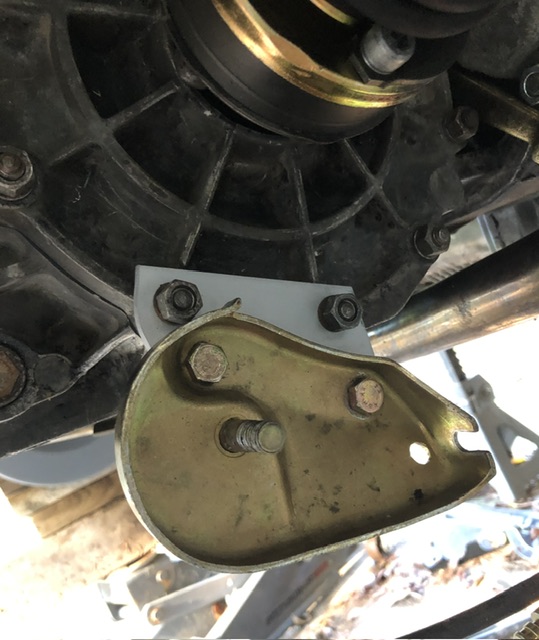

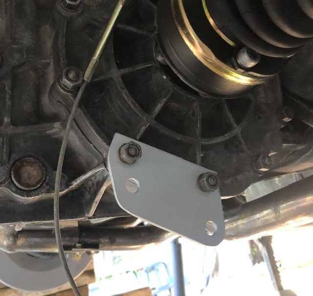

Literati914   Next I fabbed up a little support bracket for the ...   Sep 30 2021, 06:54 PM
mb911   Well you did better than I. I forgot all together ...   Sep 30 2021, 06:54 PM
Literati914   .. and got that installed:   Sep 30 2021, 06:56 PM
Literati914   .. then it was on to that pesky PS rear hinge (rea...   Sep 30 2021, 06:58 PM
Literati914   Got it measured out and located properly before we...   Sep 30 2021, 07:00 PM
Literati914   The bigger accomplishment tho, was getting the cor...   Sep 30 2021, 07:05 PM
Literati914   Installed… I reused the DS one so it’s not as ...   Sep 30 2021, 07:07 PM

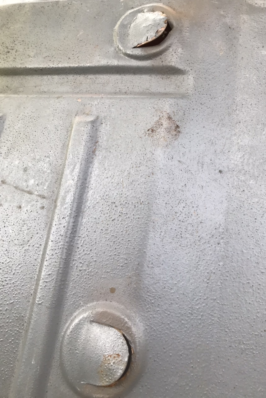

Literati914   Been wet for a couple days but I was able to get o...   Oct 2 2021, 07:26 PM
Literati914   After..   Oct 2 2021, 07:27 PM
