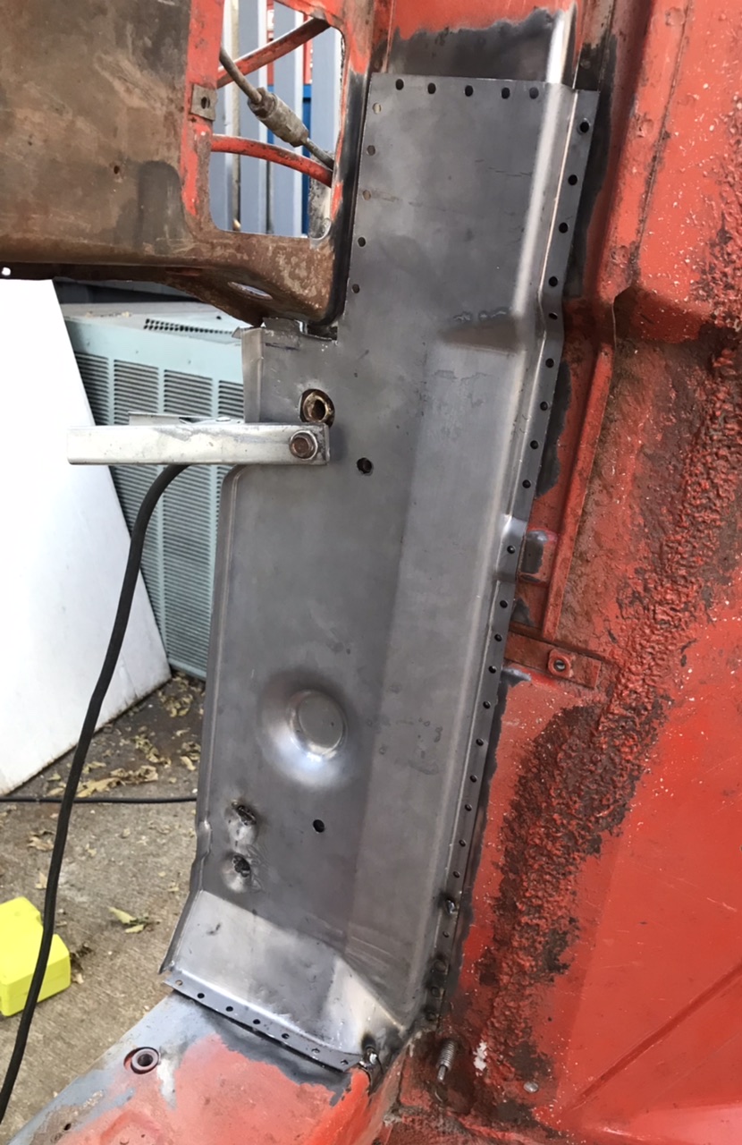

PS inner repair in process

PS inner firewall repair, completed

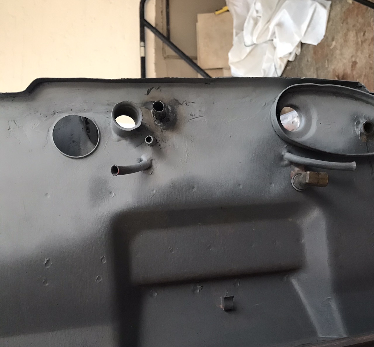

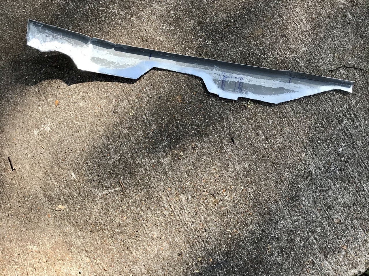

The outside passengers firewall panel I made up from the remainder of the PS inner firewall:

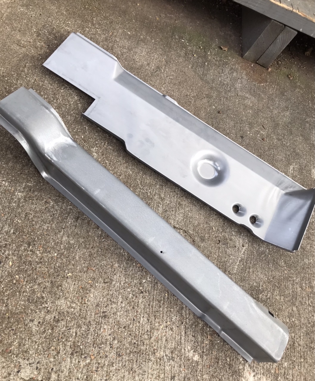

Received a couple more items from RD, time to finish the firewalls.

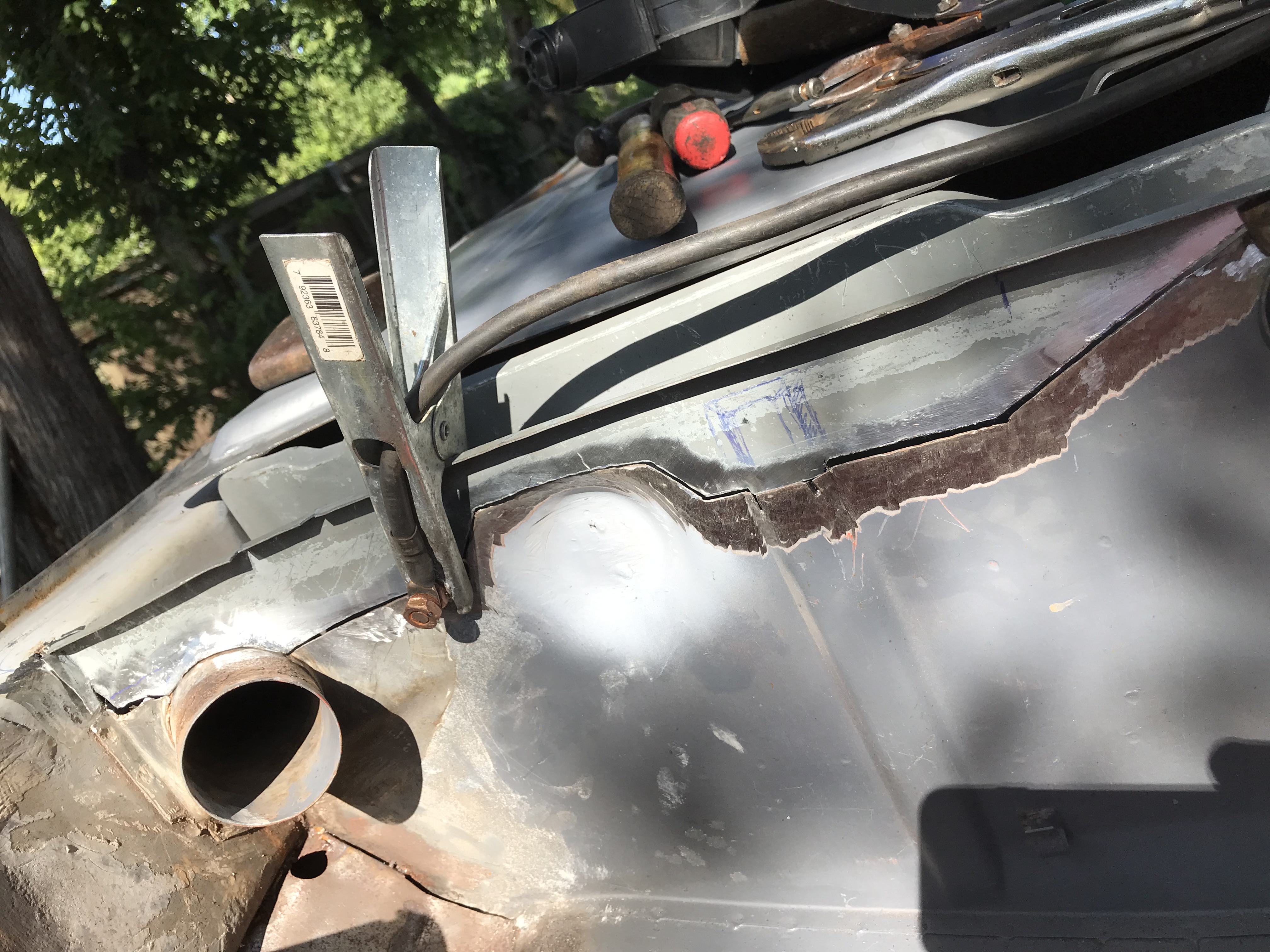

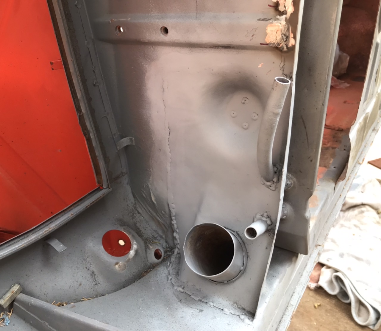

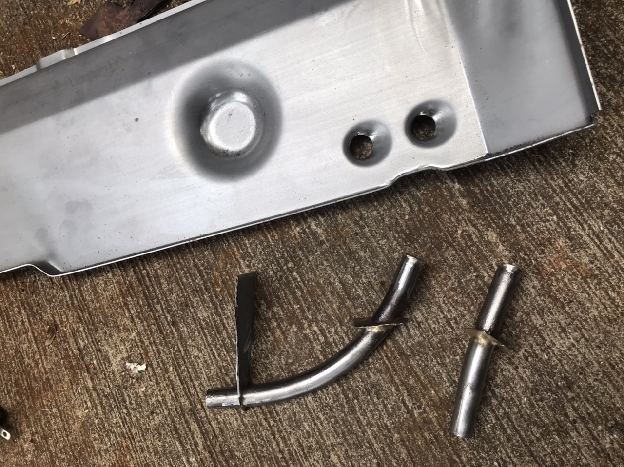

So next up.. the driver’s side inner. This time I popped holes around the perimeter for spot welds, with a convenient air tool I forgot I had (harbor freight). Before proceeding I needed to separate the ebrake tube from inner and outer firewalls:

Drivers side inner wall with holes ready to be welded.. this is actually and over-lay or a second skin for most of this wall as only the bottom of the original was bad. I figured why not use the entire piece, since some people buy ‘reinforcement’ panels and over lay anyway.

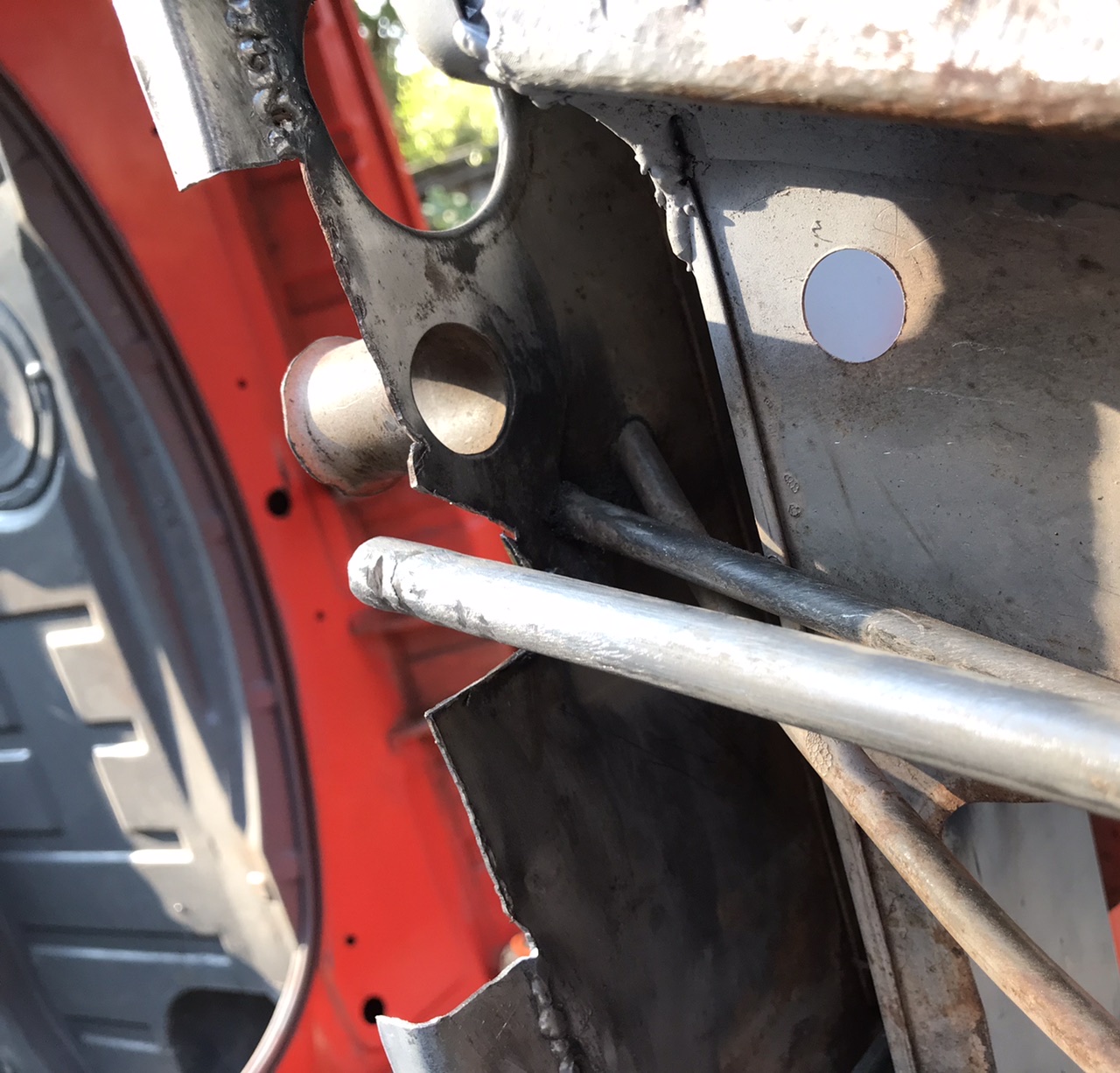

Here you can see where the original ebrake tubes are reinstalled and to get this to happen I kind of had to install the front and rear firewall at the same time on the drivers side.

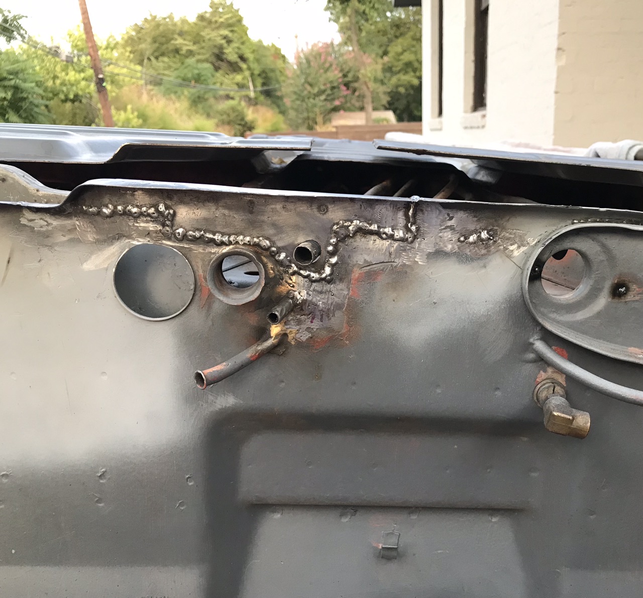

…I’ll go back and dress the weld and make things look better later..

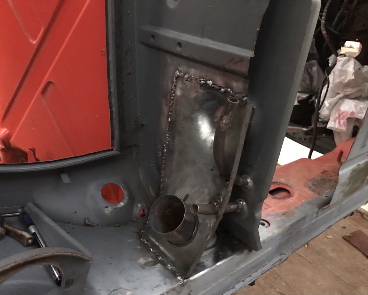

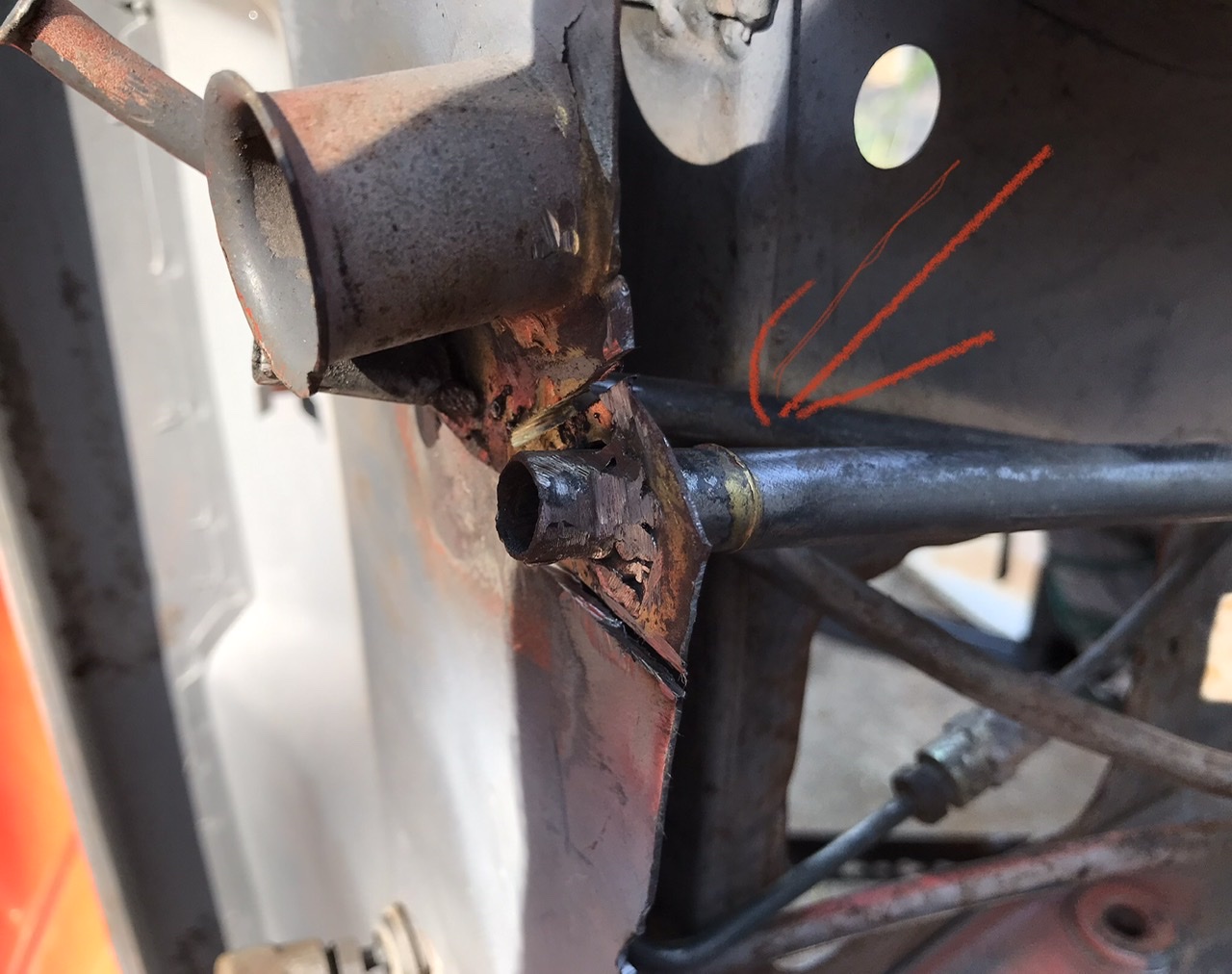

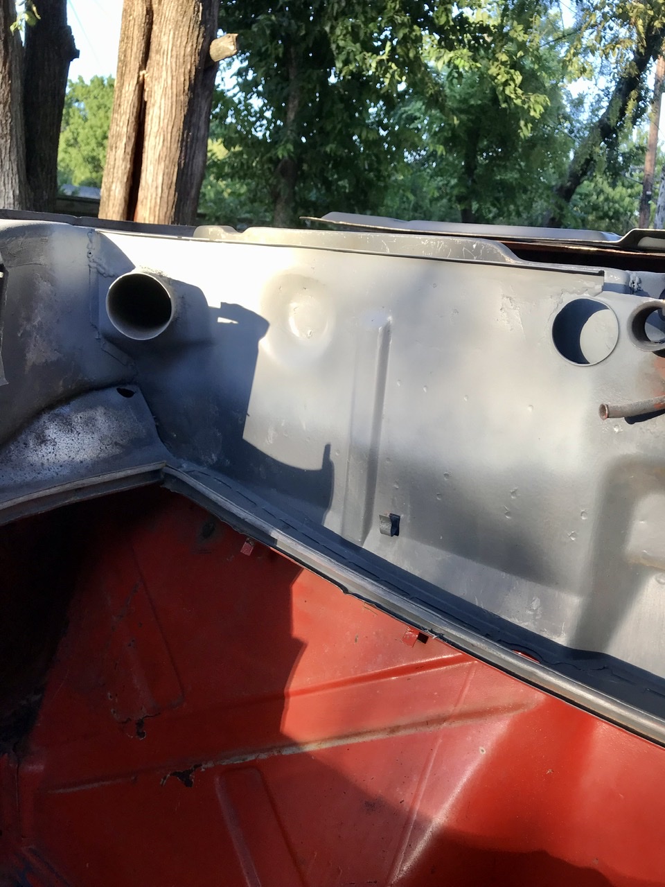

Ok so I’ve realized that when I retacked the clutch tube in place, that it was not in the right place.. it’s too far inward and not sticking out into the engine compartment enough. There is a bracket midways thru the tunnel that has broken loose and I will need to repair. I can see a brass ring around the clutch tube where it should meet the firewall (see the arrow in the pic). I will repair the inner tunnel bracket later. So ive cut the FW around the clutch tube, cleaned up the tube and will be correcting the tubes placement. Glad to do this cause those welds around the tube were kinda crappy looking.

post Sep 12 2021, 10:16 AM

Posts: 2,420

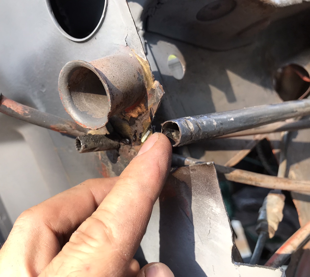

…tube released

post Sep 12 2021, 10:18 AM

.. and cleaned

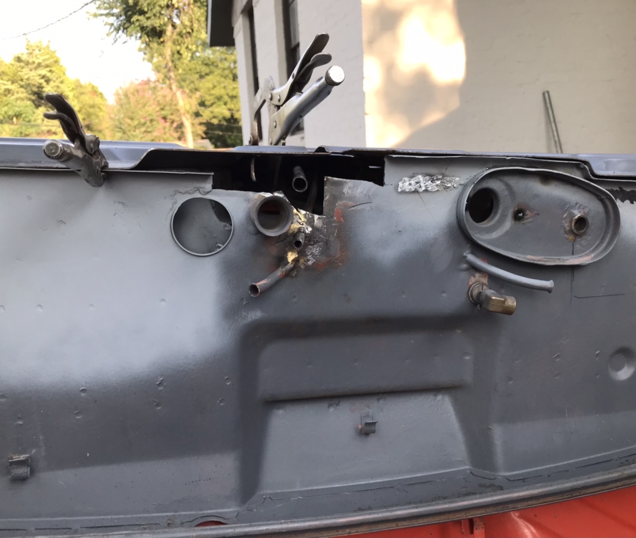

And a shot showing the remaining gap that needs filling on the firewall.

Fabricated a panel and tacked it in.. in this pic the clutch tube is loose in its hole so it can be adjusted outward later.

Welds knocked down and lightly primed
