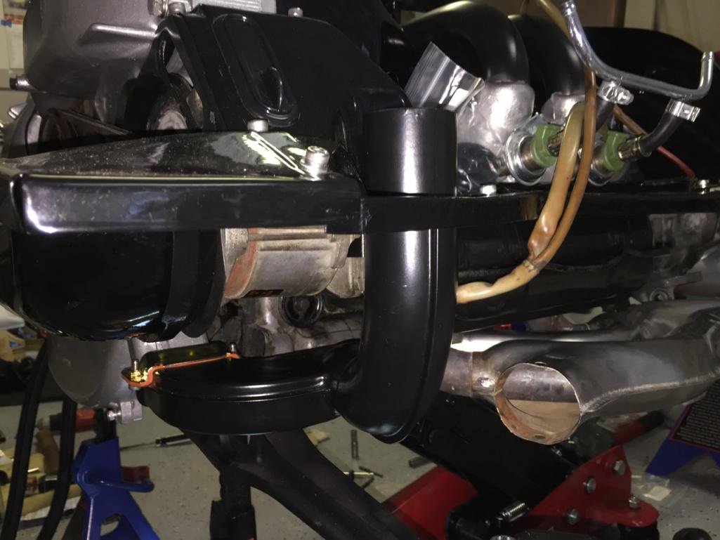

(IMG:http://www.914world.com/bbs2/uploads_offsite/live.staticflickr.com-1435-1583173857.1.jpg)
Is this the correct orientation for this tube? Do you use a hose to connect this to the firewall tube?

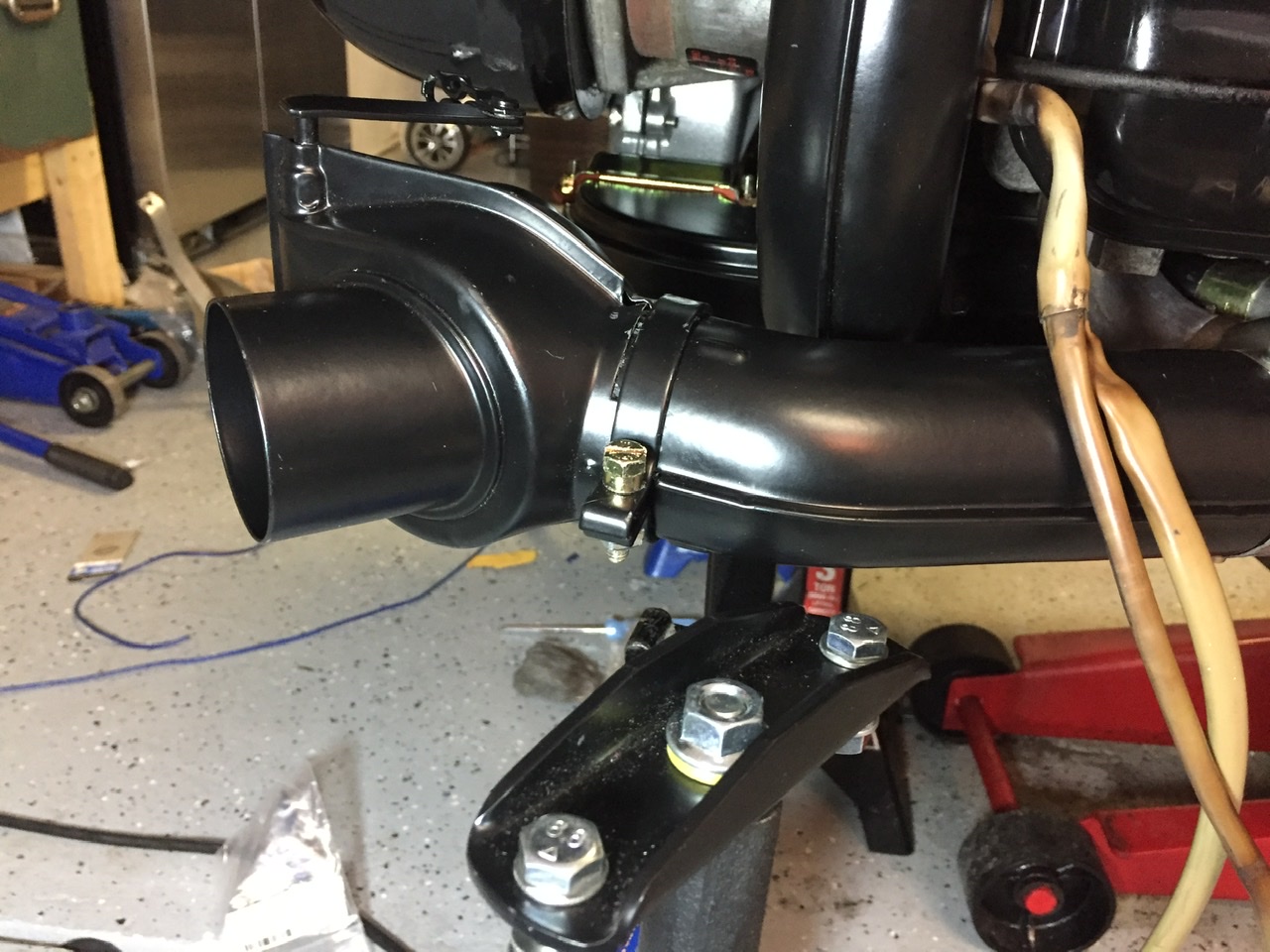

(IMG:http://www.914world.com/bbs2/uploads_offsite/live.staticflickr.com-1435-1583174027.1.jpg)
What attaches to this part of the heat exchanger? Is this the part that goes to the "Cold" side of the tins and the fan? Or does this connect to fan shroud somehow?

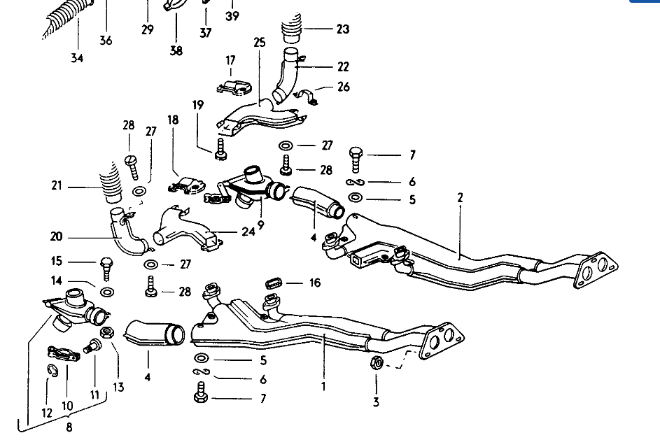

https://nemigaparts.com/cat_spares/pet/pors...14/570u/202150/

From: Bluffton, SC
Member No.: 11,106
here is a pic of the j-tube and S-tube to the fan housing. the open pipe would get the flapper box and from the flapper the orange hose goes to the bod of the car(longs tube)

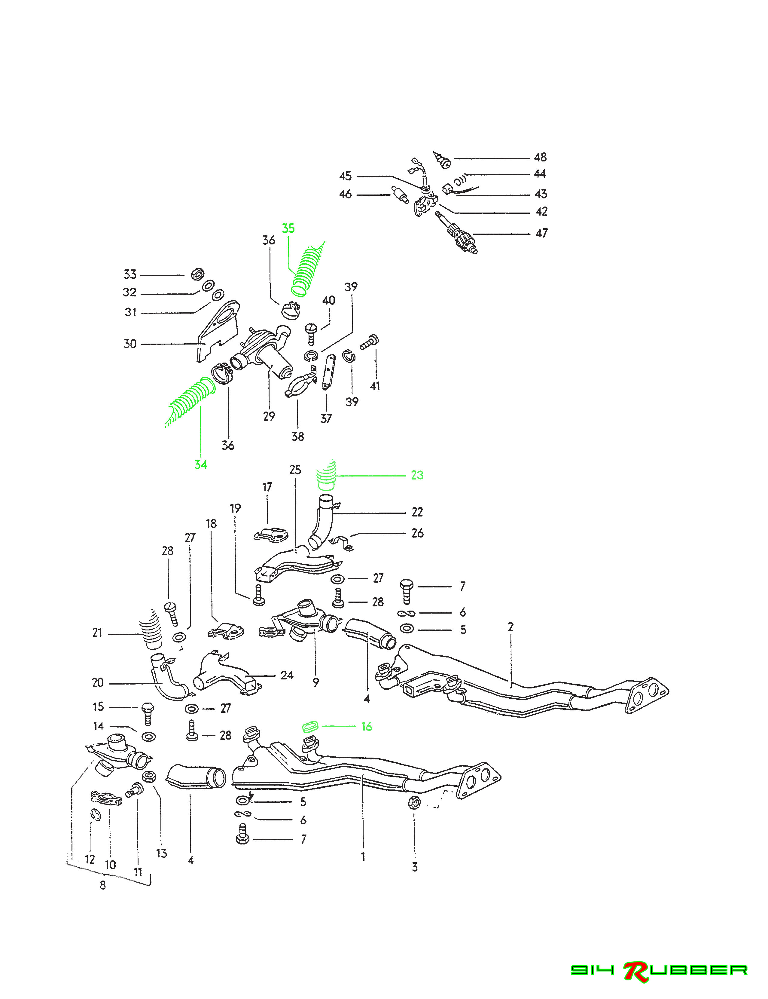

You need #24 and #18. Do you have the J tubes #20? You can buy the gaskets for #18 @914Rubber to seal the connection to the fan housing.

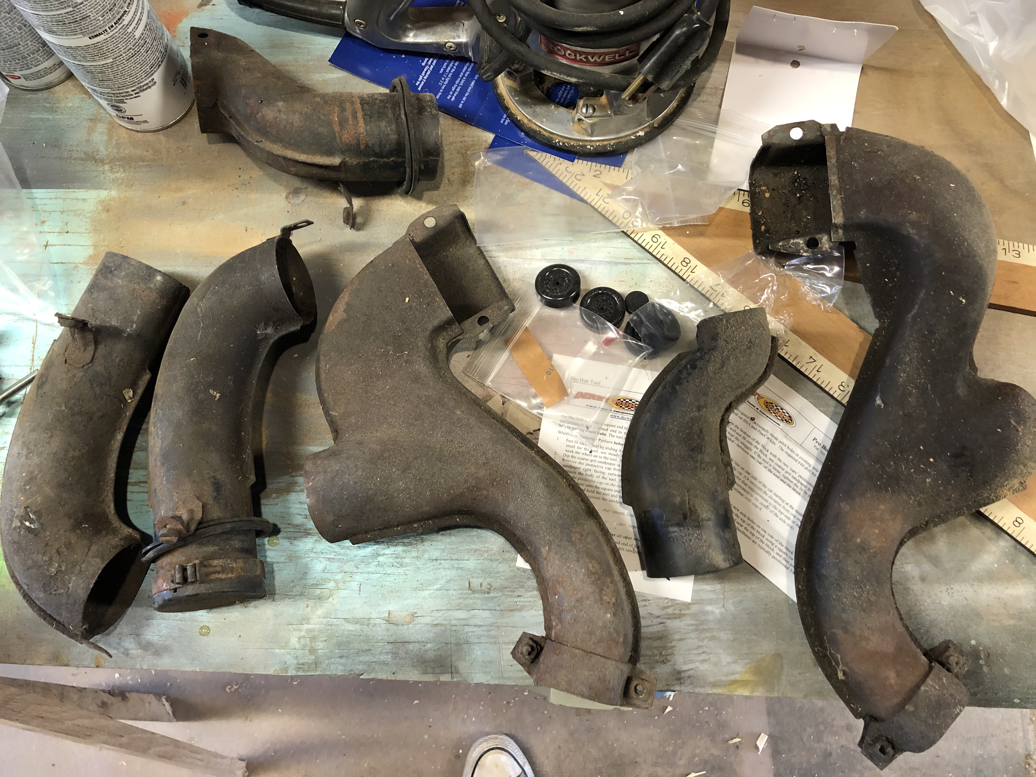

VaccaRabite
post Mar 2 2020, 01:29 PM
En Garde!
Posts: 13,757
Joined: 15-December 03
From: Dallastown, PA
Member No.: 1,435
Hrm. I am 100% missing parts.
And the parts I have may be the wrong parts. My car was a 75/76 and I backdated the heat exchangers ages ago.
These are the parts I have:
Looks like there are parts I need.
Zach

Bruce stone will have what you don’t have, flapper boxes and 914rubber has all the seals . i backdated mine from ‘75 to earlier HE too so i had to source all the parts . all those parts in my pics are from Bruce.

Looks you are missing the little covers the connect the duct to the fan housing. Somebody sells new ones

AA has those covers and the seals 914rubber, and the right side and left side are different , there is also a flapper that goes in the opening and hinges on a pin, just use metal coat hanger for the pin

Yes, the little flapper stops the heater booster fan from pushing air into the fan housing so at idle you have good heated air flow. Of course as the engine rev's the fan overpowers the flappers so air flows thru the HE's
