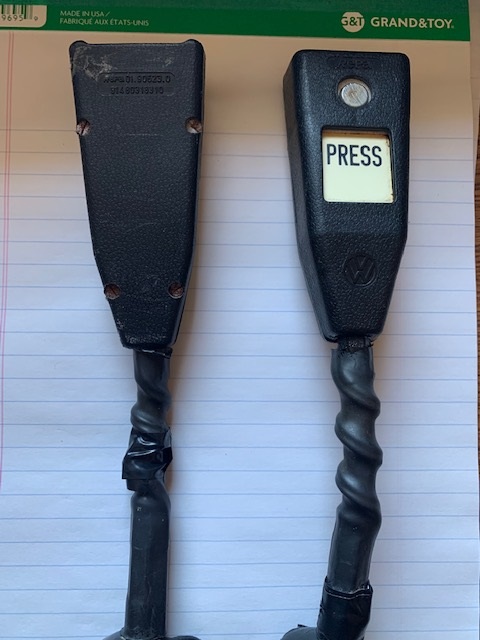

I did a search but didn't see any posts showing the disassembly/reassembly/restoration of the female seat belt receivers. Mine are pictured below. I've ordered new stickers but would like to replate the screws on the back and the main steel portion (mine were very corroded where they bolt into the car; I put POR15 on them a couple of years ago but I'd rather disassemble, media blast and replate the whole thing). Any advice based on past experience with disassembly/reassembly would be much appreciated (as always).

johnhora   Just remove the 4 small screws you see on the back...   Nov 15 2019, 01:15 PM

johnhora   Mark.. It's really not too bad of disassembly ...   Nov 15 2019, 03:05 PM
doug_b_928   Thanks, guys. I took one apart and per Jonhora th...   Nov 15 2019, 04:24 PM

doug_b_928   I finally had some time to complete the restoratio...   Dec 7 2019, 10:27 PM

doug_b_928   @90quattrocoupe Thanks, I'm really happy wit...   Dec 8 2019, 10:18 AM

doug_b_928   Thanks. Brent Brock taught me about DigiKey for e...   Dec 8 2019, 10:32 AM

bbrock   Nice work Doug :trophy: Thanks for the tip on the ...   Dec 8 2019, 02:45 PM
doug_b_928   Thanks, Brent. I should add that I also washed wi...   Dec 8 2019, 05:27 PM
Rob-O   How did you replate the section that bolts to the ...   Dec 8 2019, 07:24 PM
doug_b_928   How did you replate the section that bolts to the...   Dec 8 2019, 10:33 PM
