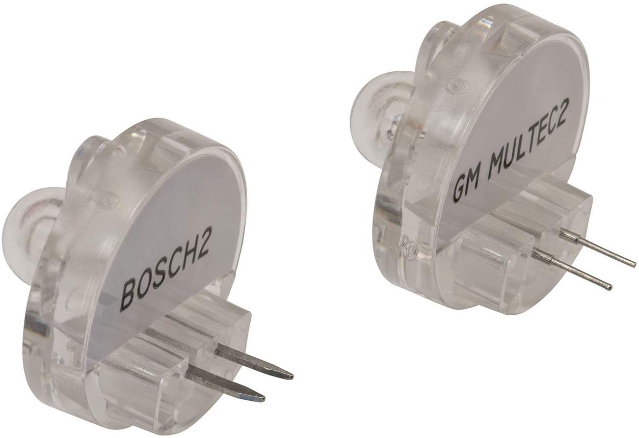

I found these on amazon. Anyone use these before?
OEMTOOLS 27319
OTC 6266

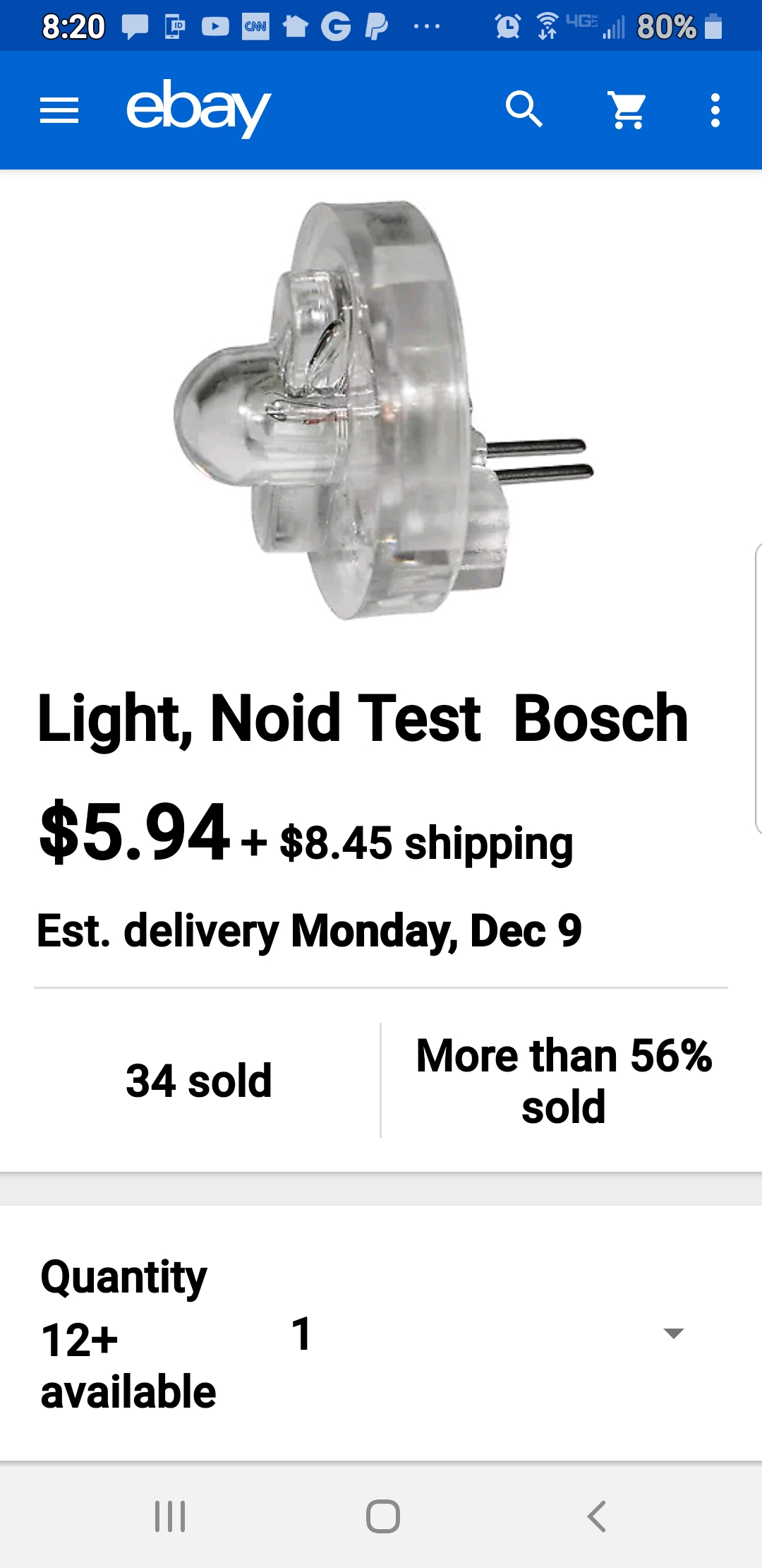

Saw these on ebay
