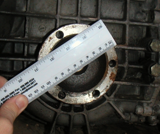

So I'm just starting to put a 915 trans in my Stretched Vanagon and I'm contemplating how to make the bus CVs fit the 915 transaxle.
The 915 transaxle has 108mm flanges with four 10mm bolts and two roll pins. What I want to connect to are bus CV's which are 100mm with six 8mm bolts.
So from previous threads I think I understand that the early 911s used the bus CVs, but I'm not completely sure. If I were to get flanges from a 1975-84 911, would they bolt up to my later transaxle? Would the CV side be a 100mm six 8mm bolt setup?
This really makes me wish my ETKA covered Porsches, sure is nice for VW and Audi.
Also, does anyone make CV spacers for the 100mm CVs or do I have to machine them myself? I need about 3/4" spacing per axle (unless I find a longer axle).
I could machine one adaptor to do it all in one, but I'm a slow on the lathe and would prefer the simplest solution.

Pic of my 915 flange attached:

The 100MM 6 bolt flanges sound like the ones used for the 944 axle conversion on a 914. Try finding the axle flanges from a 75-76 vintage 915 tranny. They are coarse splined, but they will fit the 100mm 6 bolt axle.

QUOTE (ClayPerrine @ Jul 3 2005, 05:07 AM)

I'll be looking for 75-76 flanges then. I guess a trip to HPH and WEVO are on the list tomorrow.
