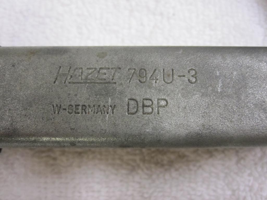

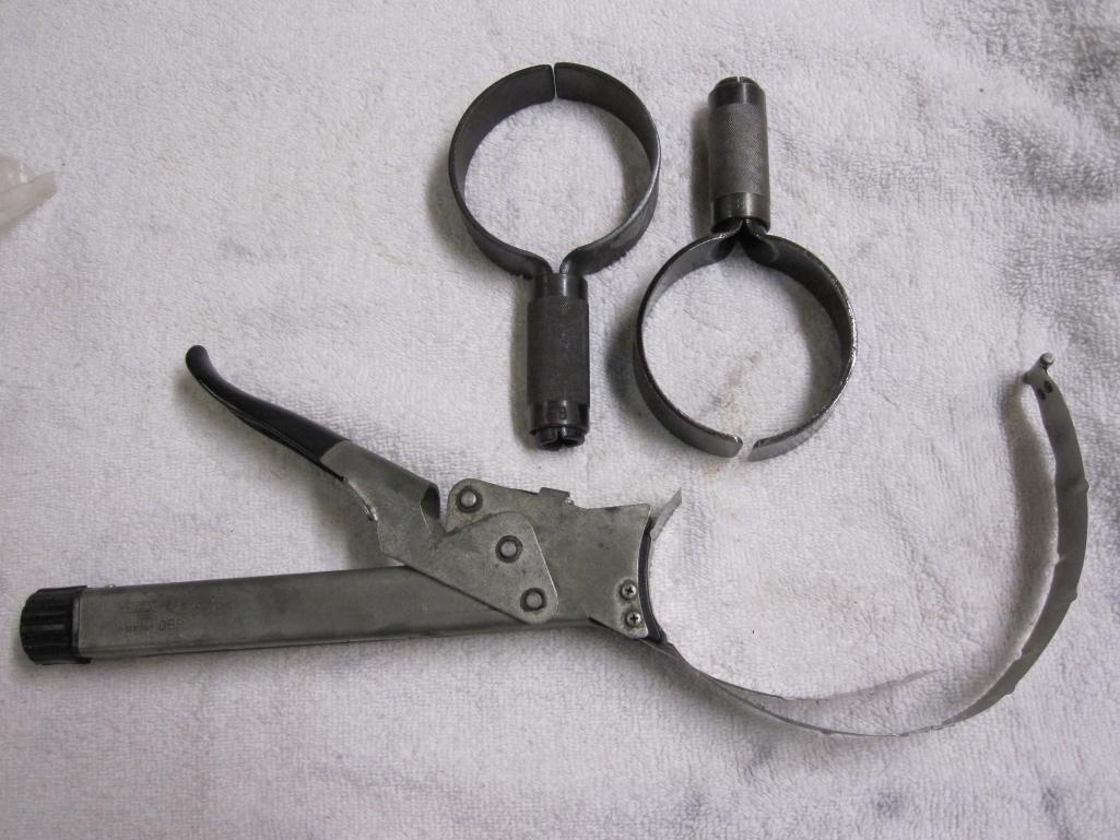

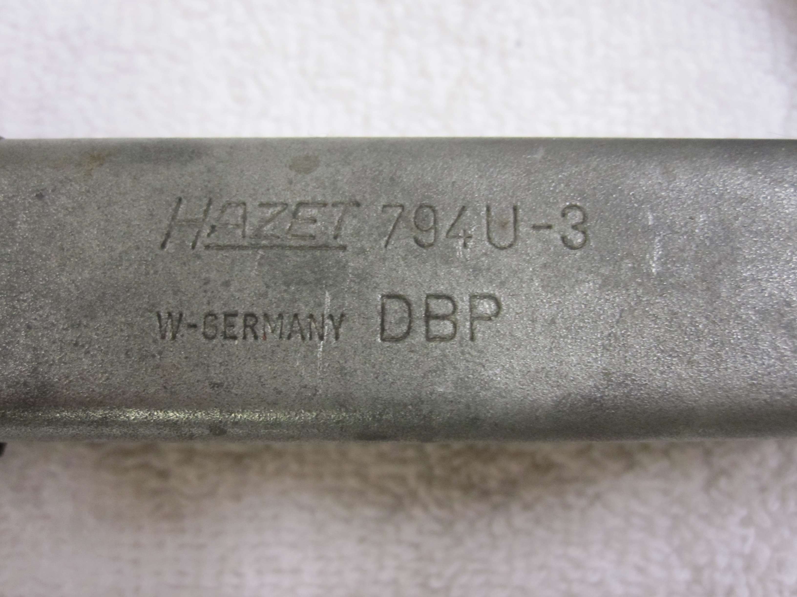

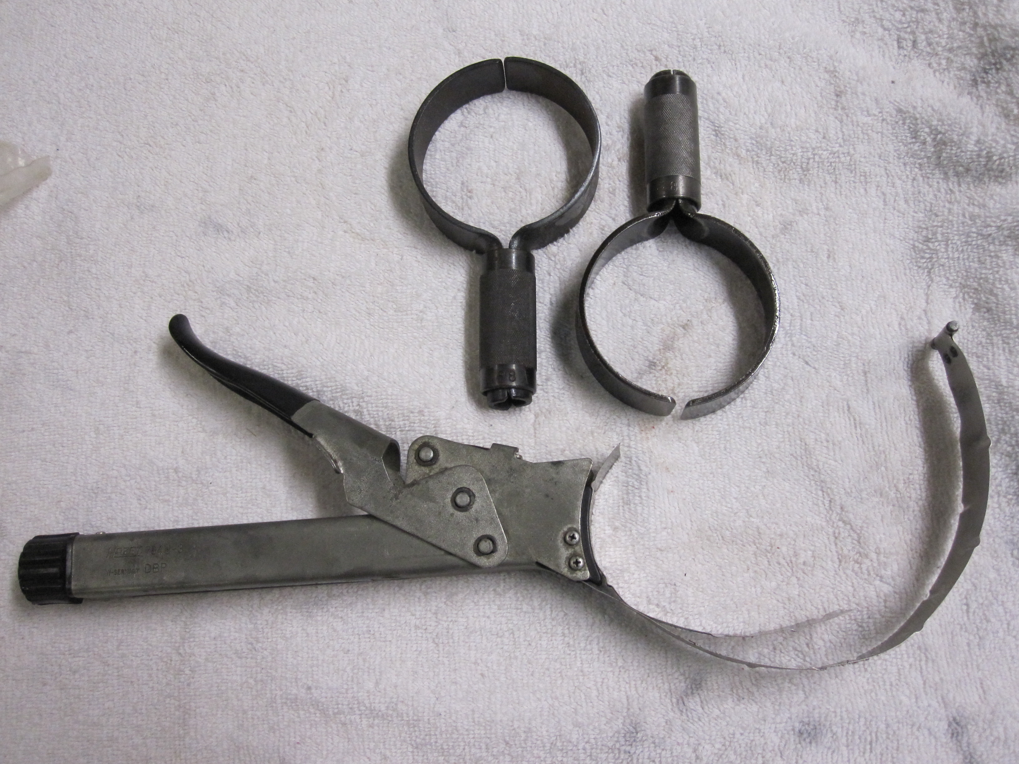

rgalla9146
post Dec 19 2019, 08:04 PM
Posts: 4,996
Joined: 23-November 05
From: Paramus NJ
Member No.: 5,176
Complicated and simple.
Both work.
The Hazet adjusts to any diameter.
The smaller ones are factory but you'd need a different one for each bore.
Mark Henry
post Dec 19 2019, 08:17 PM
that's what I do!
Posts: 20,065
Joined: 27-December 02
From: Port Hope, Ontario
Member No.: 26
I have a bunch of the top ones for T1 and 356, I've never found them for T4
