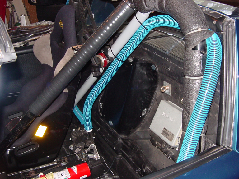

mepstein   Behind the driver or passenger seat most often. O...   Dec 19 2019, 08:31 PM

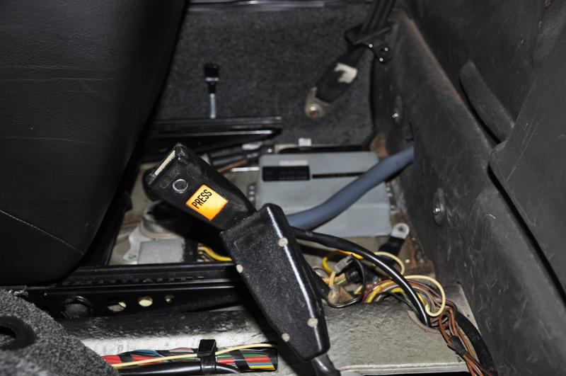

ClayPerrine   I put mine under the foam block on the passenger f...   Dec 19 2019, 09:04 PM
Tdskip   I put mine under the foam block on the passenger ...   Dec 19 2019, 09:06 PM

Steve   Mine fits perfect behind the drivers seat. I use ...   Dec 19 2019, 11:23 PM

Cairo94507   Mine is under the driver's seat. Definitely w...   Dec 20 2019, 02:19 PM

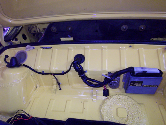

SKI-HI   Mine is in the rear trunk. Stock harness ,works ...   Dec 20 2019, 07:15 PM
