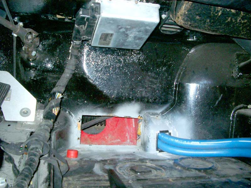

http://www.914world.com/bbs2/index.php?s=&...st&p=883879The PMS harness was actually long enough to mount the brain horizontally under the dash in the position where Mark is holding it vertically in the picture.
We mounted it on a custom frame using rubber isolators to counteract vibrations.
It's tucked away so nicely that you can't see it at all unless you get your head under the dash ...

@ClayPerrine @mepstein http://www.914world.com/bbs2/index.php?s=&...st&p=893545
