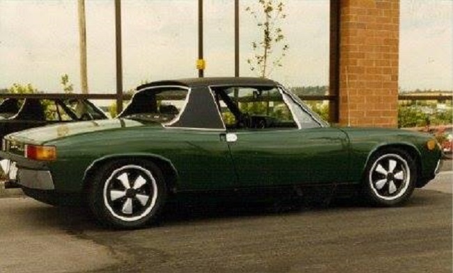

rolling start race with a 70 Z/28 stop light to stop light almost 1 mile..
MY SIX ralph meaney 2.4 special...boy was that guy pissed at the red light..twice..ya I was 22..

QUOTE(sixnotfour @ Dec 25 2019, 03:08 PM) *
Not bad for a 914 but . . . 1970 Z28 is 0-60 in 5.8 sec per Car and Driver archive. Not at all fast by modern standards.
For reference a 2019 Toyota Camry XSE V-6 does 0-60 in 5.8 seconds.
The world has changed.
I do like that your 2.4L was around a 6 second car. I'm building up a 2.4L with roughly that 6 second goal in mind. Not that I'm expecting to win and drag races, but rather that I can at least keep up with the modern cars. I'll pass em' later when the road has some turns! (IMG:style_emoticons/default/biggrin.gif)
