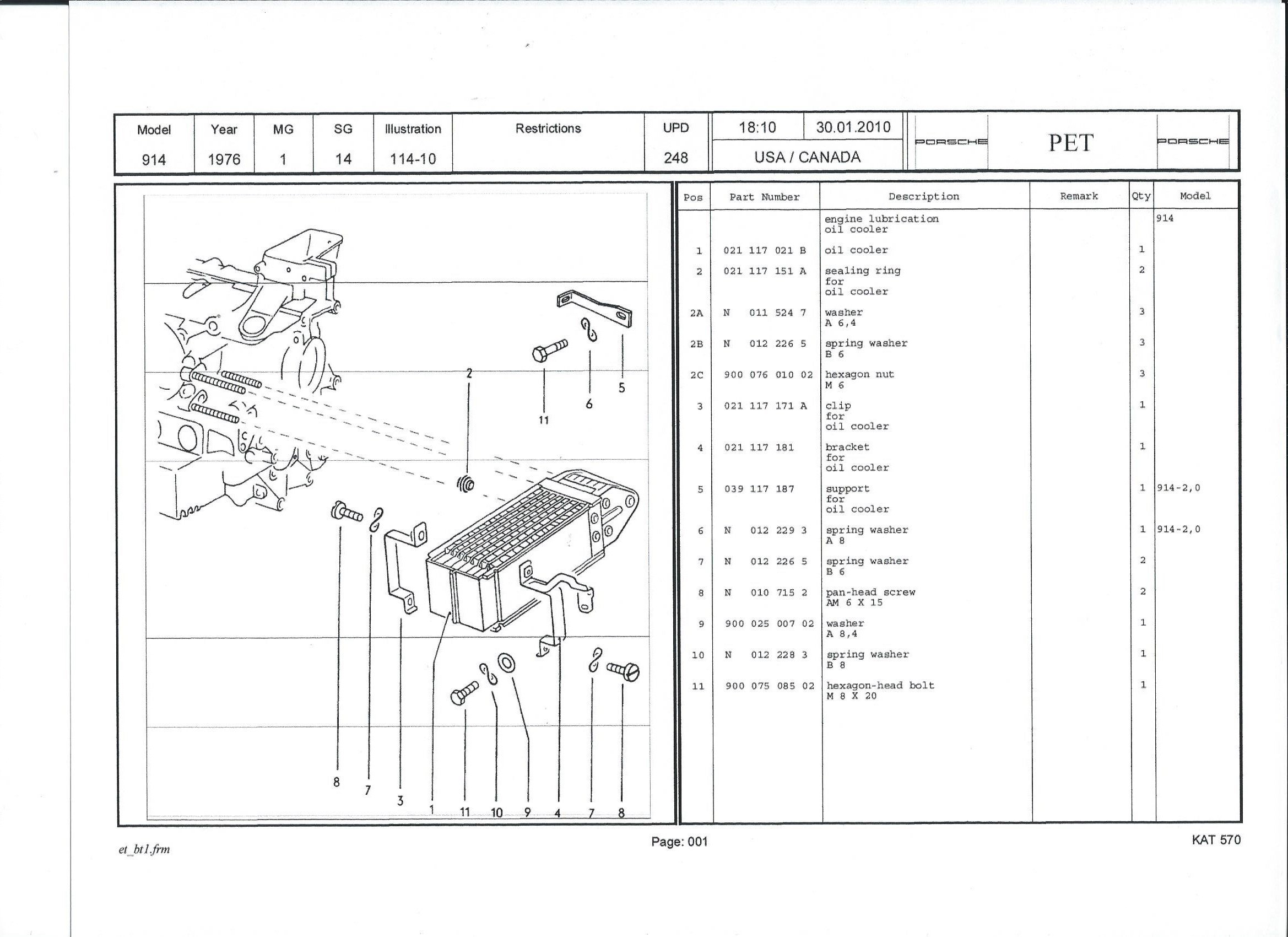

Resigned to pulling the motor to find and fix oil leaks. Ordered the Tangerine plate and it really doesn’t look too bad. Heck, we were halfway there just doing clean up.
In looking at a manual we have, it mentions a washer between the oil cooler and the block. I don’t see this on the parts diagram, and when we did the seals I didn’t see one up there. So-washer or no washer on the studs behind the oil cooler??? Also-once we get the motor out, can we just set it on milk crates or build a simple stand? Don’t really want to invest in an engine stand. Merry Christmas and TIA Rob |

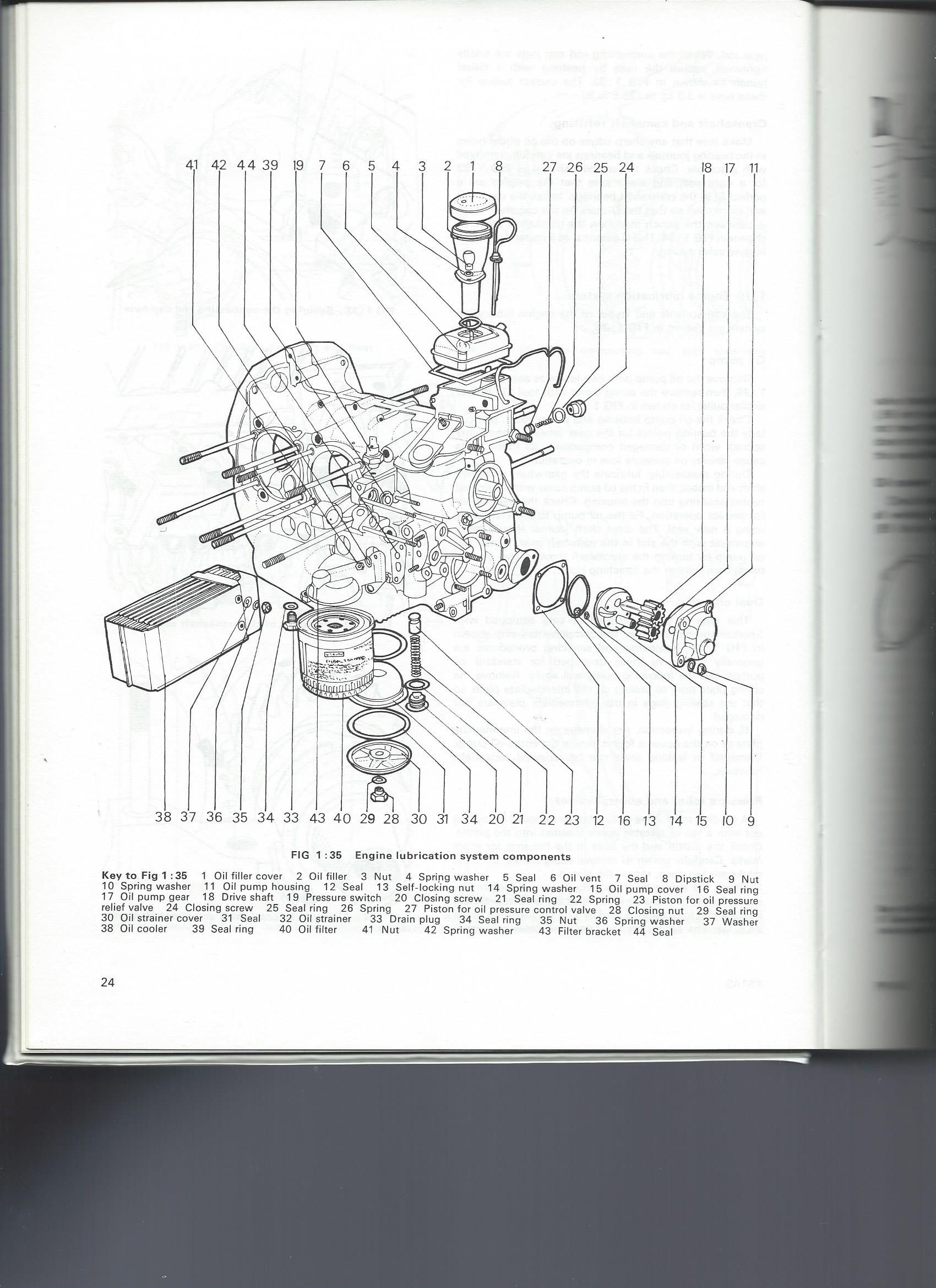

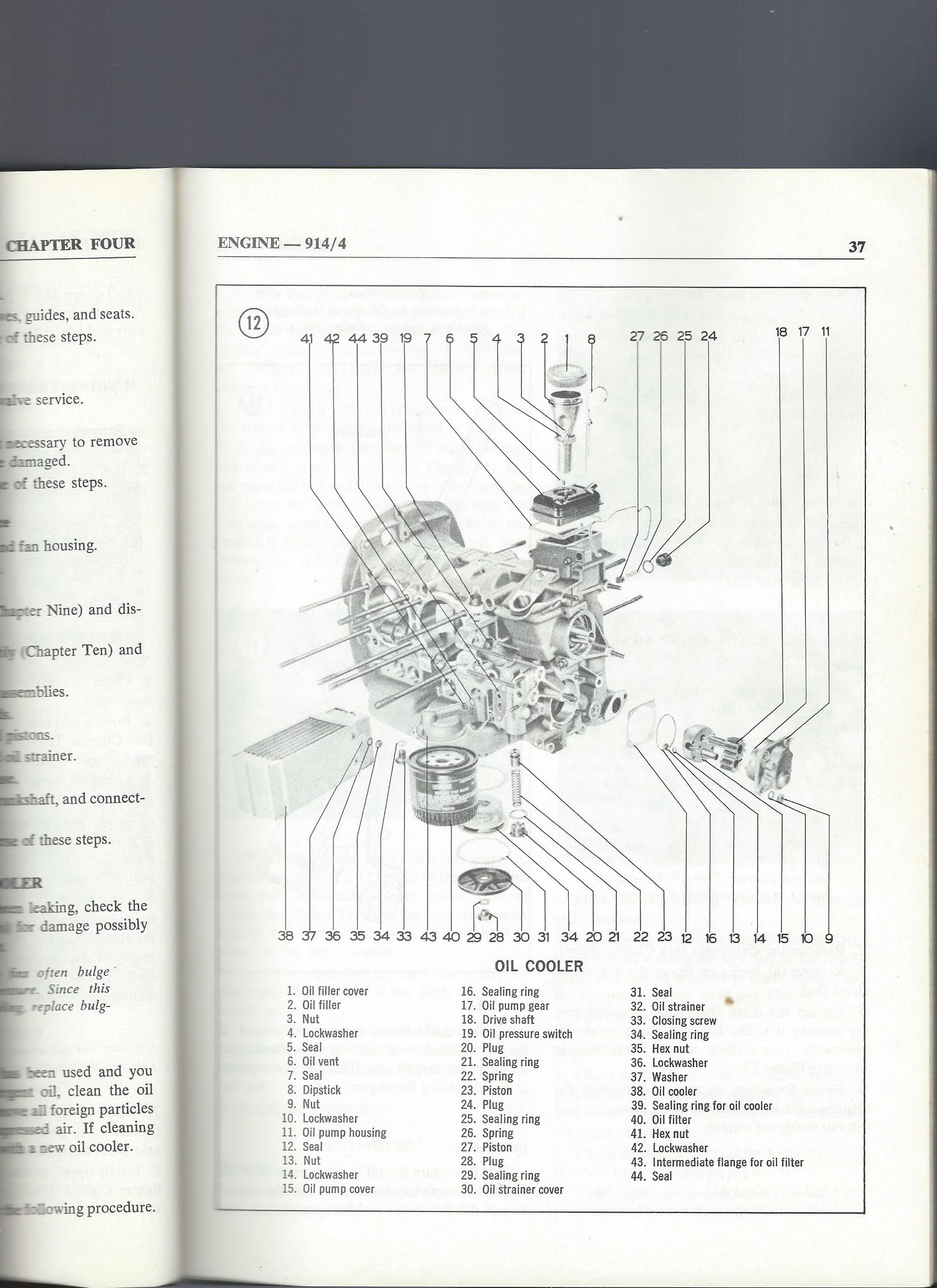

mepstein When I did it a couple years ago, I was confused b... Dec 25 2019, 08:36 PM
djway Early VW engines converting to later doghouse cool... Dec 26 2019, 12:28 AM
maf914 A few scans to help with the hardware question. L... Dec 26 2019, 07:31 AM
maf914 Many years ago, I disassembled and reassembled my ... Dec 26 2019, 07:41 AM
IronHillRestorations I ran into the washer discrepancy after my first r... Dec 26 2019, 08:37 AM
