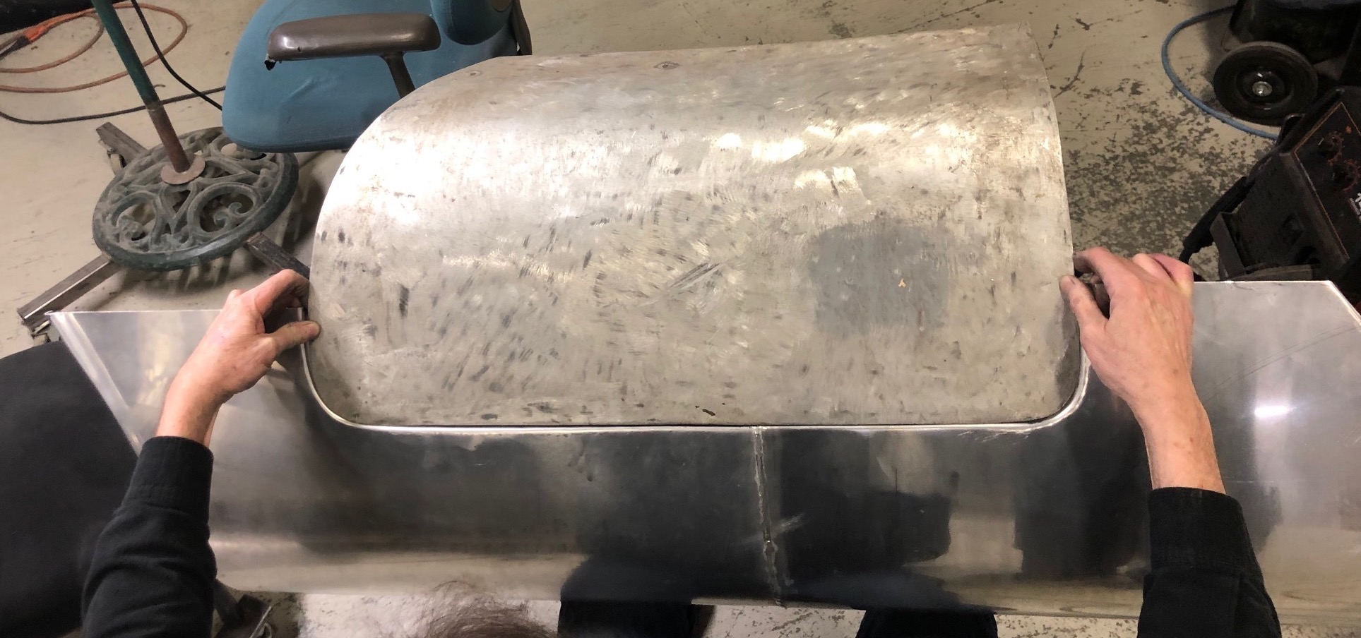

We have a 110 Mig, cost about $500. Takes the big spool of wire and does a pretty good job. Now I need to learn to tig since I'm doing aluminum.

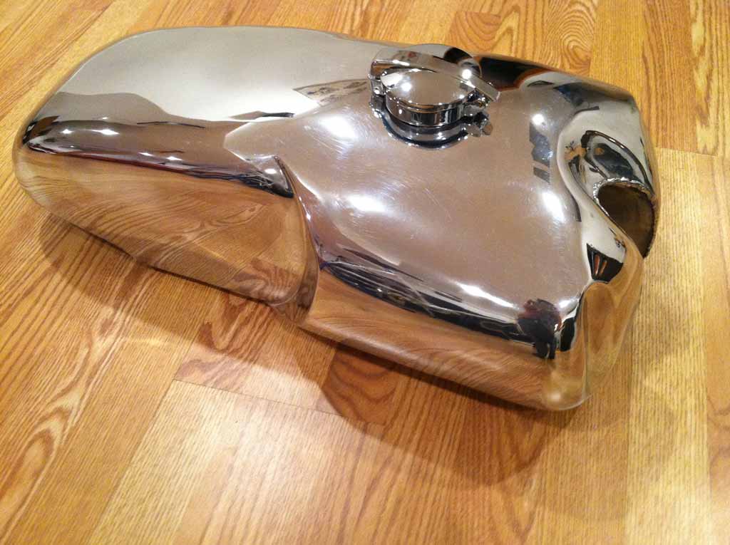

You can MIG aluminum. Ideally you use a spool gun. I've done it on an el cheapo Daytona MIG without a Teflon liner in my MIG cable but did have to work my way though jambs, birds nests, roller slippage, etc. But it can be done in a pich.
Don't overlook OxyAcetylene gas welding as another possibility. You will need special aluminum flux (very cheap) and you will need special welding glasses with a different tint to filter out the more yellow-orange flare from the flux in order to see the weld puddle. I got mine from Tinman. They are pricey but they work great!
https://www.tinmantech.com/products/safety-...elding-lens.php
This tank was gas welded.
Lots of knowlege and resources on Tinman if you're not crossed this site before.
https://www.tinmantech.com/education/articles/

So far we've been doing tig, it comes out nice, the aluminum is thin. Not the best pic but you can see the seam in the middle. Thanks for the tip on Tinman, I'll check it out!
