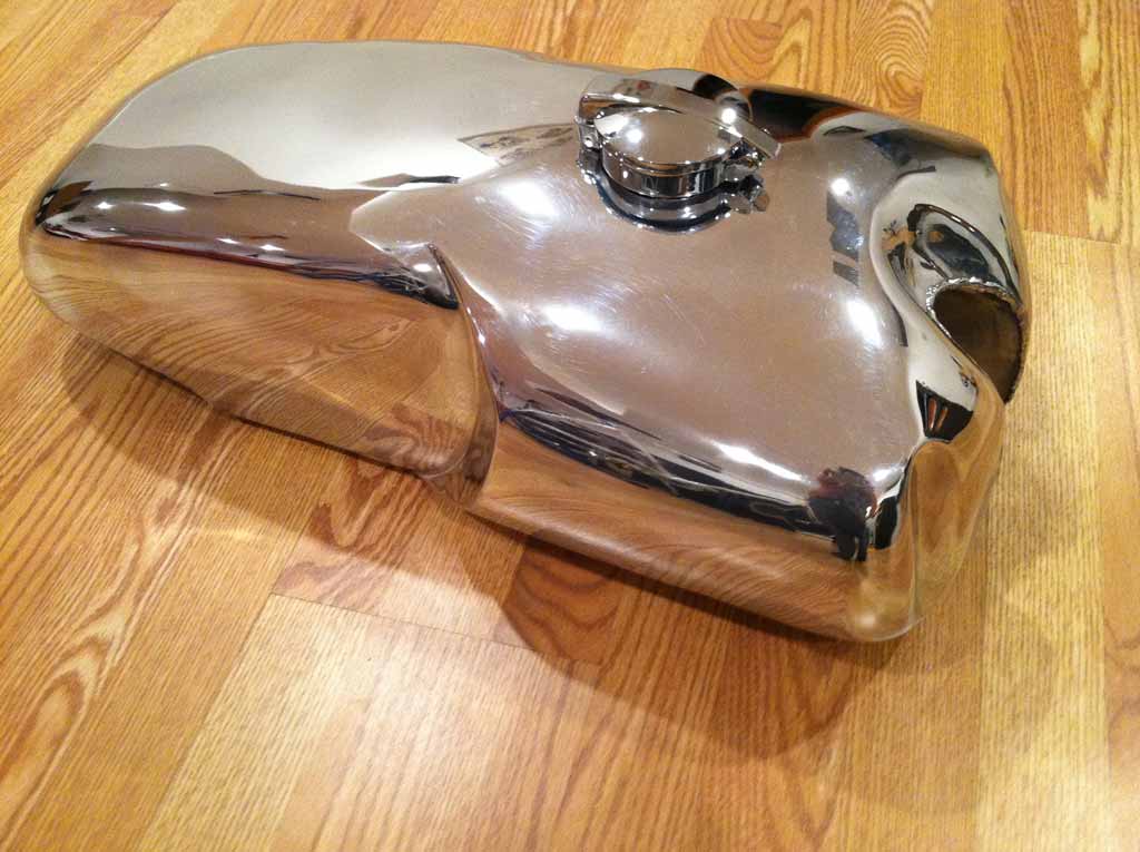

Don't overlook OxyAcetylene gas welding as another possibility. You will need special aluminum flux (very cheap) and you will need special welding glasses with a different tint to filter out the more yellow-orange flare from the flux in order to see the weld puddle. I got mine from Tinman. They are pricey but they work great!
https://www.tinmantech.com/products/safety-...elding-lens.php
This tank was gas welded.
