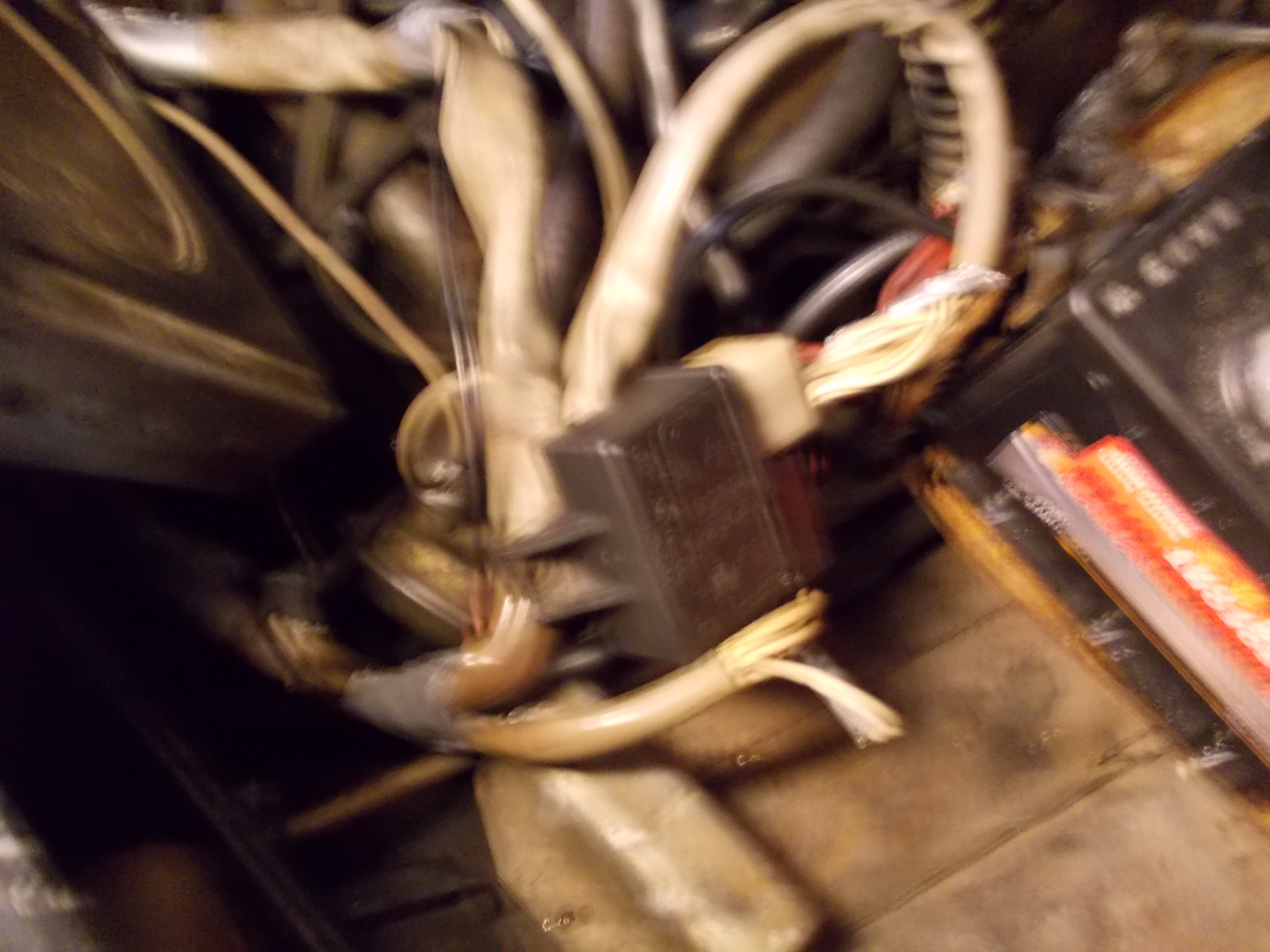

Hello here are some pictures of my engine

Hello, I have problems with the setting of pictures, but what can be to blame that the pump runs when I turn the key in the ignition lock without the fuel pump stopping working if the engine does not start. What could that be? I am so desperate and in the end I don't know what to do. Am considering whether I should not convert to carburetors if I get stuck here? Can someone give me a recommendation whether the double carburetor would be a better choice and how I can finally get the car moving? How well does a 1.8 L engine with double carburettor run? If someone sees the pictures of my engine I can send them to you by e-mail, then send me your e-mail. Kind regards Leon
