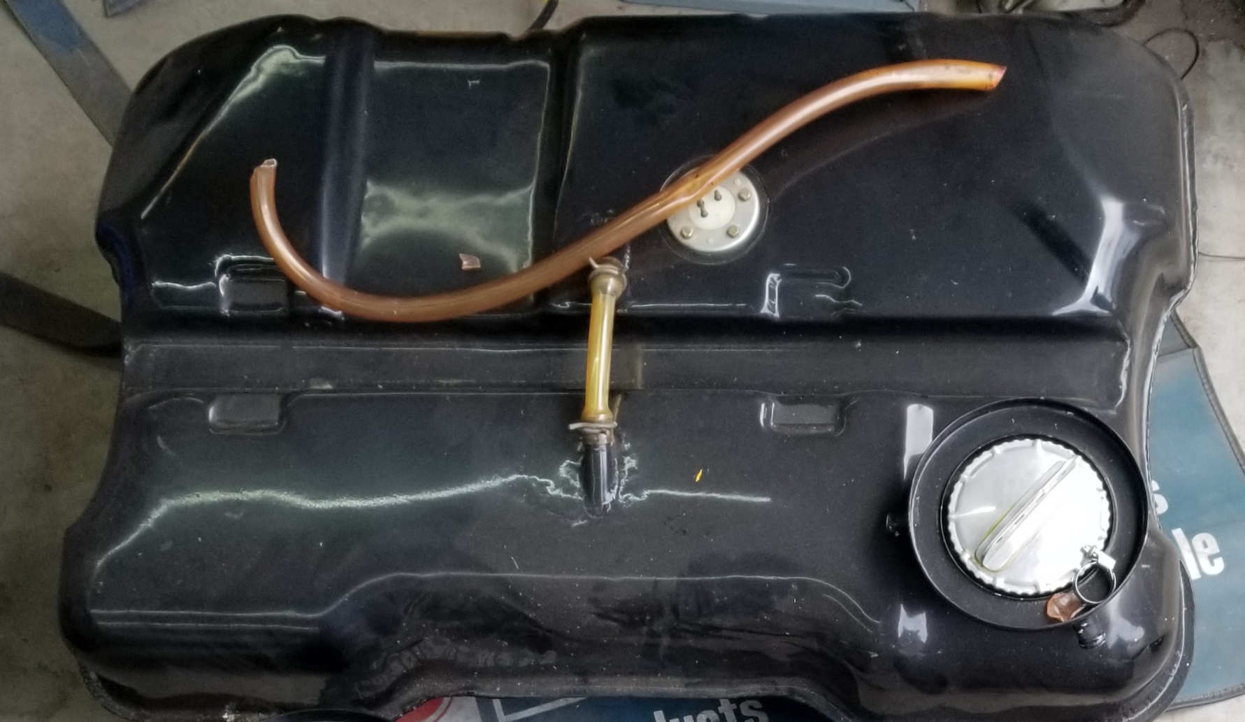

I've been around fuel cells and know that they require maintenance and replacement of the bladders...but this is on a customer's gt build; foam baffles inserted into the 100L tank. Yep...correct, several years ago these were inserted into the tank , I can only guess for keeping the slosh down and now these have disintegrated inside the tank.
Any fuel tank gurus out there, I know that cutting the tank open/and fabricating it back together is an option, but looking for solutions.Attached Image

cut up cubes or balls ..stuff through filler neck....there is no any reason to cut the og tank or make a replacement......I did it on a Cobra...
Thanks for that tip...will attempt in the next couple weeks. Msds customer will be a very Happy Camper !!!

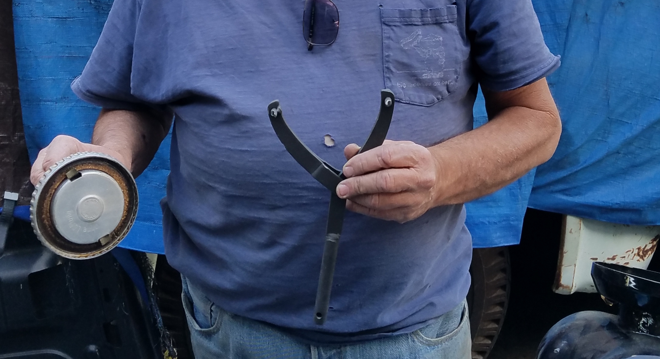

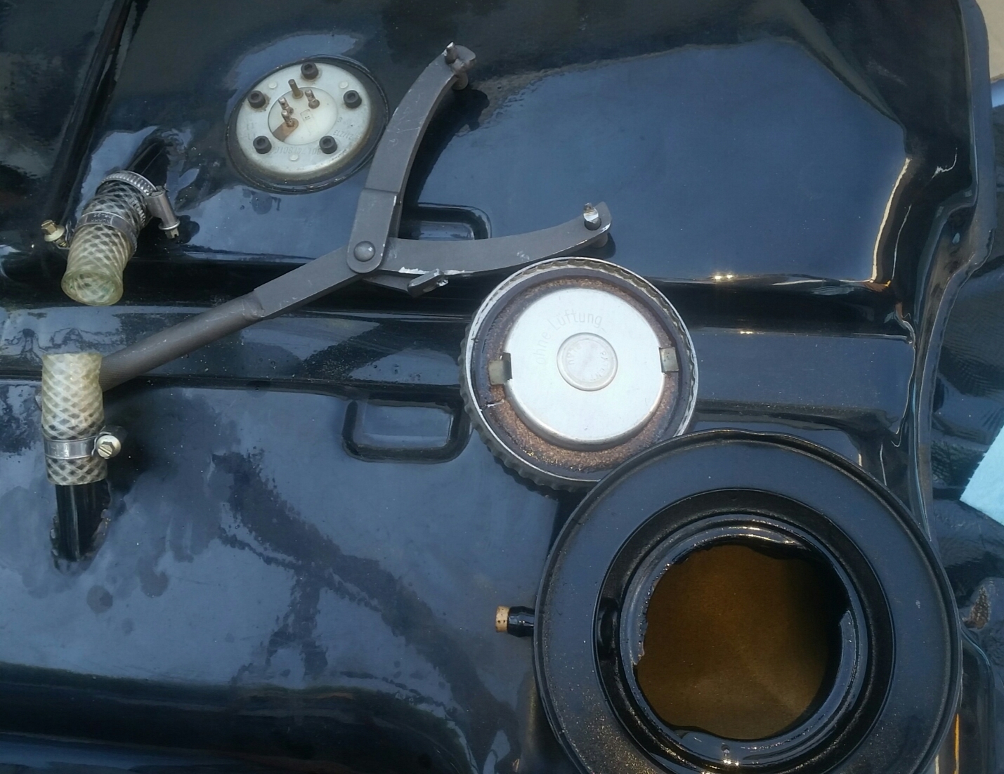

Next up is the 2nd tank...it has a filler cap that has "Mated" itself to the filler neck...won't budge and we are not looking to butcher it off of its resting place either (IMG:style_emoticons/default/sad.gif)
We came up with soaking the filler neck with pB blaster for a week, and trying to wrench it off with a toothed-neoprene belt ; no-go.
More pB soaking, and another few days with the tank inverted for more soak...nada

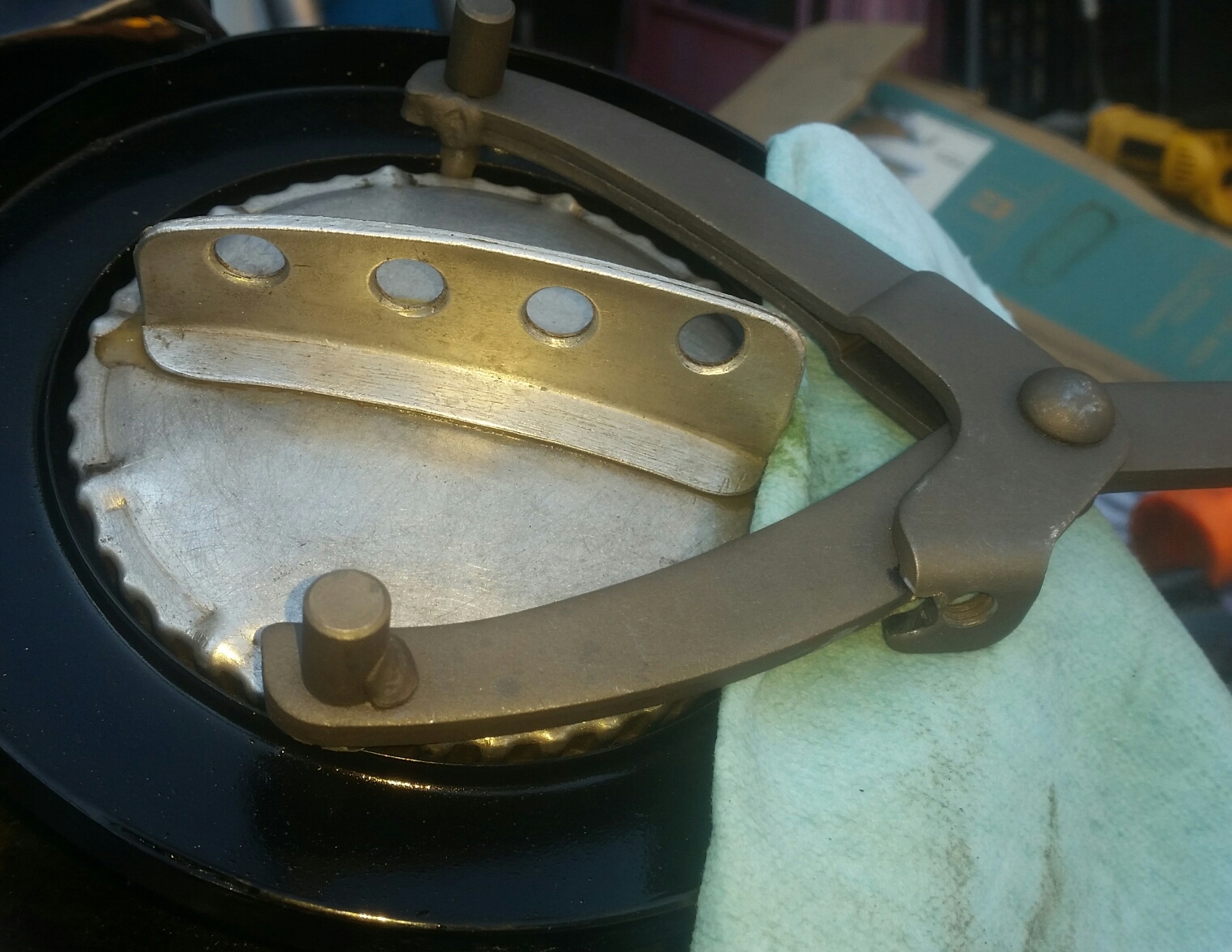

So my bud found an adjustable "Pin" wrench online, did a bit of custom contour grinding and presto >> hit the jackpot.
Maltese Falcon
post Feb 1 2020, 08:45 PM
Posts: 5,073
Joined: 14-September 04
From: Mulholland SoCal
Member No.: 2,755
The right tool gives the right result, like this...

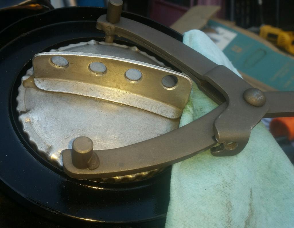

Modified the pins with a small abrasive Makita disc, so the tool can rotate within the confines of the filler neck
