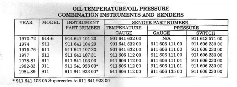

You need the correct early 911 sender.

How early is early? I just removed one from a 2.0/6.....it works, but not with my later VDO gauge....

maybe this will help

Hmmmm, no serial number on the oil temp sender...it DOES have 11/67 on the side. I assume that is a build date. It's yours for the cost of shipping if you want to try it.
The one that "I" needed cost 45 bucks... (IMG:http://www.914world.com/bbs2/html/emoticons/blink.gif)

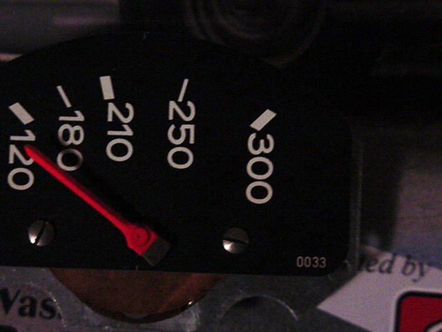

i have a euro gauge i've wanted to put in for some time. only number i can find is 0033. you can't see it when the unit is in the housing. 0033 isn't listed in that chart geoff. any ideas? (IMG:http://www.914world.com/bbs2/html/emoticons/confused24.gif)

well i guess i could do that. (IMG:http://www.914world.com/bbs2/html/emoticons/rolleyes.gif) or, just call north hollywood speedo, give them the numbers and see what they suggest. or, spend $500 and buy one of their gauges ready to go. (IMG:http://www.914world.com/bbs2/html/emoticons/sad.gif) yes aaron you just have to know which one is the appropriate sender. (IMG:http://www.914world.com/bbs2/html/emoticons/wink.gif) it doesn't screw in. you have to pull the taco plate to access the retaining nut on the backside, and then figure out what you will use for the gaskets that are nla.

mike, if you have a couple of diff senders i would sure enjoy pulling the taco plate numerous times. then converting *c to *f with my rectal thermometer. sorry for the (IMG:http://www.914world.com/bbs2/html/emoticons/hijacked.gif) dave. if you can get the numbers off the gauge north hollywood can prob set you up with what you need www.nhspeedometer.com.
