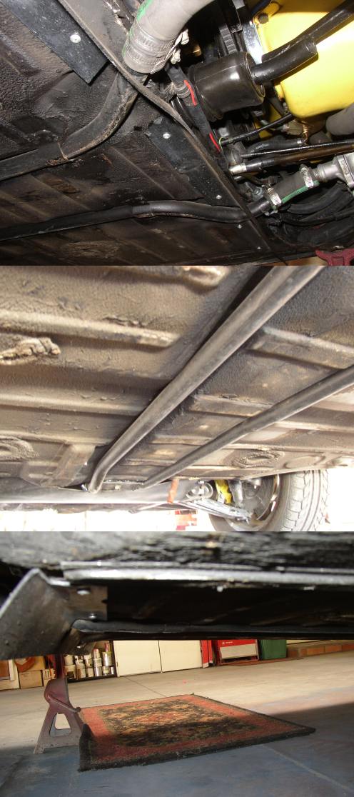

The attached pic may give you some ideas. It shows the a/c lines secured to rockers as well as their routing through the wheelwells. With the holes cut in wheel wells for air exhaust, my a/c guy routed dryer hoses through this opening. I guess something similar could be done with water hoses, just keep in mind the water hoses are about twice the dia. of a/c hoses.
I guess you could split it up and run one water hose one each side of car.
Note: if you look close, you can see my water lines routed on bottom of chassis.

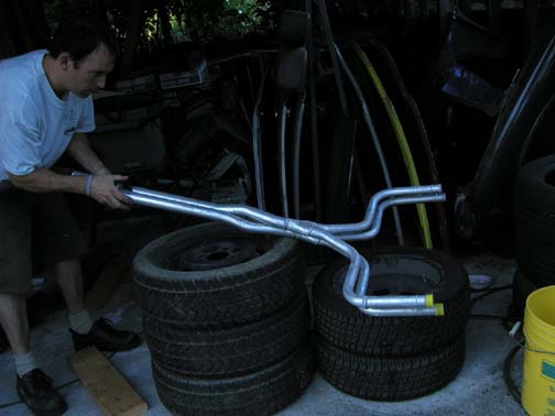

FYI, here are aluminum Boxster lines (dual rads).
(IMG:http://www.914world.com/bbs2/html/emoticons/agree.gif) what Andrew said, it's all personal pref..
The rockers are a great location UNTIL you come to the front wheel wells...

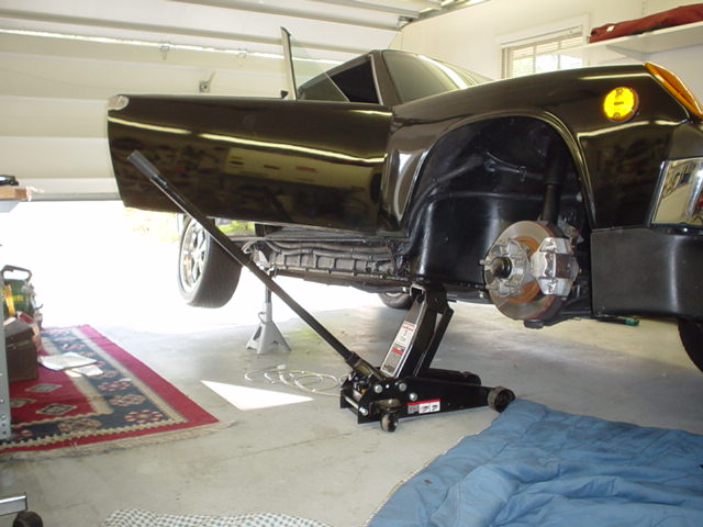

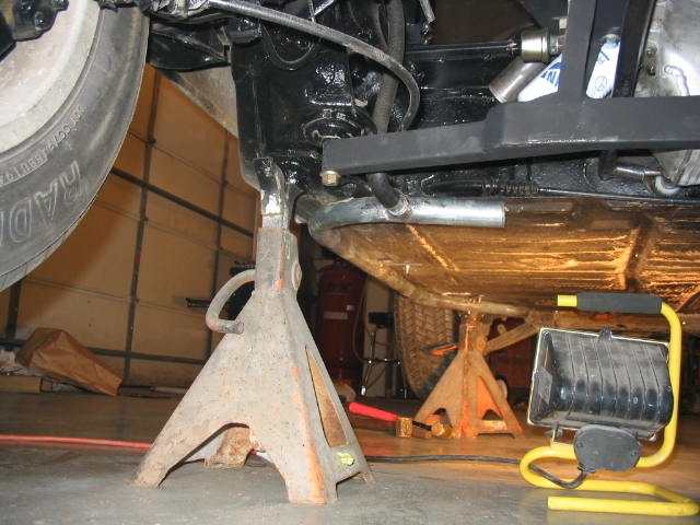

A few pictures of my lines. 3/4" steel pipe. The scrape marks toward the rear are from using the floor jack to raise up the car. The pipes fit up close enough that they are nearly hidden from view. I go over speed bumps all the time. I take it easy, not worrying about the pipe but more clipping the engine bar or my front spoiler.
