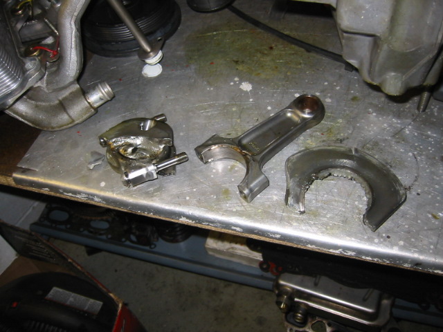

this rod had to much knock (IMG:http://www.914world.com/bbs2/html/emoticons/laugh.gif)
