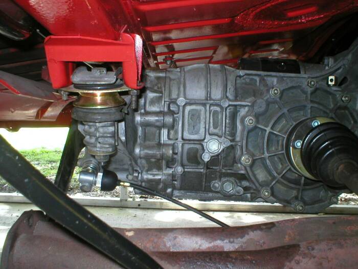

I was reviewing the engine-drop article in the 914 info section and noticed that the tranny mount, below the rubber donut, is different that the one on my car, it appears to be opposite of mine, should I flip the one that I have?
Here's a pic...

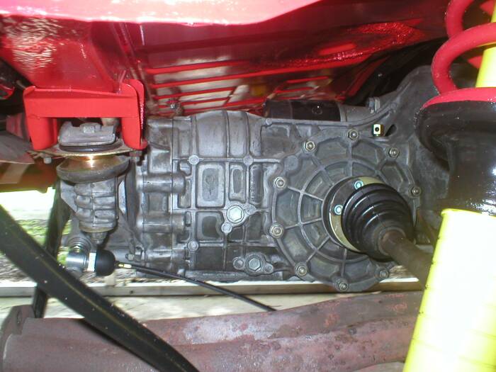

Seems to me that you have that half doughnut shaped washer upside down. Here is a picture for reference, it's not easy to see but you can tell.

DAng Rob that is SOOOO Clean. But yea the big round cup looking thing is upside down.

Look below....

Thanks guys, that's what I thought. After looking over the pics I took when I drop the engine, they've been positioned that way since I've owned the car.

Hey Joe, notice the previous post references the pics I took during the engine drop, i.e., before you rebuilt the engine, no blame there, just wish one of us had noticed the inversion.
Anyway, I spent about 30 min removing the tranny mounts and flipping the donut, thanks again guys for confirming the position.

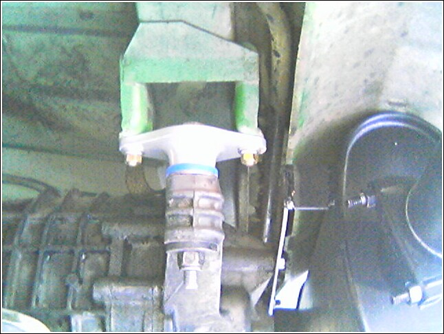

need to get a set of these puppies....easy install (IMG:http://www.914world.com/bbs2/html/emoticons/smile.gif)

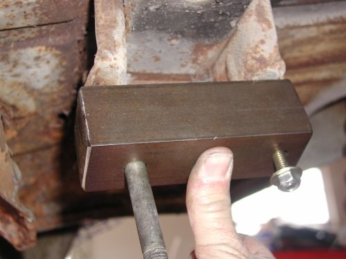

Shhheeeesch.....solid mounts are the way to go....not like yer taking Mom to the grocery store..... (IMG:http://www.914world.com/bbs2/html/emoticons/cool_shades.gif)

This is going to be the solid mount for the German 8 Tor. The trans is set back some as you can see by the bolt. This photo was when it was in mock up on the Banana
