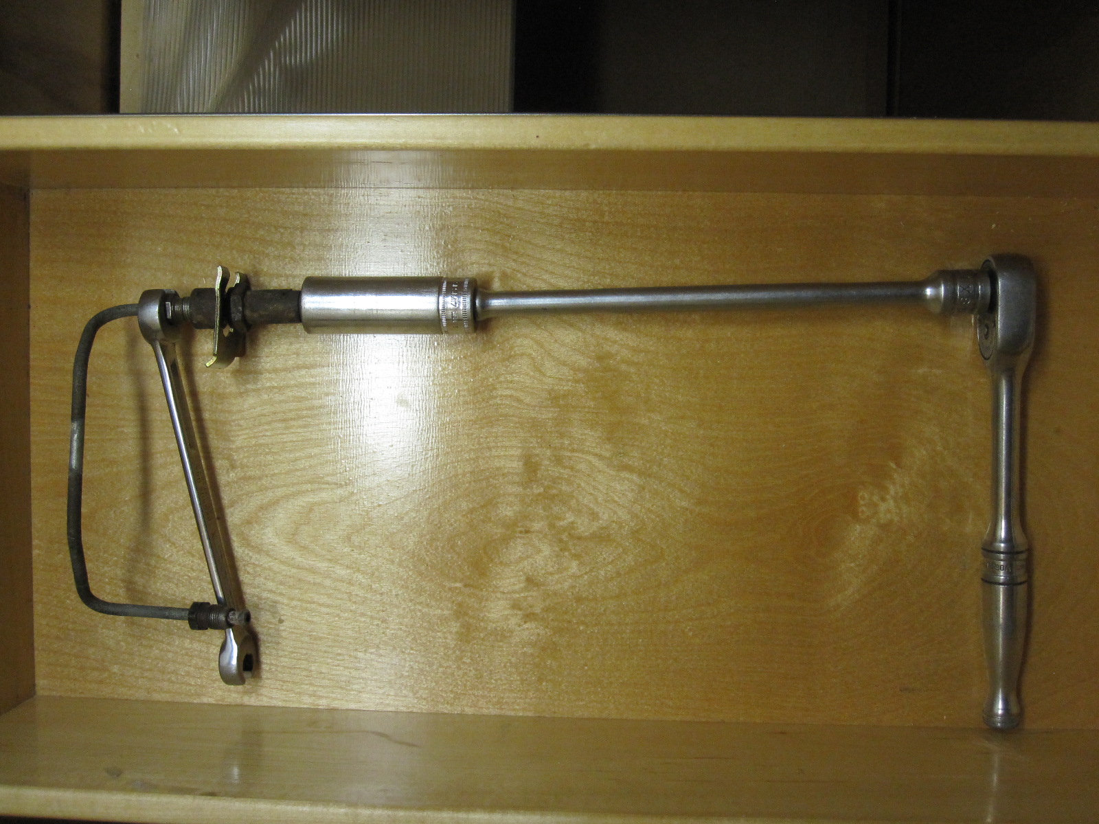

If your replacing the soft line the cut and socket works just fine.
But please use a proper flare nut wrench.

QUOTE(914forme @ Jan 19 2020, 08:55 PM) *
When the going gets tough I get the proper tool.
But then I am a toolaholic, that is the first step to recovery. (IMG:style_emoticons/default/confused24.gif)

914forme
post Jan 19 2020, 08:52 PM
Posts: 3,896
Joined: 24-July 04
From: Dayton, Ohio
Member No.: 2,388
Your welcome Rory but I can't take the credit. These where a Slits find, RIP (IMG:style_emoticons/default/beer.gif)
