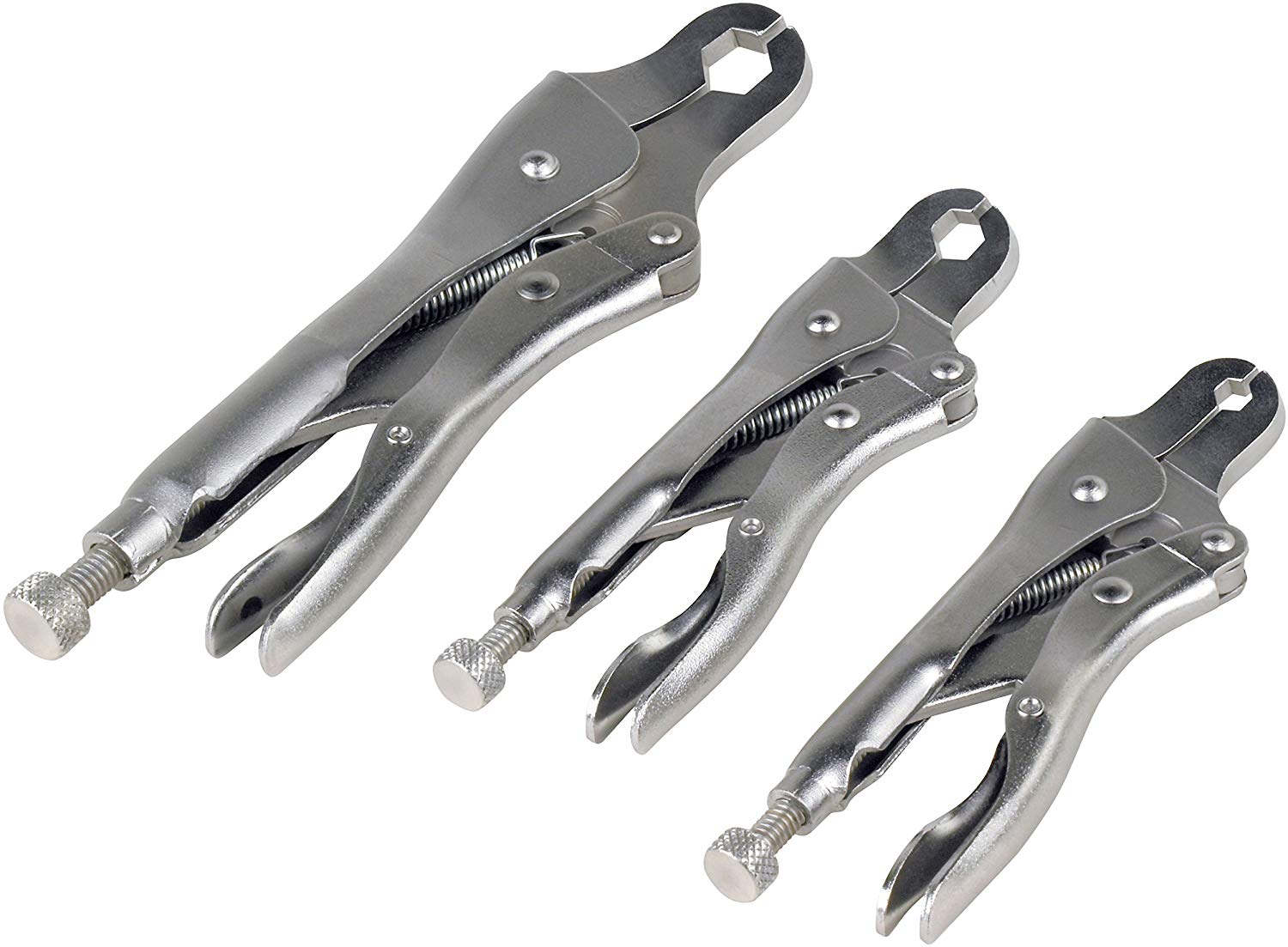

Get a medium size set of vise grips, clamp them on the end fr the soft line and use a good quality line wrench crows foot on the hard line.
https://www.amazon.com/Sunex-9710M-8-Inch-C...0/dp/B0002SRJF4
