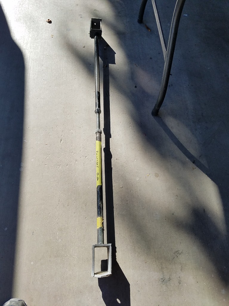

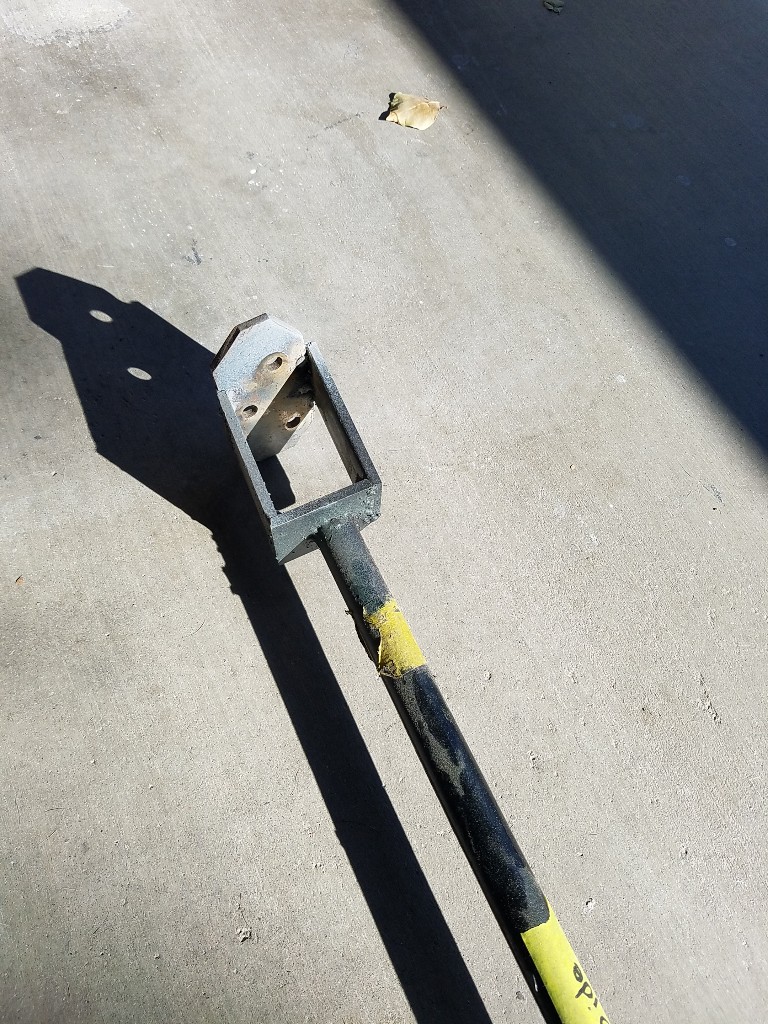

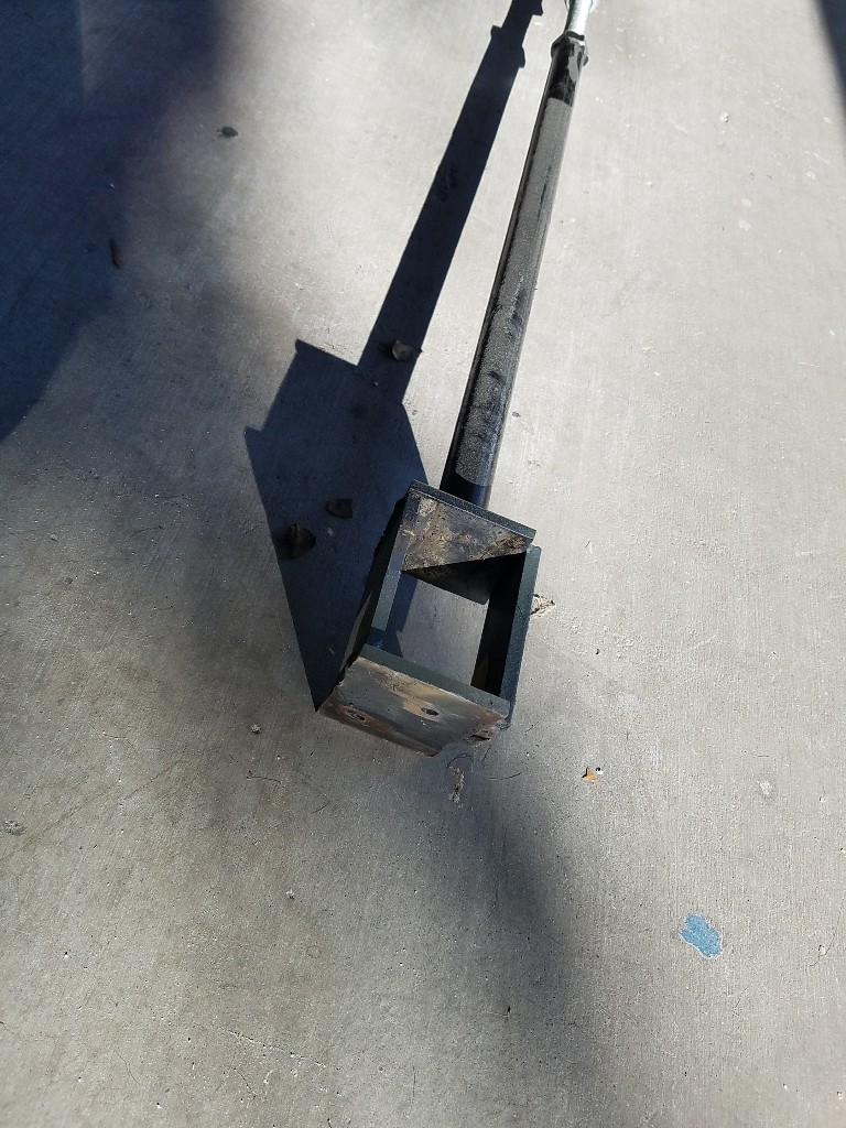

Made these from 1/2" pipe. Allthread, 1/4" flat bar stock. I am sure there are lots of other ways to make them. Each side is different. Maybe $25 in material.
