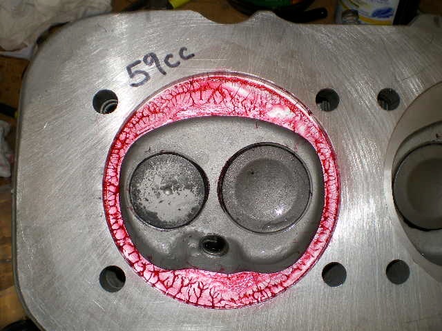

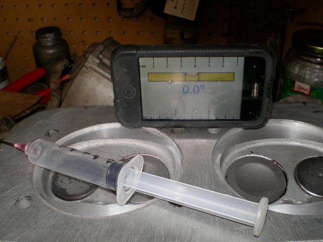

If you have a CC syringe you can level your head and use water with a drop of Dawn soap (to break surface tension) and you can measure it good enough for stock.
I made most of mine with tape, compass, drill and a jigsaw, you want at least 1/8" clear plastic. They'll look at you funny but most pharmacy's will give you a syringe, you want the biggest they have. I've always used water with a drop of soap, because most oils, chemicals, etc., will wreck the rubber piston of the syringe plunger.
I used to have a 50cc syringe, it was boss, but it wore out. Had a glass graduated burette, busted that shit.
Just CCed a pair of heads with a 3cc syringe what a PITA, I need a new syringe. (IMG:style_emoticons/default/rolleyes.gif)

I made mine pretty much like Mark did with this exception. Beside 3/16" hole for the syringe tip I drilled a smaller 1/8" hole as an air vent. Also, I use some axle grease around the perimeter to seal the plastic disc against the head. I used alcohol vs soapy water but that doesn't really matter. Feed Supply's are good places to buy a large syringe cheaply. (IMG:style_emoticons/default/beerchug.gif)
914werke
post Jan 29 2020, 12:50 PM
Posts: 11,351
Joined: 22-March 03
From: USofA
Member No.: 453
The level is a good touch.

Amazon has all the parts and stuff, if you dont have a place local. I used some food coloring because clear or light colored water was hard for me to see. Vent hole on opposite side is very helpful.
