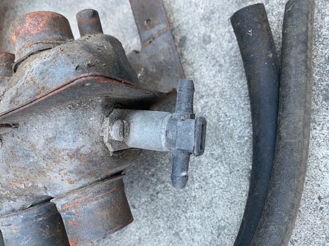

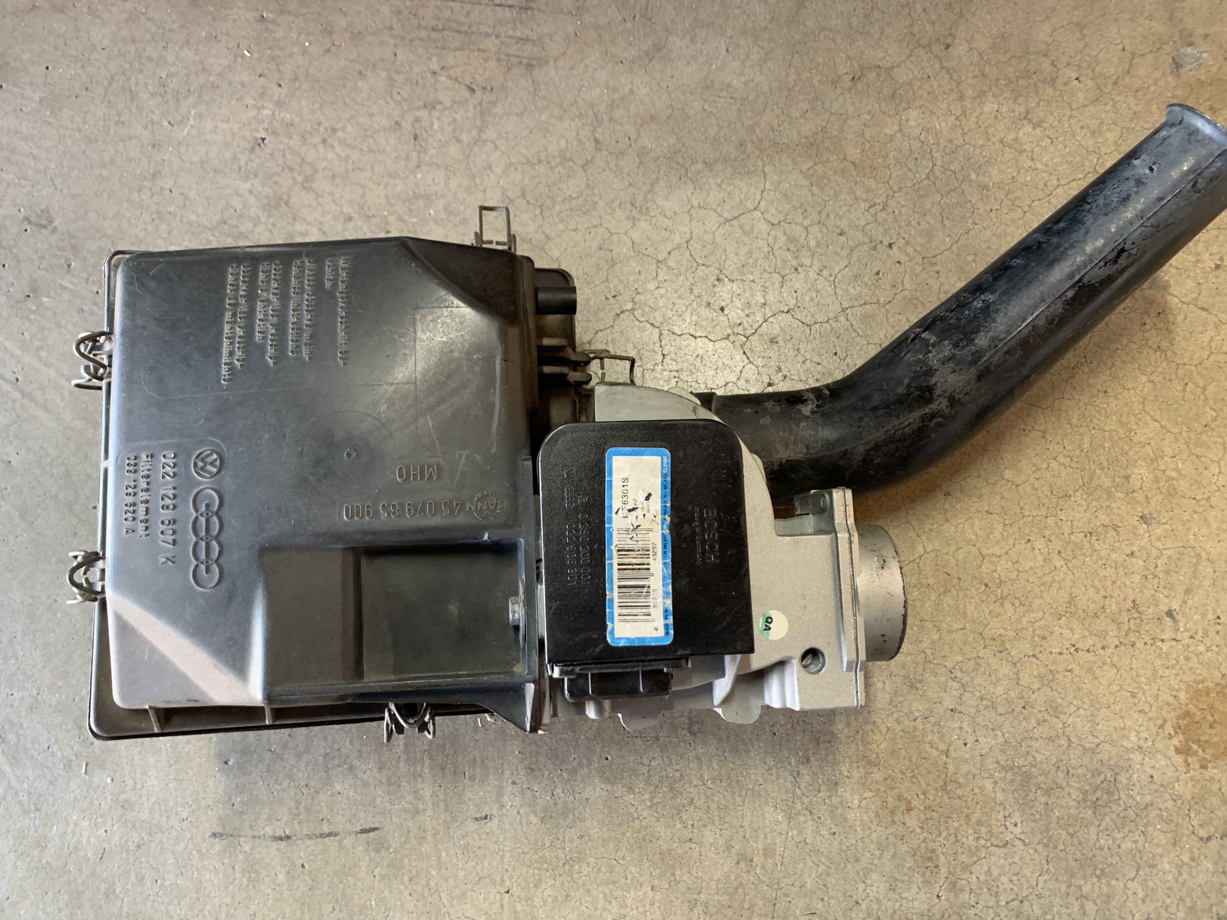

cold start valve
air flow meter

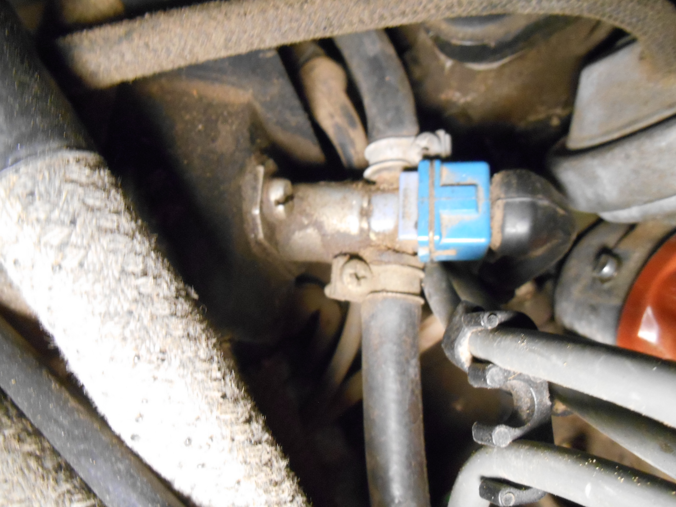

Hello, here is a pic of my cold start valve I assume it is left of the two hoses and blue electrical part inside the metal tube ???Attached Image
