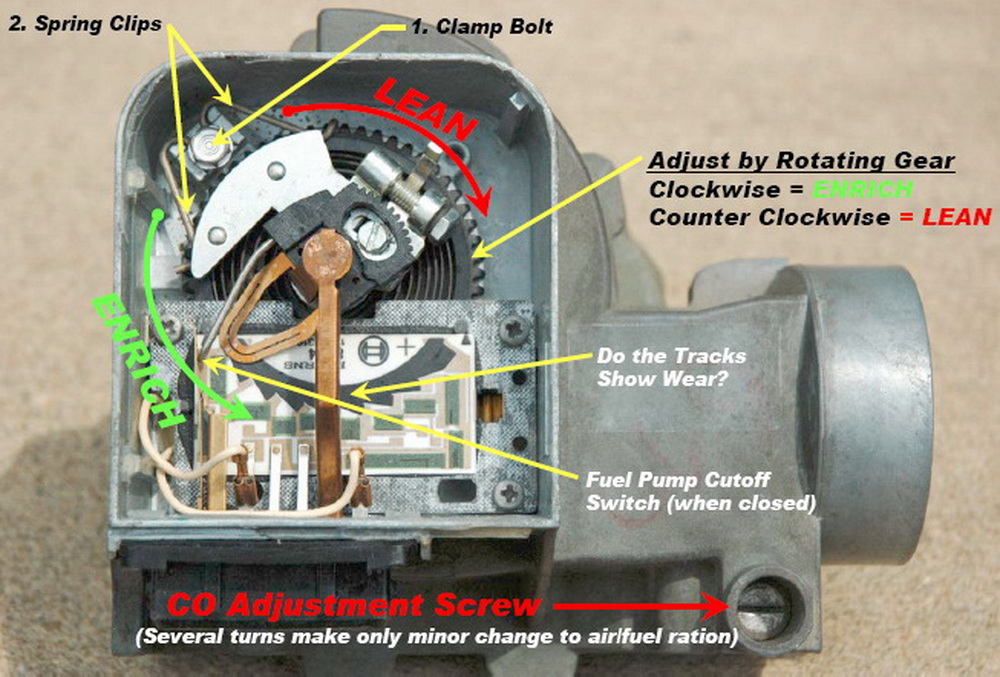

cold start valve
air flow meter

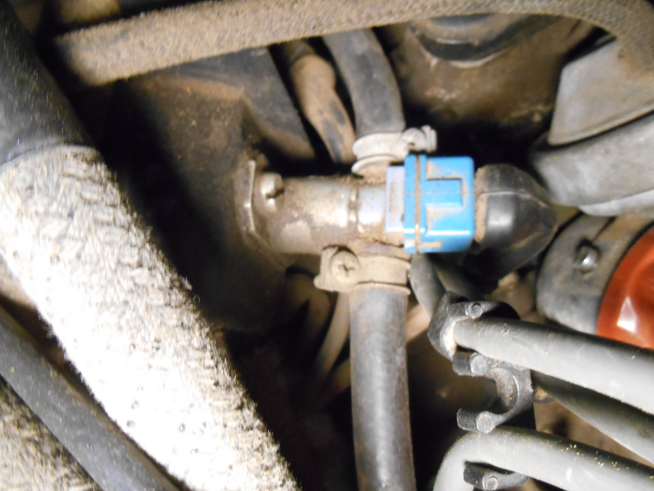

Hello, here is a pic of my cold start valve I assume it is left of the two hoses and blue electrical part inside the metal tube ???Click to view attachment

Here is the pic again to reply on your personal message. from a vanagon but pretty much the same inside.
