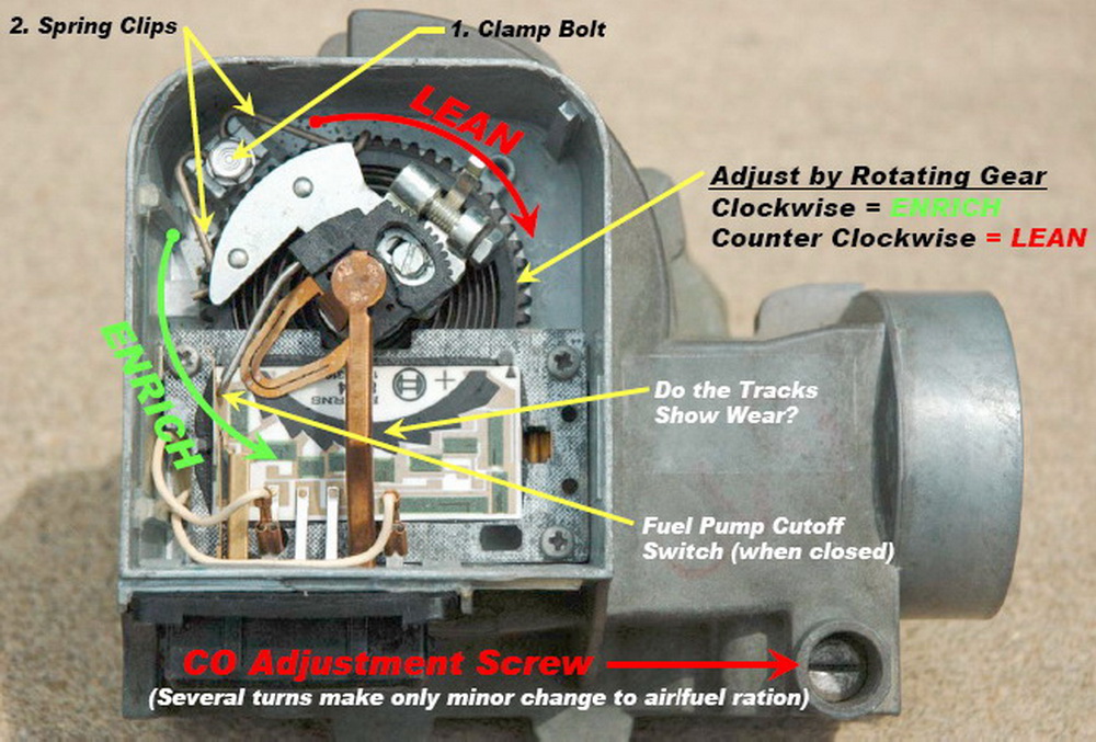

Here is the pic again to reply on your personal message. from a vanagon but pretty much the same inside.
