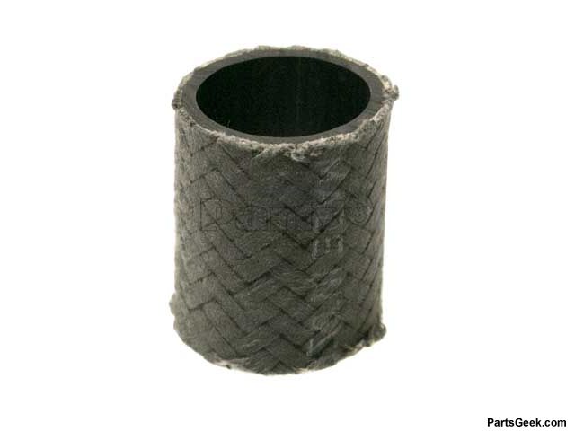

My manifold air intake hoses looked good but after I put clamps on them, my high idle stopped. Two clamps per hose.
