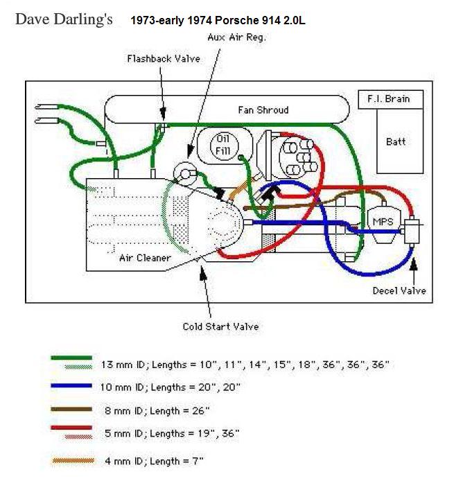

I'd verify you got the injector seal, and injector itself, seated correctly, and then I'd reference a 2.0 vacuum line diagram and go through it again. Pay particular attention to connections to/from AAR, PCV, MPS, and decel valve.
IPB Image
