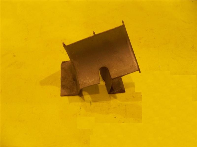

the 72 chassis didnt have the stand welded to the drvrs shelf so the early blower that mounted to the impeller housing is probably called for unless you get one of these
Mikey914
post Feb 8 2020, 12:54 AM
The rubber man
Posts: 12,772
Joined: 27-December 04
From: Hillsboro, OR
Member No.: 3,348
I know some early have the mount on the engine. My 72 has the stand on the drivers side. Not sure where the cut off is. See if you have the stand that looks like the picture. If not I may have one of the early mounts for the fan. I’ll have to check.

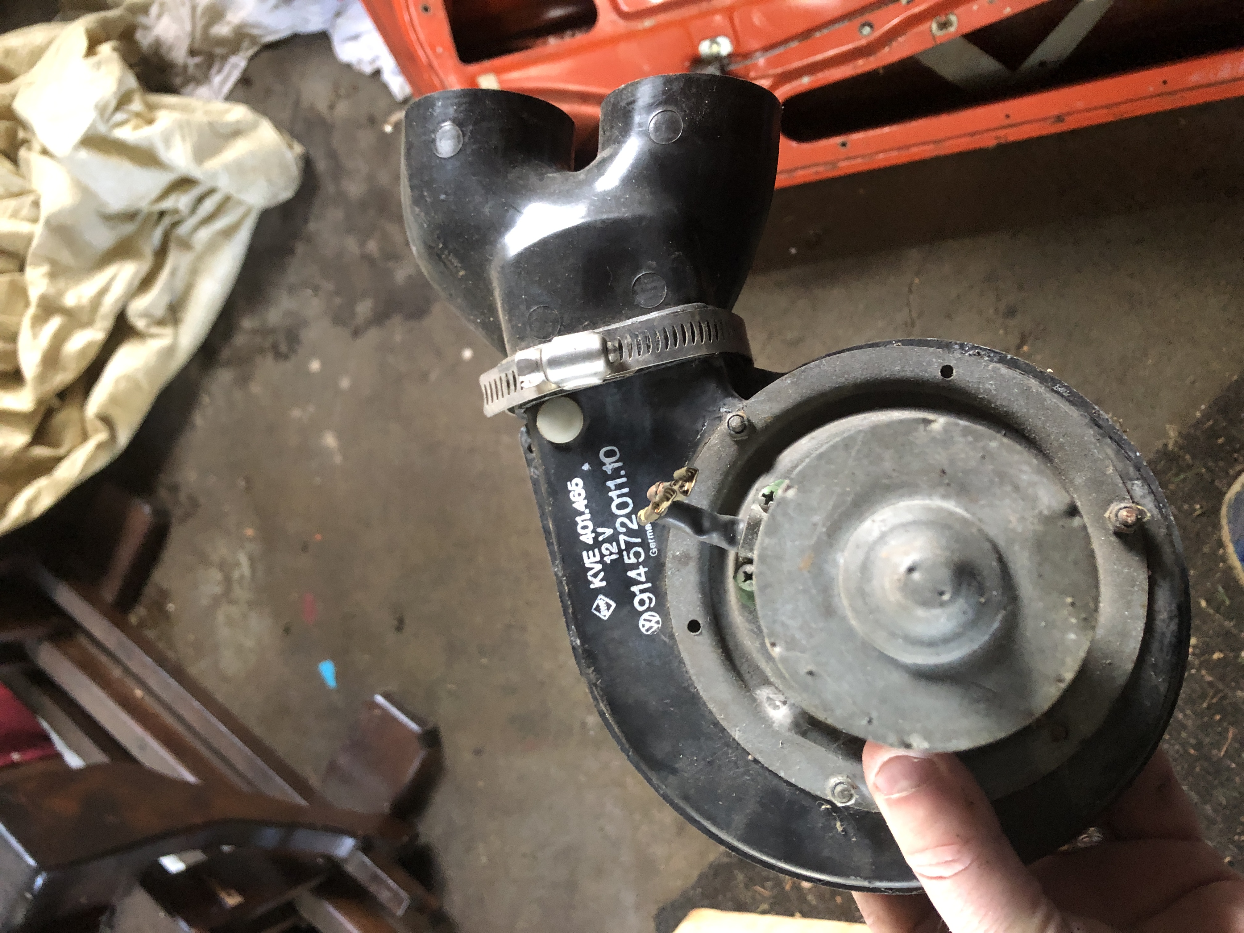

n2j2ryan
post Feb 8 2020, 03:47 PM
Posts: 85
Joined: 9-January 17
From: Victoria BC
Member No.: 20,740
So I did find this in a box, but no other metal
914werke
post Feb 8 2020, 05:08 PM
Posts: 11,294
Joined: 22-March 03
From: USofA
Member No.: 453
