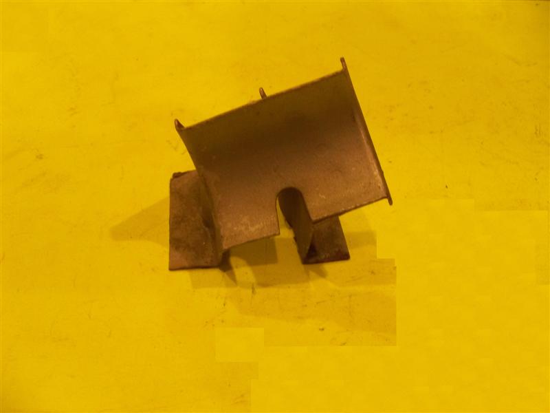

I know some early have the mount on the engine. My 72 has the stand on the drivers side. Not sure where the cut off is. See if you have the stand that looks like the picture. If not I may have one of the early mounts for the fan. I’ll have to check.

n2j2ryan
So I did find this in a box, but no other metal
