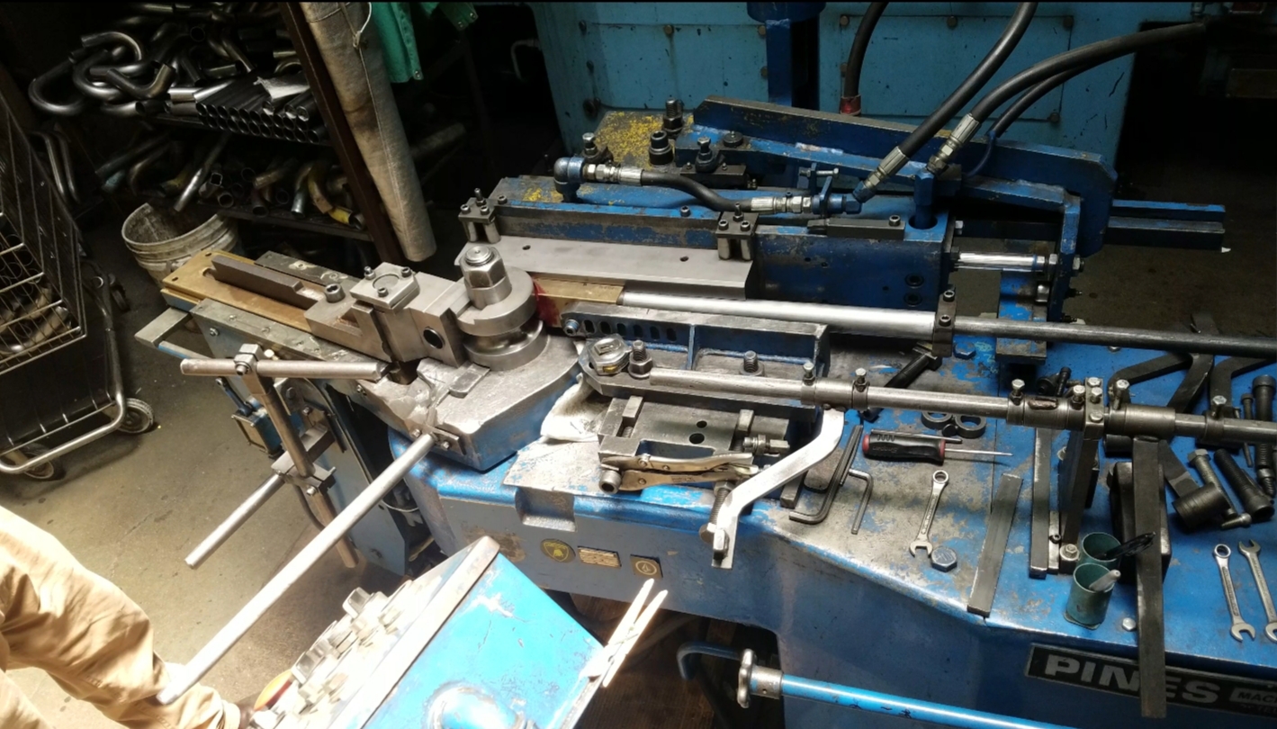

My kind of weekend therapy; Pines #2 rotary- hydraulic mandrel bending

How much different are the Factory GT headers vs the stock six exchangers?

QUOTE(pete000 @ May 10 2020, 05:44 PM) *
Very different, they are donor headers borrowed from the 906. Shorter primaries, Long transitional secondaries (via megaphones).
Seems the Zuffenhausen tuners deemed these "Correct" for the duties of a very high compression , big cammed, twin plug, 46 ida webers, 220bhp, 2L , running mostly W-O-T for race circuit; totally too wild for daily street use. 916's on the other hand did use heater boxes, which also included a tap-in-duct (and flex tubing) for heating the aneroid (spl ¿) sensor on the mfi pump. Most m471's (as you know) ran with standard (long primary tube) 9146 HB's.

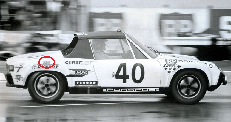

groundhog decal and location on your car

Member No.: 2,755
QUOTE(gms @ May 11 2020, 10:33 AM) *
Thx Glenn ¡
I've been told that depending on the time/ day / lap/ sponsor-op with this sticker; it was on the car...then off of the car. So run it OR not ??
Thx Glenn ¡
I think it is a cool touch

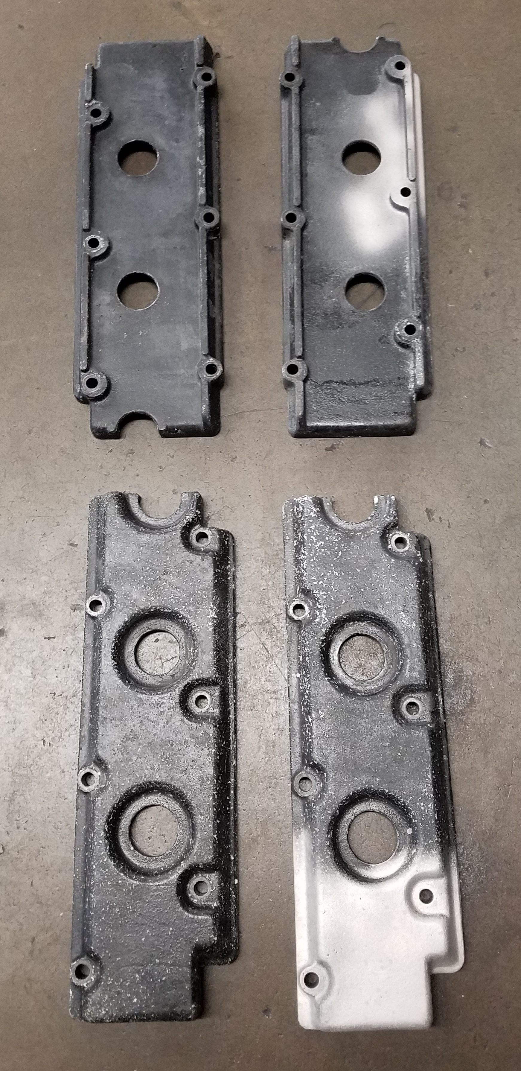

Very early style of 6-bolt magnesium valve covers; uppers are absent of the Porsche name, and lowers have some extra ribbing for strength. Engine type 901/25

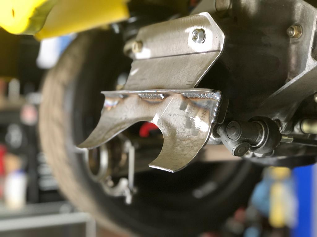

GT muffler bracket attached to the trans nose cone, that allows the 2 band-clamps (911 style) to support the muffler

QUOTE(Maltese Falcon @ Jun 15 2020, 06:24 PM) *
Reproduction time, please ! (IMG:style_emoticons/default/welder.gif)

Are those Mag covers warped, most are including the ones off my car, they now live in a bin on the shelf. Using Modified Turbo Covers...Keeps the garage floor a bit cleaner lol

QUOTE(pete000 @ Jun 15 2020, 06:35 PM) *
Yes I do recall my old 2.7 lower covers, used to constantly put them across a lapping stone to get flat. On these covers (906, 911R style) it looks like these were cast with the additional 1/4" ribs , in order to keep them flat when the engine ran higher temps in competition. These will be restored, then coated with black ceramic...looking to keep the #40 pure to its bones as possible.

QUOTE(pete000 @ Jun 15 2020, 06:34 PM) *
Seems simple enough to mfg a short run of these...I'll put it on the list !
