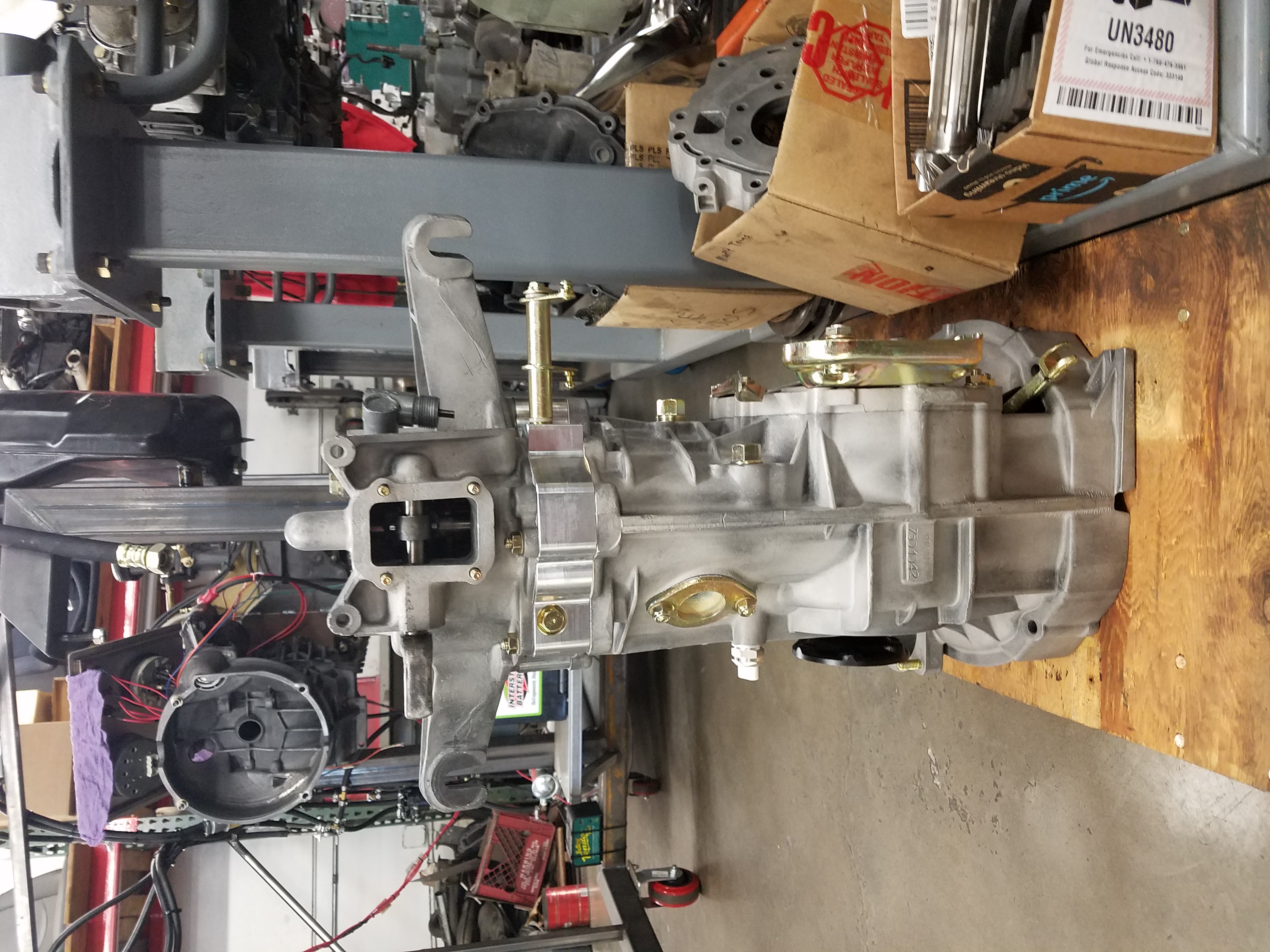

Fresh 901

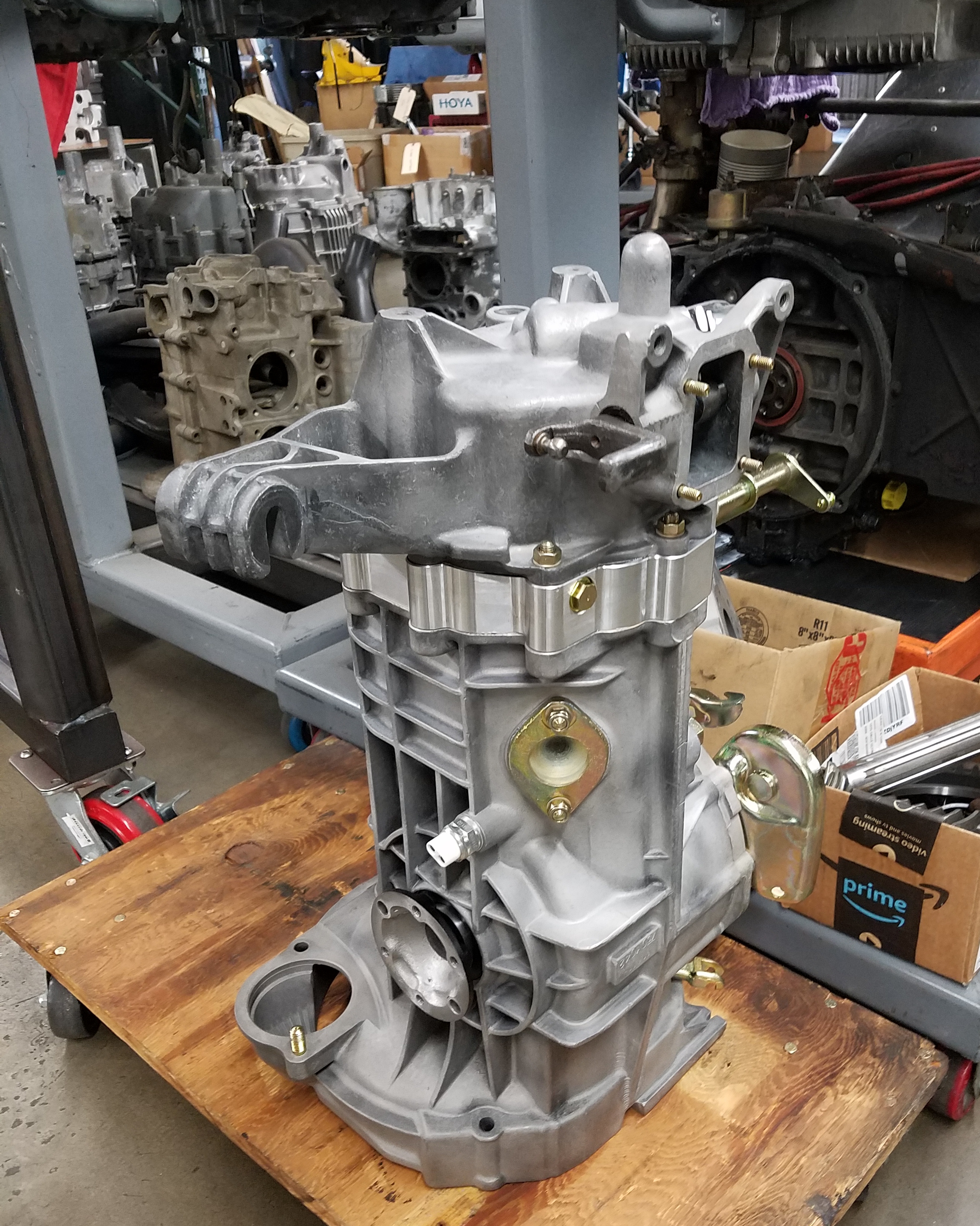

...my 1st tailshifter 914 , keeping the LeMans patina alive.
The Daytona 24hr/ 1971 class winner (J.Duval-Sunoco) GT , built at this (same )shop was equipped with a later style side shifter.
The shop can always upgrade for us (to the side shift), but for now it's the way it shifted on that Long day in June

Tranny porn.
Nice work Marty and also a happier 2021.
Hope to see everyone sometime this year.

Marty is that the original trans to the car ?
Amazing.

QUOTE(rgalla9146 @ Jan 11 2021, 06:50 PM) *
Amazing.
AFIK yes, and judging by the wear and tear parts we replaced in the trans ...it's been well used. It has been upgraded with the CMS intermediate plate along with new bearings, a different 3rd gear ratio, and a long list of replacement parts.

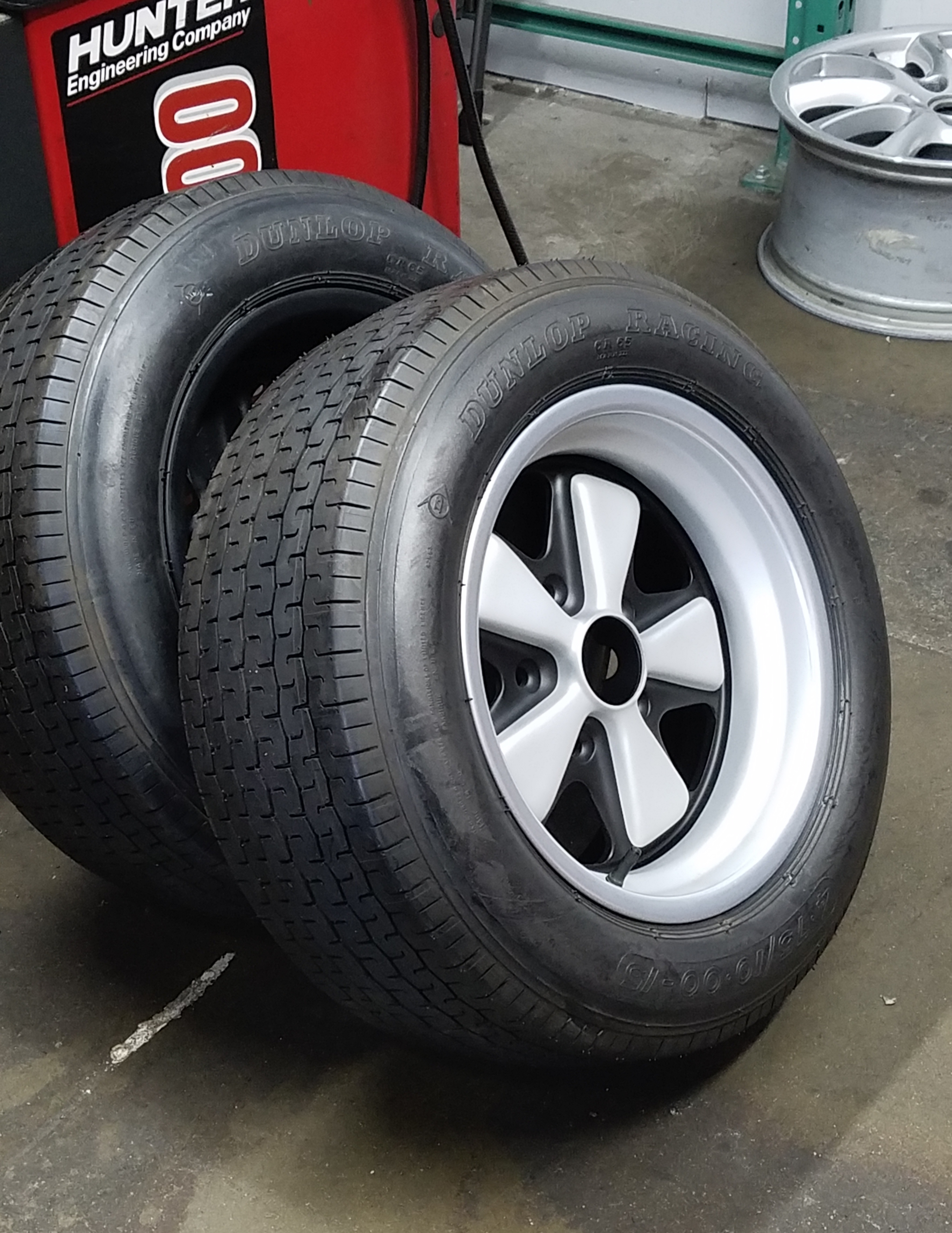

We sourced these Dunlops through Roger Krause Racing in NorCal, very good in matching the period correct "Wets" used in the 70's

^ Great stuff, Marty. Those wheels/tires sure look period correct. (IMG:style_emoticons/default/wub.gif)
Looking forward to seeing this car back on its (new/old) four feet!

Dunpy awaits his place on the rear flares as well @horizontally-opposed !

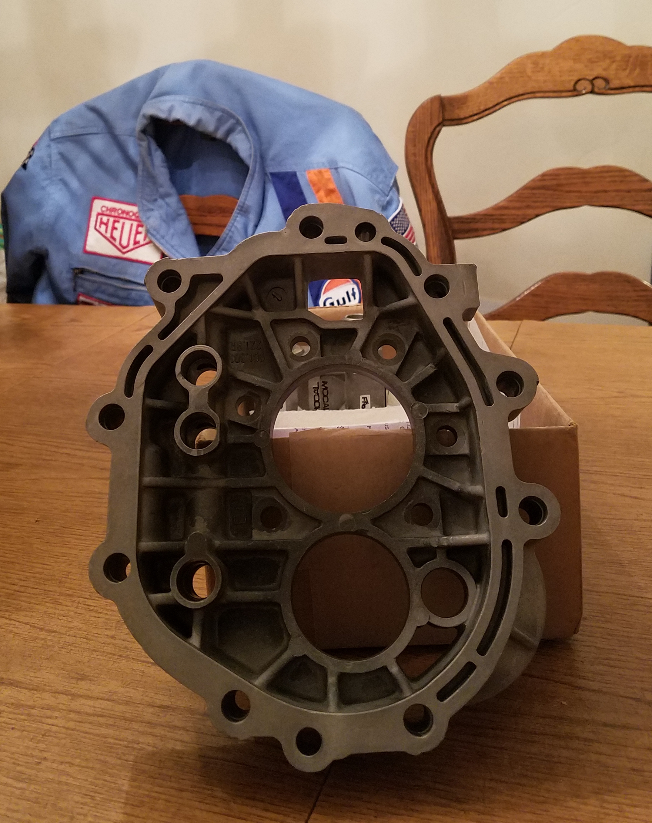

I am surprised you ran the upgraded billet intermediate plate.
They did not have that back then did they?
I would have dulled it up a bit...Looks too new modern !
I want your wheels and tires !!!!

QUOTE(pete000 @ Mar 6 2021, 06:42 PM) *
I've experienced 901 intermediate plate bearing failures...so this upgraded (California Motorsports) unit will just have to get a bit dusty, might match the rest of the mag case (IMG:style_emoticons/default/smile.gif)
I'll keep the original near the 914 books (IMG:style_emoticons/default/biggrin.gif)

Now I want a CA MS intermediate plate too !

QUOTE(Maltese Falcon @ Mar 6 2021, 09:56 PM) *
Sounds like this car is gonna be seen, heard, and used again. I like it.
And there's a case to be made for cool Le Mans car parts you can see daily…

QUOTE(Maltese Falcon @ Jan 11 2021, 07:46 PM) *
I have driven both, and the side shifter is definitely better. But our six has the tail shifter, and after I went through the linkage, it shifts almost as good as a side shifter.
The six is much better than the four for the tail shifter.
I like the period correct shift linkage on it. Keep up the good work!

Marty, what do you use to keep the case clean...or is not a big deal out there in CA. Out on the east they get dark and have surface corrosion very quickly.
I have been touching-up the mag surfaces with a scotchbrite pad & a bit of wd40 on it. The original intermediate plate was hot-tanked, rinsed and naturally looks like this. I'm sure it will turn dark grey when the humidity sets in (IMG:style_emoticons/default/smile.gif)

QUOTE(ClayPerrine @ Mar 8 2021, 07:21 AM) *
Clay
Clay, thank you for chiming in with your findings...I am looking forward to Not grinding gears & Not missing shifts. There is something to the "Look" of a tail shifter on this special teener !
