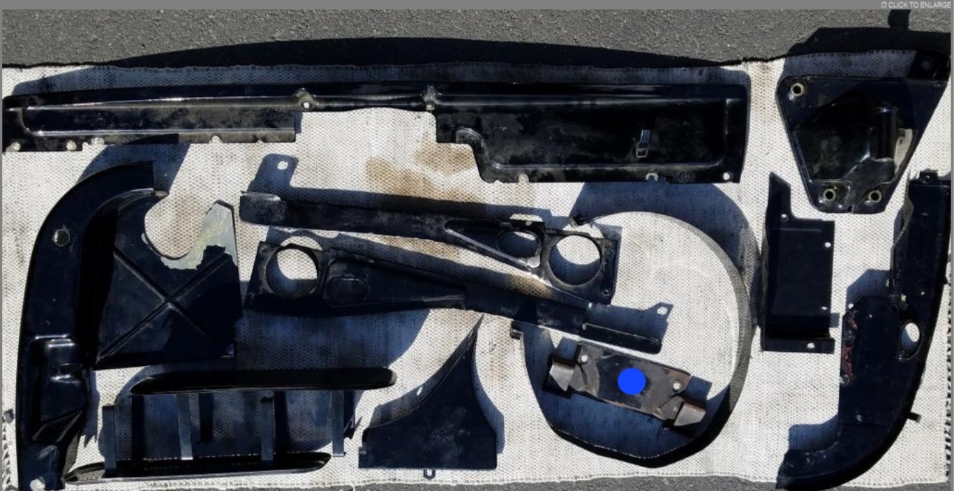

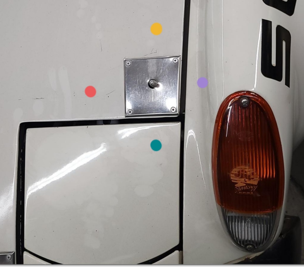

Thanks again for the reply Marty. I'm looking for the dimensions on this one in the center of the pic.

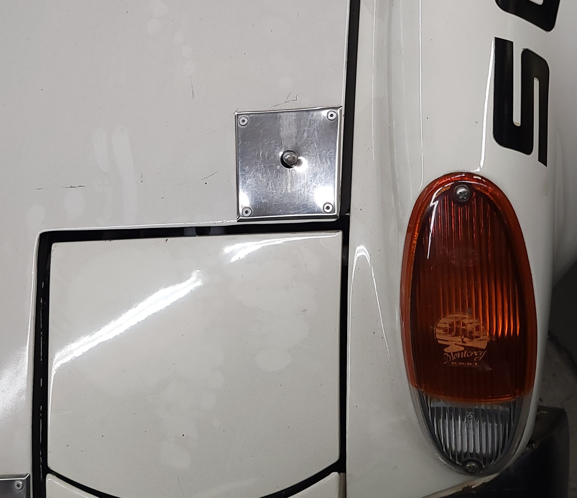

OK, plate dimensions are:
Yellow, Red, Violet = 3.125"
Blue (above headlight) = 2.875"
Flip this outline for the R /passenger side
The edges of the plates also have a beveled contour.

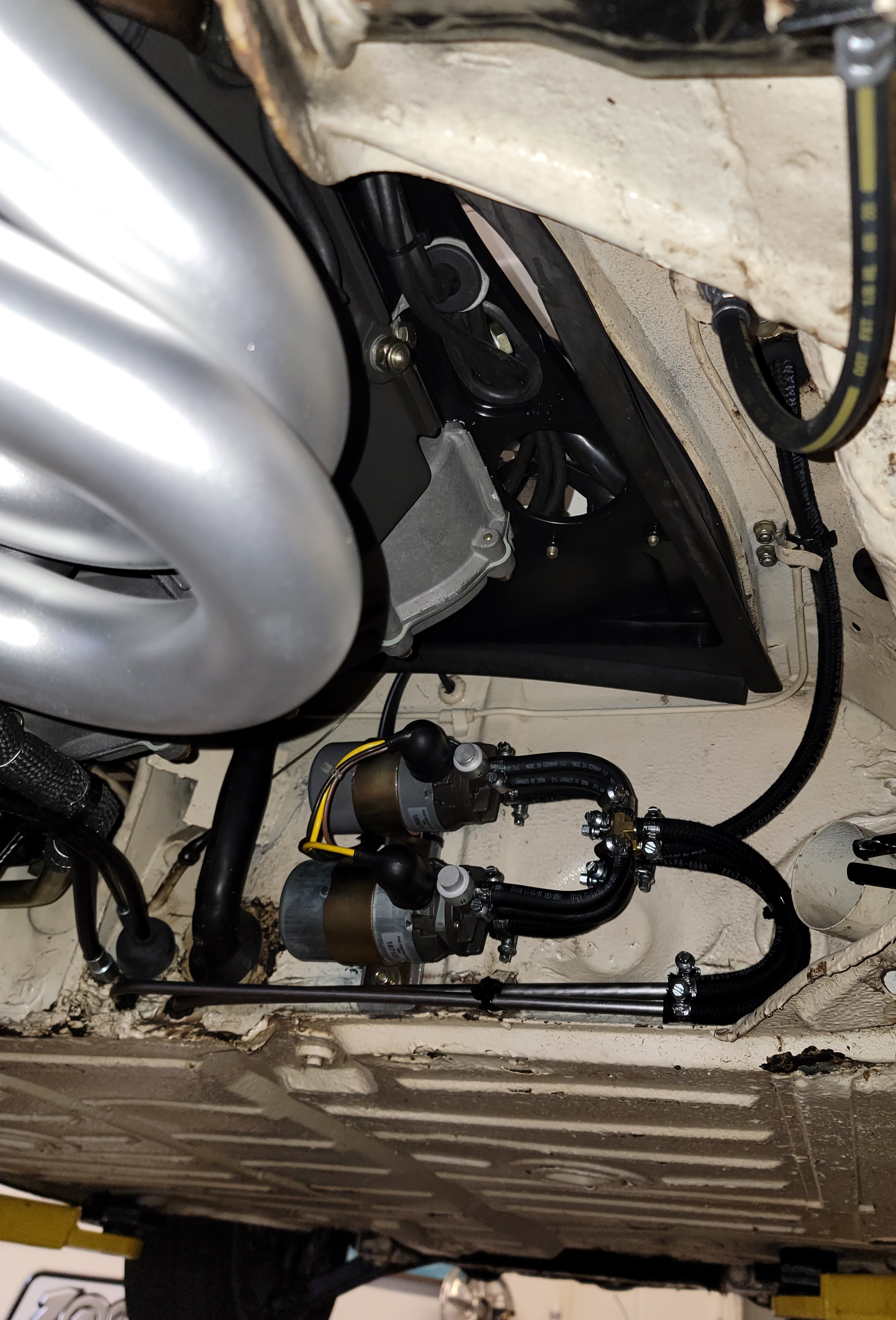

Twin fuel pumps, new wiring, relays, SS fuel lines, brackets, supply + return lines and clamps all in place.

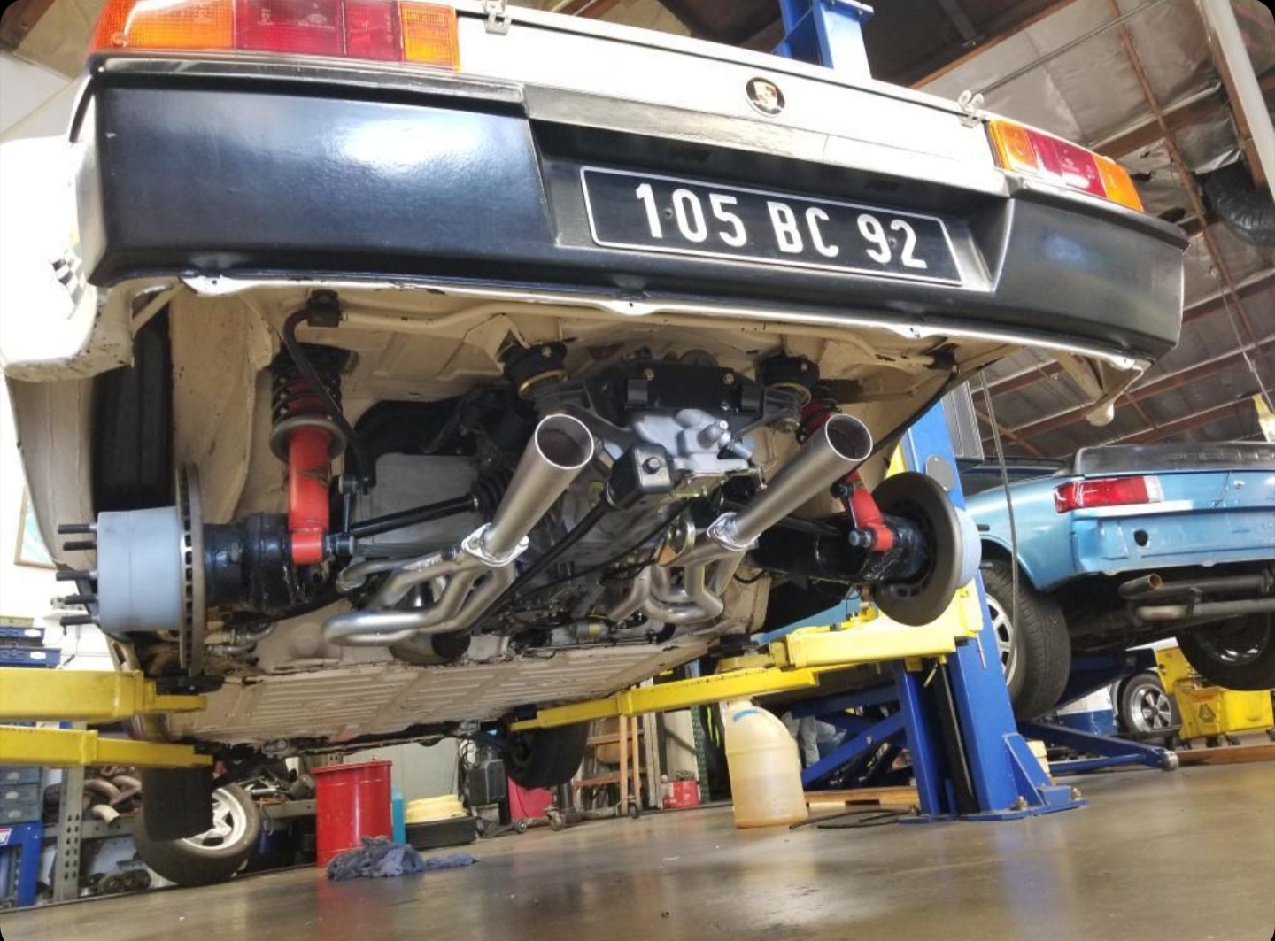

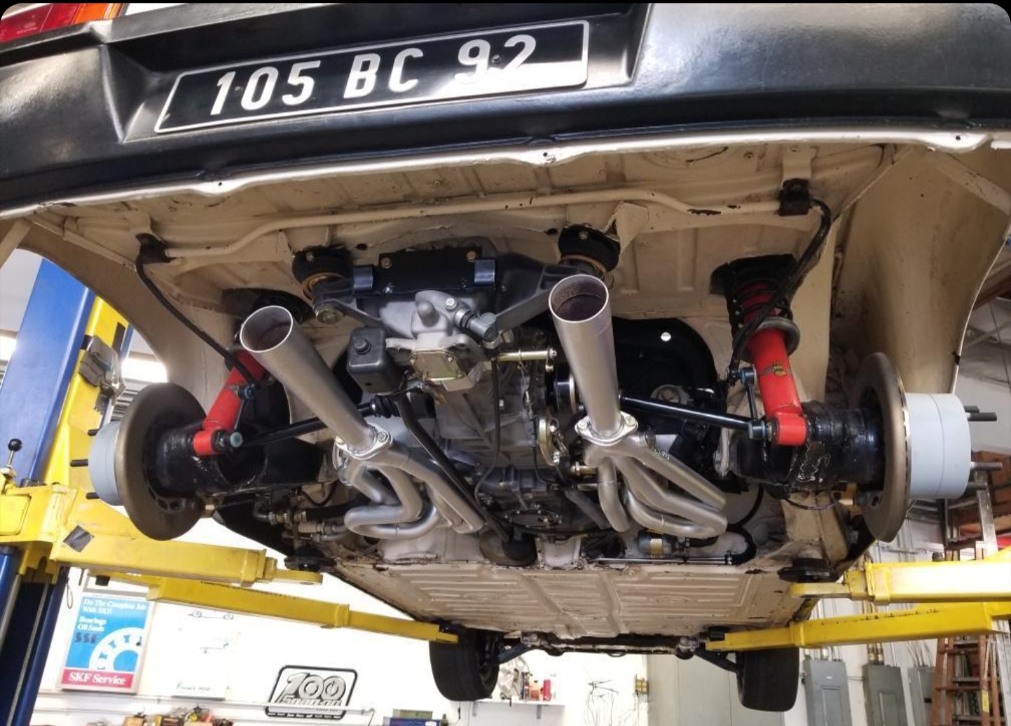

Finalizing the exhaust, our newly manufactured 1.625" od merge collector headers are slightly larger than the original LeMans (1.5" od) headers...but there are -0- clearance issues on surrounding components.

...couple more

Marty will you add a support when running the megaphones ?

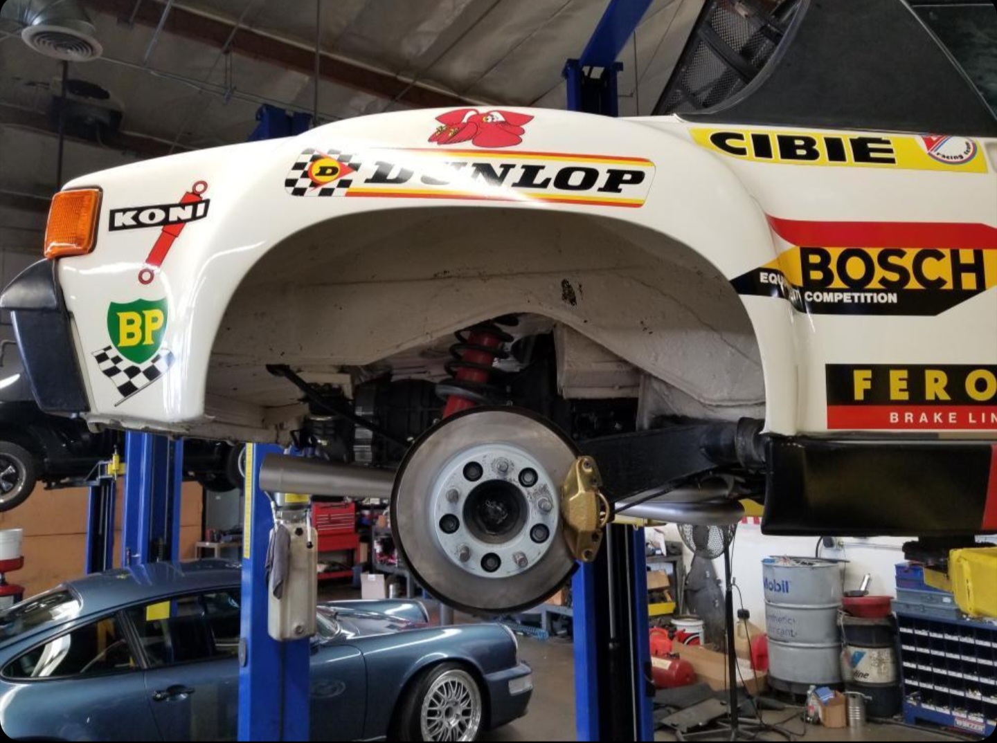

Marty it’s looking so incredible.
That’s a great shot of the business end. How much more width are those flares.
I remember reading that the Marathon de la Route cars(3 of them) all had different width flares. Just curious.

QUOTE(rgalla9146 @ Jan 7 2022, 08:52 AM) *
Rory, the megs that you see in the pics will not be floating around as these will push into the rear muffler (id / od fit), then tightened with a pair of band-clamps.
The main support bracket which bolts to 901 nose-cone and uses a pair of large band clamps (911 style) to support the GT muffler/ with the megs clamped down and along for the ride.
GT nose-cone bracket (blue dot) in the picture.

@Dion , I'll throw a straight edge into the rear wheel well next chance I get !
