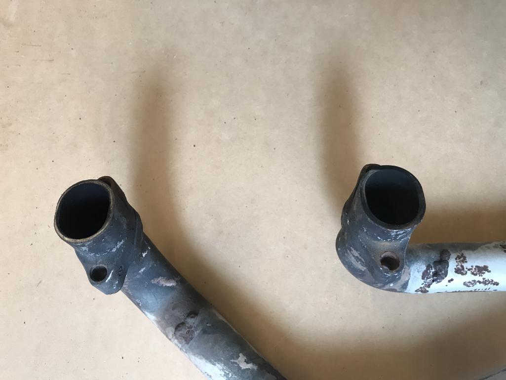

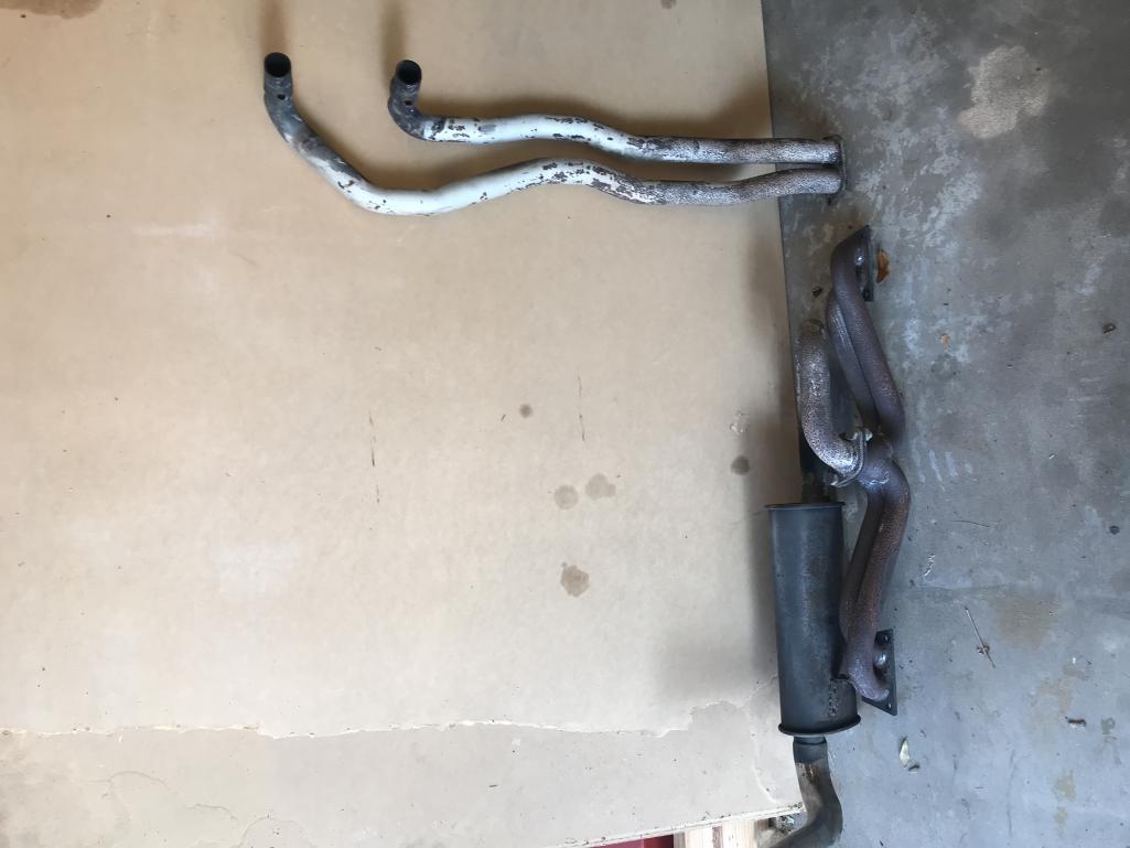

Car didn’t pass inspection because of an exhaust leak.
So... Just ordered some manifold gaskets from Pelican Parts.
Question is.
Is this copper soft out of the box, or does it need to be annealed before install?
Thanks for sharing your experiences.

HansJan
post Feb 8 2020, 11:53 AM
Posts: 406
Joined: 5-April 16
From: Sugar Land TX
Member No.: 19,860
Sorry. There are no HE’s, just some pipes.
But will anneal the gaskets when they come in.
Thanks y’all
