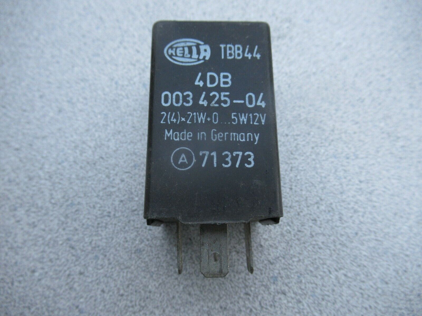

For reference, the below photo shows the correct relay for a late '73 car...
Still trying to figure out if the turn signal indicators should flash with the 4 Ways, any '73 owners out there? Anyone, anyone? @bbrock @superhawk996
