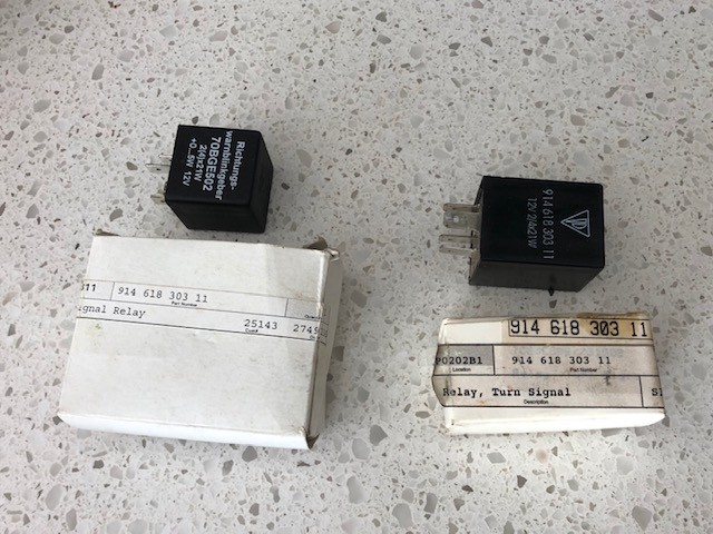

I have tried two new Wehrle relays and they are both not working correctly. One keeps the E-brake light indicator solid and they other has it flashing very quickly.
The Hella TBB4 relay in the car is working correctly as evidenced in the E-brake, turn signal and Hazards flashing at the correct speed.
This is a known problem with the Wehrles as they all come with the generic Porsche part number 914.618.303.11 , but there were diffferences in the older stock. I recall seeing previous threads on this.
Looks like the Wehrle 914-618-303-11 relays may have some issues. Below are the comments from a couple of guys on Pelican who had similar issues as you have.
For LED turnsignals, I resell the EP26 LED-compatible flasher which solves many issues especially when using LED turnsignals. Works also with incandescent lights.
914-618-303-11 on Pelican Parts
Clark Allen
Feburary 2nd, 2018
Wherle relay does not work
After buying this item, I was told that the very low load on it when only the hand brake lite is on will not blink properly. Guess what, my source was right. The load is so low that the relay hyper clicks to the point that it just buzzes. If you pull the hazard knob everything works fine.... more load and it works. But these guys will sell it to you anyway. Buy an LED relay, or an OEM brand. $18 Wherle will not work. They tell me to keep it, they are not taking it back.
Paul
January 10th, 2017
Works, sort of...
This relay works fine except for the brake light function. With the parking brake engaged, the brake light on the dash doesn't flash like it's supposed to. Instead, it glows dimly, accompanied by an annoying buzzing sound. I replaced this with a good used OEM part and all is well.

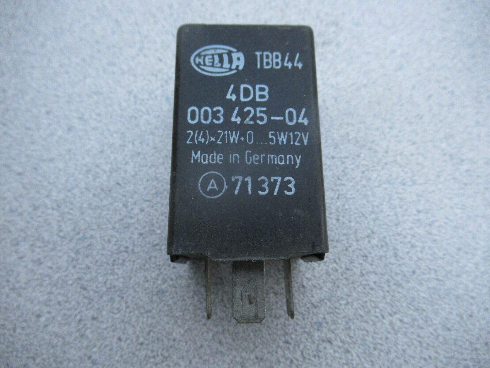

For reference, the below photo shows the correct relay for a late '73 car...
Still trying to figure out if the turn signal indicators should flash with the 4 Ways, any '73 owners out there? Anyone, anyone? @bbrock @superhawk996
