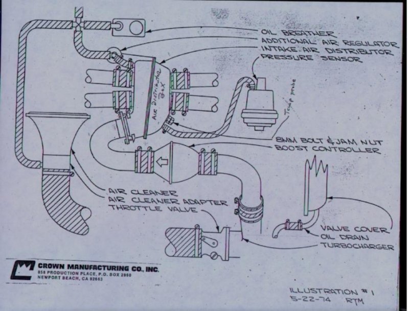

I’ve been a 914 enthusiast for years and I just bought my first one. ‘73 2.0. The car is in good shape structurally, but it hasn’t been on the road in 31 years. I’m still figuring out long term plans for the car and I would appreciate the forum’s advice on what to do with the aftermarket turbo on the car. At this point, I only know that the engine turns over but I have no idea of the condition of the internals or the condition of the turbo. After doing some quick internet searches and learning the long running joke that “you can’t turbo a 914”, I think I’ve figured out that the turbo I have is a Crown Manufacturing unit from the early ‘80s. The engine is still fuel injected, but it looks like some of the original FI parts were removed when the turbo was put in (there is no air filter?)

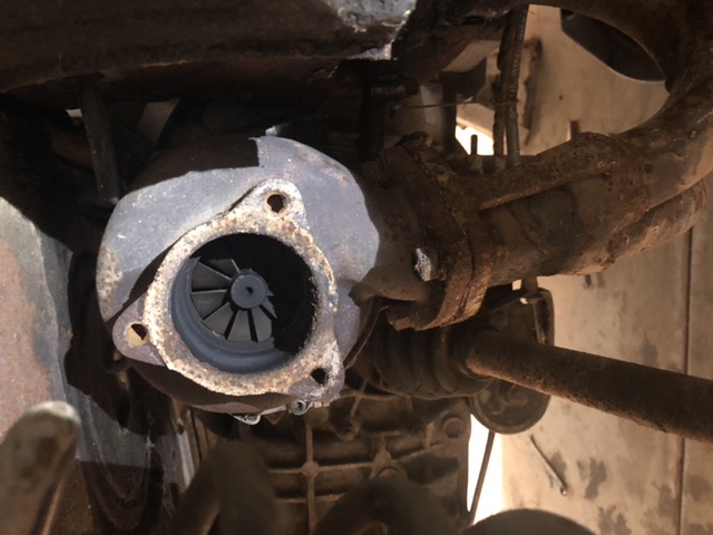

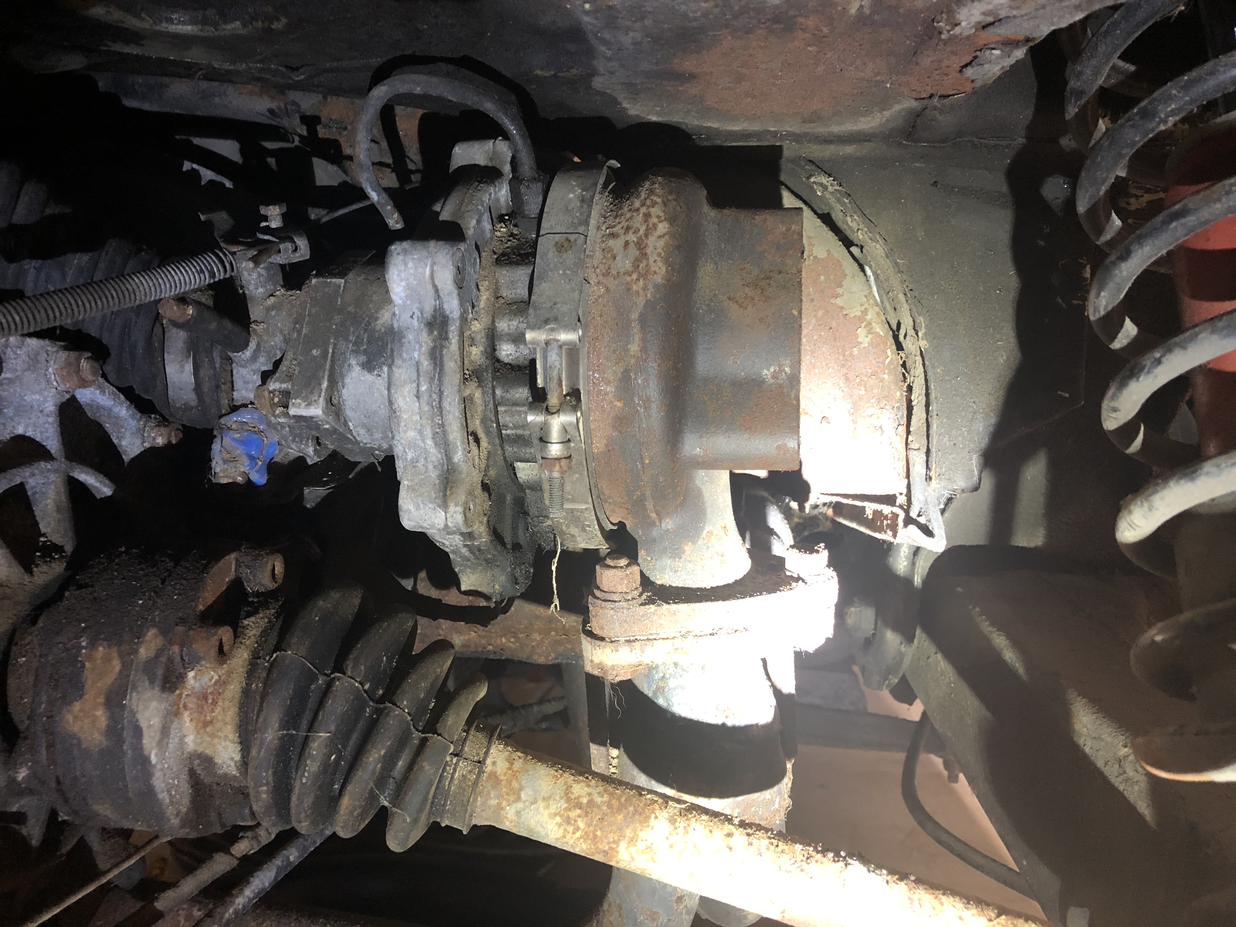

Thanks for the advice and recommendations. I spent the last couple of nights examining the car and finding all the preliminary things I want to fix before putting the car on the road. Of course, the more I look, the more I find...
I’m not really a “flame test” guy and I’m seeing way too many sins committed by the PO to make me realize that “flame testing” this car might end in actual flames.
So I started some disassembly and I got a closer look at the turbo. I also found the throttle body! It was hiding above the transmission. (IMG:style_emoticons/default/blink.gif)
Pics if anyone is interested or wants a laugh.Attached Image
