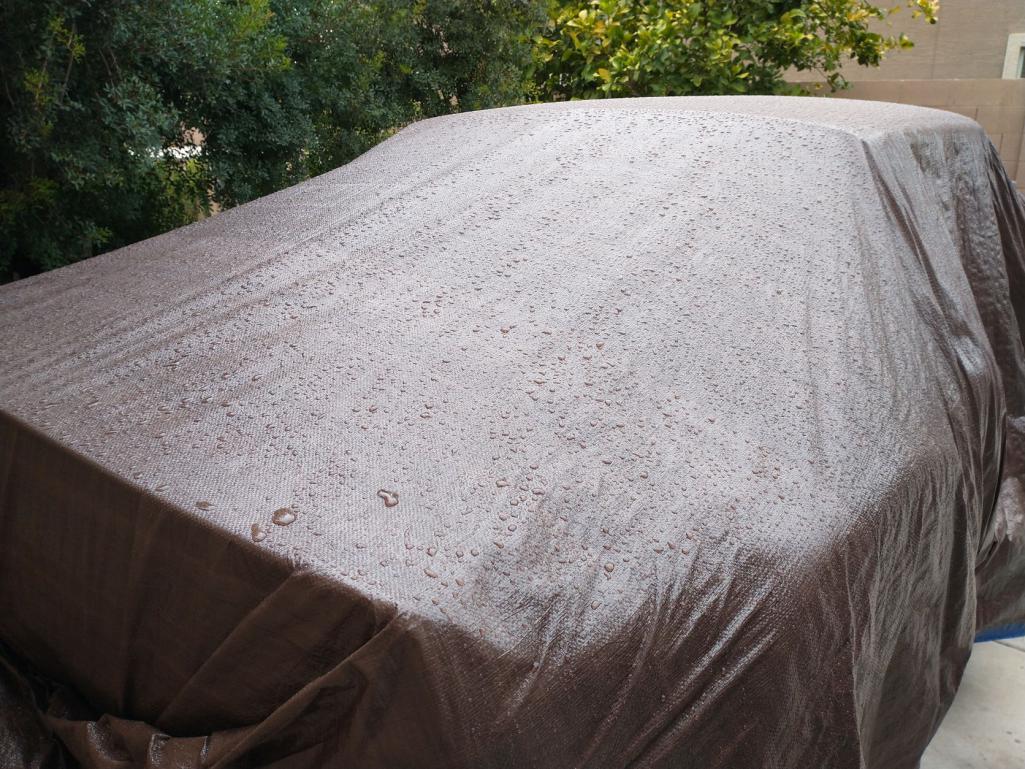

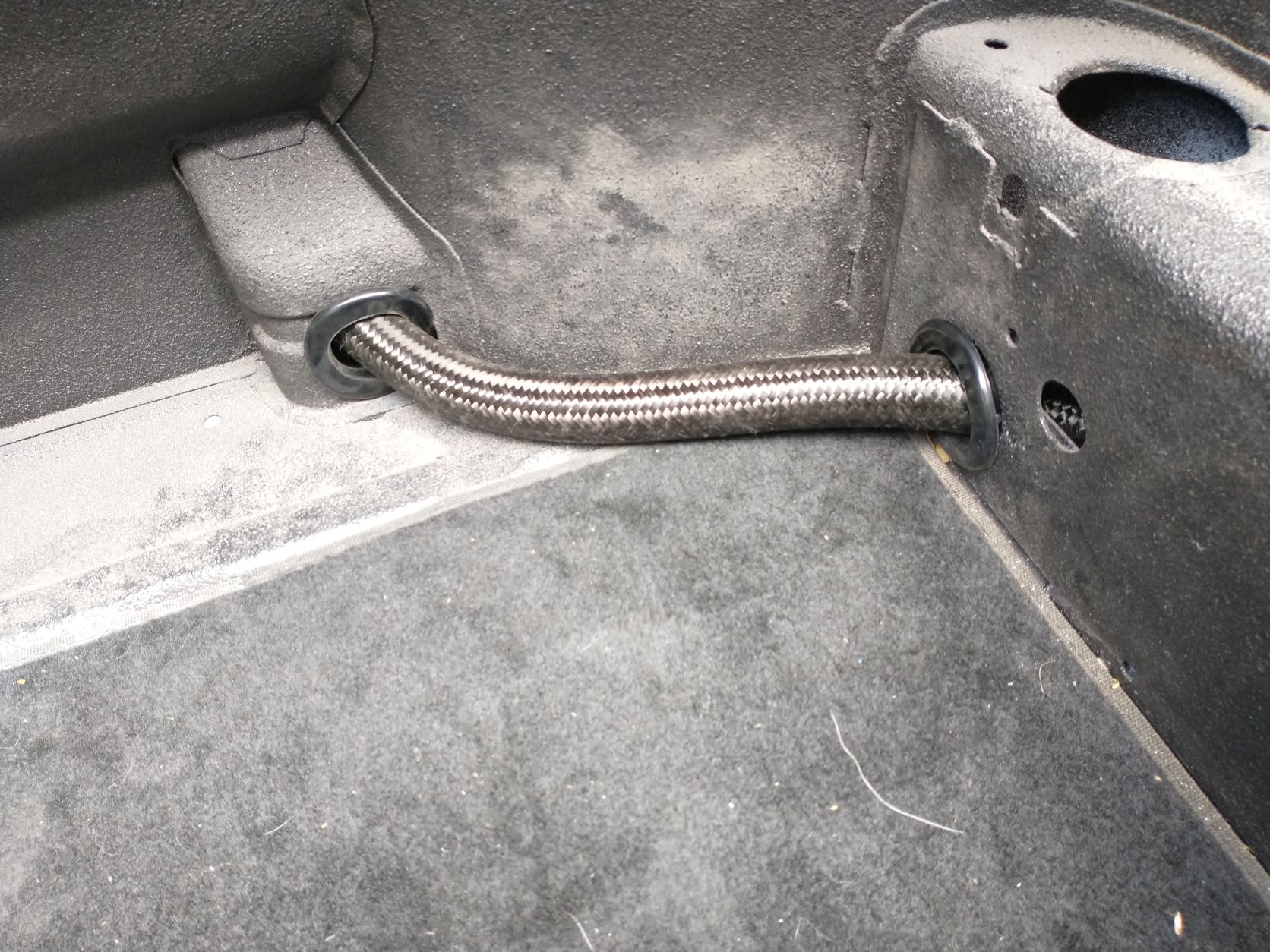

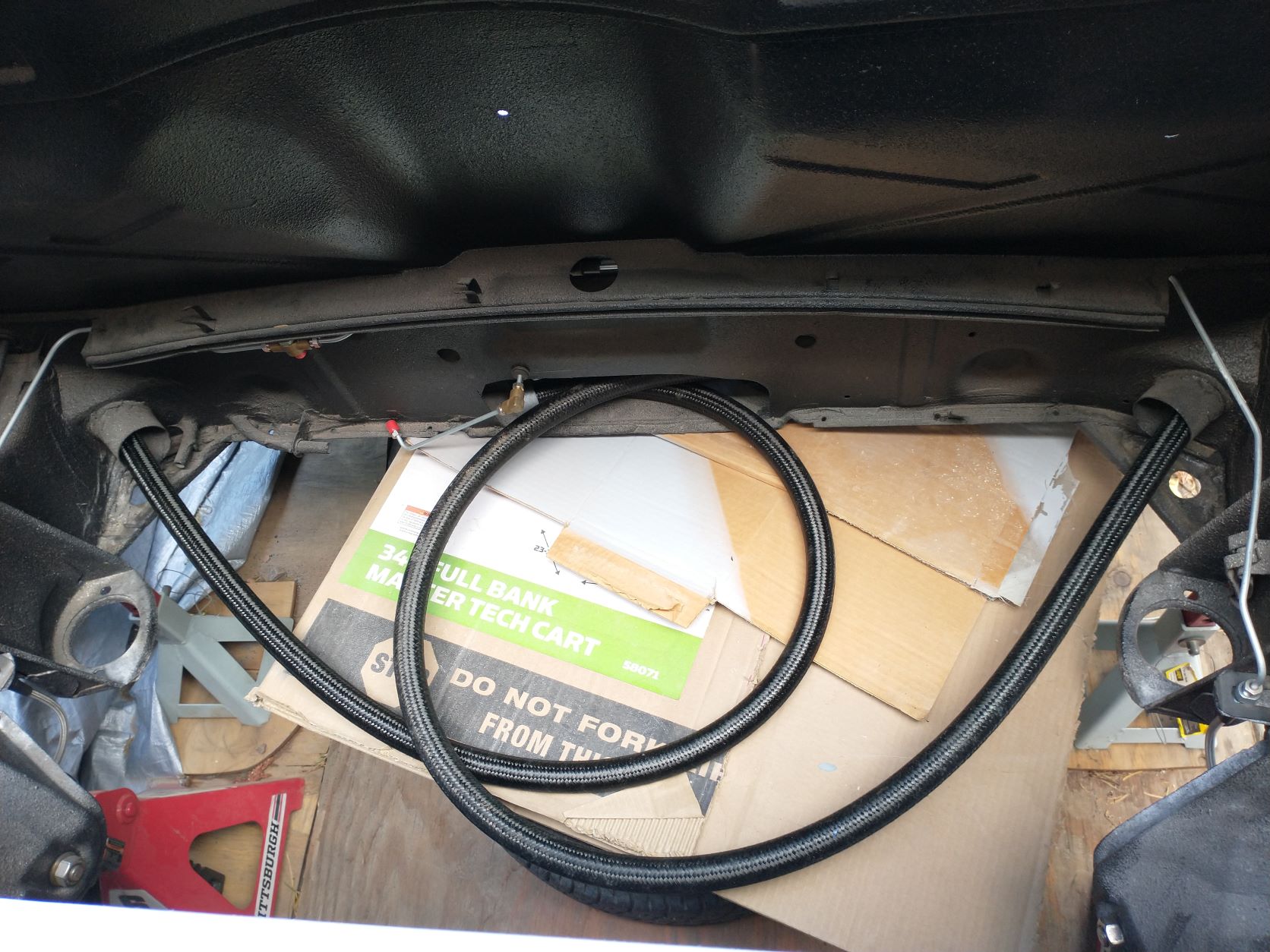

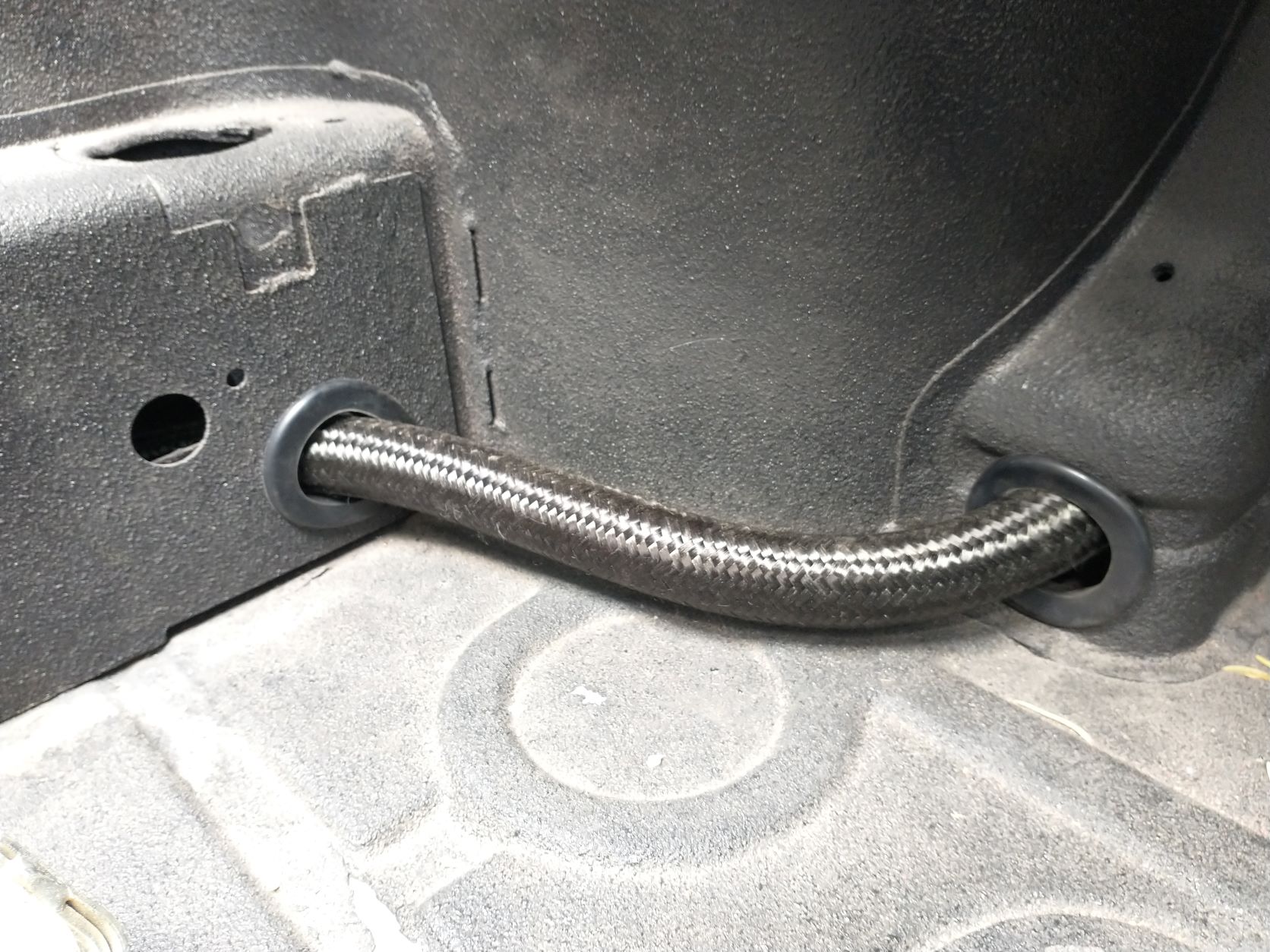

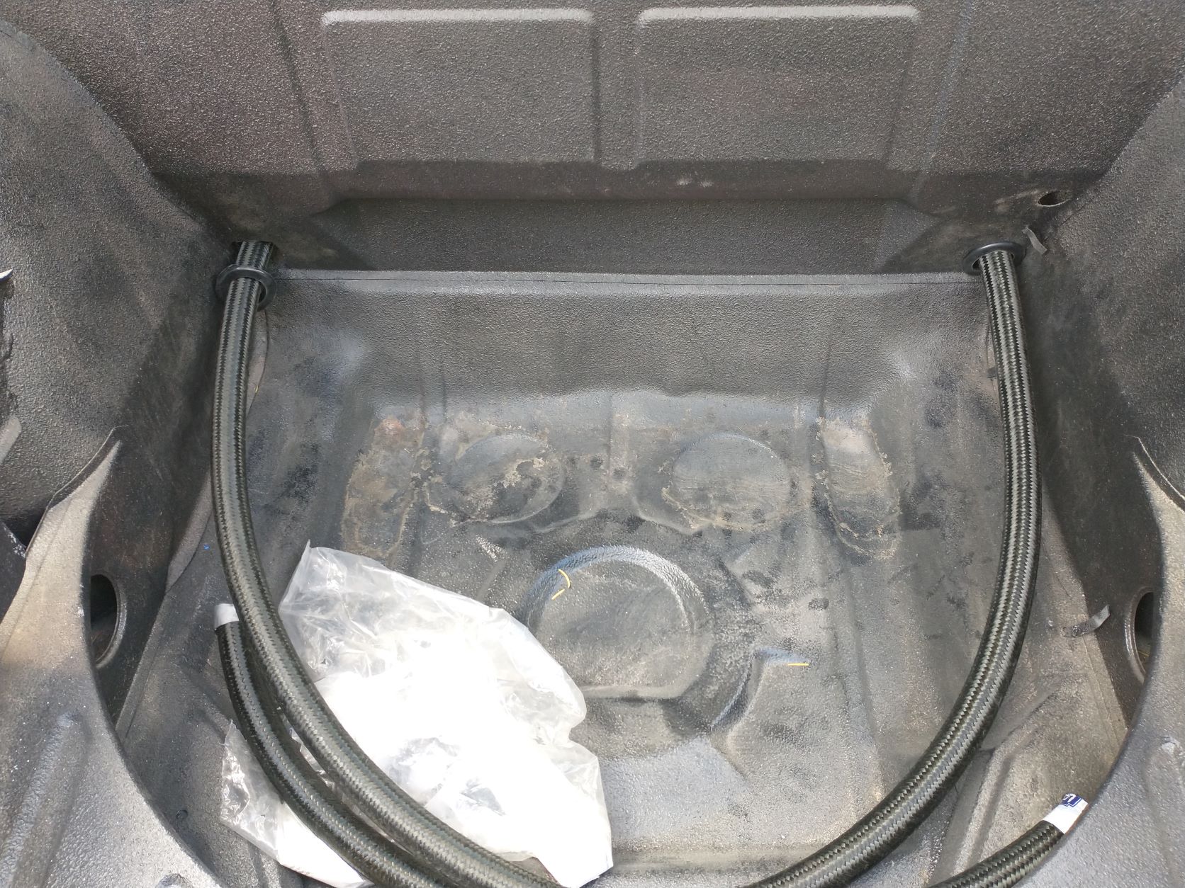

Been trying to do some little things while I replenish some $$$ for the 914. I got the radiator hoses run through the longs and got the grommets in place to keep them from chaffing on the openings.
Attached Image Attached ImageAttached ImageAttached Image
It's not much, but it's something - especially with all the rain we have been getting!

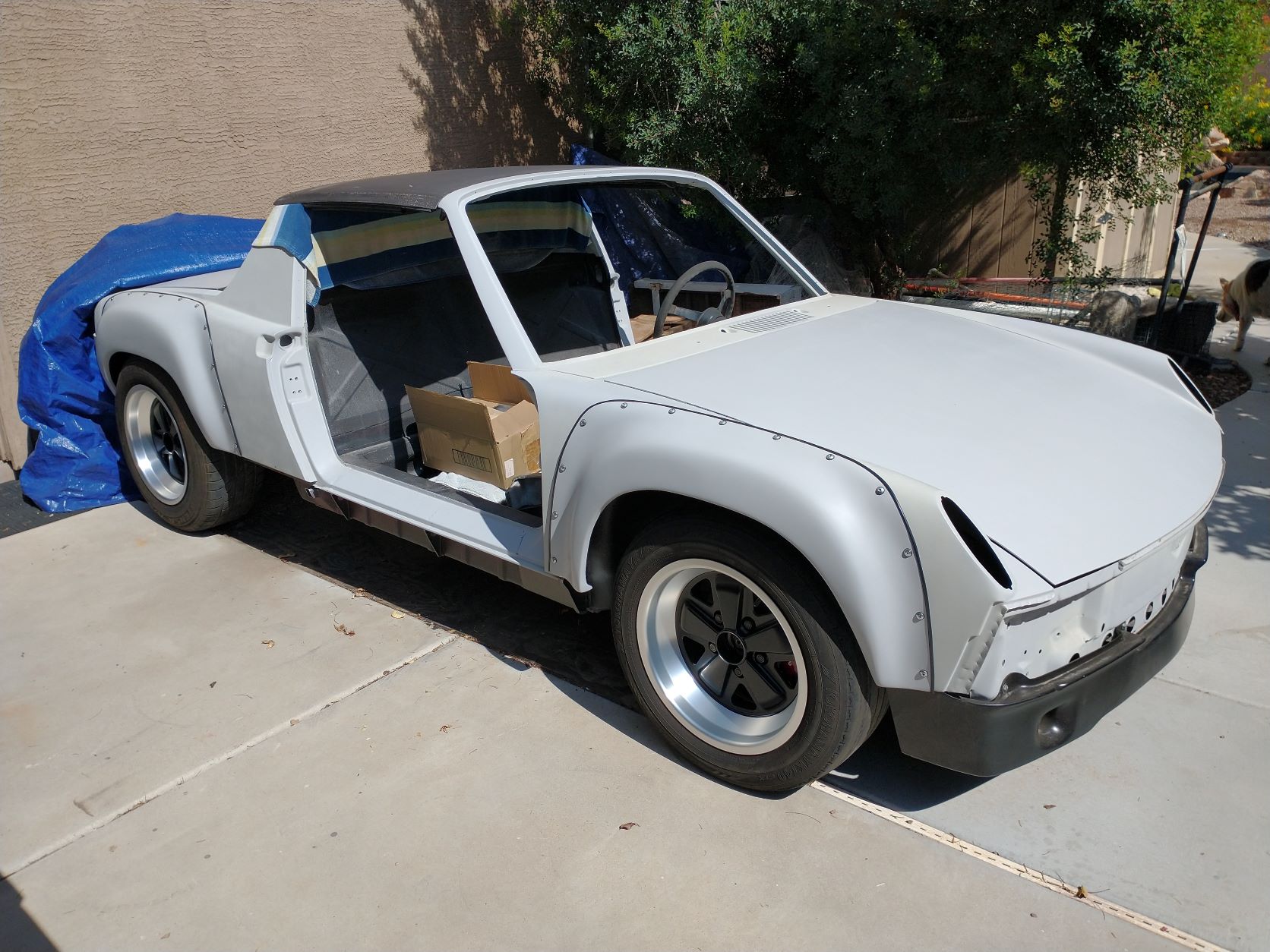

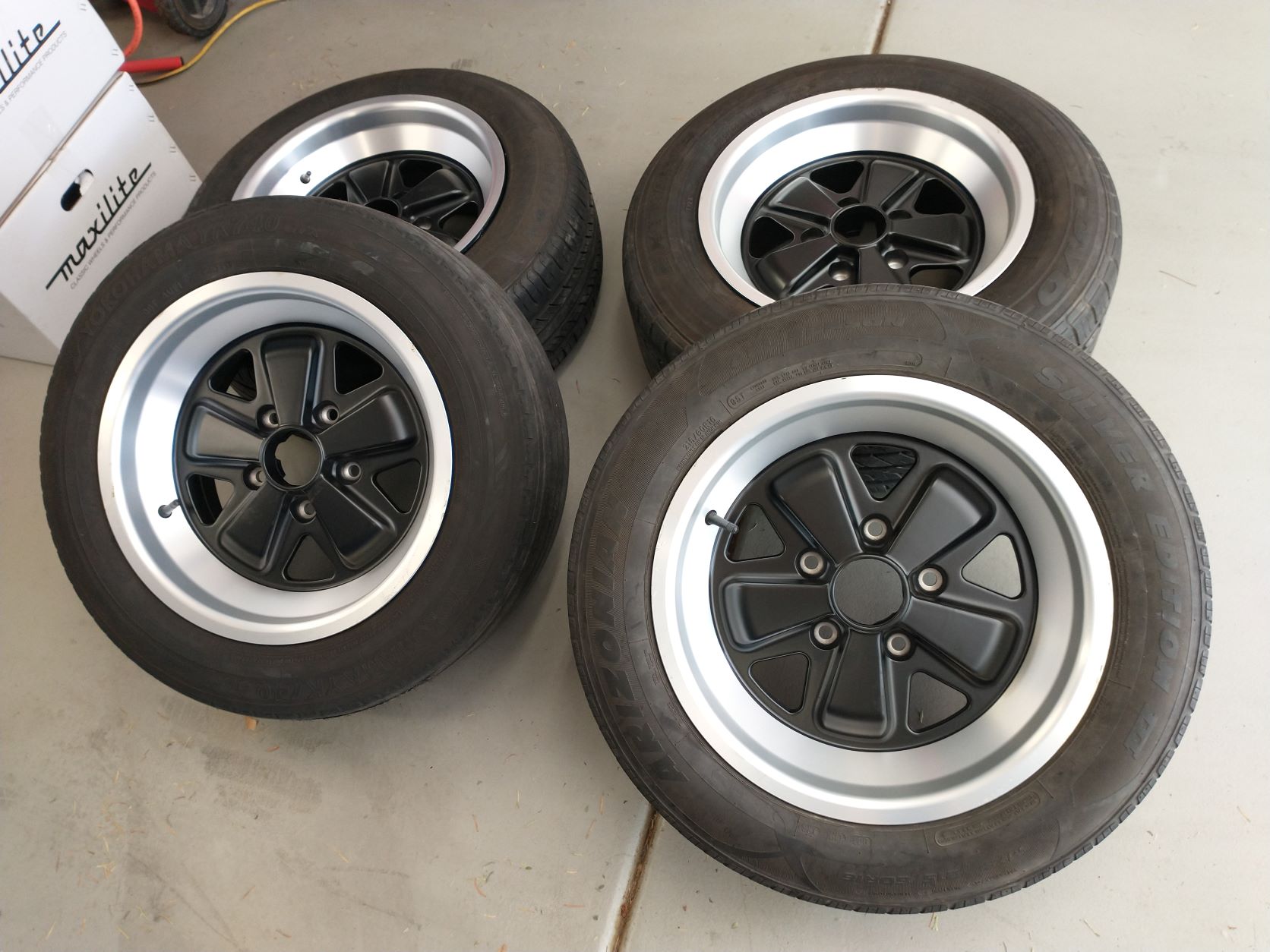

Here's what I ended up getting for wheels...
Looking back I should have tried harder to track down the 17" diameter wheels. Tire choices would have been much more plentiful, and I think now they would have looked fine with the 911/Boxster suspension & brake setup.

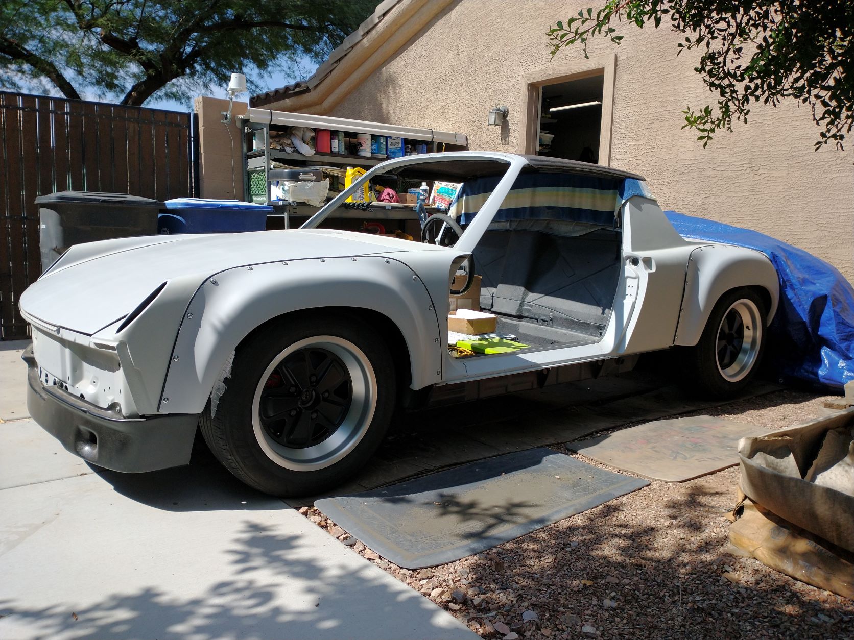

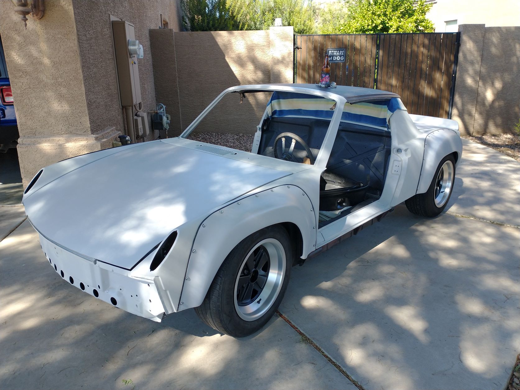

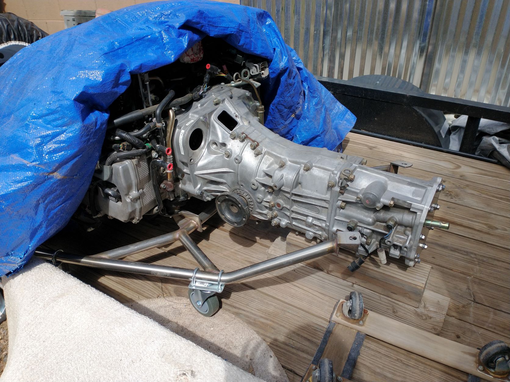

I believe its taken at least about twice as long as expected, but she's finally a roller again! (IMG:style_emoticons/default/piratenanner.gif)
The EZ36 on the cradle tipped forward so bad I thought the motor mounts would tear, I had a 4x4 under the front of the oil pan! I decided to try bolting the transmission up to see if it would balance things out. Sure enough, that did the trick. An interesting side note on the more recent EZ36 motors - it looks like Subaru added a front motor mount bolted to the aluminum front timing cover. It reminds me a little bit of the Porsche six mount...not sure there's really anyway to utilize it, or if its needed at all...
I got some U-bolts and added casters to the cradle so it's easier to move around, but I can remove them when its mounted in the car. The trans acts like it has the LSD installed (what I was told, but no way to confirm), which is an incredible bonus! (IMG:style_emoticons/default/smilie_pokal.gif)

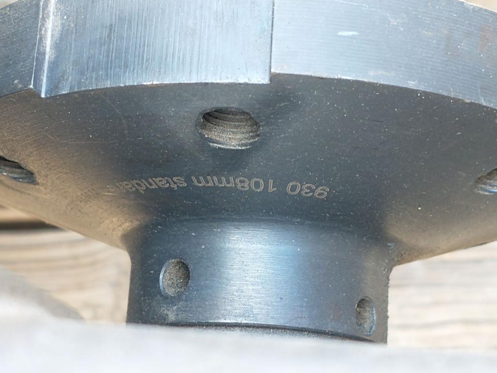

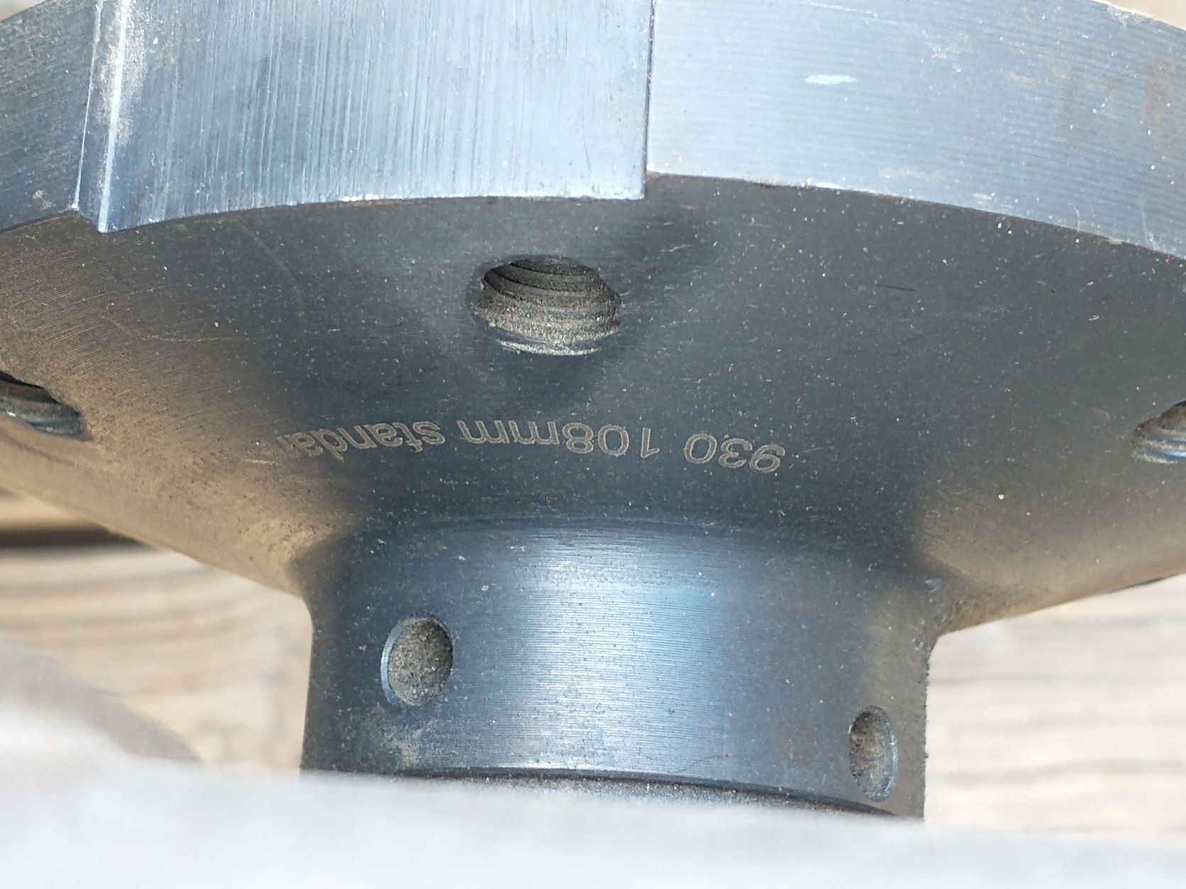

It also has the SubaruGears 108mm 930 output flanges installed:
A bit premature, but I like to plan/am a total overthinker (IMG:style_emoticons/default/idea.gif) With the 108mm 930 flanges on the transmission side, and I installed 914 splined stub axles on the outboard side. Is there an axle/CV joints I can use? Or, is it still going to be a custom axle? Totally not there yet but... (IMG:style_emoticons/default/confused24.gif)

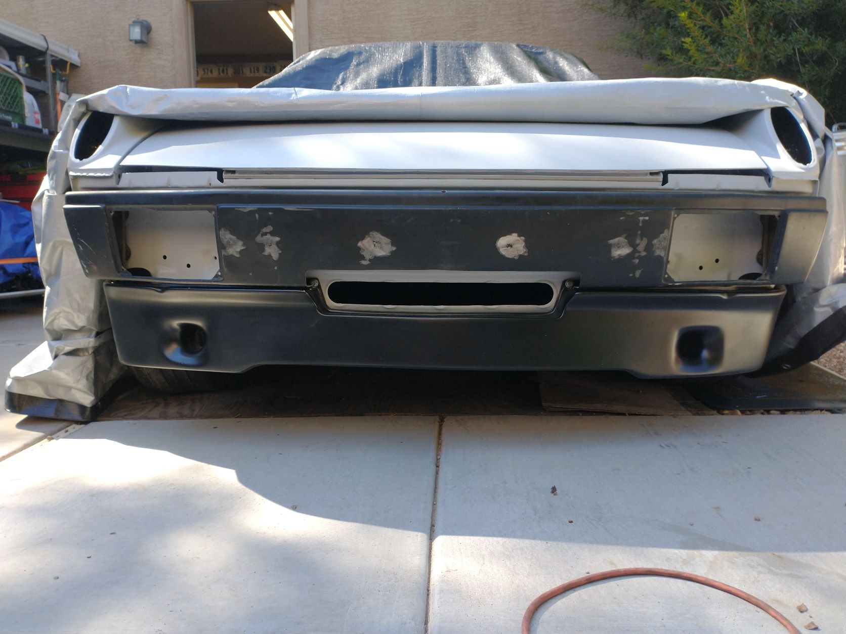

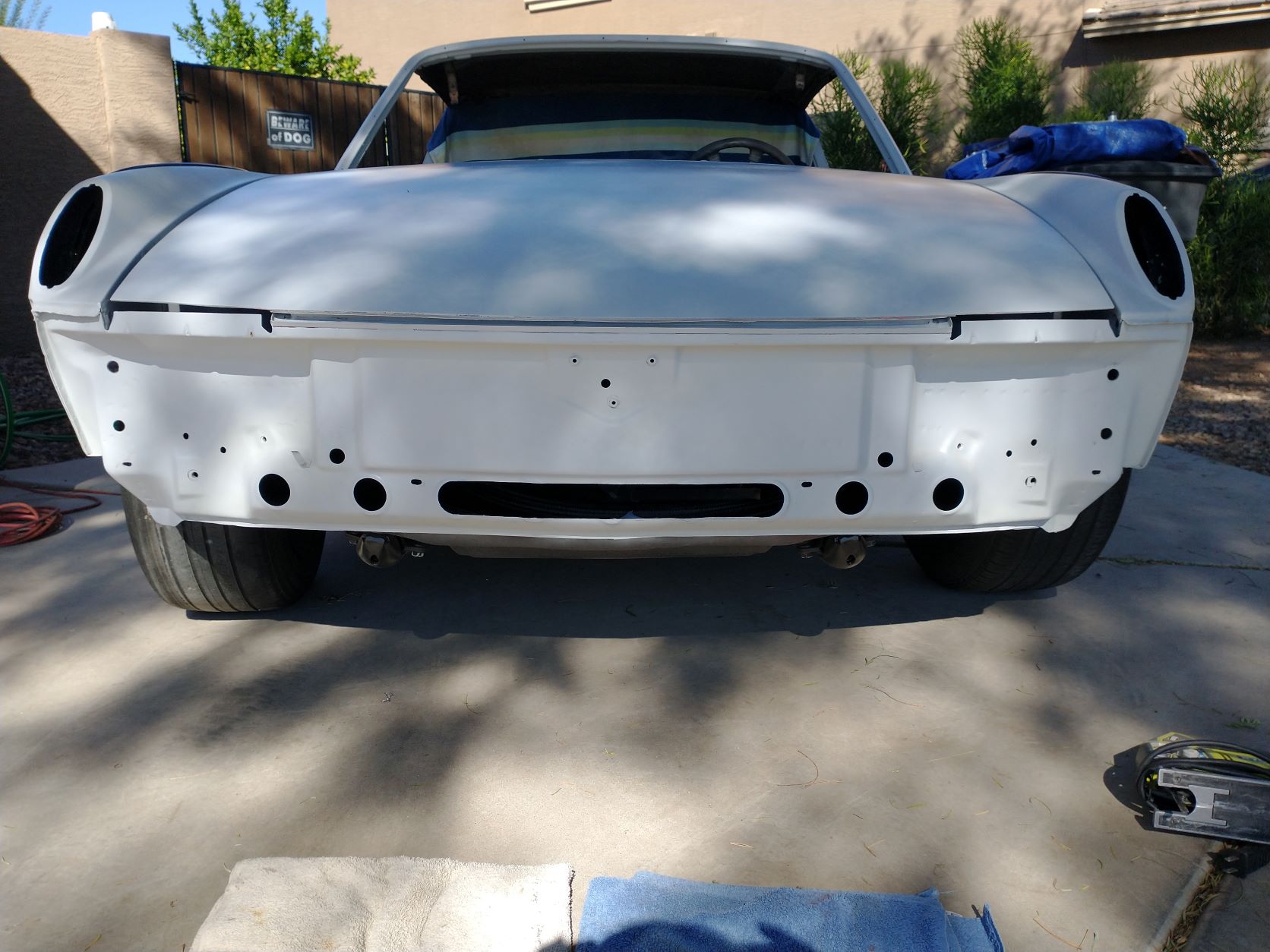

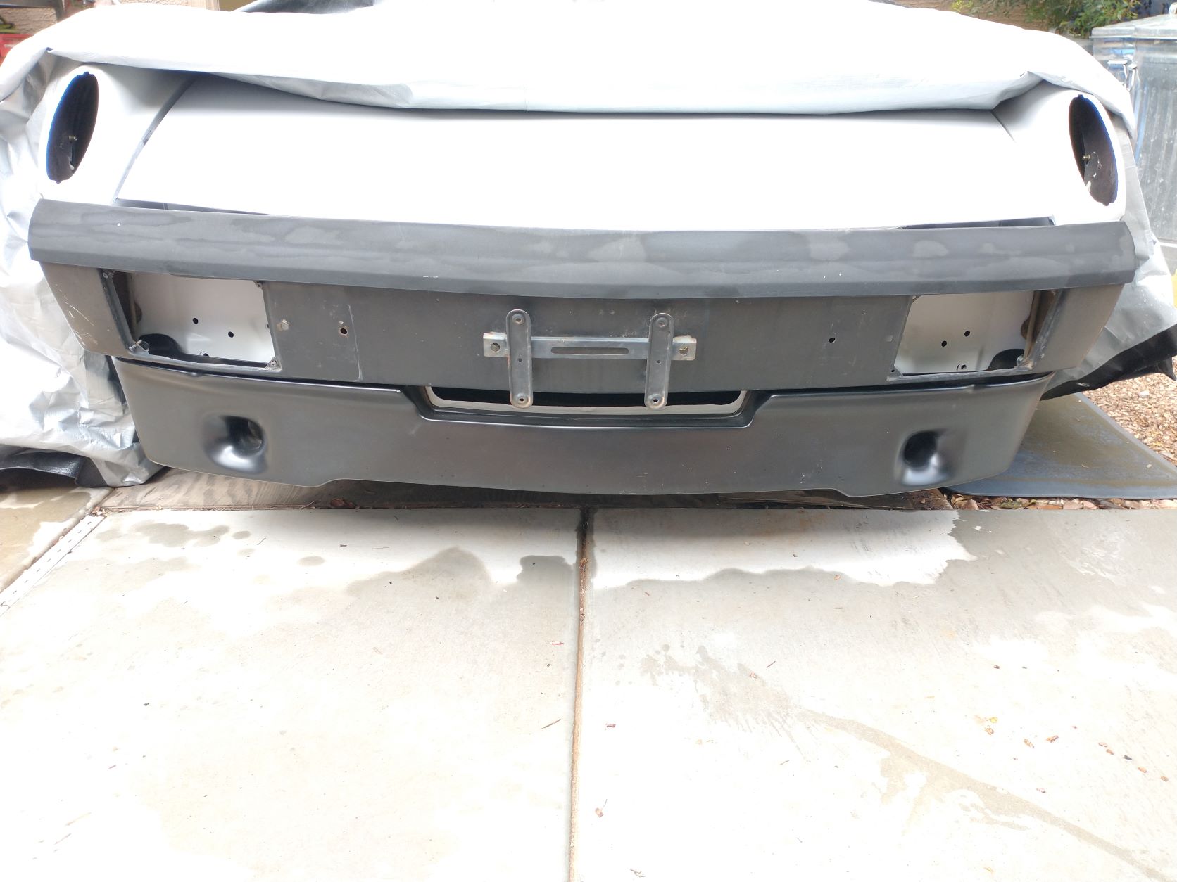

I did manage to roll the 914 out, clean her up a bit and then cut the radiator inlet opening. Not much, but something!

Nice intake; I like the minimalist approach. I drilled holes between the factory holes, so maybe about the same amount of airflow. Counting on my EZ30R not being too hotheaded. Car looks great, BTW!

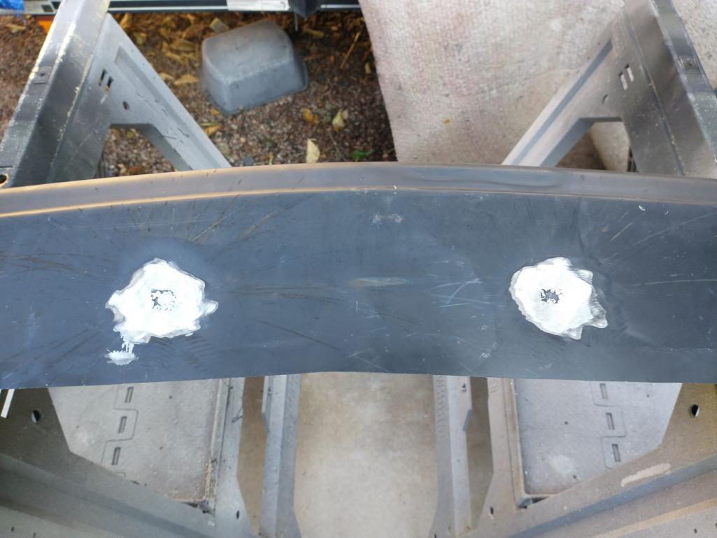

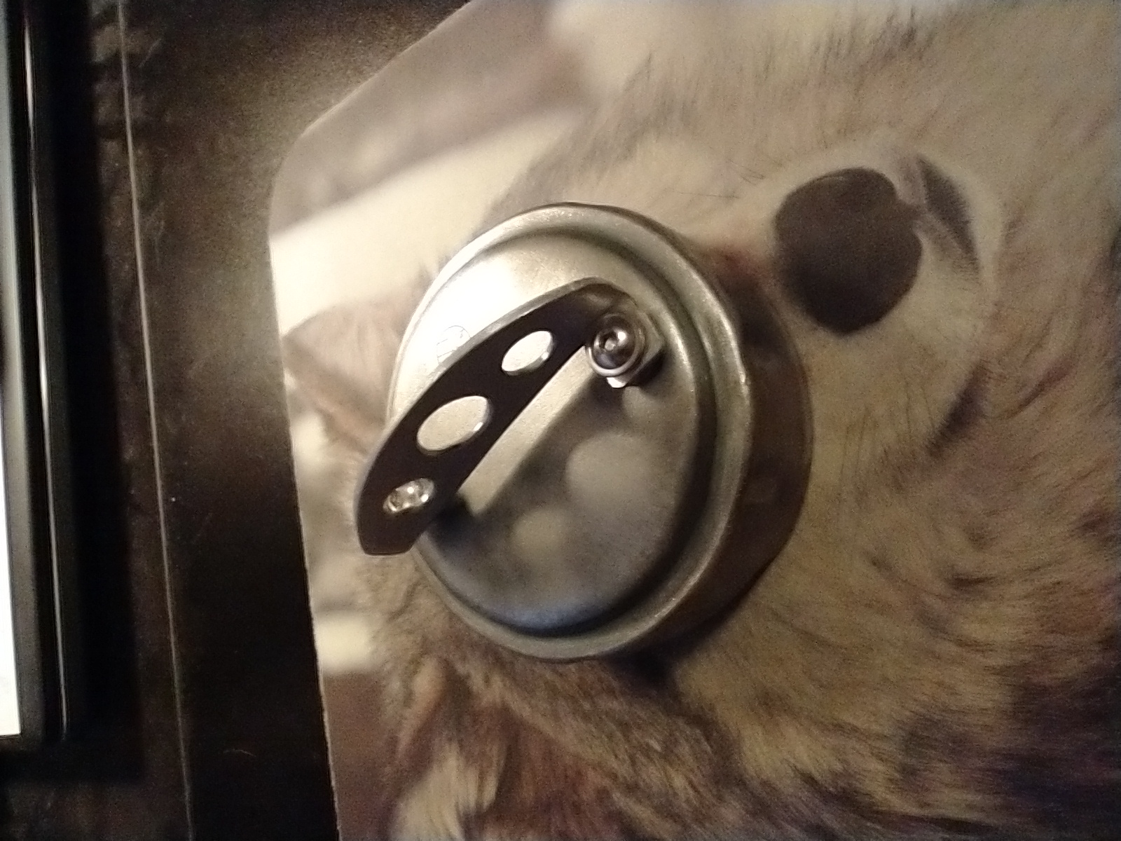

I'm still saving up $$$, but in the meantime trying to keep doing little things as distractions.

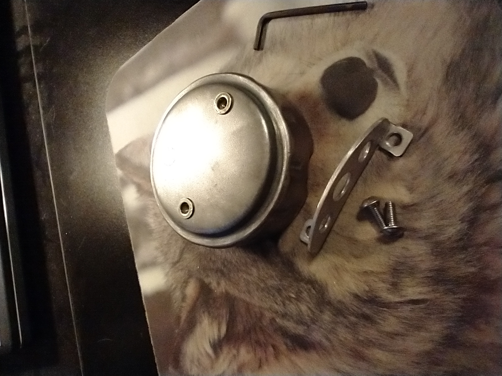

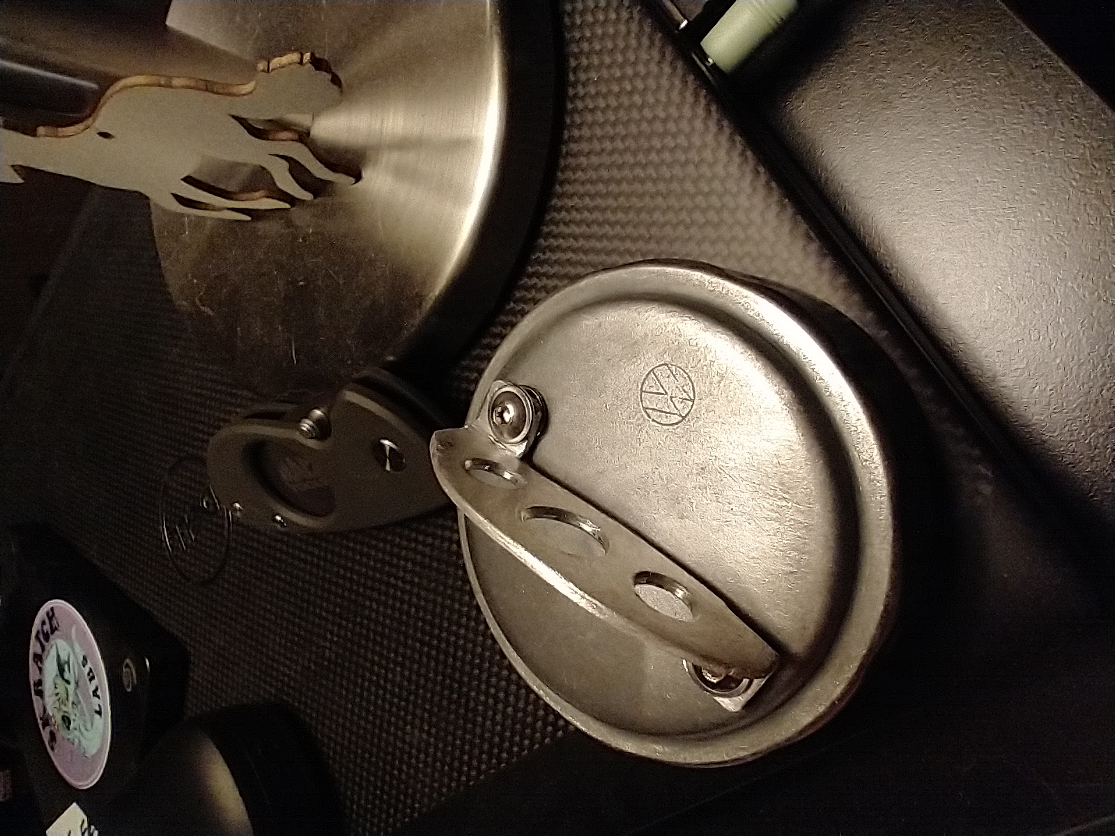

Here's this afternoon's diversion... (IMG:style_emoticons/default/idea.gif)

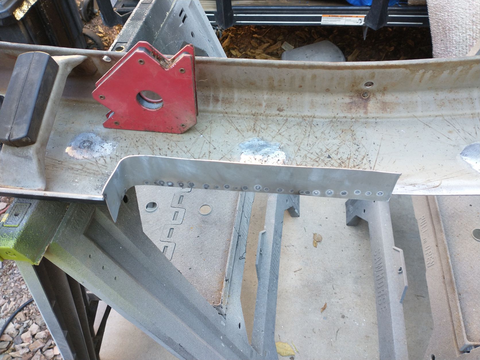

Had to use rivnuts instead of pop rivets, and my holes did not line up perfectly, but close enough! (IMG:style_emoticons/default/aktion035.gif)

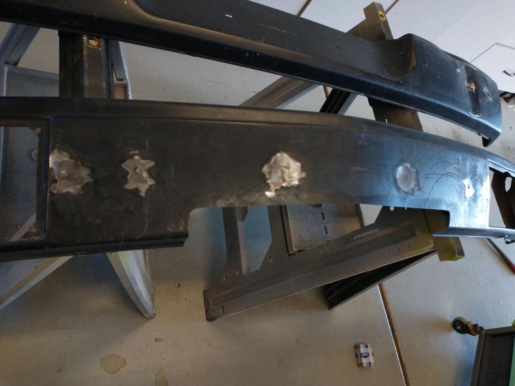

Trying to keep myself busy without spending money (IMG:style_emoticons/default/blink.gif)

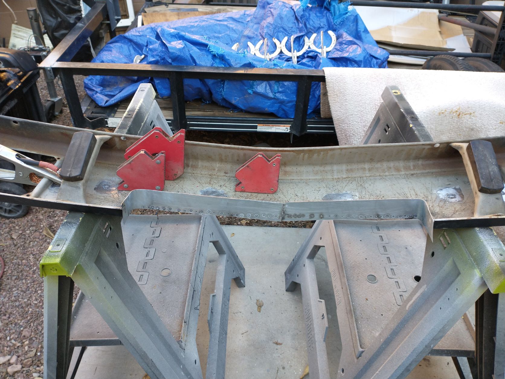

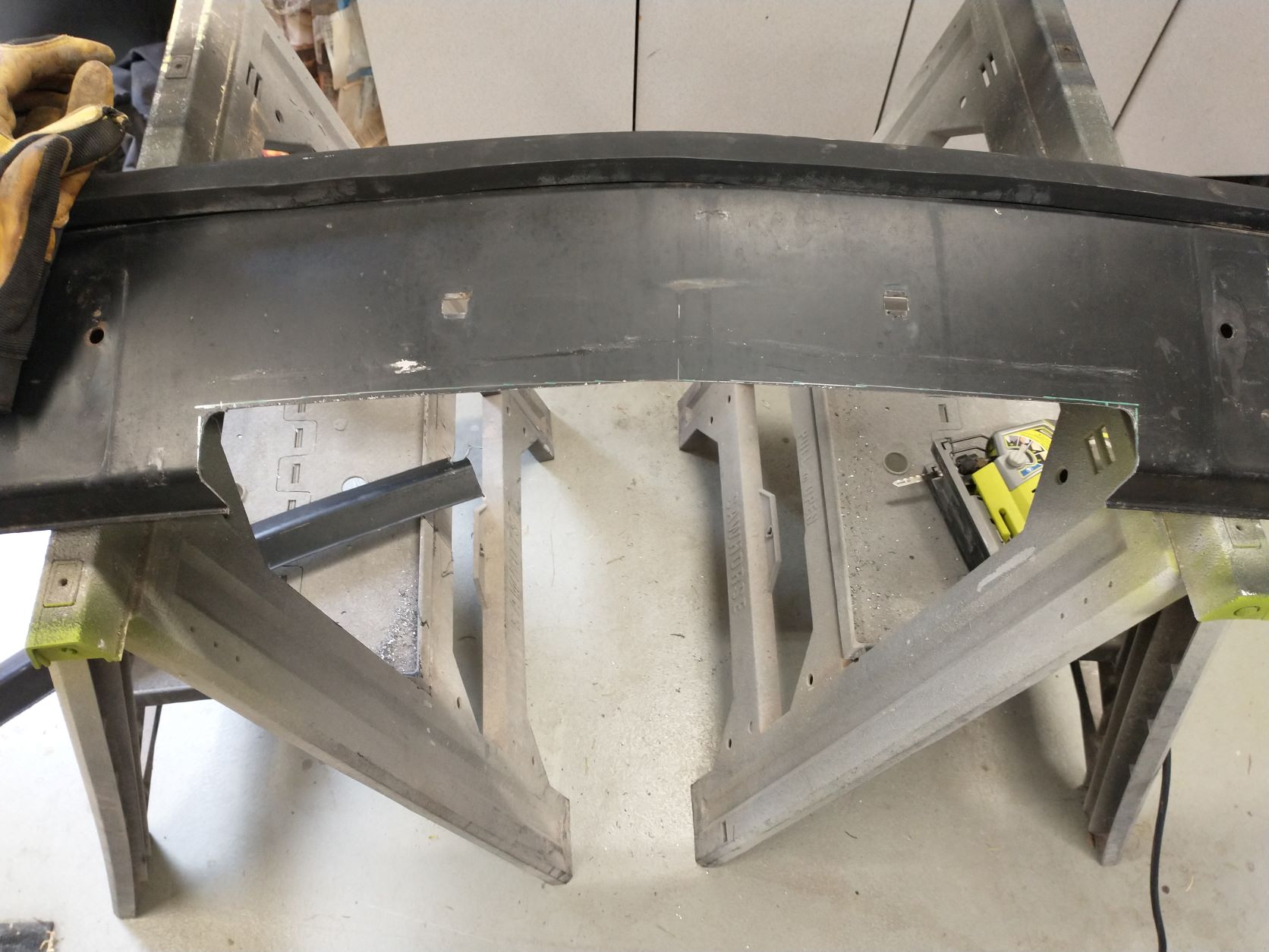

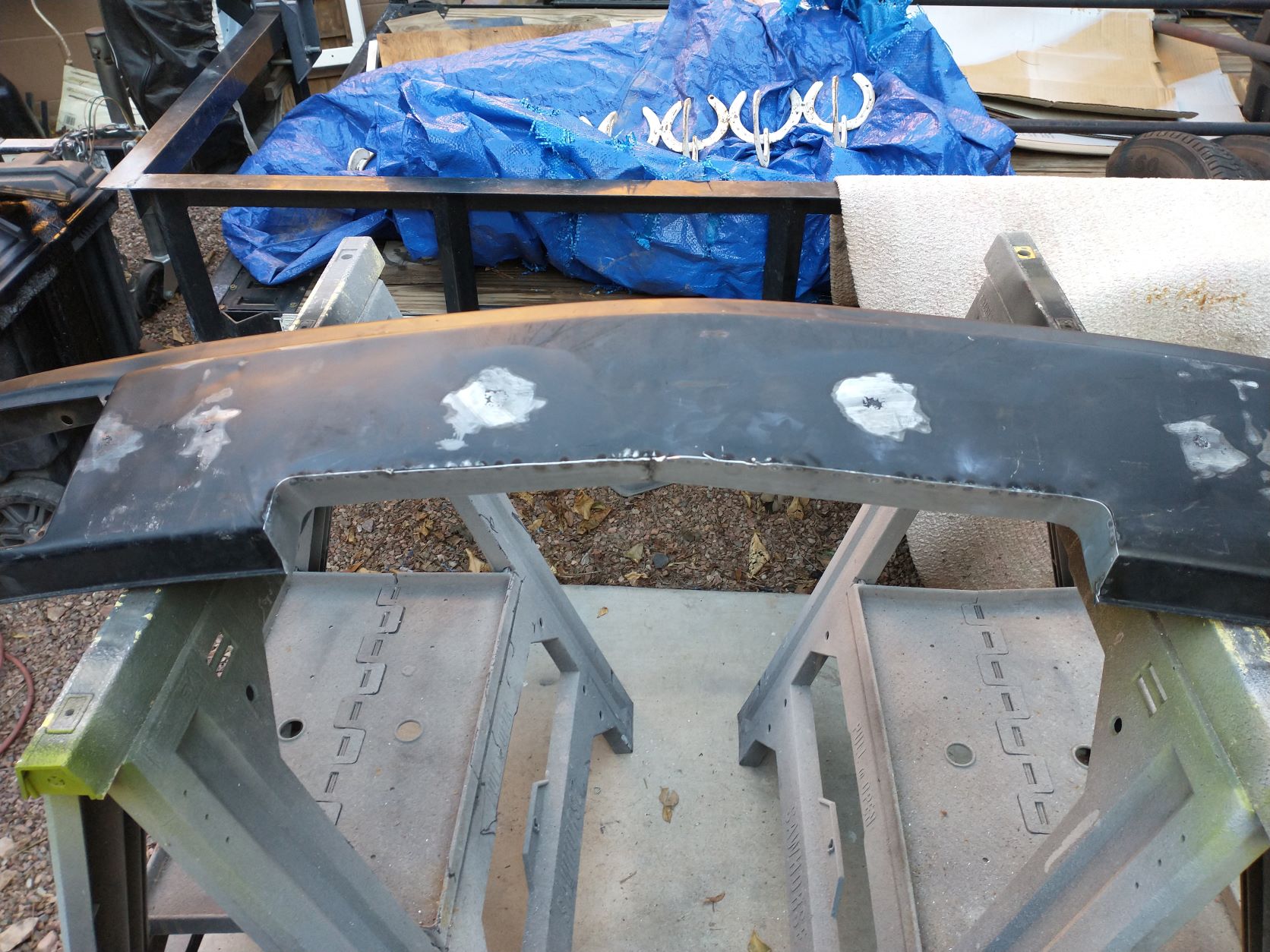

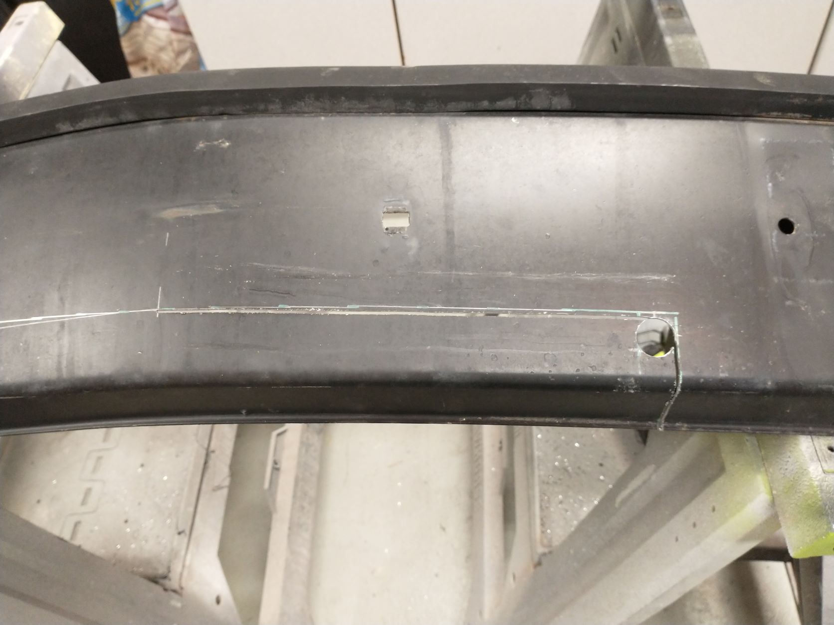

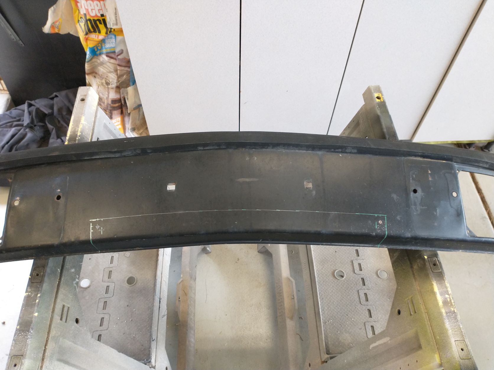

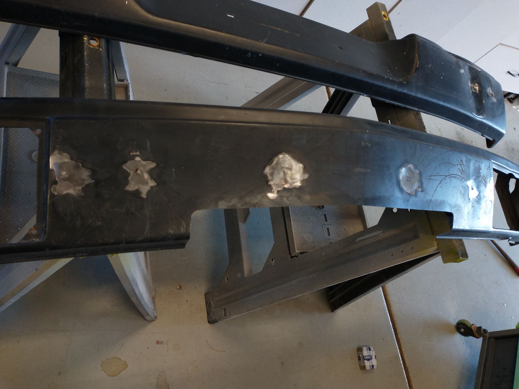

I decided to see if I can reuse the old steel bumpers that came on the 914. They are not great, but not horrible either. I mounted the front up real quick to mark where the cooler opening from the valance lines up.
Once I had the sides marked, I laid out where the opening needed to be to line up with the valance opening, and match where I can cut the opening on the nose without messing with the bracing that goes around where the spare tire sat.
I drilled the holes for the two corners (was off a smidge on both), grabbed some earplugs and started cutting (IMG:style_emoticons/default/sawzall-smiley.gif)
Came out pretty good. Toyed with using the cut out piece to match the lip on the rest of the bumper & valance, but need to mount on the car and measure first.

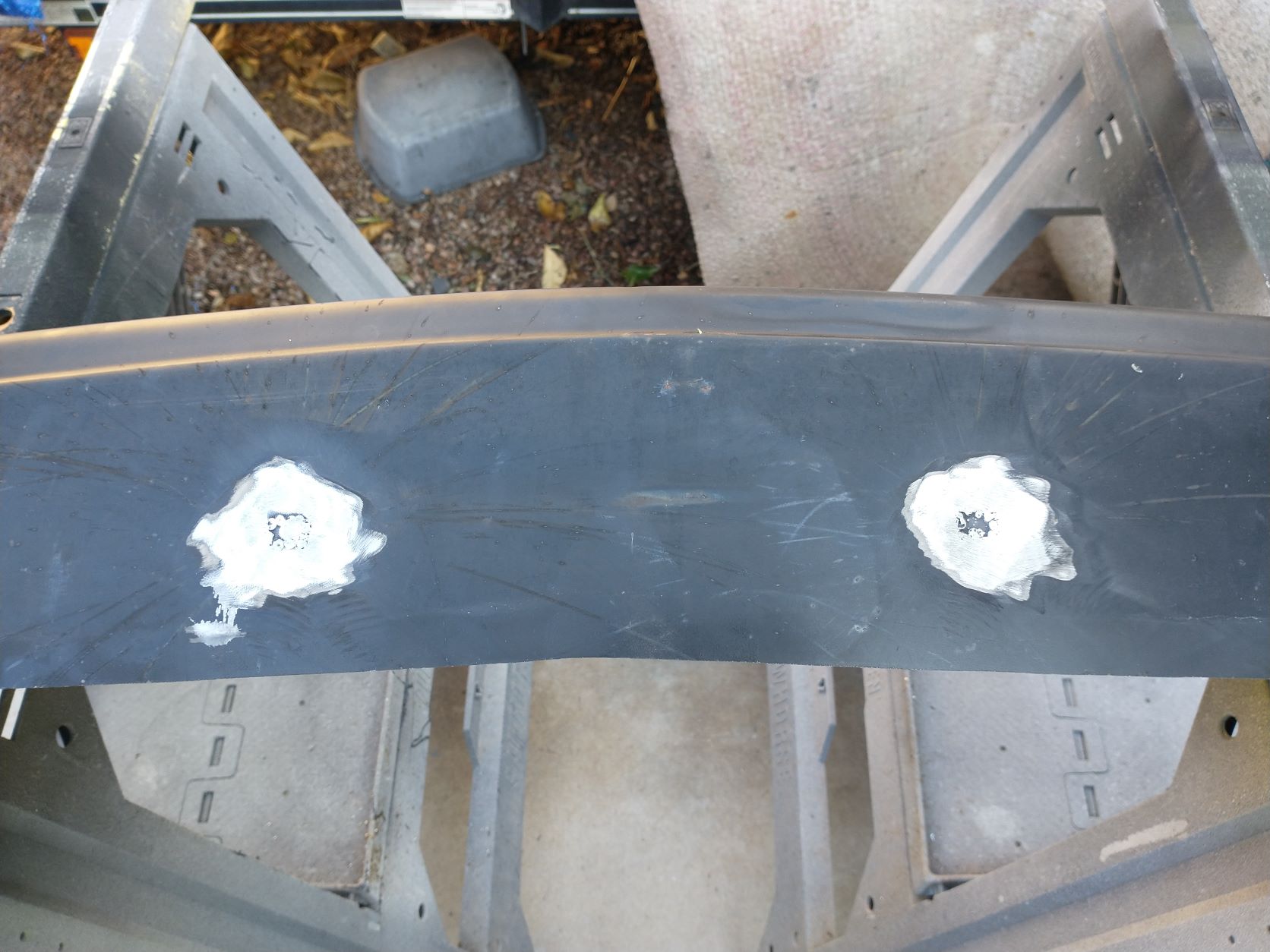

I cut out and welded in some patches for the openings where the license plate bracket was mounted, and where the holes were for mounting the rubber bumper blocks.
I still need to fill and sand my patches. Front does not look too bad, but the back was pushed in where the blocks mounted and will take a bit more work - you can see the dent on the right side of this pic! (IMG:style_emoticons/default/smash.gif)

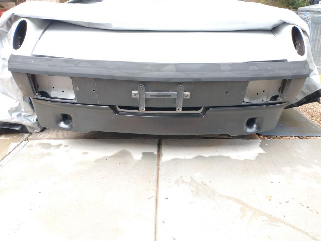

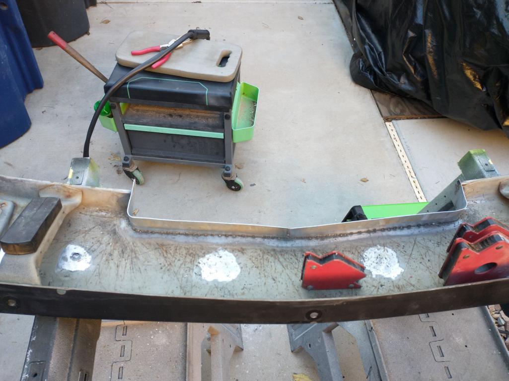

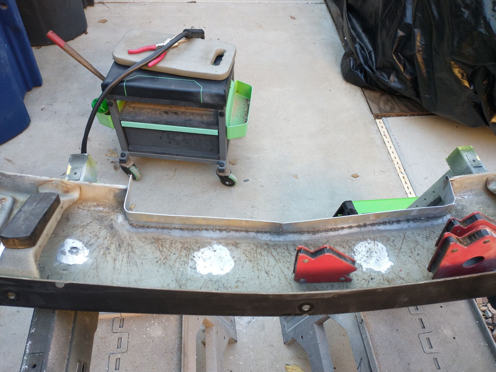

Quick test fit on the car to get some measurements for trimming out the opening I cut.
Once I had a rough measurement, I started cutting and forming the pieces I would need.
I needed to do two pieces because the scrap steel I had was not long enough for a single piece. I think it worked out better that way because the angle on the bumper would have made a single piece a challenge!
Mostly in place and tacked.
Pay no attention to my crappy welds! (IMG:style_emoticons/default/confused24.gif)
Did a quick, rough trim with the nibbler. More work to do with the angle grinder and body filler!
