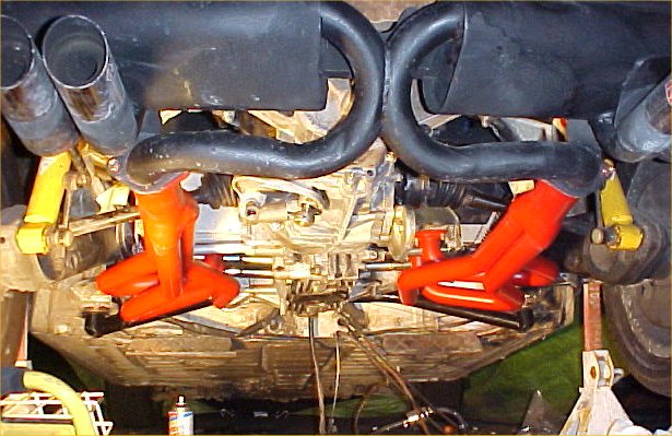

Trekkor
post Jul 5 2005, 06:31 PM
I do things...
Posts: 7,809
Joined: 2-December 03
From: Napa, Ca
Member No.: 1,413
just isn't room to put it before the mufflers in a 914
Oh, but there is...
Sounds great, too. (IMG:http://www.914world.com/bbs2/html/emoticons/wub.gif)
KT
bondo
post Jul 5 2005, 06:36 PM
Posts: 4,277
Joined: 19-April 03
From: Los Osos, CA
Member No.: 587
QUOTE (trekkor @ Jul 5 2005, 05:31 PM)
Oh, but there is...
KT
Ooh, that's clever!
