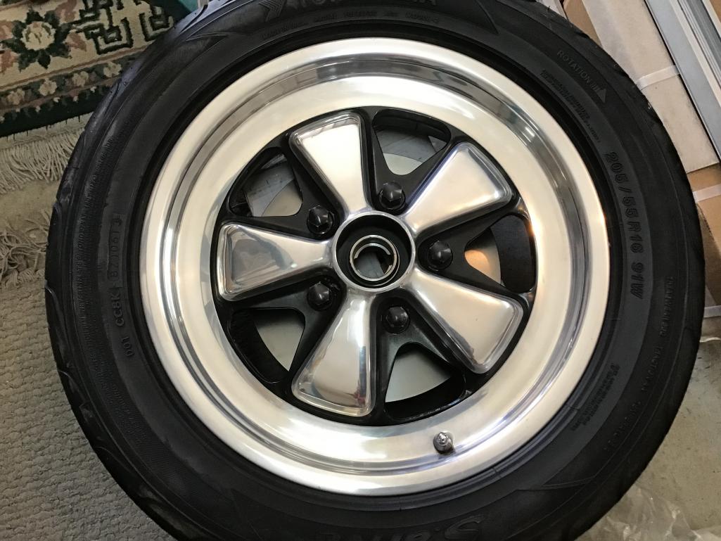

I am getting close to having the car ready for paint. Once I finish this I will get the car back to a roller so I can flatbed to the paint shop. I want to use my old 4 lug Fuchs to sent to the paint shop and not my nice 5 lug Fuchs.
This is where I need advice, I sent my 4 lug hubs to PMB to be converted to 5 lug and also purchased the kit. Since I no longer have the 4 lug hubs, what would be the easiest way to accomplish this. I know Ivan purchase a pair of 4 lug hubs, just wanted to make sure I am not missing something easier.
Also, I want to know if I can install the stub axles without the axles just to get it to the paint shop. There will be no engine in the car.Attached Image
I want to use these wheels to take to the paint shopAttached Image

If you haven't installed your five lug setup yet, install the 4 lug with stubs and you'll be fine. use old bearings since you will ruin them when you pull off the hubs.
or you can find someone with an old set of trailing arms with hubs and stubs
or you can find/borrow some old five lug wheels. We use repos, spares and junk wheels for rollers and paint.

I agree....don't use those 4 lug Fuchs for paint. Sell them (they are worth good money) and buy some cheap wheels from a forum member.
Another option is put on the 5 lug conversion and use a cheap set of Boxster or 996 wheels for rolling around. There are plenty out there for much less than your 4 lug Fuchs will sell for. That will also give you the option of having cheap roller wheels if you need them again in the future.

Thank you, maybe some out there has some 4 lug hubs, and I’ll start looking for some cheap wheels. I have one steel wheel, so only need 3 more.

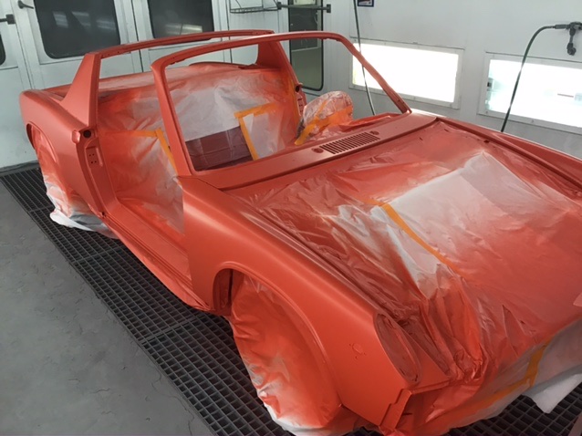

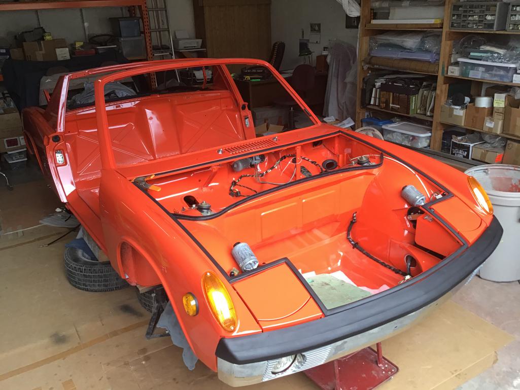

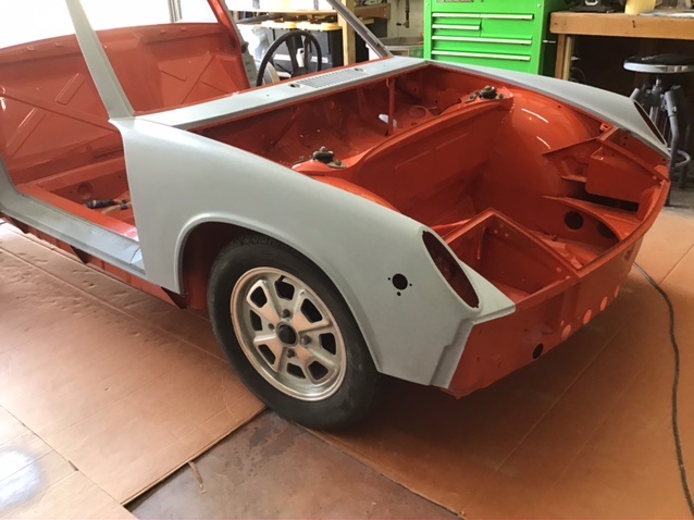

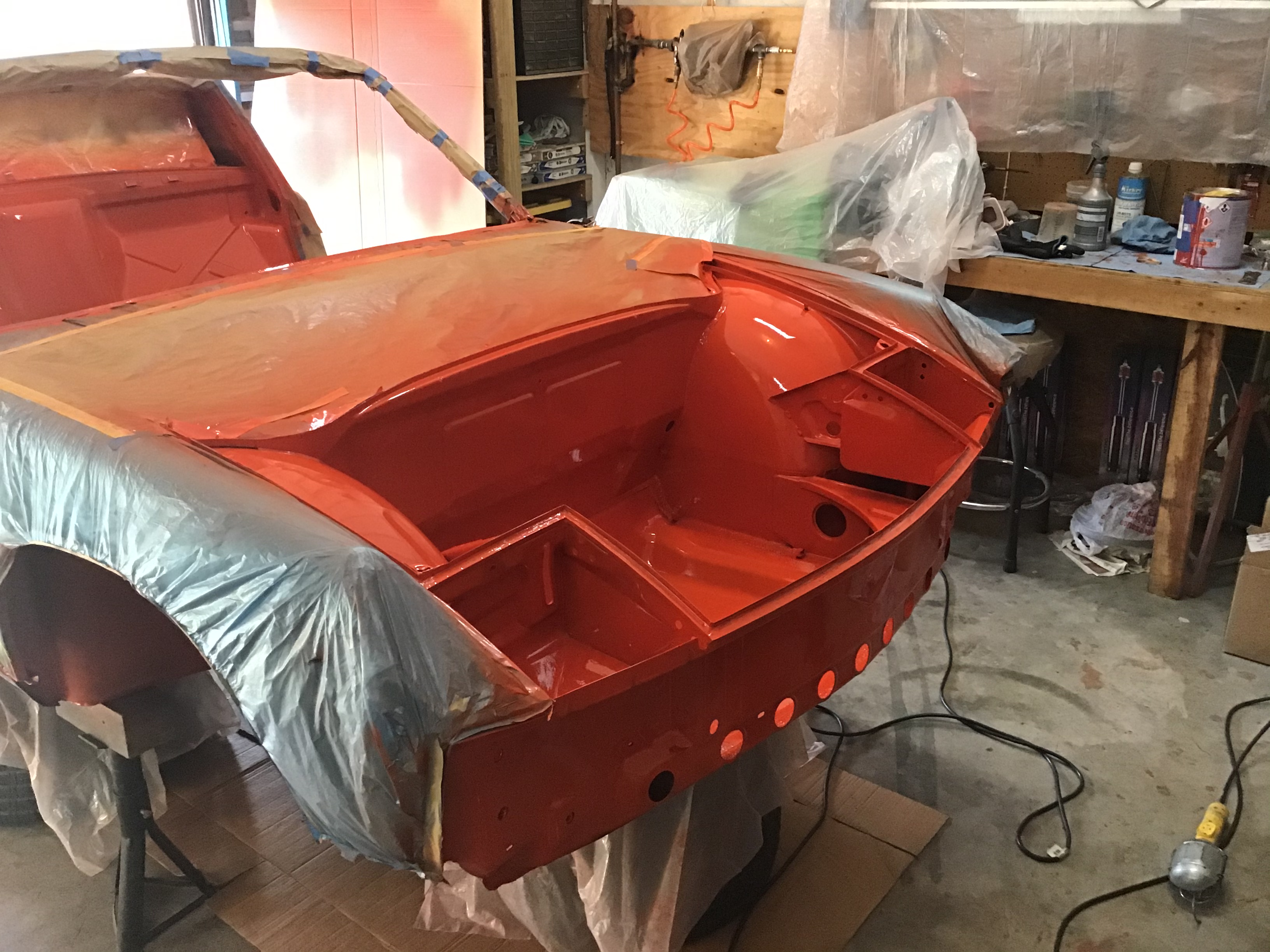

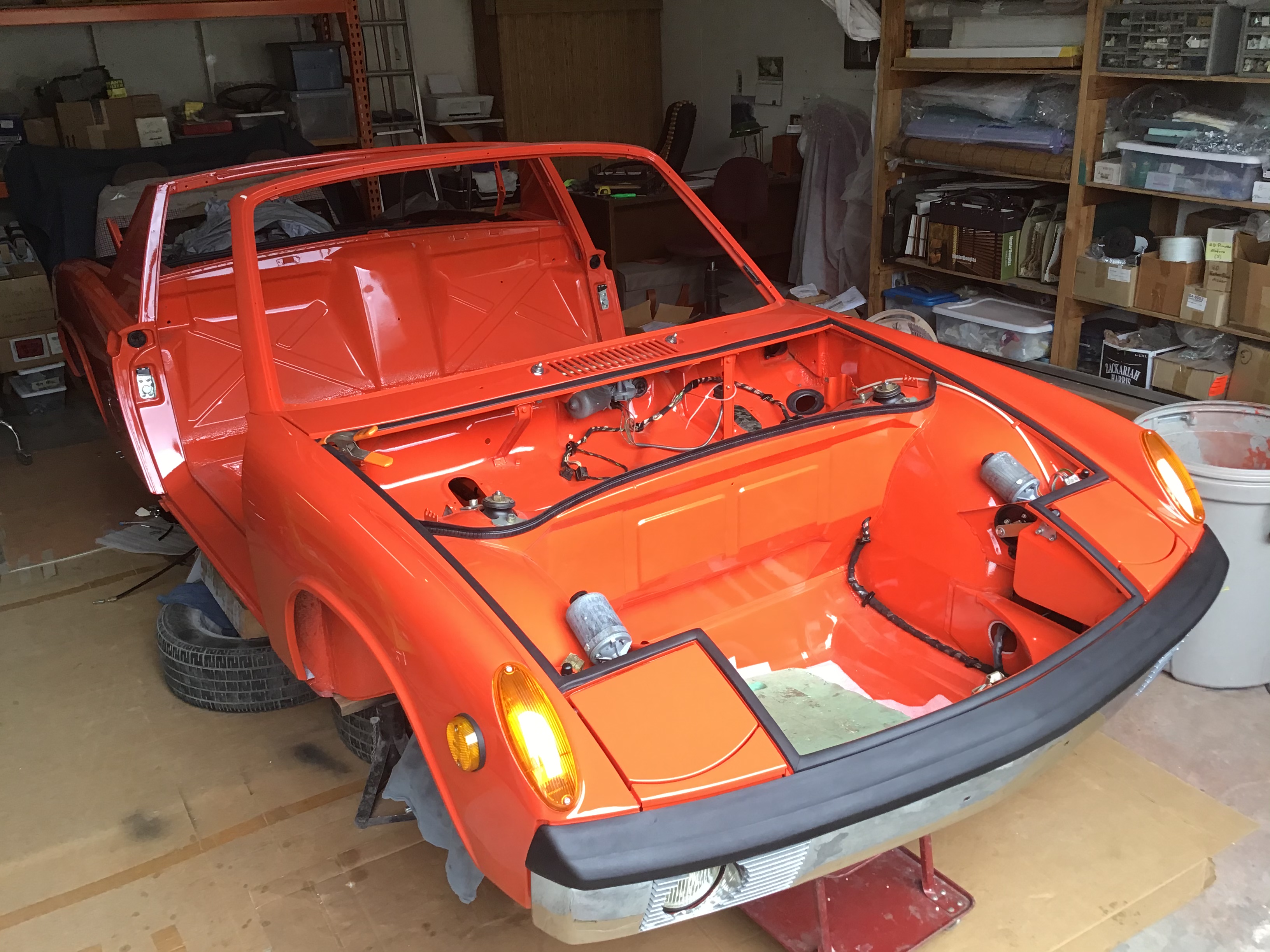

I guess I will continue the build postings here instead of many new threads. I have had a hard time finding this link because I have not posted anything here in a while. Any trick to this?
After being back from paint, it has been very rewarding to start putting it back together and seeing some light at the end of the tunnel. (IMG:style_emoticons/default/piratenanner.gif)

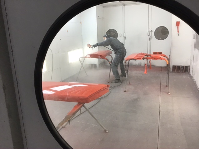

I painted everything except the exterior, including raptor on the belly with single stage.
I completed all the body work and finished using 400 grit wet sanding.
Off to the paint shop
And after a few months, this is where I’m at with the car now

post Sep 29 2020, 07:32 AM

JOEPROPER

Very nice progress. Inspiration for the reset of us! (IMG:style_emoticons/default/aktion035.gif)

Looks amazing. (IMG:style_emoticons/default/beerchug.gif)

Very nice to see it all coming together. You are going to have a great car and lots of fun driving it around. (IMG:style_emoticons/default/beerchug.gif)

Everything looks so nice at this stage. Assembly is a bit challenging but fun.

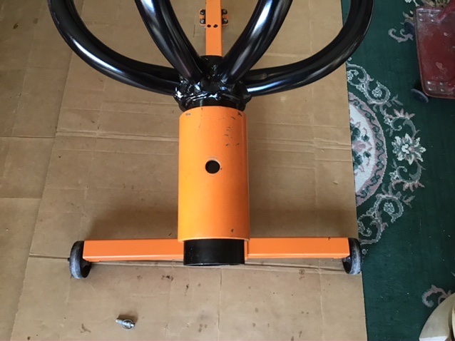

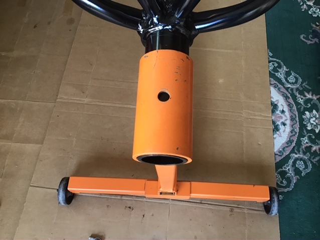

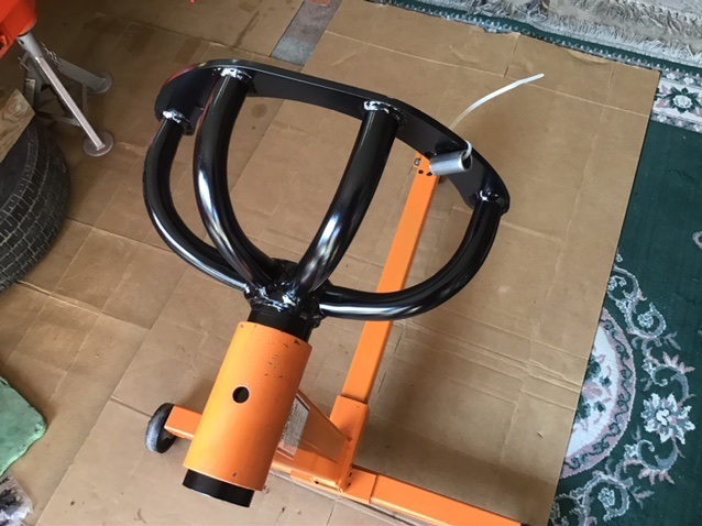

I just received this engine yoke from the Samba. I was wondering if it will be obvious where to drill the holes when I get the engine mounted to the yoke and on the stand? Or shall I drill holes at 12,3,6, and 9 o’clock? Also not sure what the attached sleeve or bushing is for (IMG:style_emoticons/default/confused24.gif)
Also would like to know if there is any advantage to the yoke positioned all the way in or out flush with the edge, or somewhere in between.Attached Image Attached Image
I have upgraded from 1.7 to a 2.0 and it has already been rebuilt to stock but I wanted to get it on a stand to install all the tidbits. I plan on building a big 4 with the 1.7... unless a six comes along that I cannot live without.
Thanks for your replies,
John
post Sep 29 2020, 02:54 PM
914-6 GT in waiting
Posts: 20,980
Joined: 19-September 09
Member No.: 10,825
Keep the yoke all the way in. I would drill holes every 90 degrees. The hole doesn’t have to be very big. It just needs a rod or bolt to keep it from turning while you work.

QUOTE(mepstein @ Sep 29 2020, 02:54 PM) *
Will do , I held the yoke up to the case where it mounts, and there is not much meat on that case to hold the weight of the engine. I will proceed with caution.
John

I have the same yoke and that's what I did. Also when you decide to go to a 6 you can use the same one (IMG:style_emoticons/default/biggrin.gif)

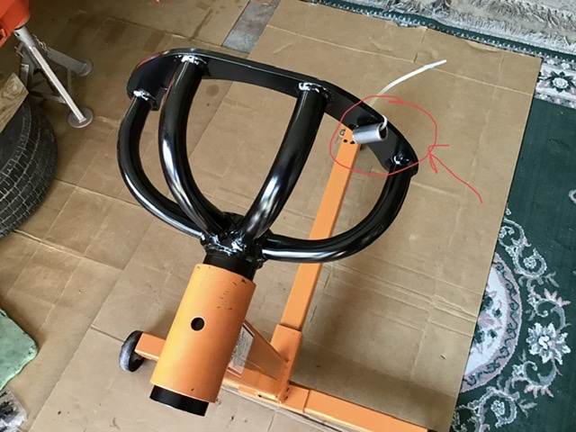

Anyone know what the zip tied sleeve/ bushing is?
VaccaRabite
post Sep 30 2020, 06:05 AM
En Garde!
Posts: 13,930
Joined: 15-December 03
From: Dallastown, PA
Member No.: 1,435
QUOTE(Morph914 @ Sep 30 2020, 07:29 AM) *
A spacer for a long case stud.
Zach

QUOTE(VaccaRabite @ Sep 30 2020, 06:05 AM) *
Zach
Thank you, I figured that’s probably what it was for, but it’s nice to confirm with the almighty forum.

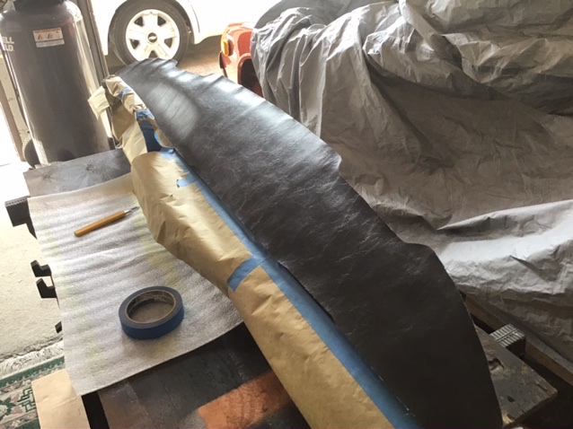

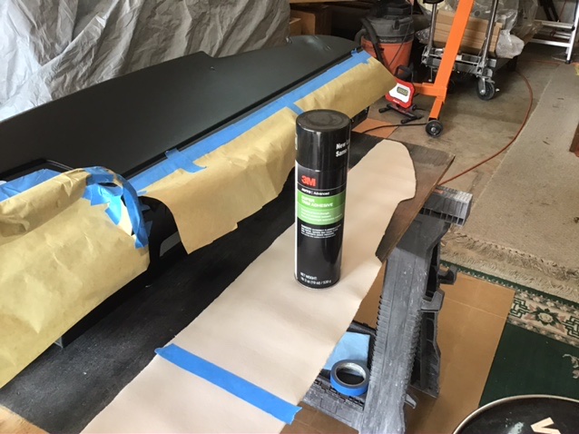

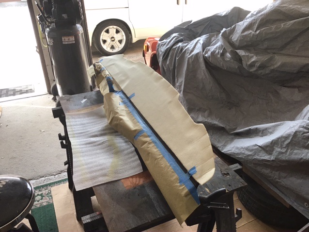

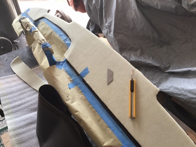

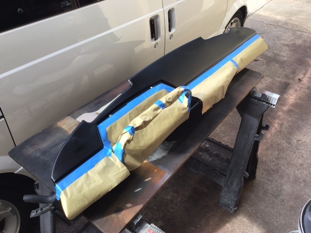

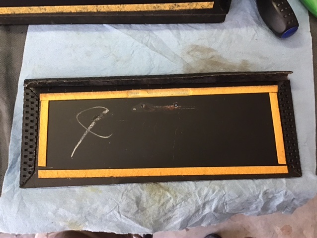

Since the weather is fantastic here today, I am working on the dash. I have installed the padding but I’m not in love with this vinyl top piece, it has too much sheen to it. I noticed in Ian’s video, his had more of a matte finish, which is desirable for low reflectivity. Both from 914 Rubber, but mine may be older. I will find out before proceeding any further.
Taped off to avoid glue where I don’t need it.
Installed some reference points and only glued half at a time.
Went on well with no issues.
Tools of choice
Morph914
post Sep 30 2020, 08:40 PM
Posts: 435
Joined: 22-August 16
From: St Augustine, FL
Member No.: 20,326
I decided not to use this piece of vinyl due to the high sheen. 914 Rubber has agreed to exchange it for a different material. I will continue on with installing the new basket weave to the front of the dash.
