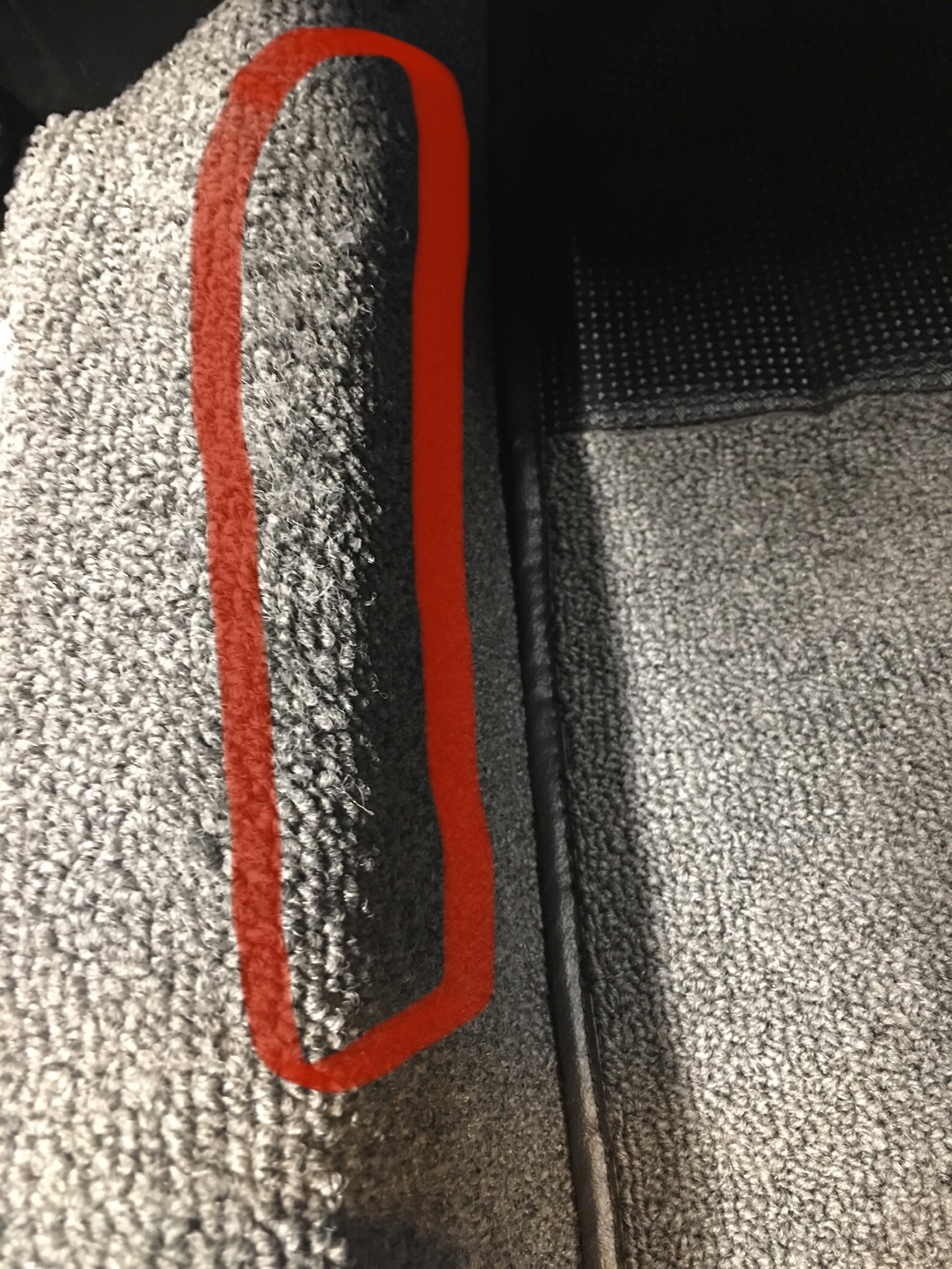

Installed new carpet from 914 rubber about four months ago. Beautiful install great carpet. Now every time I get out of the car I drag my foot across this one spot of carpet and it’s starting to frizzle and fray. I’m sure I’m not the only person that this is happens to. Looking for suggestions on some type of clear tape that’s very durable and won’t peel up easily to put on this edge.

The domestic charcoal is a light duty(less dense) carpet and will not hold up as well as the German. However, you can protect it or other carpet with this inexpensively.

You might be better served to take that piece into an upholstery shop and have them stitch a nice heel pad on that spot so you solve the problem and it looks like a planned part of the carpet? Just a thought. (IMG:style_emoticons/default/beerchug.gif)

Back in the day there used to be small aluminum (stainless?) threshold covers, usually machine turned. Maybe a set of those if you can find them?
Is that the ‘domestic loop’ material? I’ve found that the German loop holds up better. But the aftermarket carpets don’t have the same backing that the factory had. The factory backing helped hold the carpet in the shape it needed to be in to fit the area it was designed for. It’s the white/clear plastic like material on the back of the factory carpet pieces. That material helped hold the shape of the carpet...and helped the loops to its backing without unraveling.

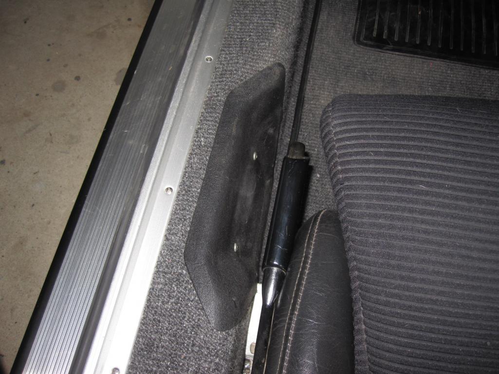

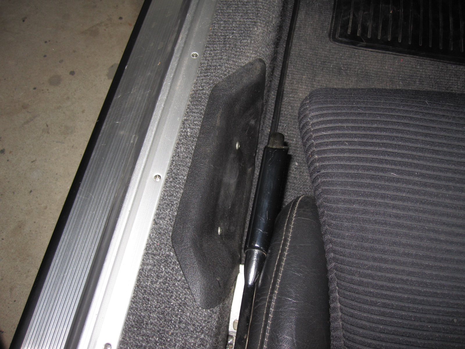

Fabricate a hard cover.
I made this from fiberglass to define the recess for my hand brake.
Look for a bendable or flexible black plastic sheet. Cut to size, radius the corners,
Attach with four black truss head sheet metal screws.

Great idea and looks like it belongs there.

I can tell from the loop it is the domestic charcoal. Perhaps we just offer up an individual piece at $25 ?
The German wears MUCH better. However, the domestic black we have is at par with the German stuff.
Let me know, I'm thinking maybe we could make a clear protector? something that would be easily removable.

that is so cool! i want one of those - make some i bet you will sell fast, or maybe 914rubber would?? @mikey914 @rgalla9146

It’s the middle level carpet set from 914rubber. Not German. Yes if someone makes cover for that place I’d be interested.
