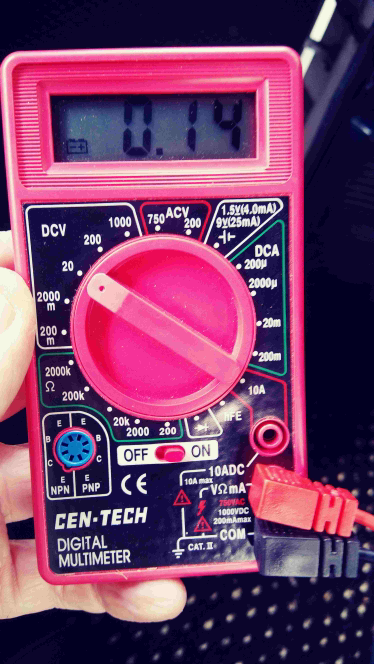

Hi everyone, I've gone through the horn posts and tried to do everything correctly, but I still cannot get my horn to work. I purchased the horn contact ring from Sierra Madre. I've added nylon insulated washers to the Batwing. I have switched out the relay from a working headlight. I have also put in a new fuse. When I touched the horn contact ring female spade terminal to the steering wheel nut I can hear something electrical making almost a clicking sound. When I check it with a meter I am getting 12 + volts when I touch the nut with the terminal.

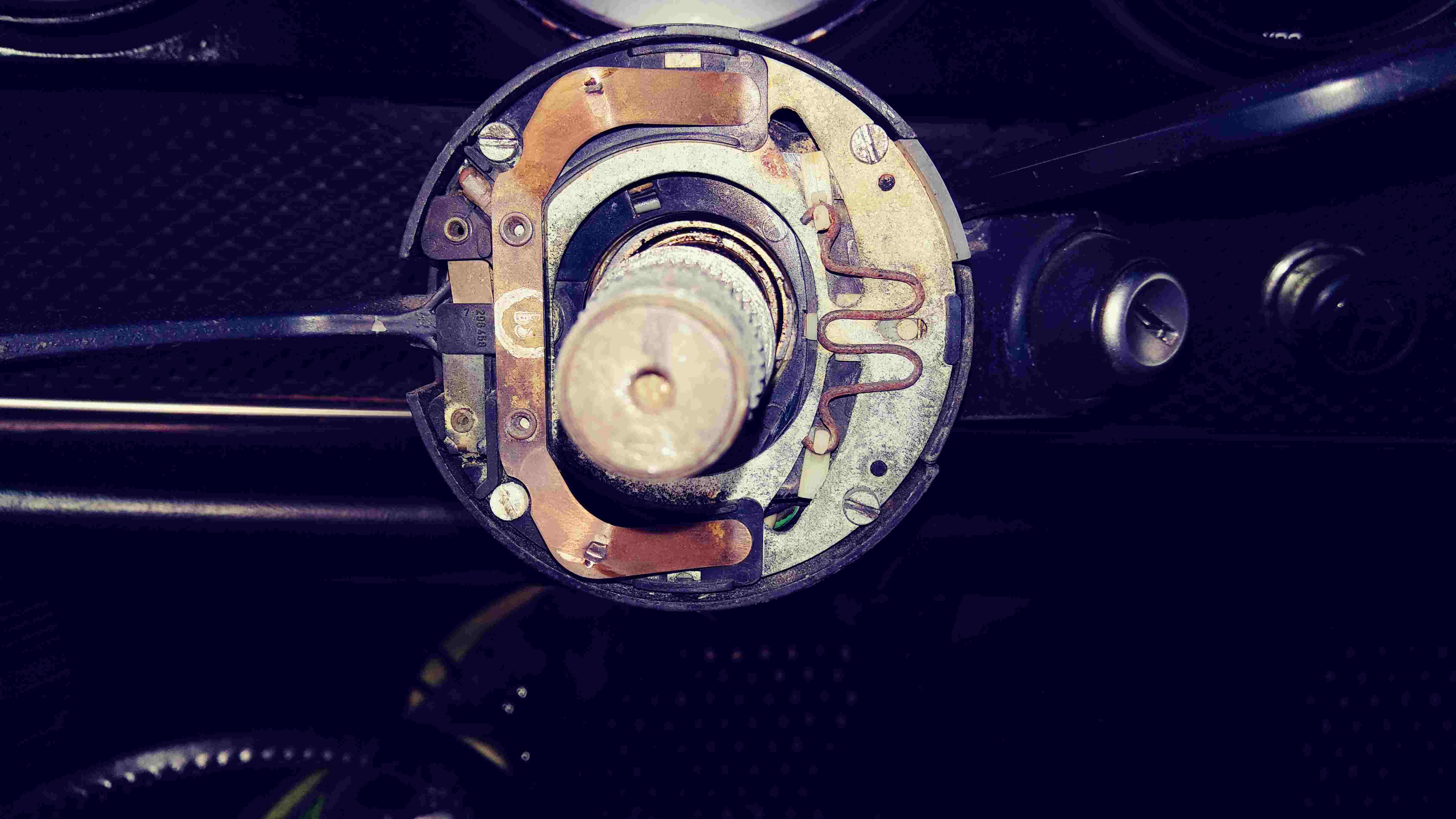

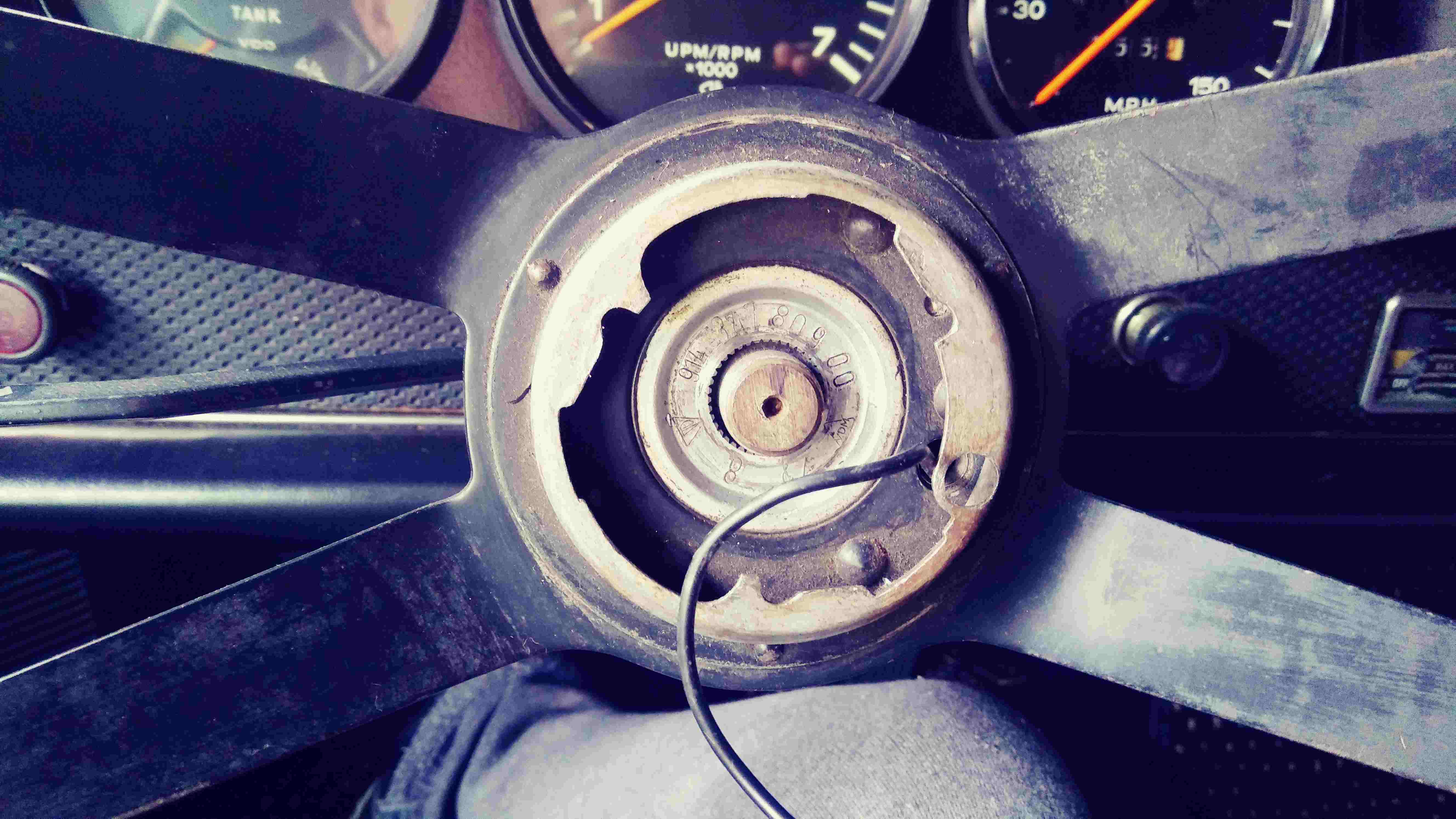

I pulled the horn and checked it on a battery and it works. I sanded down the horn contacts and added dielectric grease. I am not an expert with the multimeter but I did hook up a negative and positive to the leads that connect to the horn and when I touch the nut I was getting a very small amount of current less than a half volt. I did drive it without the Batwing connected to the wire and the turn signals did not cancel. However they did not cancel before I got the new Sierra Madre contact ring. question about the area where the wire comes out of the steering wheel. Is the hole supposed to be on the top left side or the bottom right side? You'll see in the picture that mine comes out of the bottom right side.
When I purchased this car it had an aftermarket steering wheel. I bought a 914 wheel and batwing off of Craigslist and it fit. what am I doing wrong? Thanks in advance for any help you can give me.Attached Image

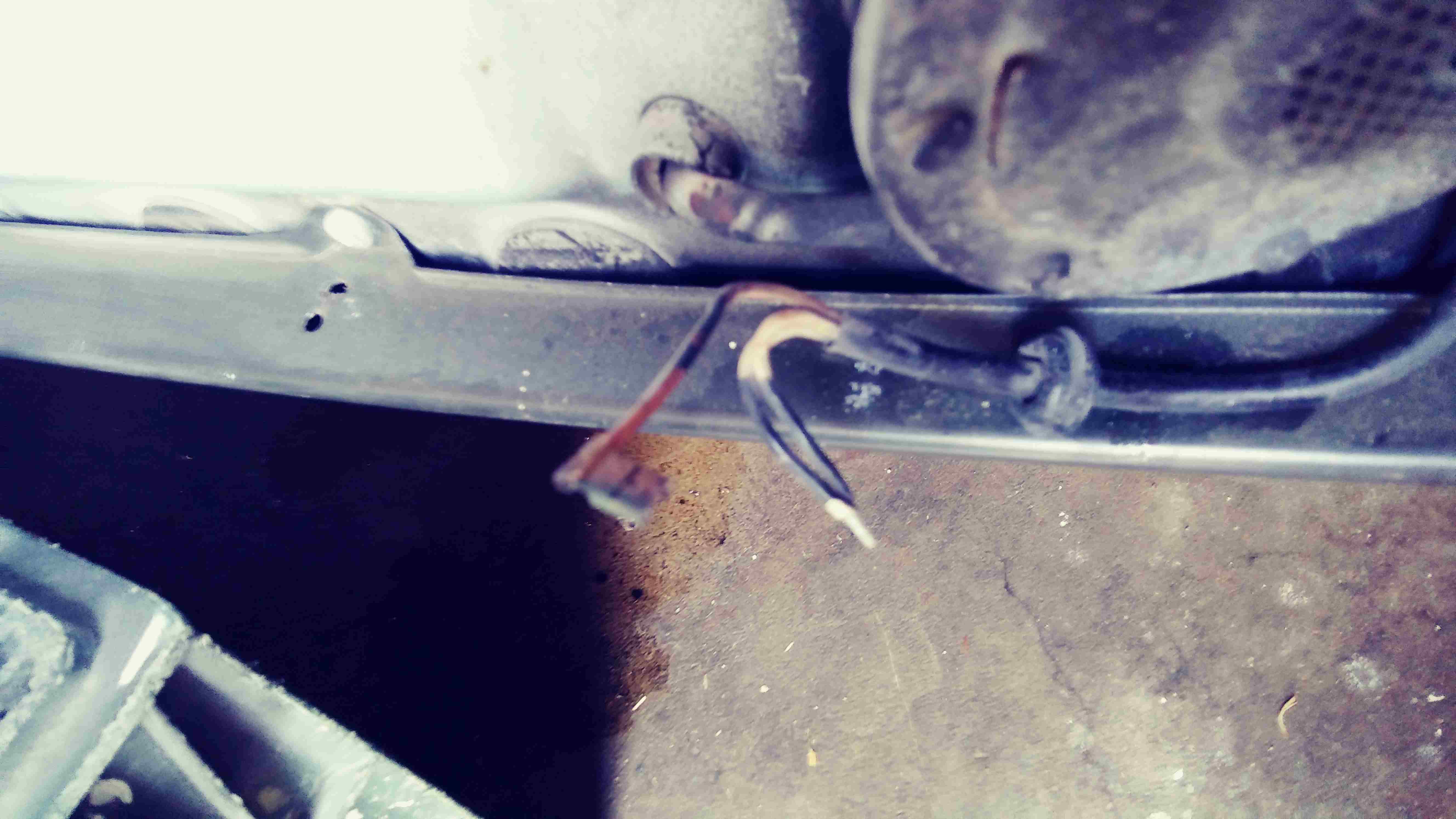

Have you tested for continuity (or 12v ) from the output side of the relay to the horn,reason I asked is that if the relay is energizing it should work if the power is getting to the horn.
Edit as I (IMG:style_emoticons/default/type.gif) ,you mentioned you had a small amount of power,some horns don't function on very low voltage,you could try running a spare short piece of wire off the relay to the horn as it seems the original wire is damaged/faulty.

porschetub you are my hero. I went to hook up test wire and when I connected it to the brown wire from the relay the relay stopped working. Must be an input wire. I was about to give up when I looked at the horn again. Saw the two pigtailed wires and female spade terminal that I believe go to the optional horn. Unplugged one of my female Spade Terminals and plugged in the one that was not connected. The horn works now. The p.o. did a number on me. Your last reply porschetub gave me the boost to give it one more shot. Thank
