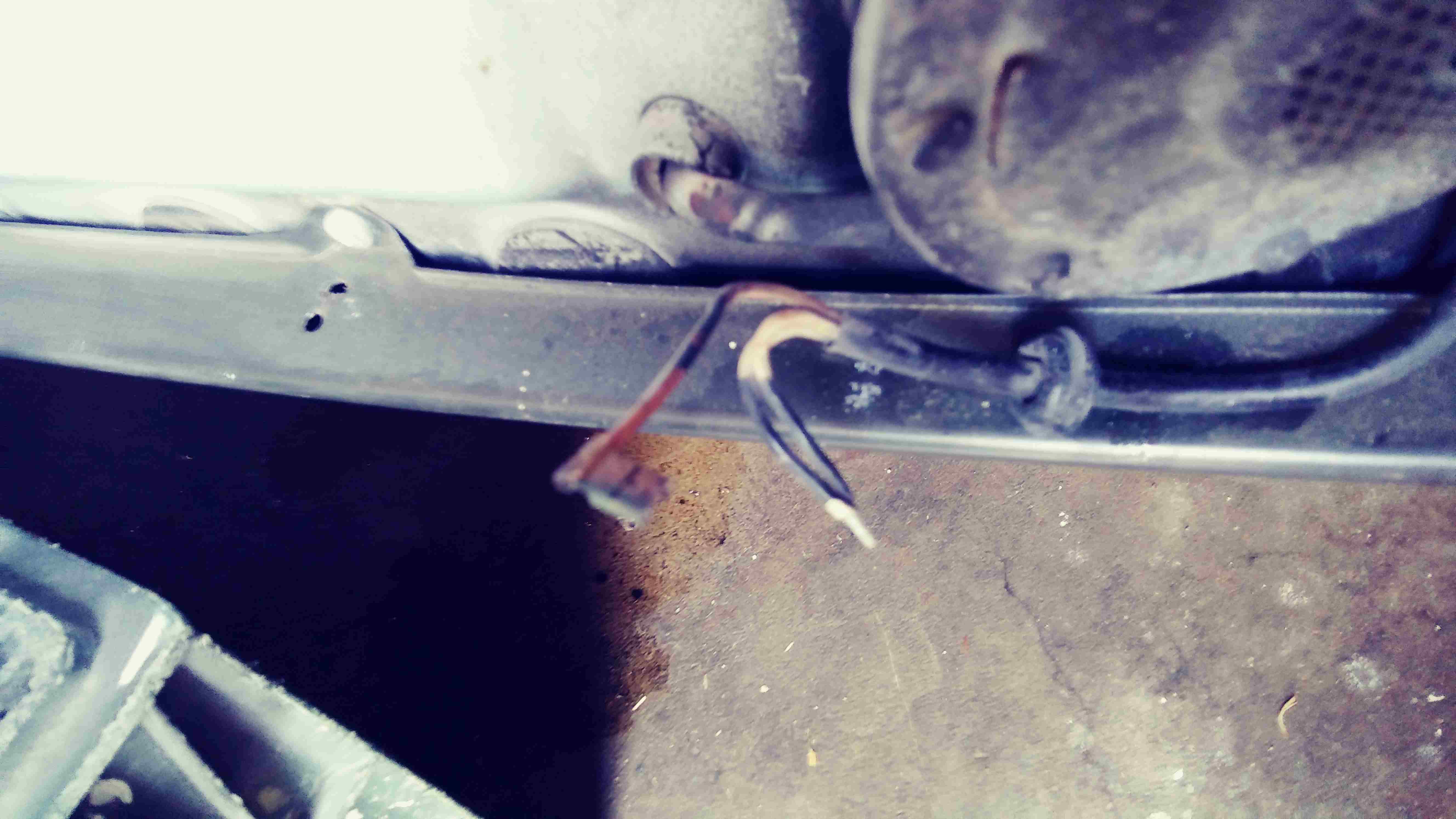

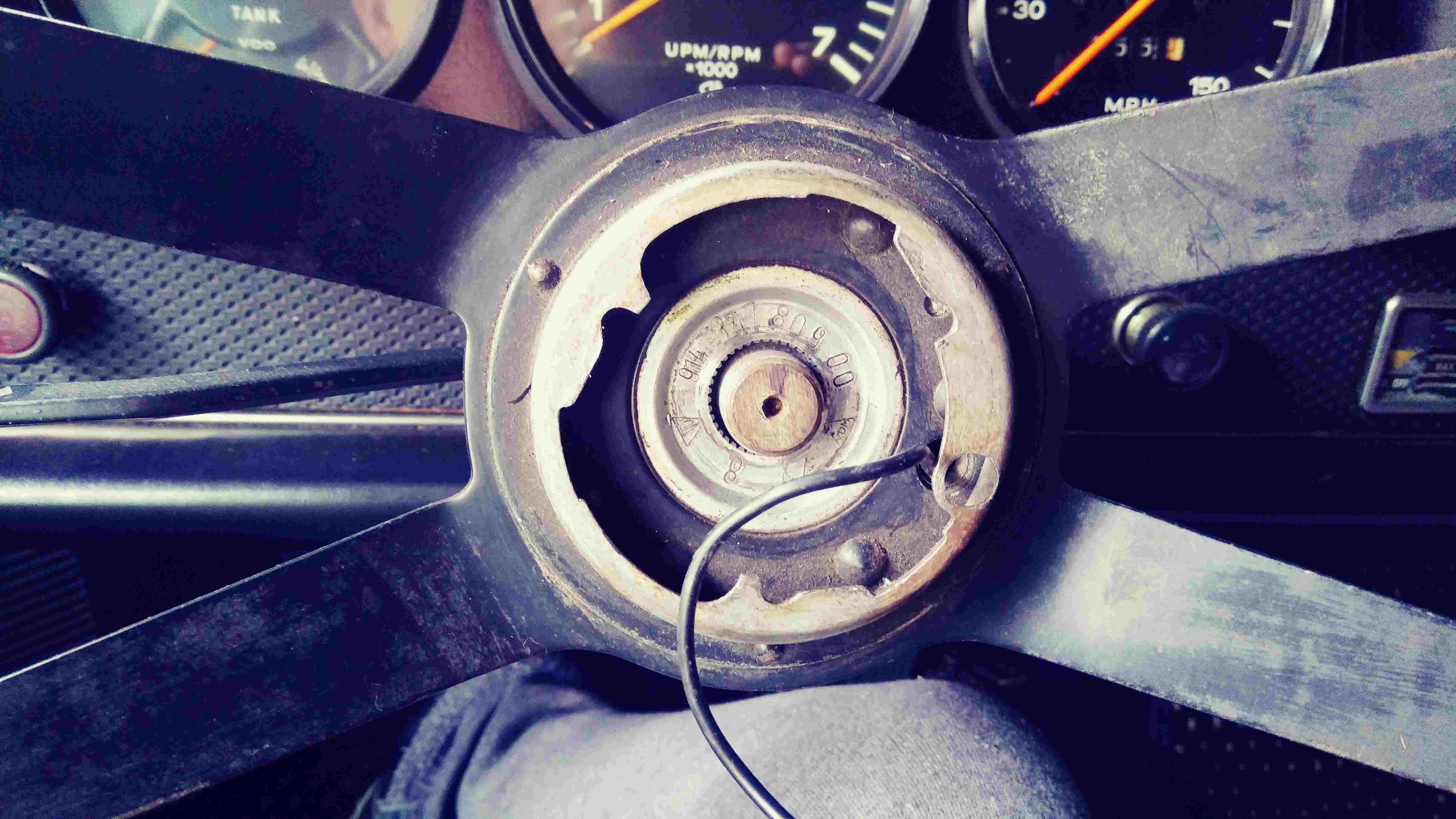

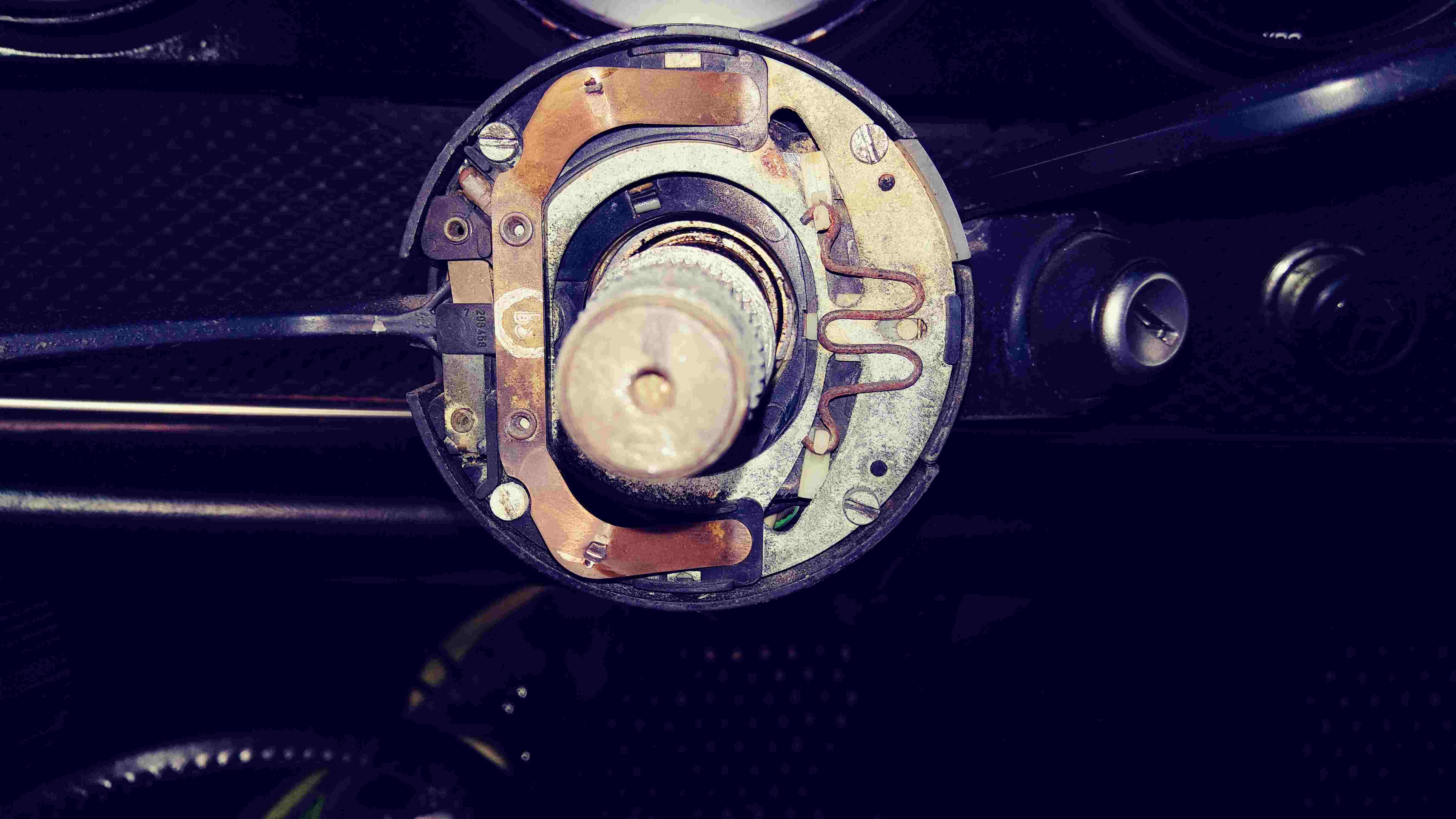

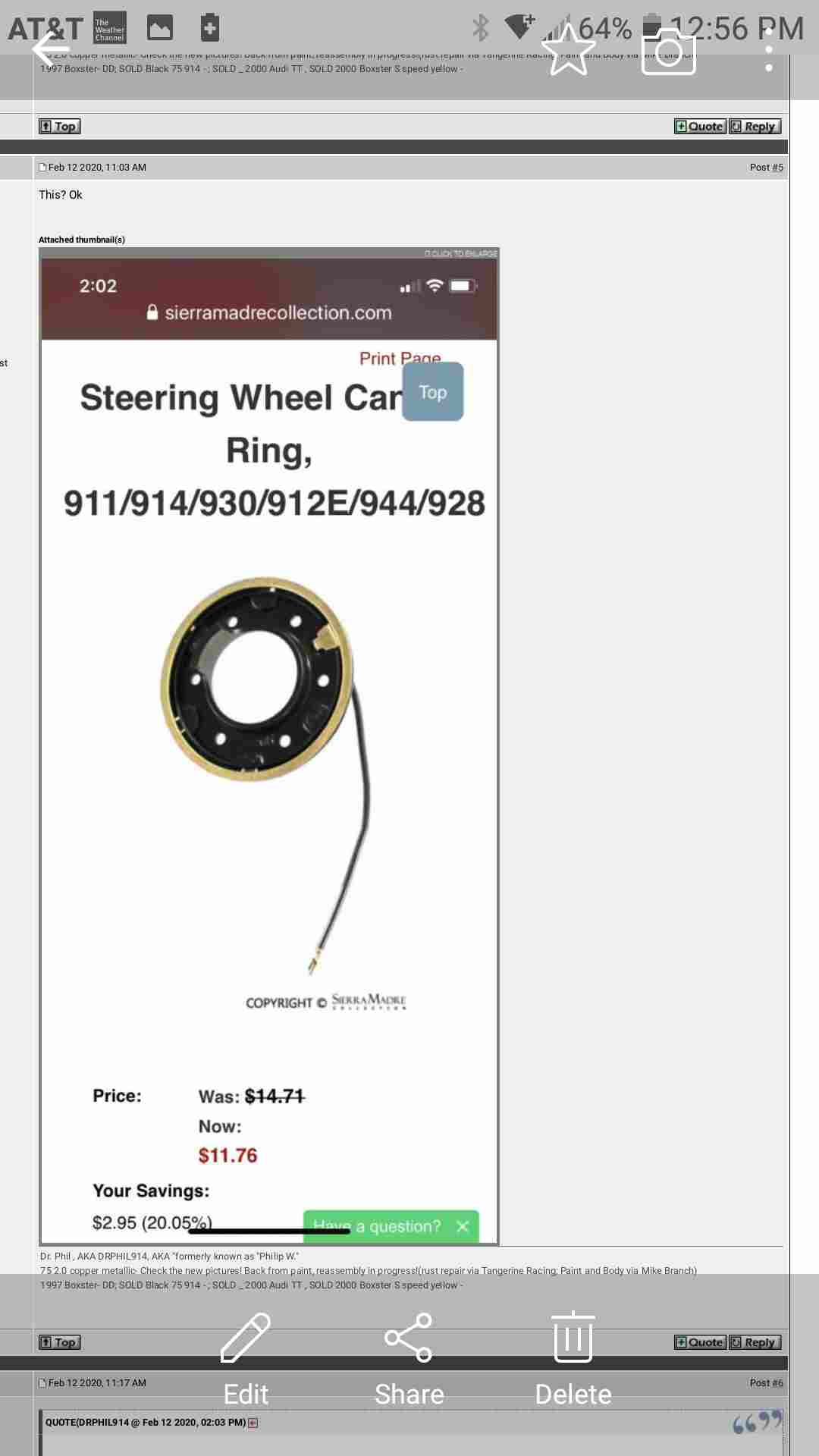

Hi everyone, I've gone through the horn posts and tried to do everything correctly, but I still cannot get my horn to work. I purchased the horn contact ring from Sierra Madre. I've added nylon insulated washers to the Batwing. I have switched out the relay from a working headlight. I have also put in a new fuse. When I touched the horn contact ring female spade terminal to the steering wheel nut I can hear something electrical making almost a clicking sound. When I check it with a meter I am getting 12 + volts when I touch the nut with the terminal.
I pulled the horn and checked it on a battery and it works. I sanded down the horn contacts and added dielectric grease. I am not an expert with the multimeter but I did hook up a negative and positive to the leads that connect to the horn and when I touch the nut I was getting a very small amount of current less than a half volt. I did drive it without the Batwing connected to the wire and the turn signals did not cancel. However they did not cancel before I got the new Sierra Madre contact ring. question about the area where the wire comes out of the steering wheel. Is the hole supposed to be on the top left side or the bottom right side? You'll see in the picture that mine comes out of the bottom right side.
When I purchased this car it had an aftermarket steering wheel. I bought a 914 wheel and batwing off of Craigslist and it fit. what am I doing wrong? Thanks in advance for any help you can give me.

Put the new relay in. Checked all the fuses again and lightly sanded the fuse connection. Still nothing, but I can hear the relay clicking when I touch the cancel ring terminal to the nut. Then I noticed the brown wire coming off the relay had been connected together at some point and the connection was loose. My hopes went up way high at that point as I reconnected the brown wire. Didn't work. Thought maybe someone put an alarm system in it at some point since they cut and reconnected the brown wire.
I'm out of ideas. What am I missing?
